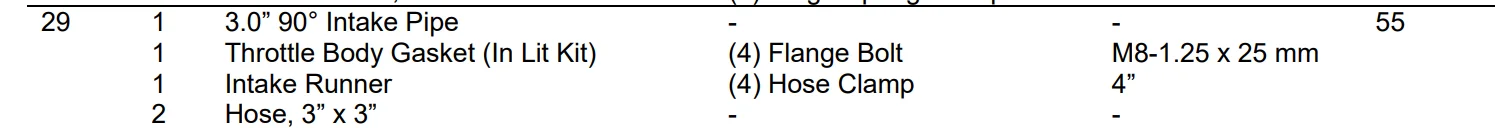

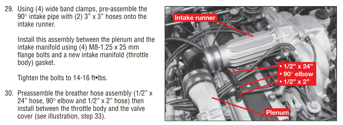

No parts are available for the TRD Supercharger on my 1996 Landcruiser—I've talked to Magnuson and Super Chargers Online (SCOL). I need the 90-degree elbow shown below that connects the supercharger plenum to the intake runner. Has anyone replaced this elbow? What part/source did you use?
3 inch connections.

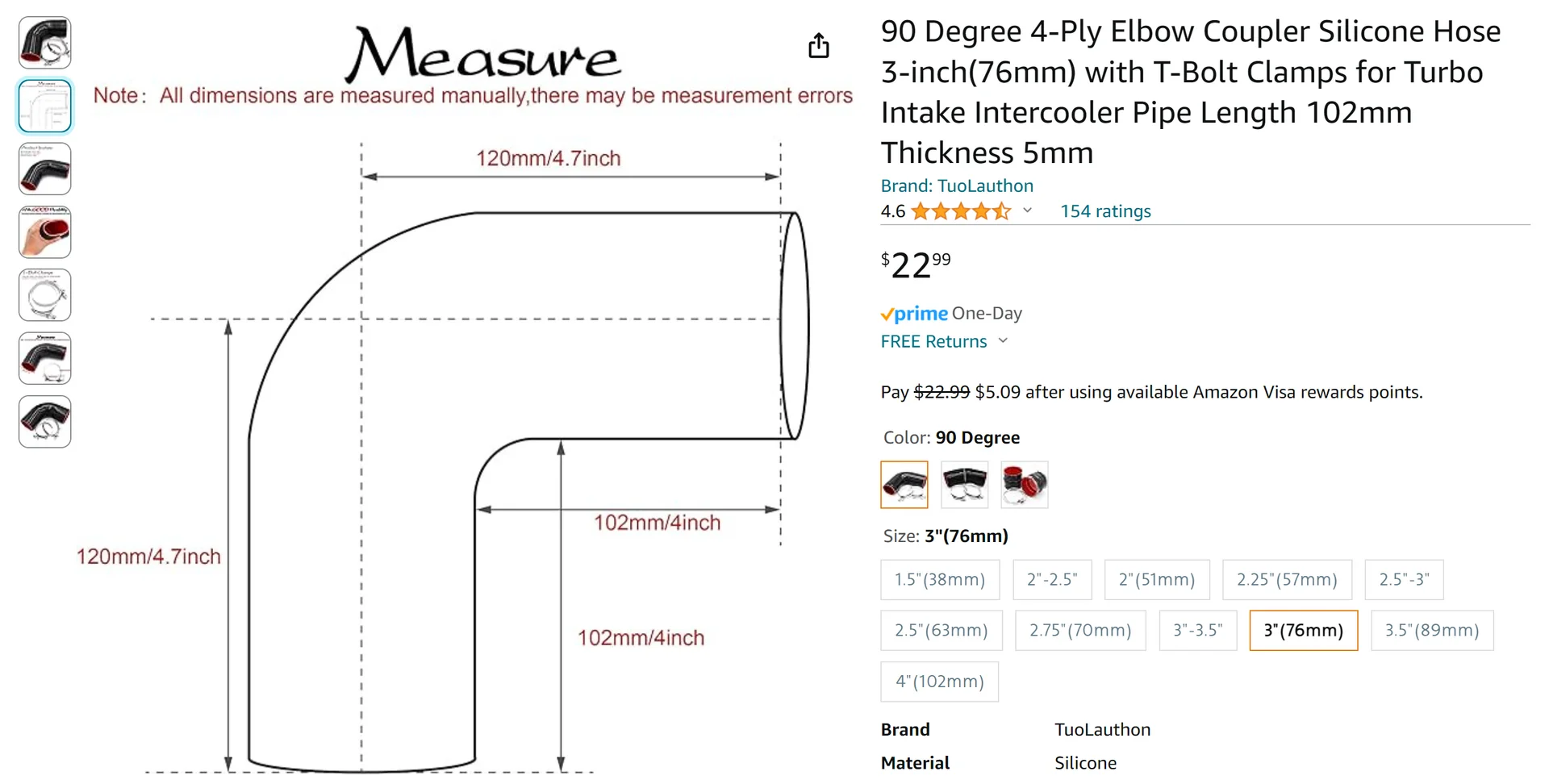

Seems like you could replace the 3 parts with one.
