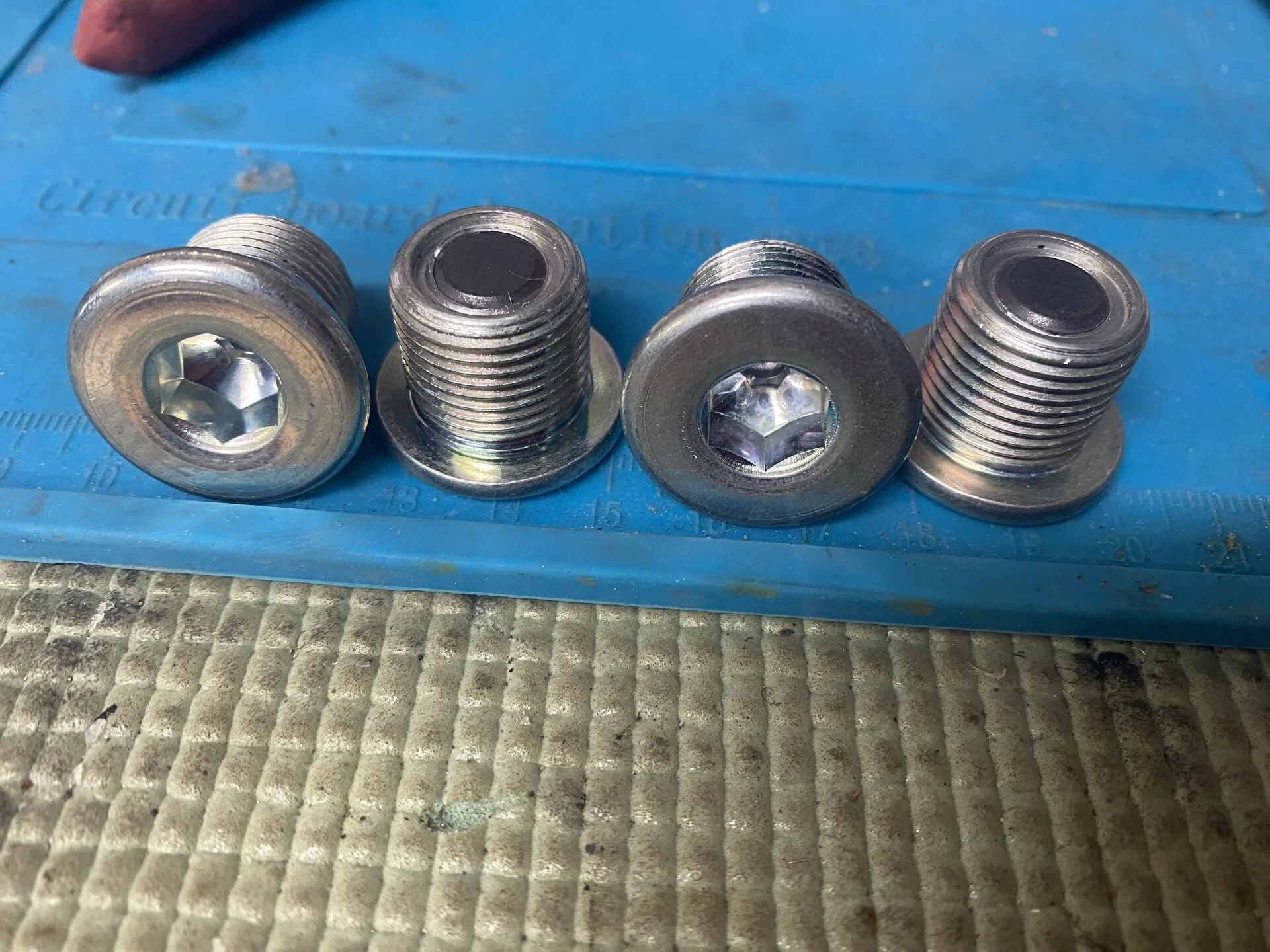

I had some of the hex drain/fill plugs from when I had my 80 series. Will those work with the 200 for the diff and TC drain?
Note: I do not condone purchasing from this link. Search Mud for details.
Double check the overall length before running into the transfer case, but yes they’ll fit the rear diff, xfer, and front diff fill.

Did the rear diff and kept the original in the drain bc the magnet was about 1/2” longer. I replaced the rear diff fill with the hex as the original had signs of potential rounding. Better safe than sorry. Torqued both to 36 ft lbs. Weird that I drained about 3.75 and ended putting in around 4.2-ish. It wasn’t draining like crazy out of the fill, just a tad. All seemed well.

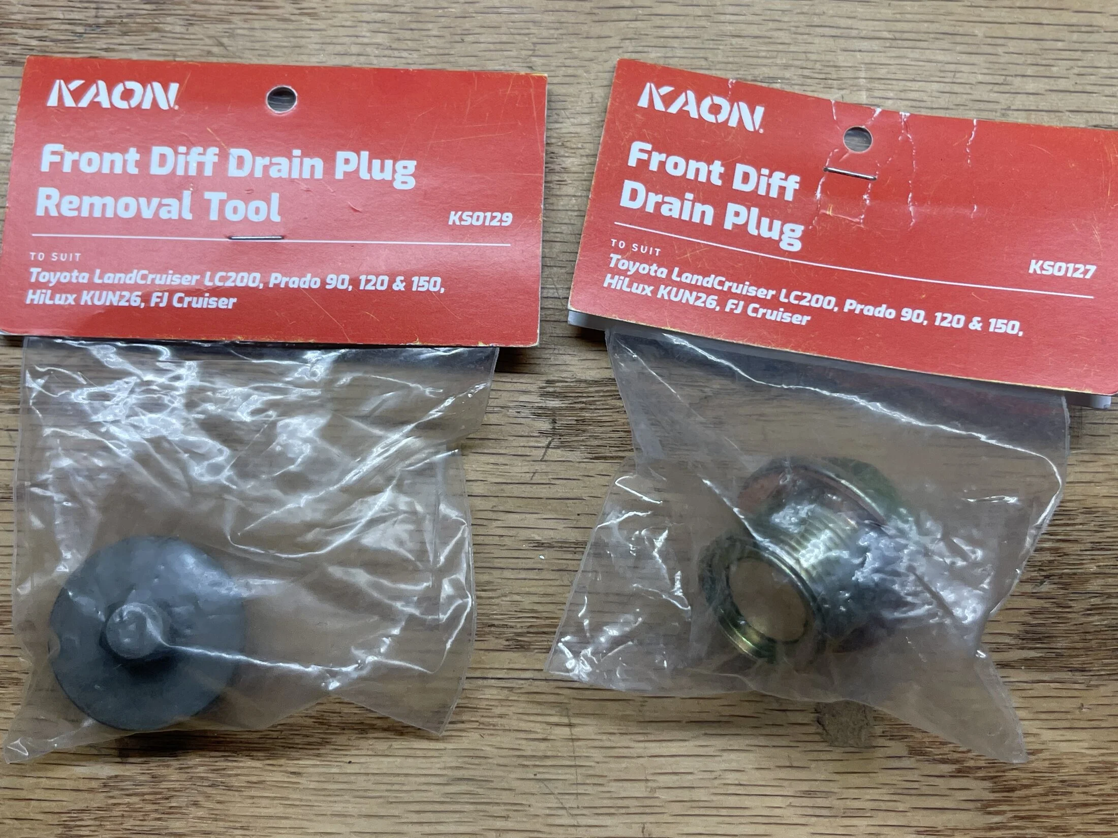

The 90341-24016 is the one I’m having trouble getting to load on the Toyota dealership parts sites I’m trying to buy from… it will only show me 24017 or 24014. A while ago I bought the Kaon hex removal nut head thing and one of their front diff plugs so I have one already. However, I do like to stick to Mr. T oem stuff when possible. Are the magnetic plugs something worth switching to?

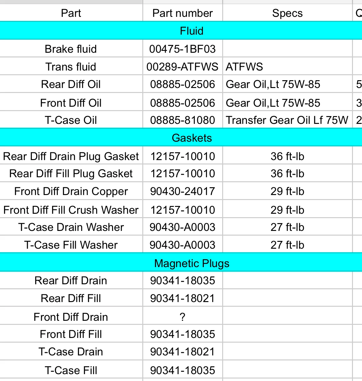

I’m gathering parts for fluid service and finding conflicting info, still need to track down the trans pan plugs and gaskets Here’s my list so far:

Don't forget the Kaon option too. They make a drain and a fill replacement set for the front diff that is great IMO. Drawback is price/shipping and the fact the fill port is not magnetic.
I have the Kaon front plug with their special allen key removal tool.

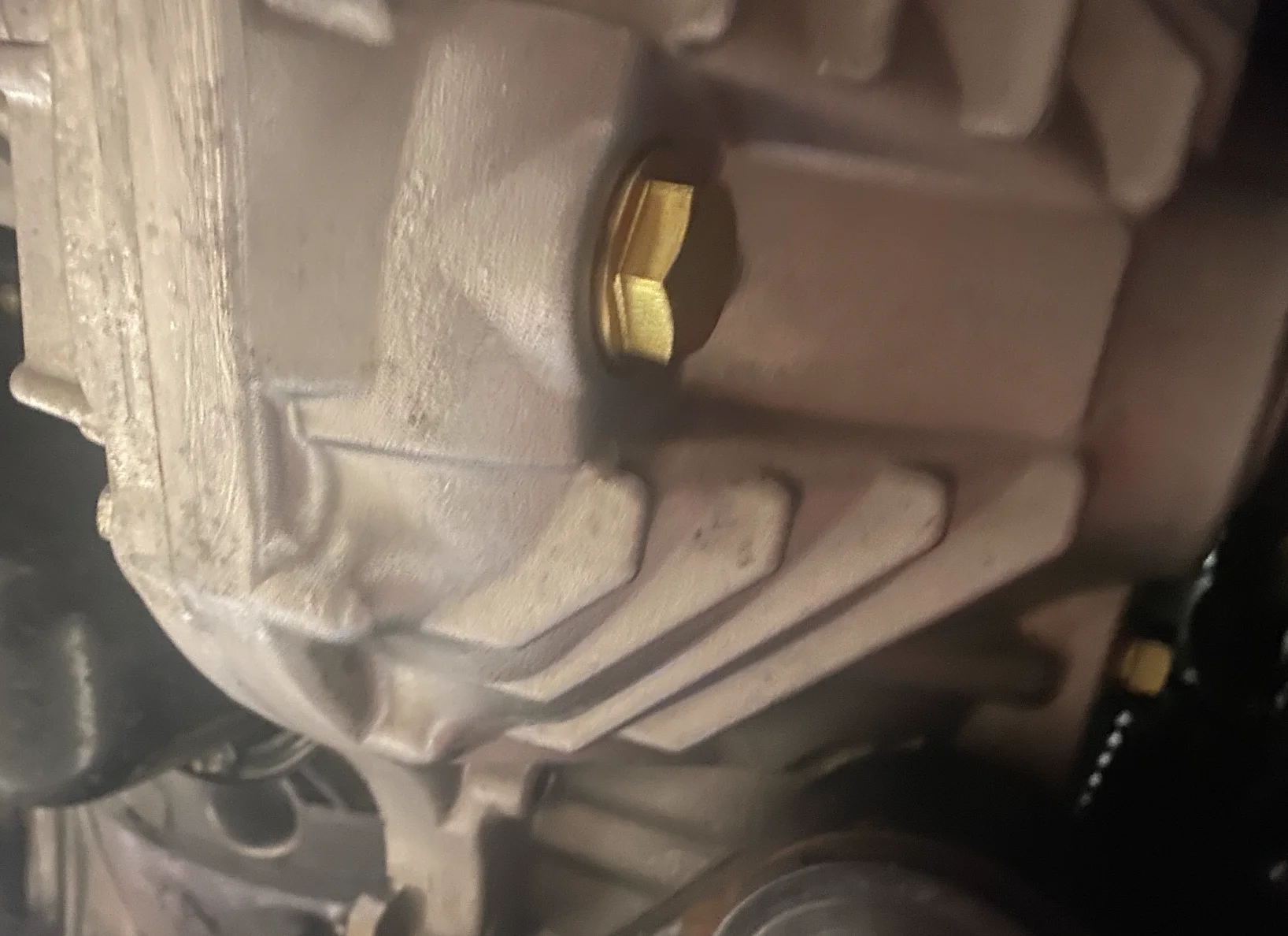

Second picture is showing my front diff, I think you guys are talking about welding and such, I installed Koan fill and drain plugs, they use 19 and 24mm.
