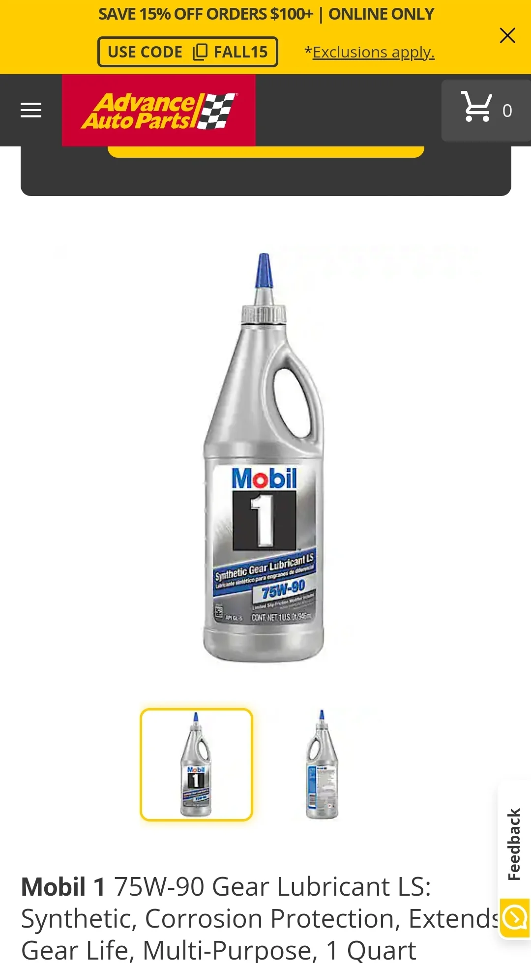

I'm going to knockou my transfer case and front & rear diff fluids today.
I bought two bottles of Red Line MT-LV fluid 70W75 for the transfer case.
Front & Rear diff wise, I plan on using Mobil 1 75W-90. The only gear oil I can find at any of the auto stores is Mobil 1 75W-90 LS. Is this gear oil safe to use on the front and rear diffs?
That's exactly what I used for the diffs. Some of it was a few years old, left over from our previous 100 series. No issues after maybe 1500 miles.
