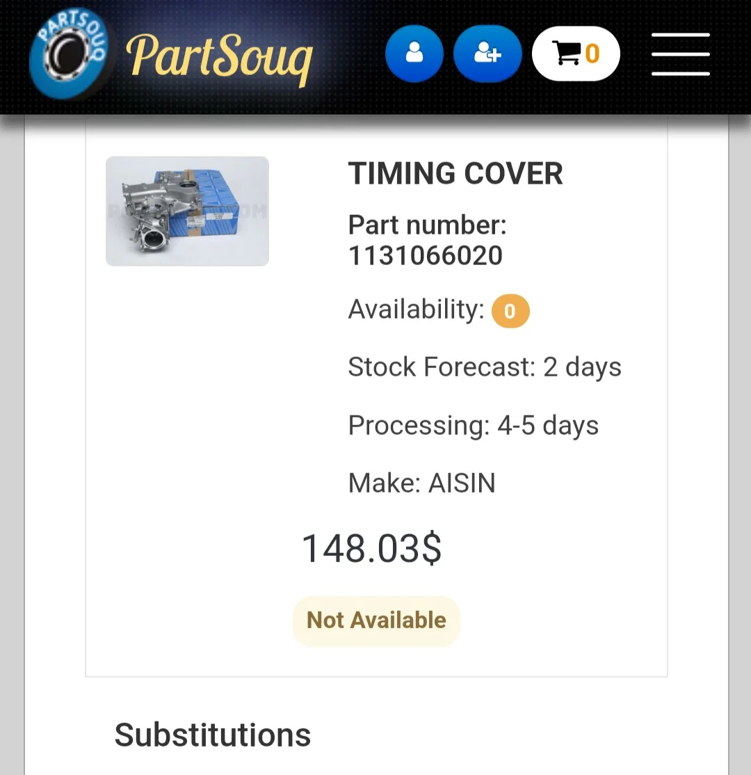

Aisin timing case was >$200 when i bought one through partsouq.com
Wouldn’t have guessed that cheap.
Aisin currently not available through partsouq.com
Toyota branded one is $257
The Aisin one I have clearly had the toyota branding ground off

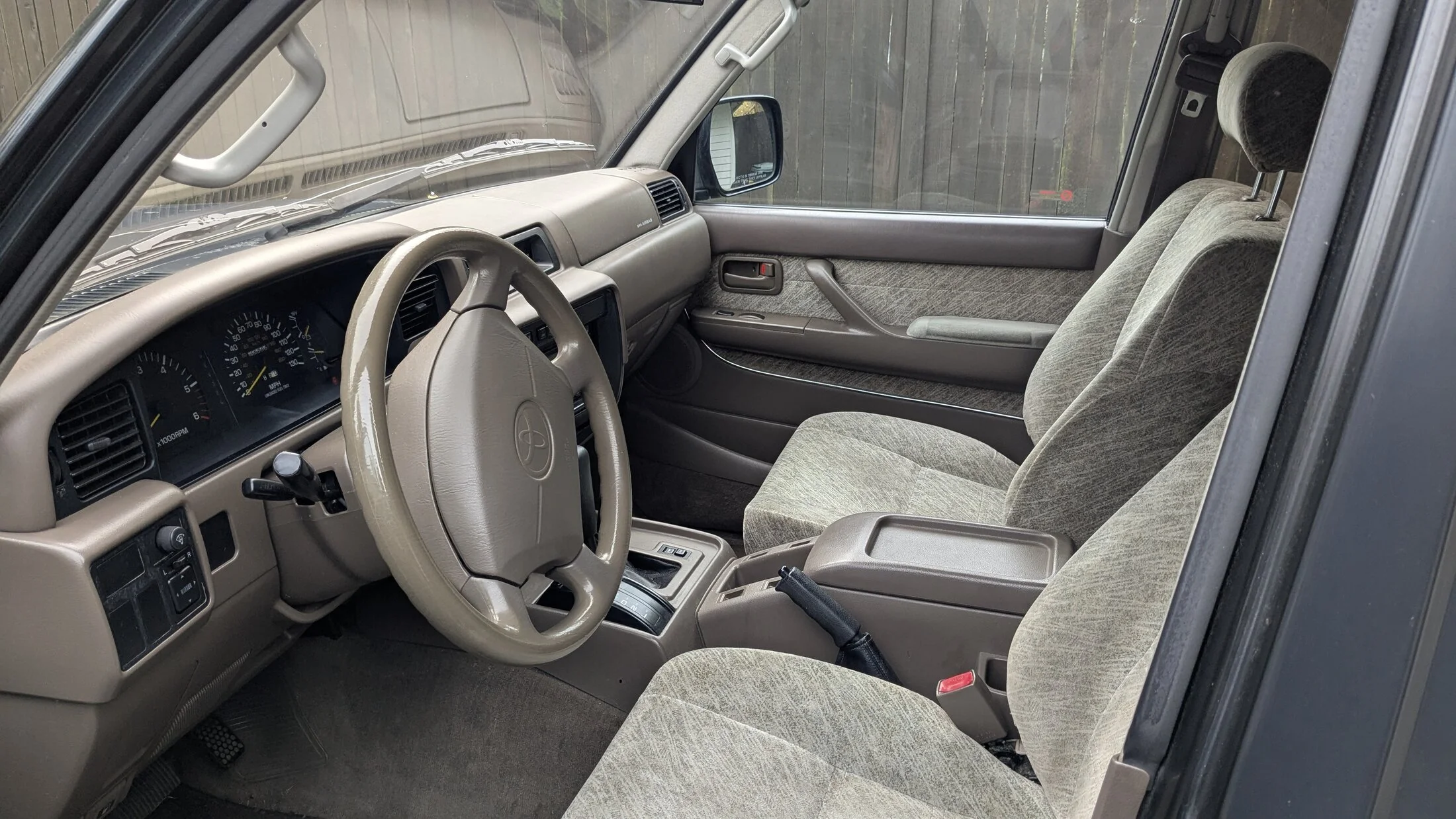

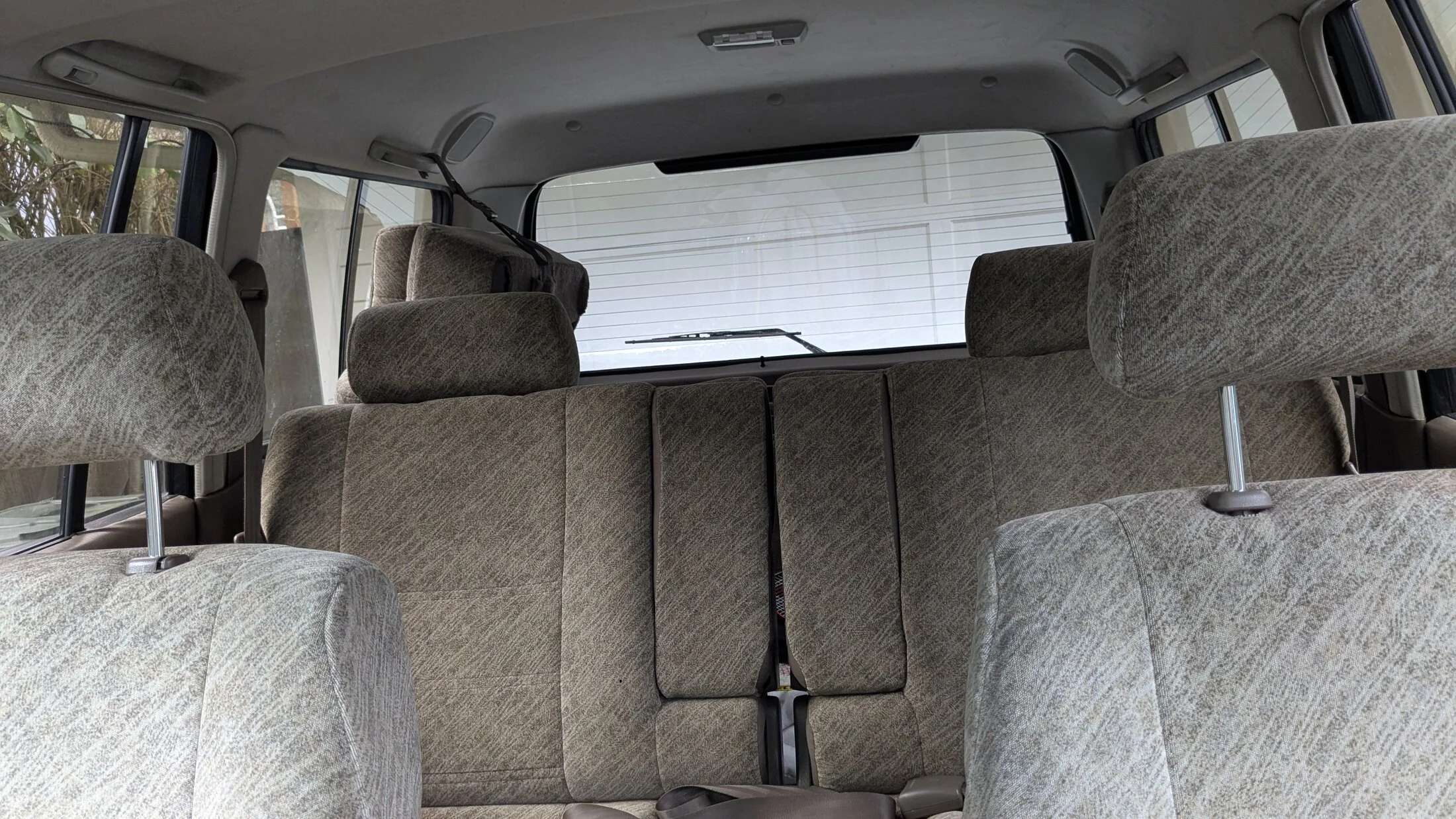

I think it's time to move on, but I don't know how much to ask for her. Can you guys help?
History;
Early 95 emerald with tan cloth interior - not poverty pack. Has sunroof / rack (removed) / rear wing / gold emblems
Not 3x locked
240k
No rust
No rips in the interior
3rd row seats
Head rebuilt by torfab in Everett , Wa
Peaky hh replaced
Was based lined 30k ago - wires, plugs, dist. Seal, cap, rotor, pads, rotors, oil filter, fuel filter and some hoses.
New Denso radiator and hoses
Aisin water pump
New interstate battery
New Oem wiper windshield motor motor
Oem power steering pump
OME stock height springs all around
Oem shocks all around
Oem brake lines
5x 295/75/16 GY K02 - always rotated with the spare / still have tire nipples.
New oem emerald sideview mirrors
Wits' end spare tire leveler
Oem full lock set - 2 keys
Everything works (minus the engine of course) Sunroof doesn't leak. Paint is faded like most. Cracked windshield. No accidents. One minor dent in the rear tailgate. Clean title in my name.
Was originally owned by a school teacher. Never off-road. Mall cruiser.
Was a great rig up until she blew. Always started right up. Shifts smoothly. Knuckles don't click or leak. All windows, locks and sunroof opporate as they should (slow rear windows) N light was replaced and illumates.
Sad to see her go but 7k and up for a used engine swap is not in the cards.
Let me know if there's anything else I need to mention to help form an accurate asking price.
