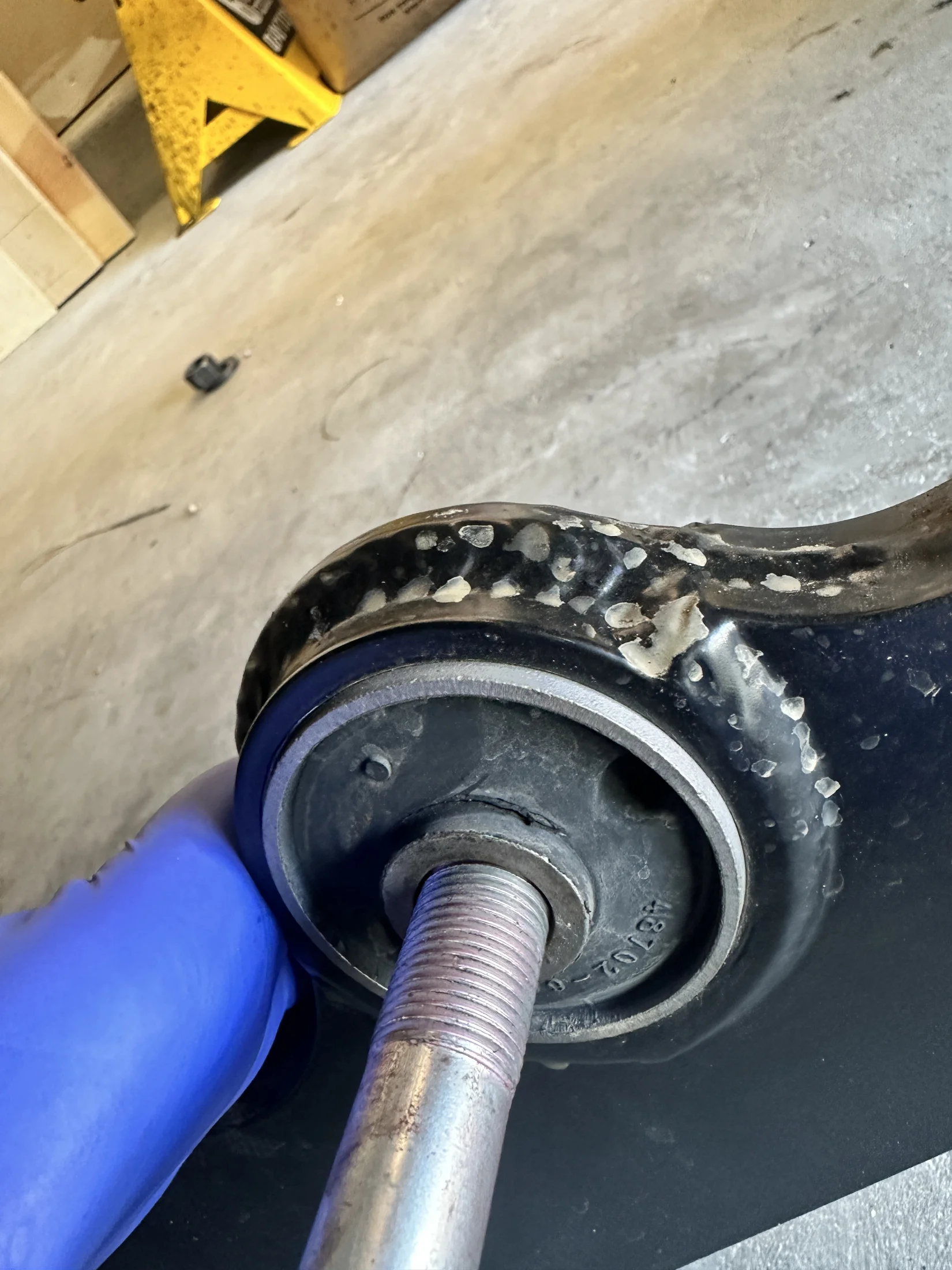

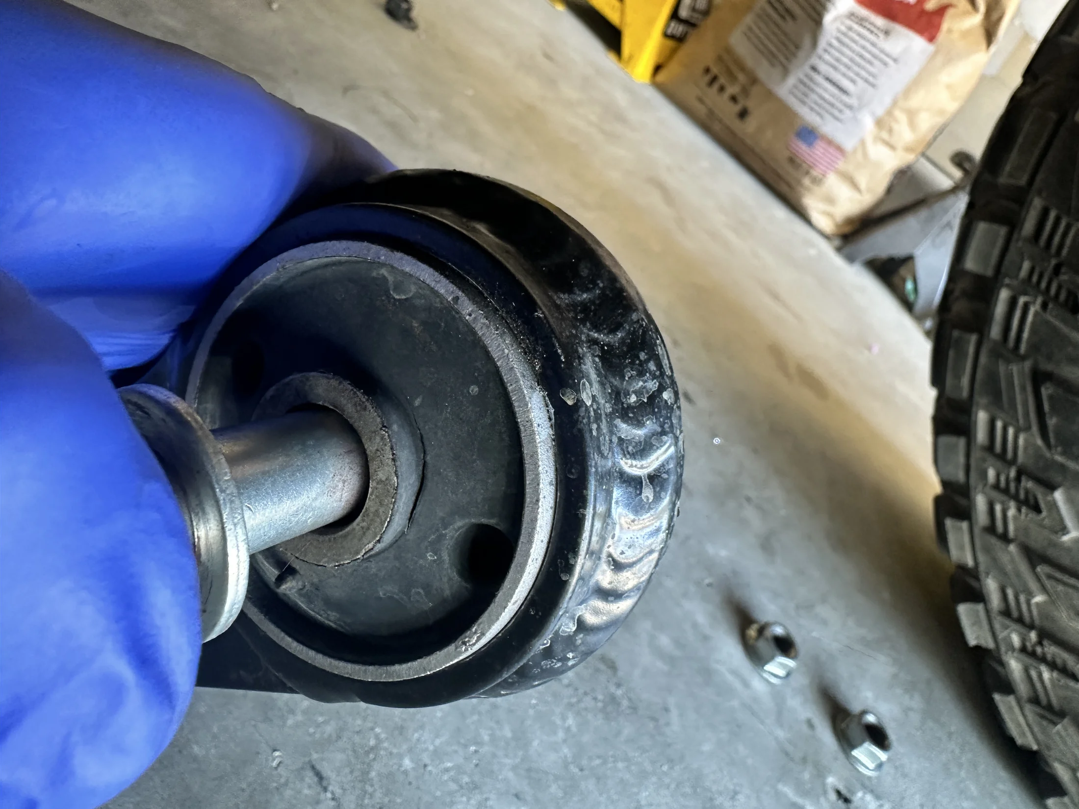

Yesterday I dropped the new control arms to see if the bushings tore up or something. I did find few small cracks on the outside but they’re in tact. I thought maybe the new control arms are bouncing around. I took a picture pushing the insert down with a bolt.

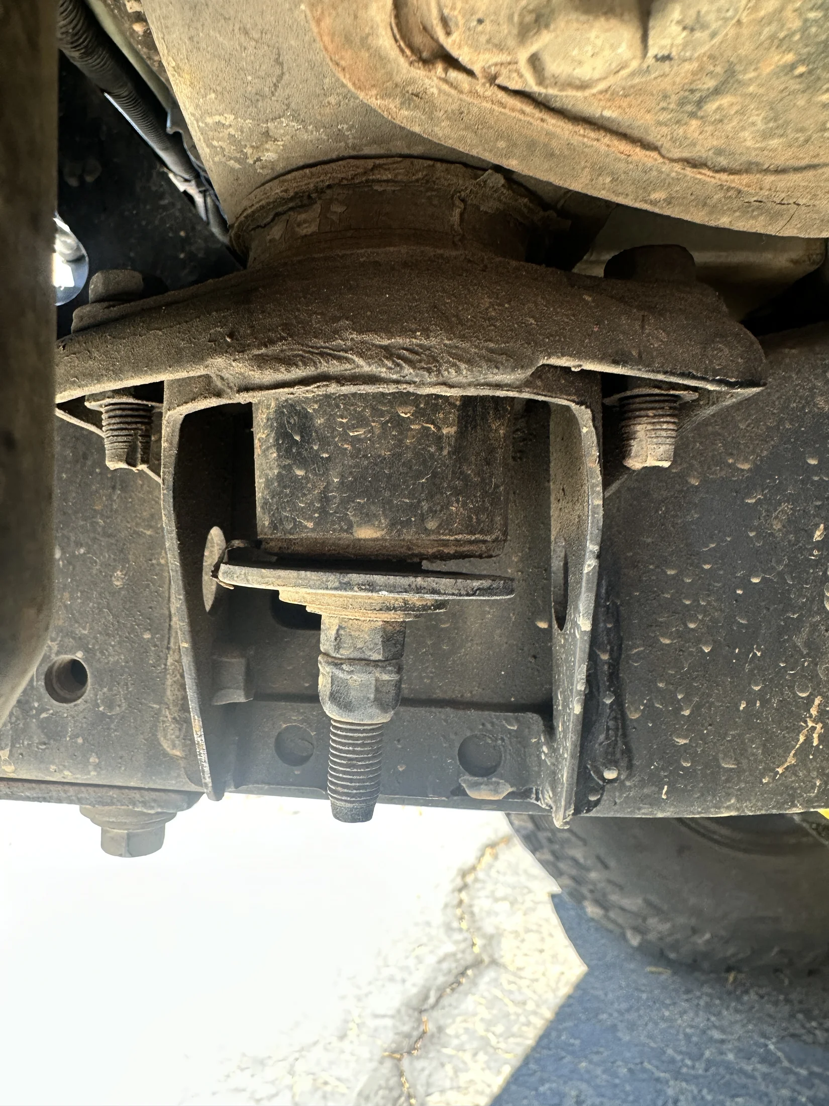

if you're feeling something near the foot rest, check that body mount bushing hardware for tightness. you may have to put an extra ugga ugga on it then see what happens.
Haven’t checked that, might be a good idea. Maybe the heat from the welding has loosened up a body mount.

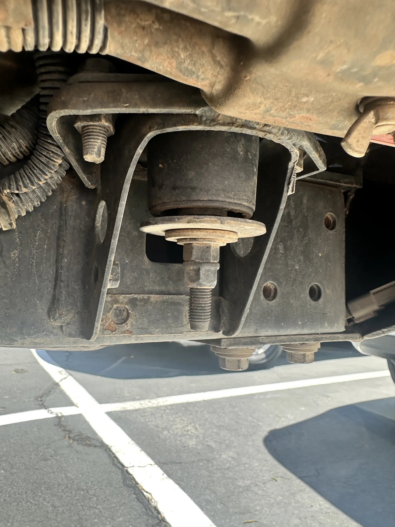

Certainly doesn’t “look” right. Here are the forward ones.
Ok, that one is cockeyed looks no bueno. I did the same project and no heat makes it that far to impact the body bushing in that manner. Something ain't right!!!
