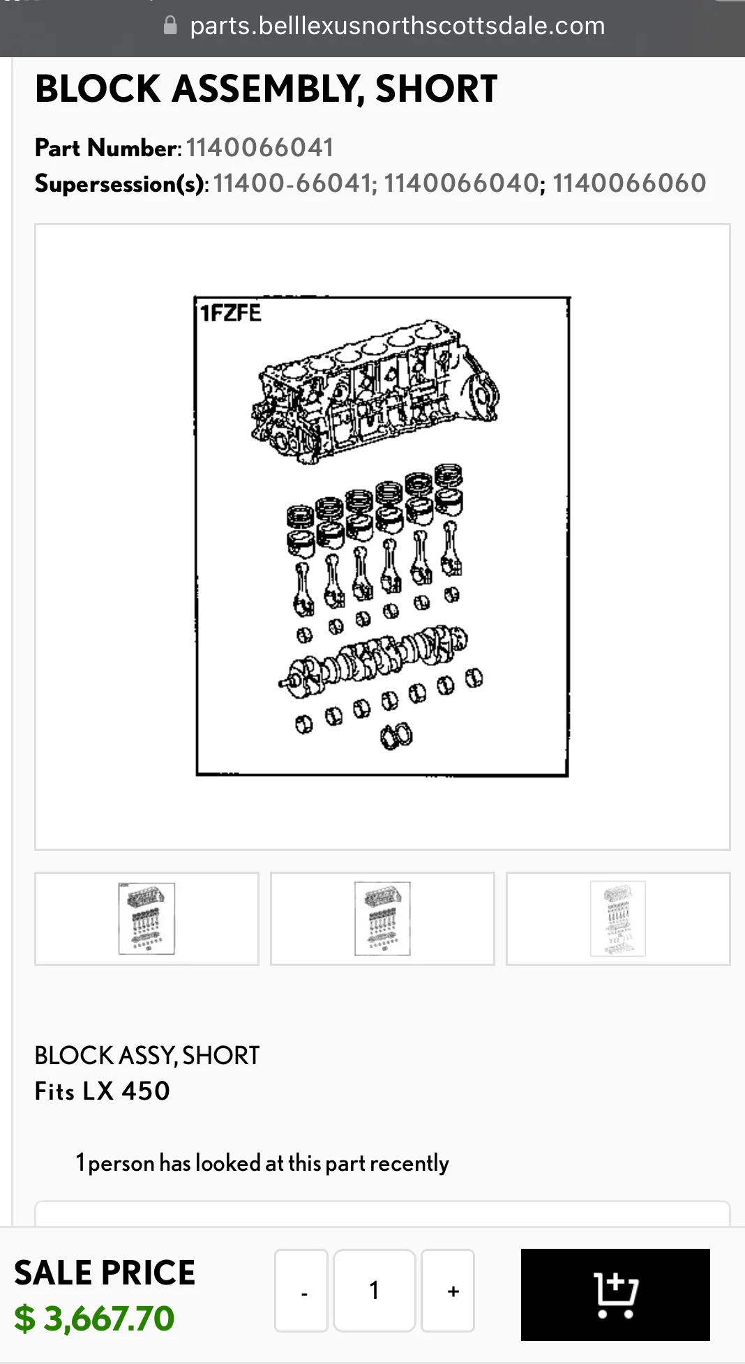

one source i like to use is bell lexus in scottsdale az, free shipping (up to $100 merch) to lower 48
they won't ship engine assembly but the price would have me seriously consider options to get it from there to wa
popped back in to say check with @Fj80oregon
he's closer to you
That is a way better price! I just got off the phone with their parts dept. And he said that is their sale price and that the blocks are backordered but an order of 10 is being sent to their ontario dc at some point. I just would have to figure out pickup and shipping and the cost for all of that.

Thank you guys again for all your insight. I am leaning towards rebuilding it myself. I do already own a cherry picker and an engine stand so now it's all about making garage space and sourcing an oem short block in my area since shipping from Arizona isn't feasible.

You want 04111-66036 as it’s a complete engine gasket kit. Also Toyota of Portland msrp for a short block is $4686 can usually be bought for $4300 not sure who you talked to over there.

I didn't get the guys name even though he mumbled it when he answered the phone. I will look around online today to see if I can source a block within a few hours from the seattle area.
Called around and either the msrp has gone up or everyone is marking these things up.
EDIT: Calling was a waste of time. The prices online (even through the same dealerships I called) were way better than what the parts guy quoted me.
Lexus of Fife: $5700 + tax = 6200
Beaverton Toyota: $4700
Broadway Toyota: $5963
Gladstone Toyota: $4687
Capital Toyota: $4830
Columbia Gorge Toyota: $4998
Toyota of Corvallis: $4874
Lithia Toyota: $4686
There are more dealerships in the area which I'll call but I'm not holding my breath on finding anything like the Arizona price.

With Lexus, they just add the Lexus tax to the Toyota MSRP. Don't bother unless you like paying it.
Looks like $4,686.84 is MSRP. No one is giving you a discount and some are adding a premium? Damn...
Cheapest online is $3,644.51, out of a Toyota dealership in Kansas.
Ishino Stone engine gasket set, made in Japan and more than likely the supplier to Toyota. If I remember correctly I had to buy timing cover orings, probably some other seals and gaskets but not a crazy amount. I've never bought a Toyota gasket kit so I'm not sure even if those come with all the seals and gaskets. Call around on the short block, thinking you should find one around $3750.00. personally I wouldn't use any valve stem seal that is not Viton, The valve stem seals Toyota sells for this engine will be hard as a rock in less than 100,000 miles. Timing cover and oil cooler cover can have erosion, need to clean and inspect. Also you can upgrade to a MLS head gasket, companies like Cosmetic. You can use ARP bolts for the head to block fastening.
