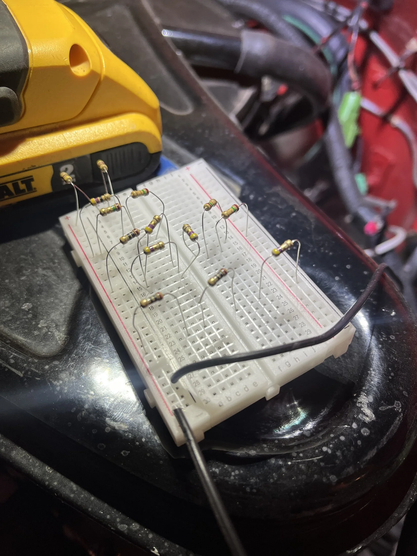

So, I ordered a new temp sender (Toyota OEM part # 83420-20011), but haven't installed it yet. I'm suspecting that my current temp sender is faulty or I did something stupid when I installed it. Before I do all that work, I figured I would test the actual gauge in the cluster to make sure it's calibrated. I set up a breadboard with different combinations of resistors to get me the values called out in the table in the FSM, turned the truck on and validated the gauge ended up where it ought to. Everything looks good except the high-setting. 25 ohms barely pushes it over the 3/4 mark. Doing some testing, I found that the gauge needs about 15 ohms resistance to hit the max setting.
I'm not sure I can fix the gauge for the highest setting (maybe it's fine, eh). But I would like to fix the temp sender. So my next steps are to drain a bit of the coolant, swap out the temp sender for the OEM part (with thread sealer), and see whats up next. For those experienced with this stuff, am I skipping anything important? Anything you'd do differently? I want to get the stock gauge working as best as possible ideally.
Here's some pics of the testing setup:

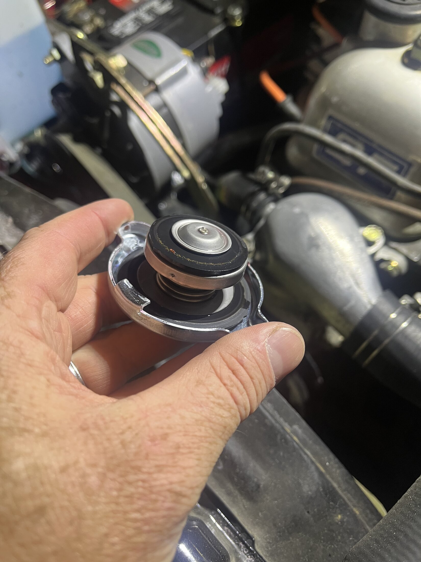

Do you have a 14 PSI radiator cap? At 14 PSI you would be good to 254 degrees. This temperature is based on the cap, not what the engine will run reliably at. If you’re testing by driving the rig, the stock radiator is basically designed to keep the engine 100 degrees F above ambient with the T-Stat fully open. So on cold days like below 50, the T-Stat will partially close to keep the coolant system at 180. On a 90 to 100 degree day, under load, you should see 200 (maybe 210) degree coolant temperature…..and when you cruise into town, with stop and go ‘after’ your ‘under load’ run, you’ll see temperature increase, many as high as 220 (due to lower airflow) before you see a temperature decrease. However, you should see a decrease….after a while.

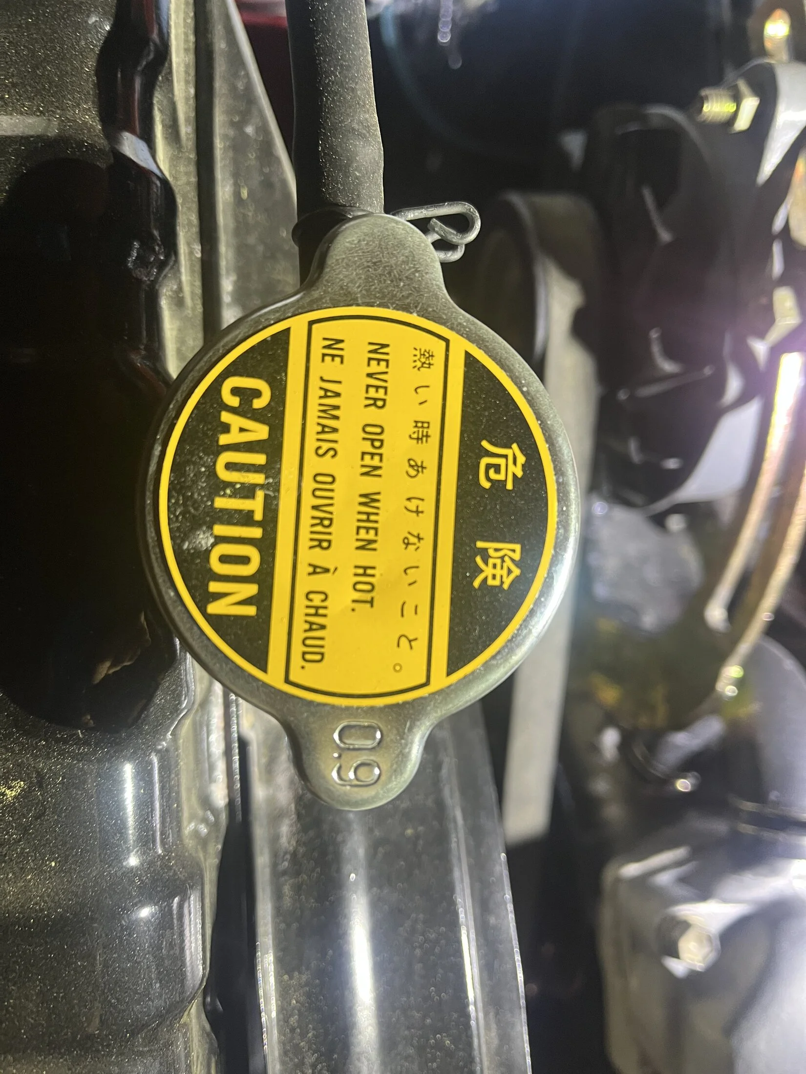

I checked my receipt from SOR, and the cap itself, aside from trusting that it is a new OEM one for my year (looks like its the same from 75-84), I can't find much in the way of identification on the cap itself, aside from a "0.9" stamp on it. No idea what PSI its rated for. Here's some pics for those who are experts at radiator cap identification :)
I realize I made a small error with my resistance testing on the gauge, I strung together two 10-ohm resistors and a 4.7, should have done 10+10+1.5+1.5 (according to the FSM its 23 ohm, not 25). That said, it still wouldn't have moved the needle all the way to the right, as that required around 15 ohms.
So what do y'all think? My plan is to swap the sending unit next, unless Im skipping a step here. Has anyone had luck in calibrating their gauges?

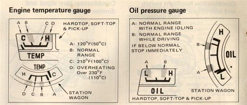

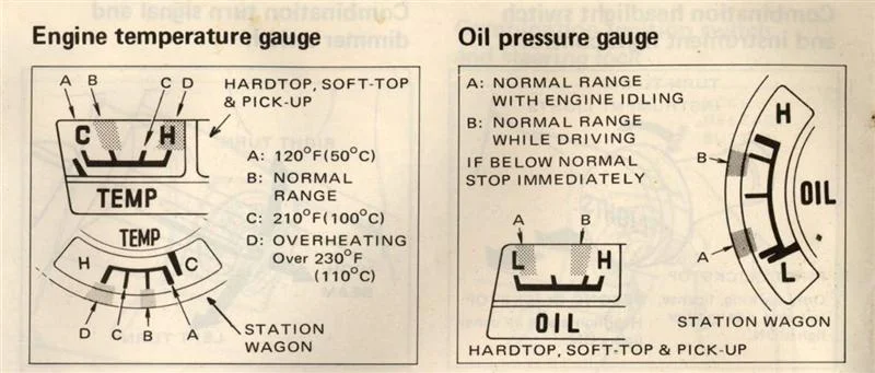

All the gauges IMHO are sort of basic as in they read in the vicinity. The J3 Cub I learned to fly, gas gauge was a cork float with like a coat hanger poking threw the cap. Lots of coat showing was lots of gas, If the 90 degree bend in the rod was getting near the cap you were low on fuel. Pro Tip if you think you might need carb heat turn it on, because if you wait until you are sure you need carb heat it might be too late to work
Someone posted this yrs ago.
I run an sbc and use the stk gauges in the cluster. My oil gauge seemed to run low so i temporarily installed a mechanical oil gauge to compare the two. I should do the same for the temp gauge. It's not a priority because there's no indication that it's even close to running hot.
The 0.9 stamped on the cap is 0.9 Bar or close the 1 atmosphere, and that = approximately 14 PSI. So you have a 14 PSI cap.

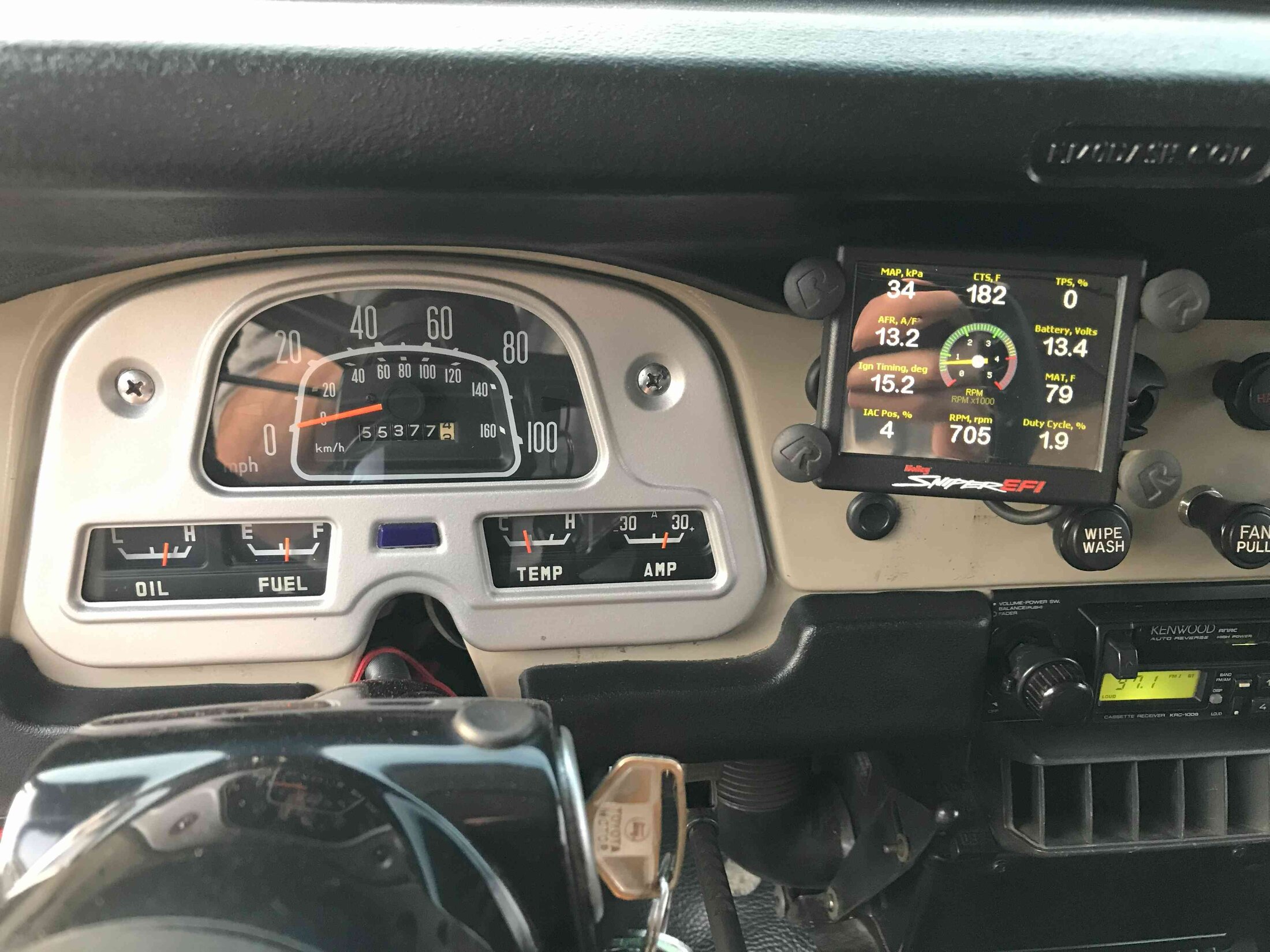

I'd say that temp gauge pic @pb4ugo posted is accurate, see below for my '77 FJ40's OEM TEMP gauge & Sniper's temp gauge. Like yesterday, with the outdoor heat index over 100F and over 20 minutes of driving, the highest my Sniper read was 186F.
Not being familiar with the Sniper, where dose it pick up water temperature. Is it at the back of the head, as the original temperature sensor?
I have my Sniper's water temp sensor in the rear block drain location.
Actually .9 bar converts to 13 psi, .97 bar converts to 14 psi. The significates of psi is a higher boiling rate so for every psi (3 degrees for every 1 psi) which in turn can help prevent overheating. If the cap is too high (depending on condition of cooling system) it can lead to overflow, leaks, or damage
Numbers are with 50/50 coolant
3 x 13 psi = 39* above 220 for a sum of 259*
3 x 14* +42* .....262*
Done nerding out with Hazmat/O-chem stuff. :)
