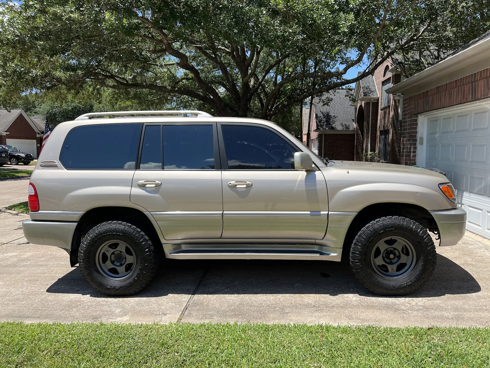

I've been waiting for almost a year for these 5x150 to be in stock. Grabbed them last week and arrived yesterday. They look great. Lightweight too.

Looks great! How do you like the way it handles (e.g acceleration, braking, turning) on the road?

Love it. The only thing I can really notice is the lighter rotational mass, coming from oem rims. It’s subtle, but makes just enough of a difference to help the bigger tires turn a little easier. Worth it in my book.

Similar experience though with 285/75R16s. Felt a little more frisky if that is a description.

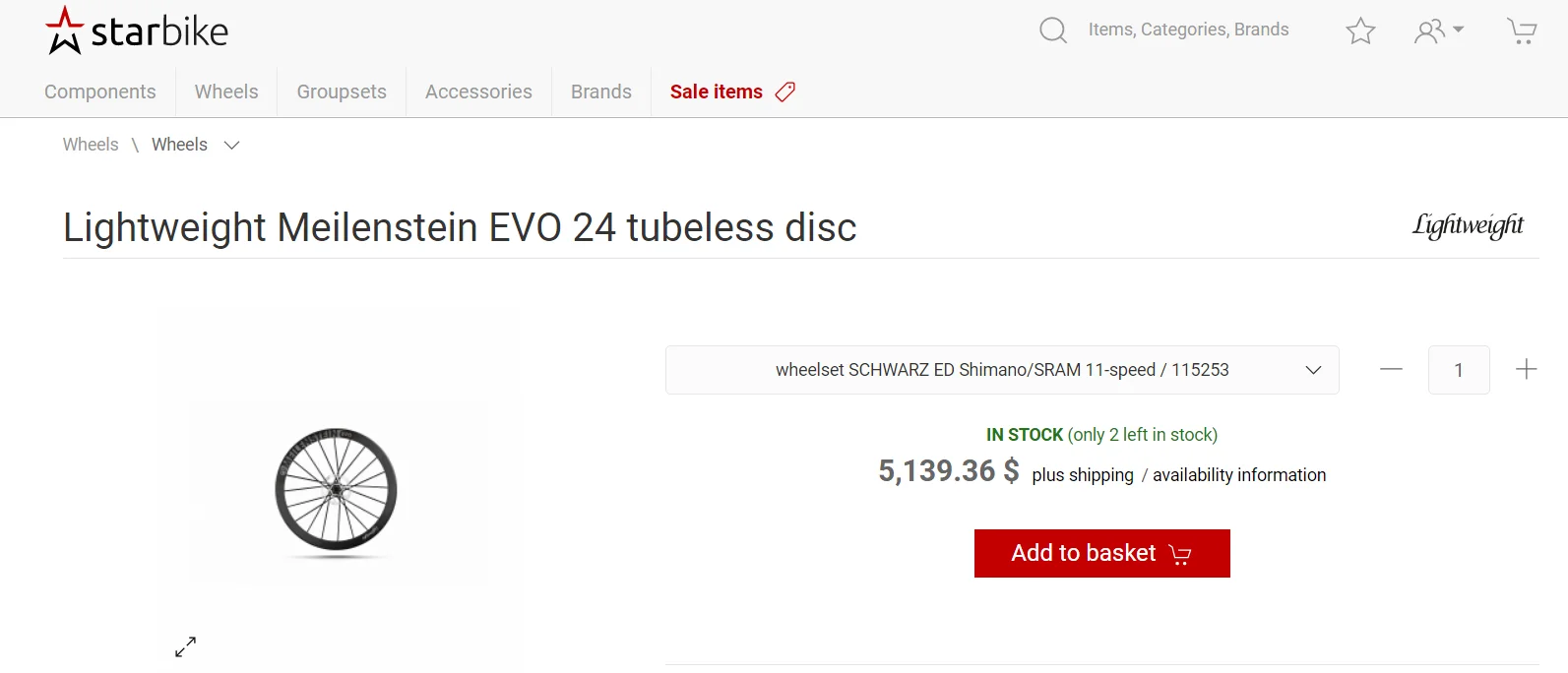

Look at the bright side.
It costs thousands less to buy a set of lightweight SCS F5 wheels for the 100 series than to buy one Lightweight Meilenstein EVO 24 tubeless wheel for a bicycle.
People spend big bucks to shave off a few ounces of rotational wheel mass.
