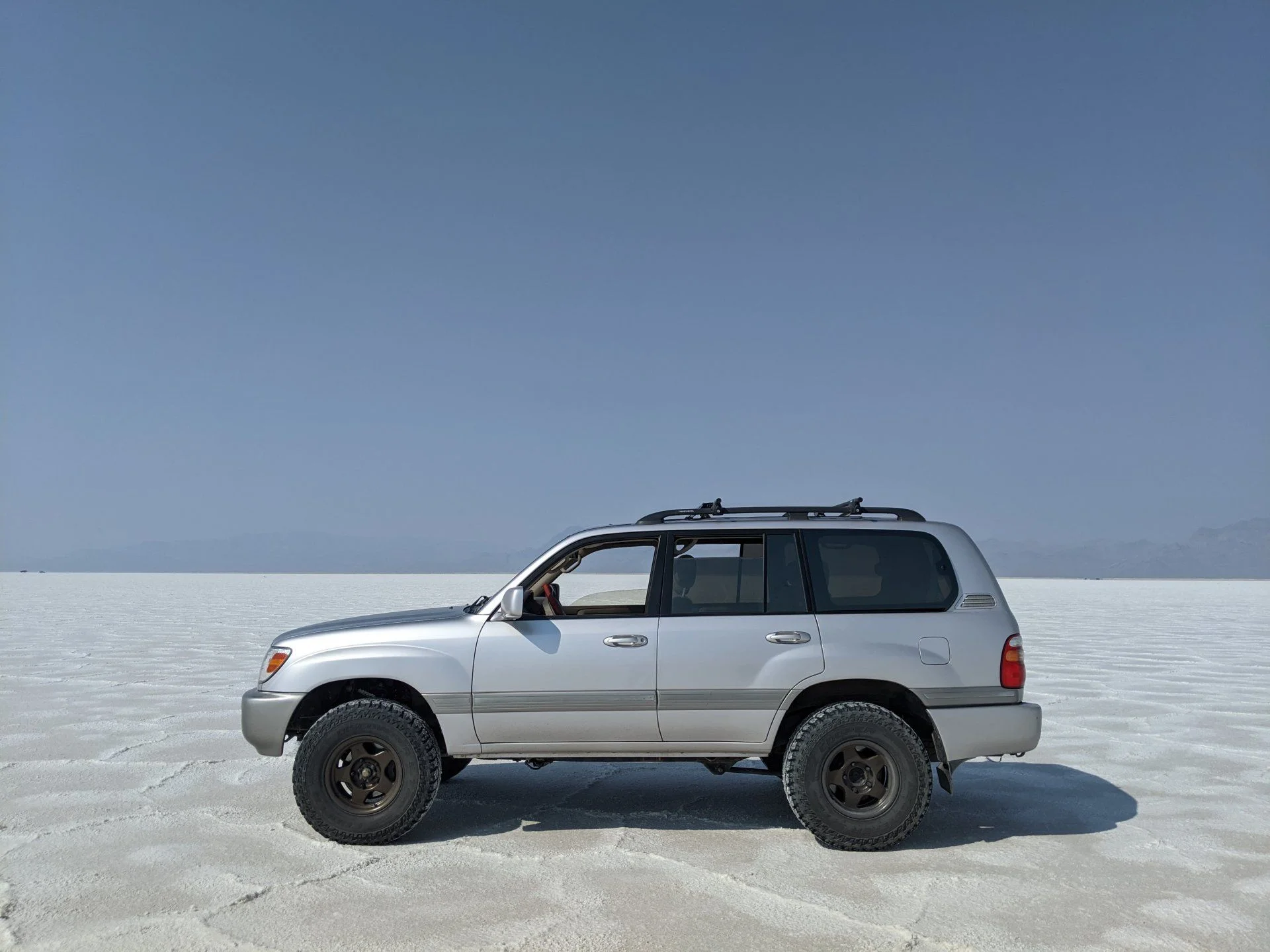

5x150 SCS F5 Wheels 16x8
2.5" lift 285/75/16
Works for me😎
Finally pulled the trigger on a set of these in gunmetal. Absolutely LOVE the way they look, and the offset really enhances the stance.
For the debate about whether these rub, mine did .... quite a bit (Tires are 285/75/16). Had to hammer the s*** out of the pinch weld, and I need to move my drivers side slider a bit further back.
Rear bumper will be going on next week. I'll get some better pictures taken then.

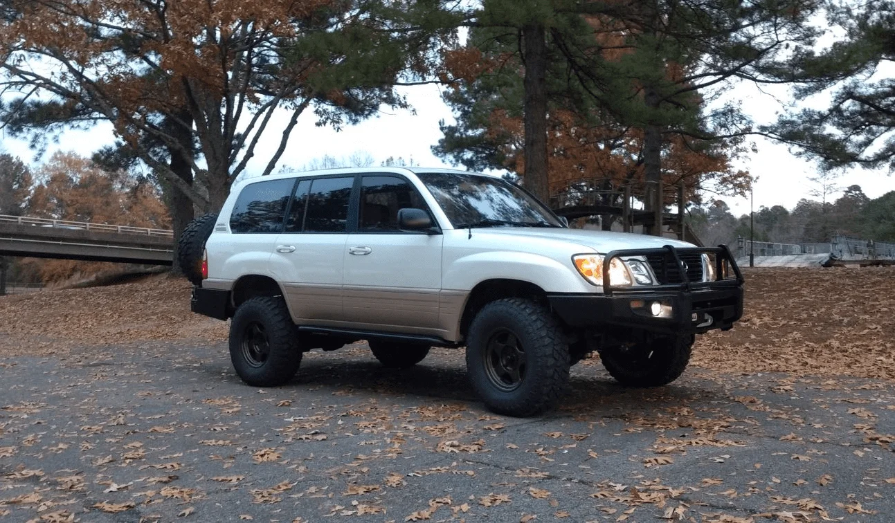

Really like this lift and stance. I'd like to do something similar wit my 99 TLC. I'm talking to Jason @ Trail Tailor about getting a Tough Dog lift (2-2.25 inches above stock height). I'd like to run the SCS F5 16's like you have here. What amount of lift and what size tires are you running in these photos? Thanks! Jeff
285/75r16 Cooper ST Maxx with an OME 2" lift
285/75R16 Cooper MTP with an OME 2" lift front, Dobinsons shocks and springs in the rear. SPC uppers at the +1 position. No rubbing.

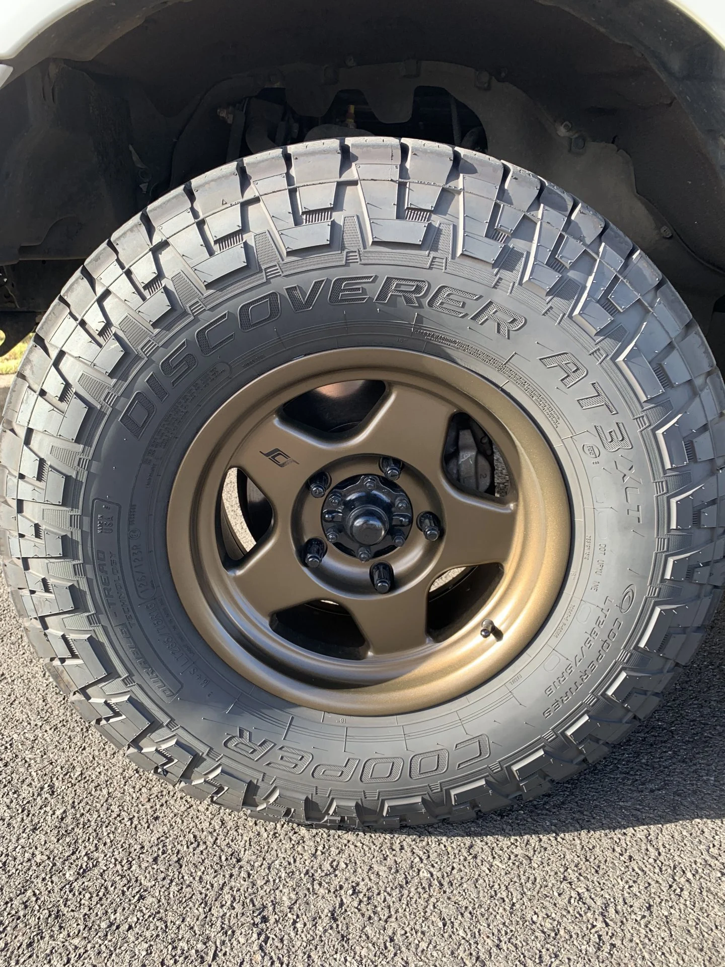

Question for those who have done some offroading with their F5's on stock suspension....
I had mine put on a few weeks ago, and managed to get rid of most of the rubbing by trimming the fender liner and hammering pinch welds.
I'm a little nervous about how this setup will do offroad, from a rubbing standpoint....especially when articulated quite a bit.
I'm curious to hear from people who have done this, on stock suspension and 285 75 16 tires. Is the rubbing excessive when articulated / under compression....or not so bad?

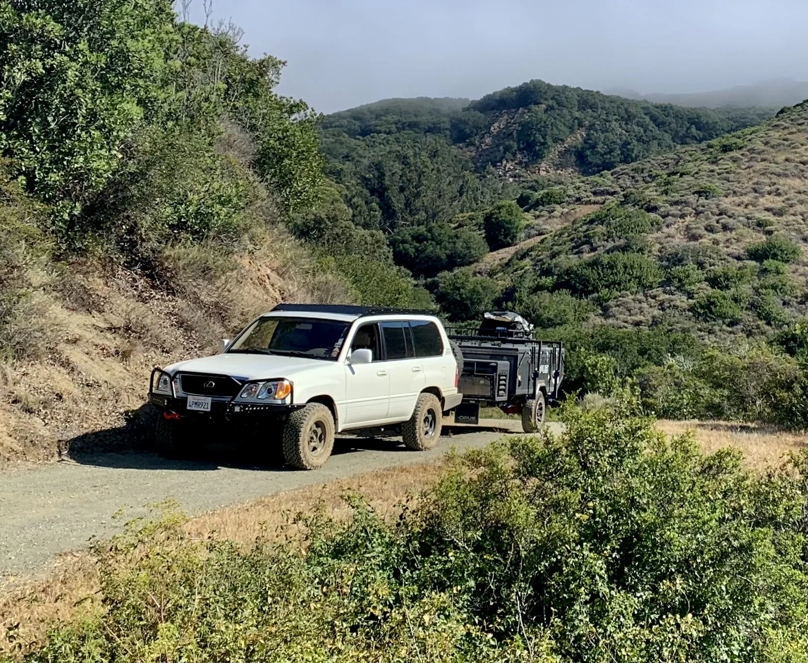

2.5" lift 285/75/16
Works for me😎
