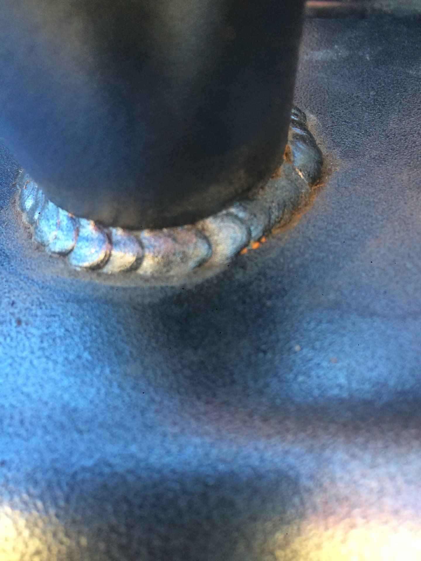

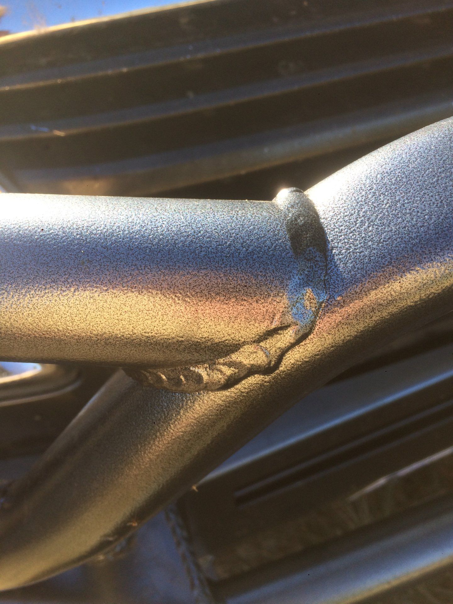

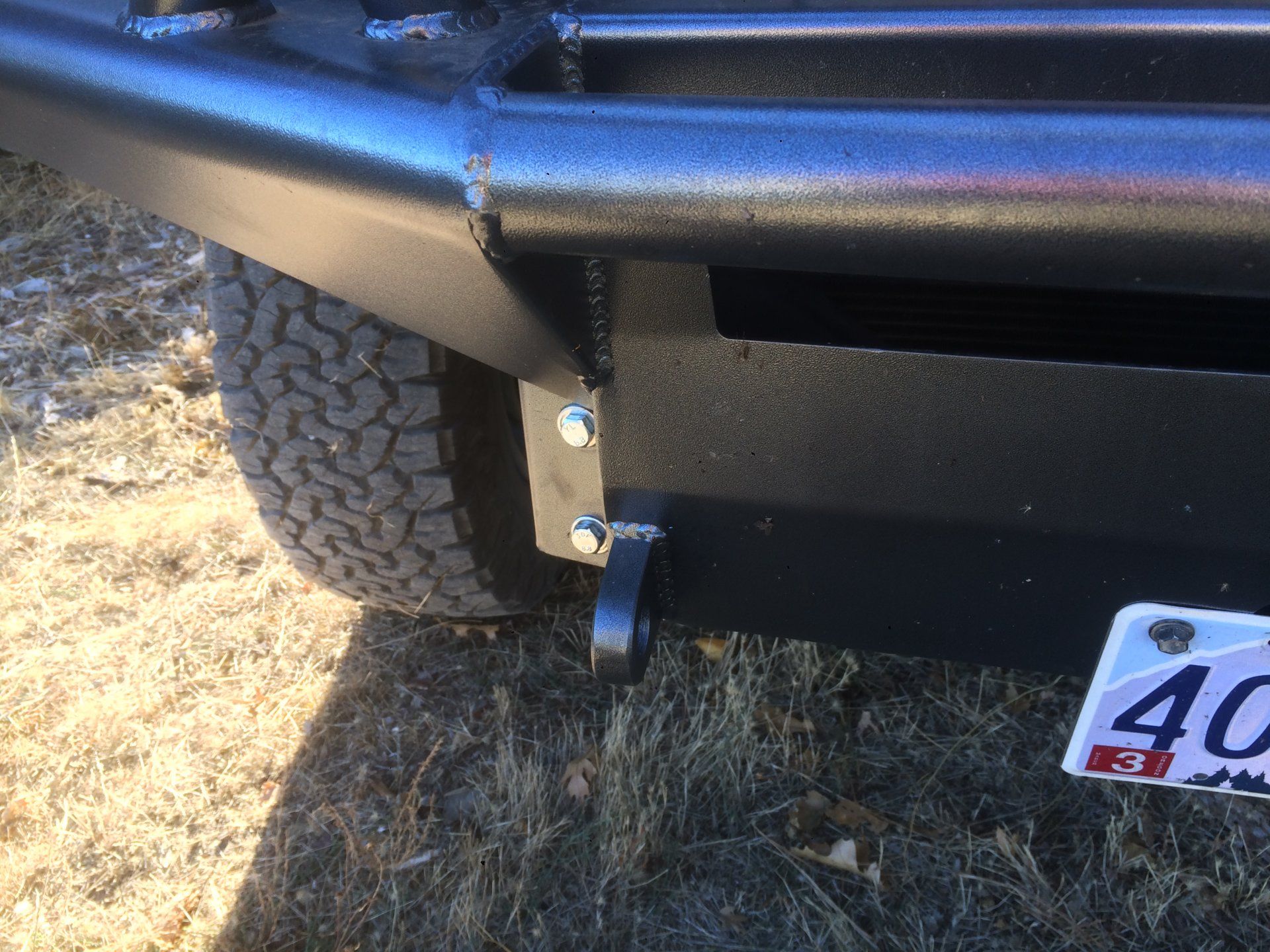

Also, I'd like to see some pictures of the welds you are saying are so horrible. If you're going to blast someone's reputation on their quality of work you really need to back it up with proof. I've seen numerous examples of his shop's welding and they're some of the best examples I've seen. (and I used to inspect welds on submarines)
Maybe you'll notice some otherwise un-noted imperfections:
On the photos with the license plate, compare left and right sides....see any difference?
Notice the receiver hitch....no powder in there!
Already beginning to rust in places, when we've received about .10" of rain thus far, since install.
I've really seen much better welds on Taiwanese bike frames. That's all, on this topic. I will update about future progress with Delta!
View attachment 1812113 View attachment 1812117 View attachment 1812119 View attachment 1812121 View attachment 1812123
1. The welds could be better. I'd grade them about average. Nice puddled weld lines for the most part, but some not-so-nice in a few places. It's not Dissent's welding porn, but it's not "Glorious People's Chinese Bike Factory #7" quality, either. It should match side-to-side, agreed. Looks like the weld was ground down on one side, and should have been ground on both.... I bought a bumper from another popular fabricator (not Dissent or 4x4Labs) who is here on MUD, whom I don't want to name, because I don't want this to sound like a complaint, because it isn't. The welds are about equivalent. On my bumper, not art, but functional, strong, and workmanlike. Took a little cleanup on my part to make my bumper really look great, though.
2. The powder coat didn't adhere to some of the welds real well. Probably from some contamination from the mig welding process. I'd say yeah, you have something to complain about there. Definitely would ask for a refund on the powder cost, if it were me. That is why I get my stuff in bare steel, and handle prep myself before painting or powder coating. I painted my bumper, because I intended to use it to.. bump into stuff.
3. No point in powder coating the receiver. Zero. The powder coat will get worn off immediately, and it can interfere with the fit of the hitch coupler. The receiver will get a coat of rust about ten minutes after the first time you use it.
Man, looking at my new dissent bumper compared to this, i wouldn't be happy. Shoot, comparing this to a chinese TJM, the TJM still looks better. Sorry that you have to go through this. Just return it and move on.
Most of those welds look cold. The hitch receiver top weld is stitched which is unacceptable. Hard to believe that came from their shop... I'm surprised. They definitely need a new production welder.
