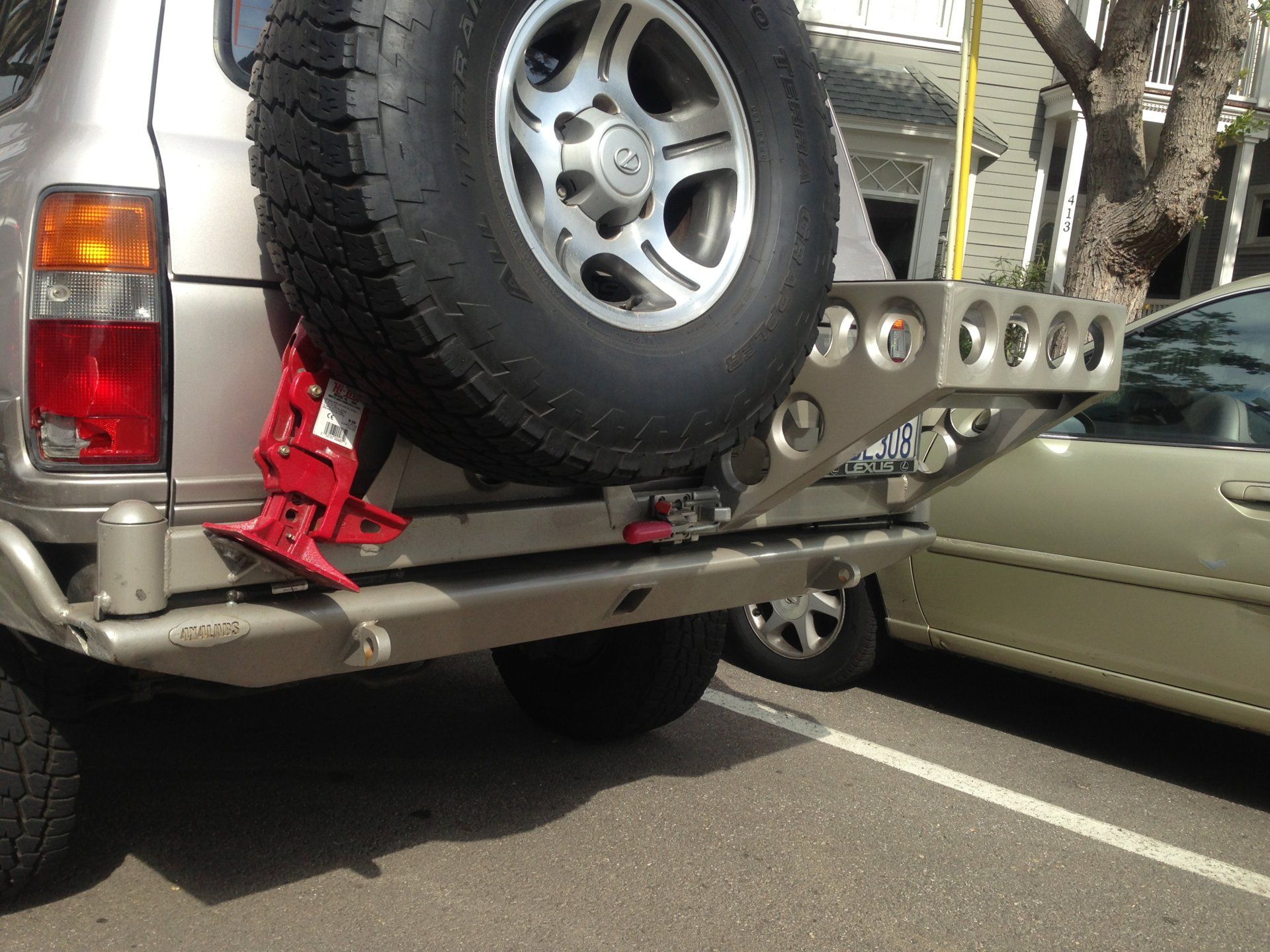

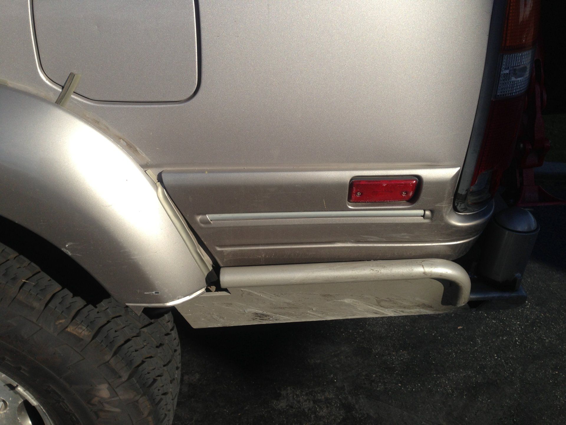

I purchased the 4x4 Labs bumper (no swing outs) several years back as a DIY weld kit. It's been a great bumper and held up to a side hit when this car ran the red light. The collision spun me around 180 deg.

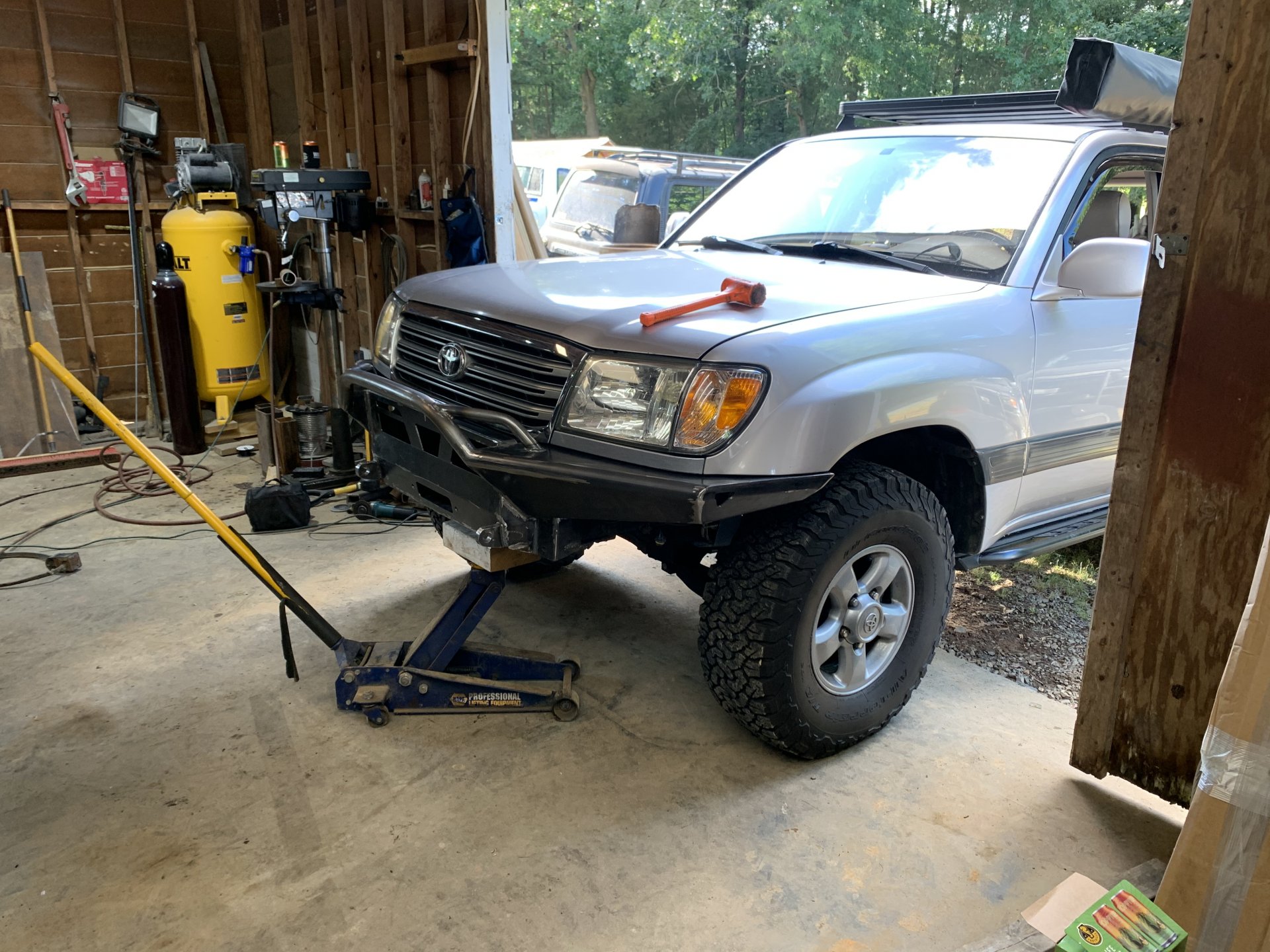

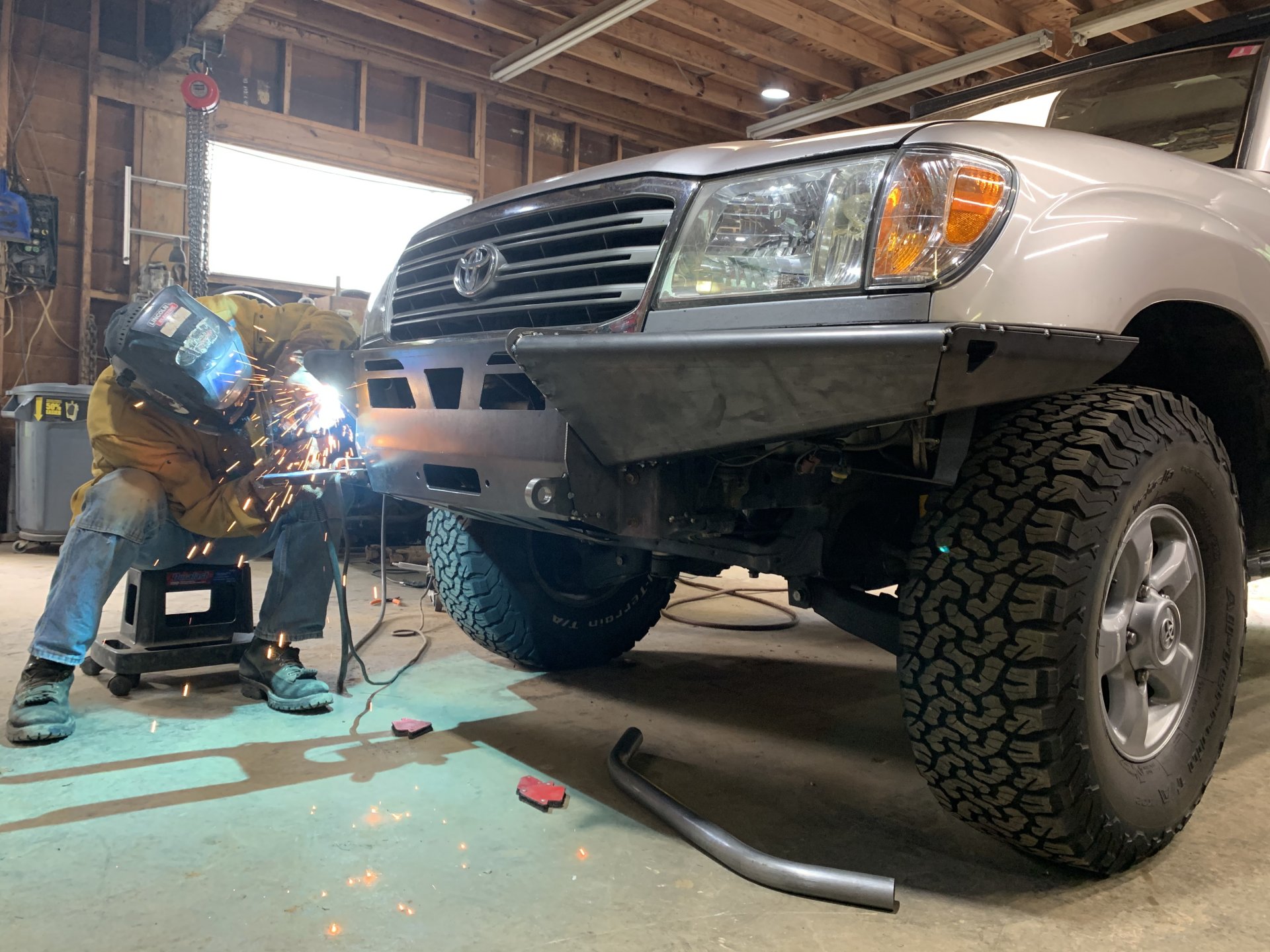

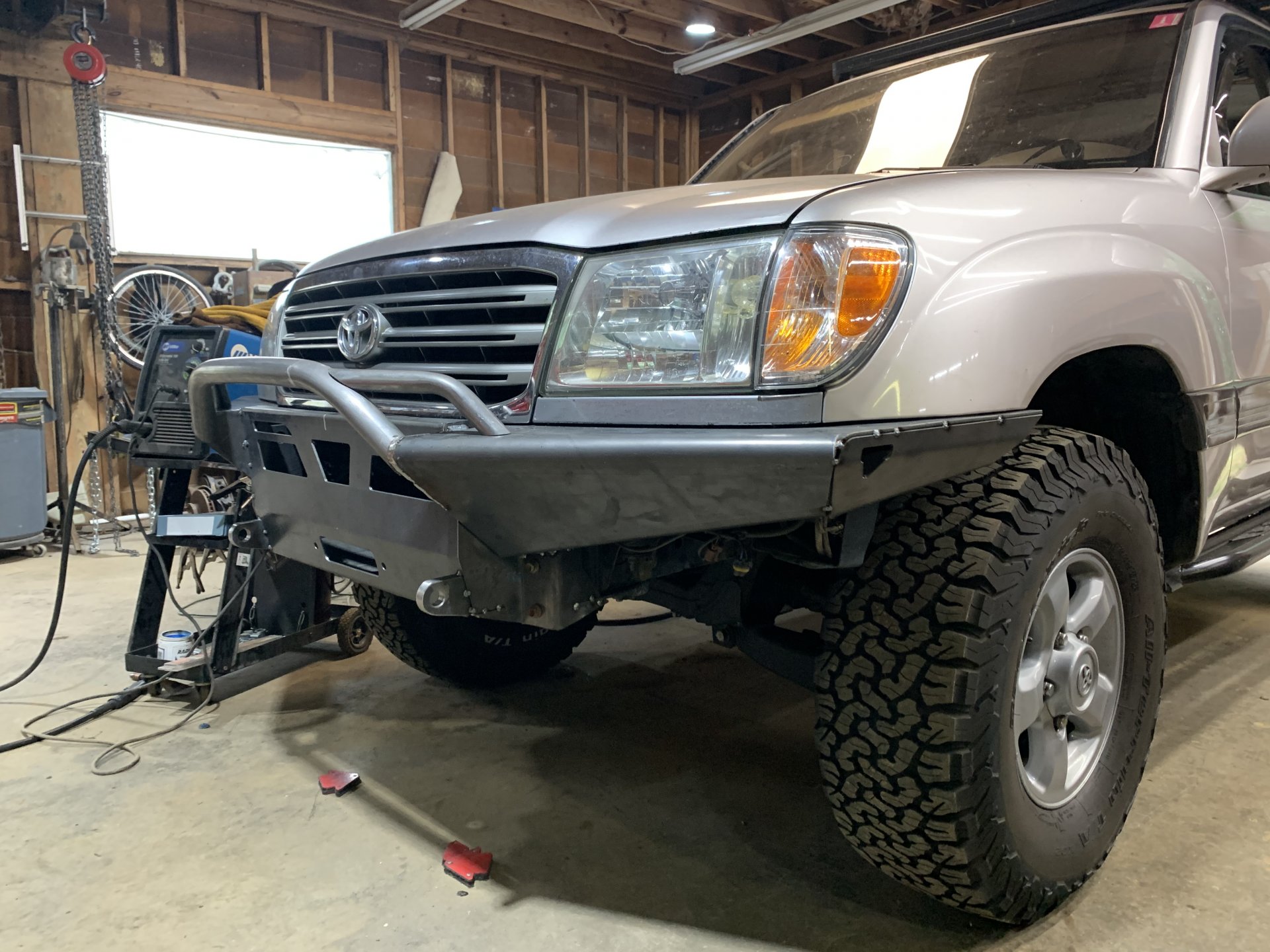

Can't find many 4x4labs front bumper build threads for the 100s. We started welding/installing the kit last night and are very unhappy with the quality and fitment of the kit. So far, the front skid plate does not reach the bottom crossmember and the side wings are going to take some serious modification if I want them to line up with the body lines and not have an inch of gap between bumper and body. Also extremely disappointed there are no instructions and Labs has not taken the time to at least do a build thread.
So far, it's a PITA. I have always been a fan of the Labs bumpers I have seen on the 80s in my club and could not wait to have one of my own. I'm wondering if quality has gone down over the last year or so. I'm really wishing I had gone with Slee at this point.
So far, it's a PINA. I have always been a fan of the Labs bumpers I have seen on the 80s in my club and could not wait to have one of my own. I'm wondering if quality has gone down over the last year or so. I'm really wishing I had gone with Slee at this point.
I'm working on the front bumper currently (things are about to get tacked together, and then started on the wings).. I really haven't had much fitment issues yet, however the front OEM brackets on the frame (the ones that the horizontal bolts connect to) have a lot to do with the crossmember lining up well. Mine are completely tweaked because of a few front end bumps, so I had to straighten them out quite a bit to get things to line up. Also, make sure that the plate that connects to the front diff guard is bolted on loosely, and then pressure things into place from the top/forward.
I'll take some photos of mine and perhaps start a thread here, as I also noticed nobody has really done a detailed writeup on it yet.
We finally got it on, but it was not fun. There was no way to get the wings to line up with the top of the winch housing, so we had to drop them down and cut off the excess. Had we lined the wings up with the lines of the winch housing, there would have been over a 1" gap between the bumper and the lines of the truck.
To get the wings under the grill, headlights, and fender required LOTS of trimming. Lots of cutting, grinding, and trial and error.
In addition, we had to fabricate an extension plate to get the bottom of the skid plate to bolt to the lower crossmember. There was just no way that skidplate was going to reach the crossmember with the winch mount plate installed.
The whole process would have been easier from the beginning had Labs provided instructions/guidance or some YouTube videos. While I'm sure they're great guys, it does leave a bad taste in your mouth, when things aren't lining up and you're having to figure it out on your own. Had everything lined up properly, then I'm sure assembly would have been more straightforward. To offer a product that requires assembly and not provide instructions, is either laziness or arrogance in my opinion.
Also, I say "we", but @AJR did the lion share of the work and ALL of the welding. In the end, he did a great job and I am happy with the results despite the initial setbacks.
Now I'm waiting on the paint to cure. Looking forward to getting it back on the truck later this week.
