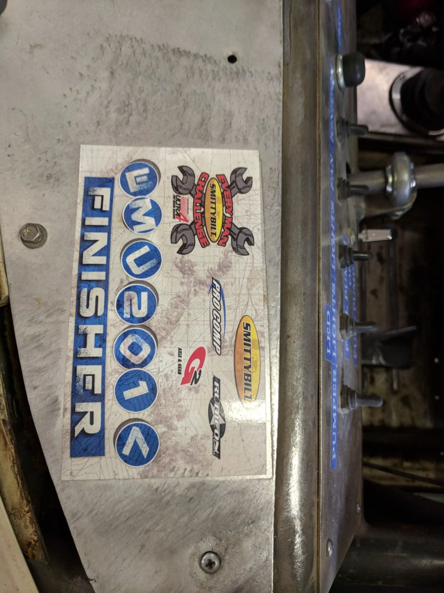

And that concluded the racing segment of the 2018 Every Man Challenge for the 4508 Land Cruiser!
