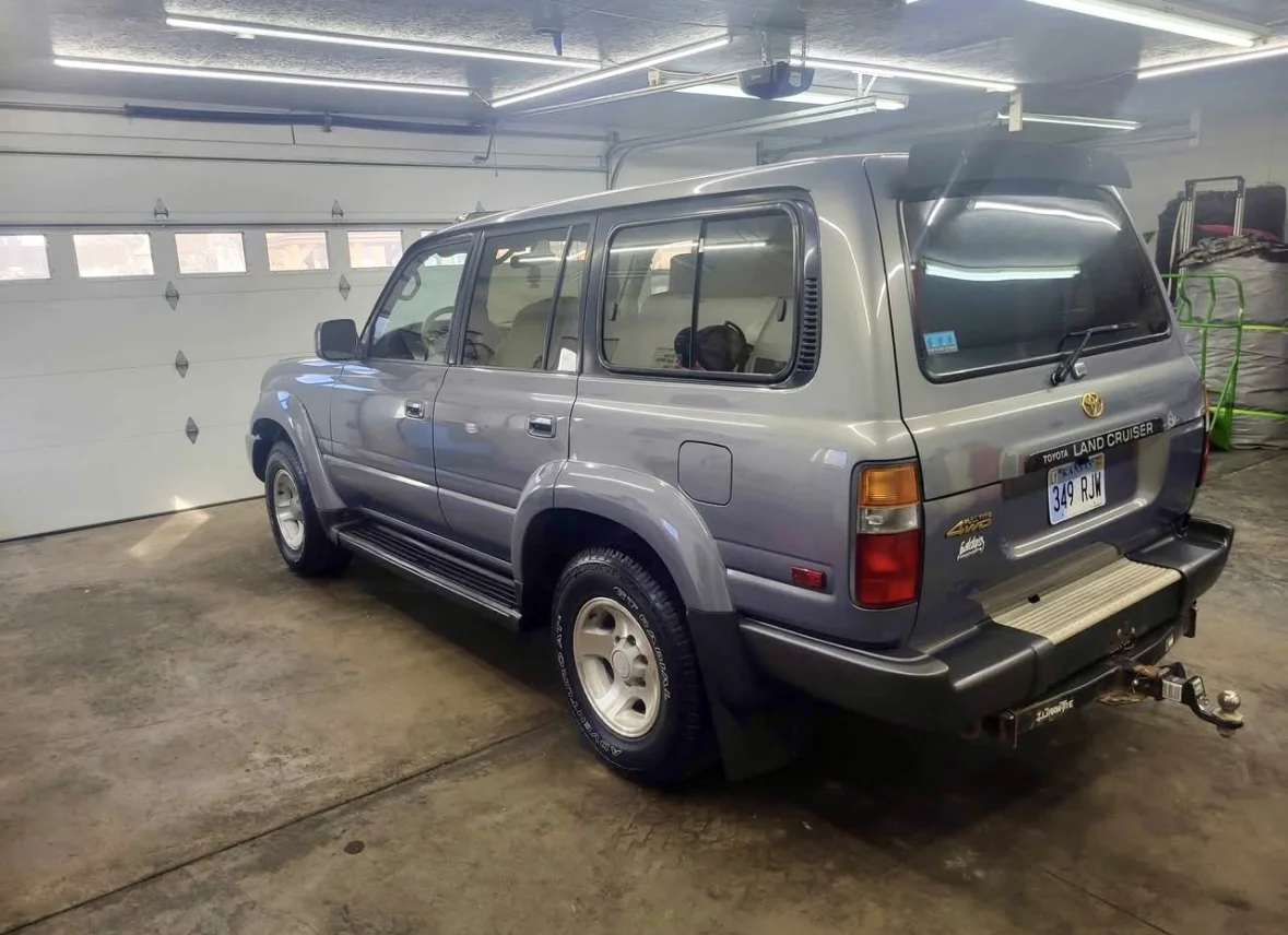

Here she is, as purchased. A clean 1997 with only 311,000 miles!

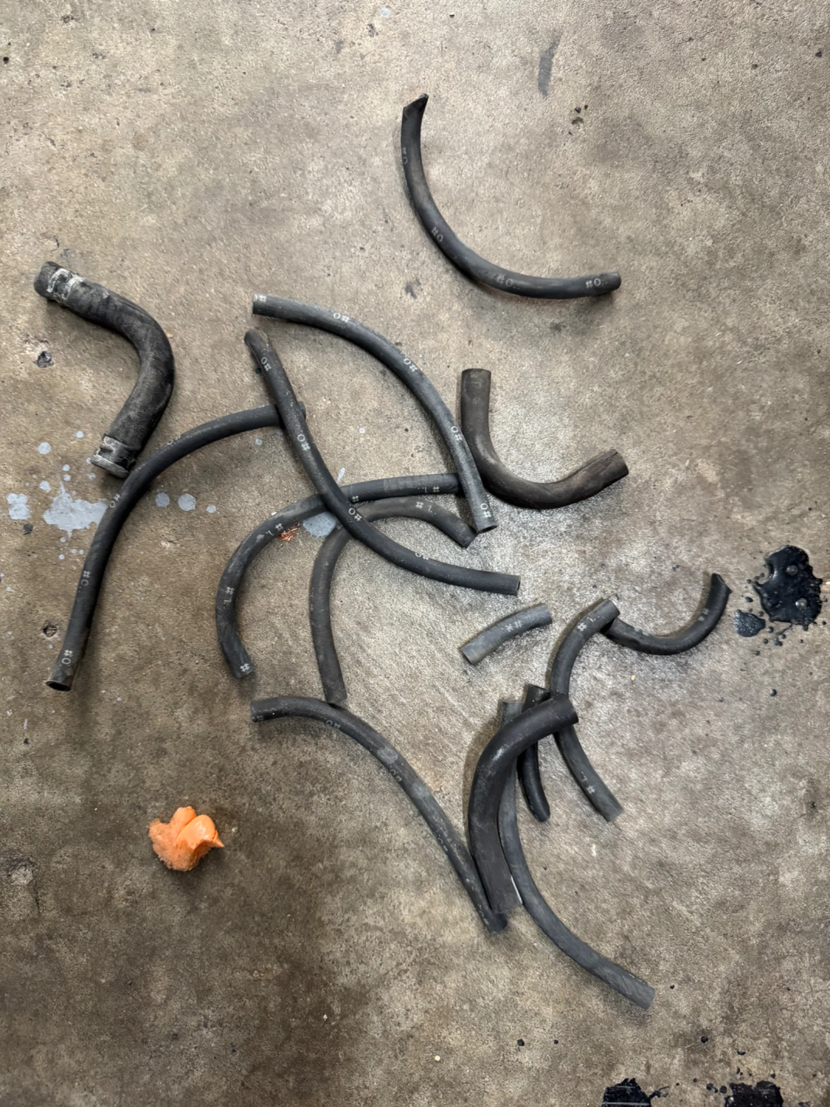

I replaced every vacuum line on the engine with new silicone and it was fixed!

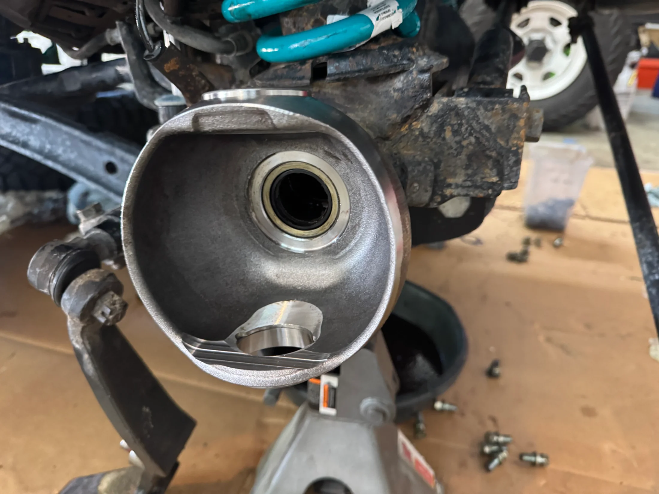

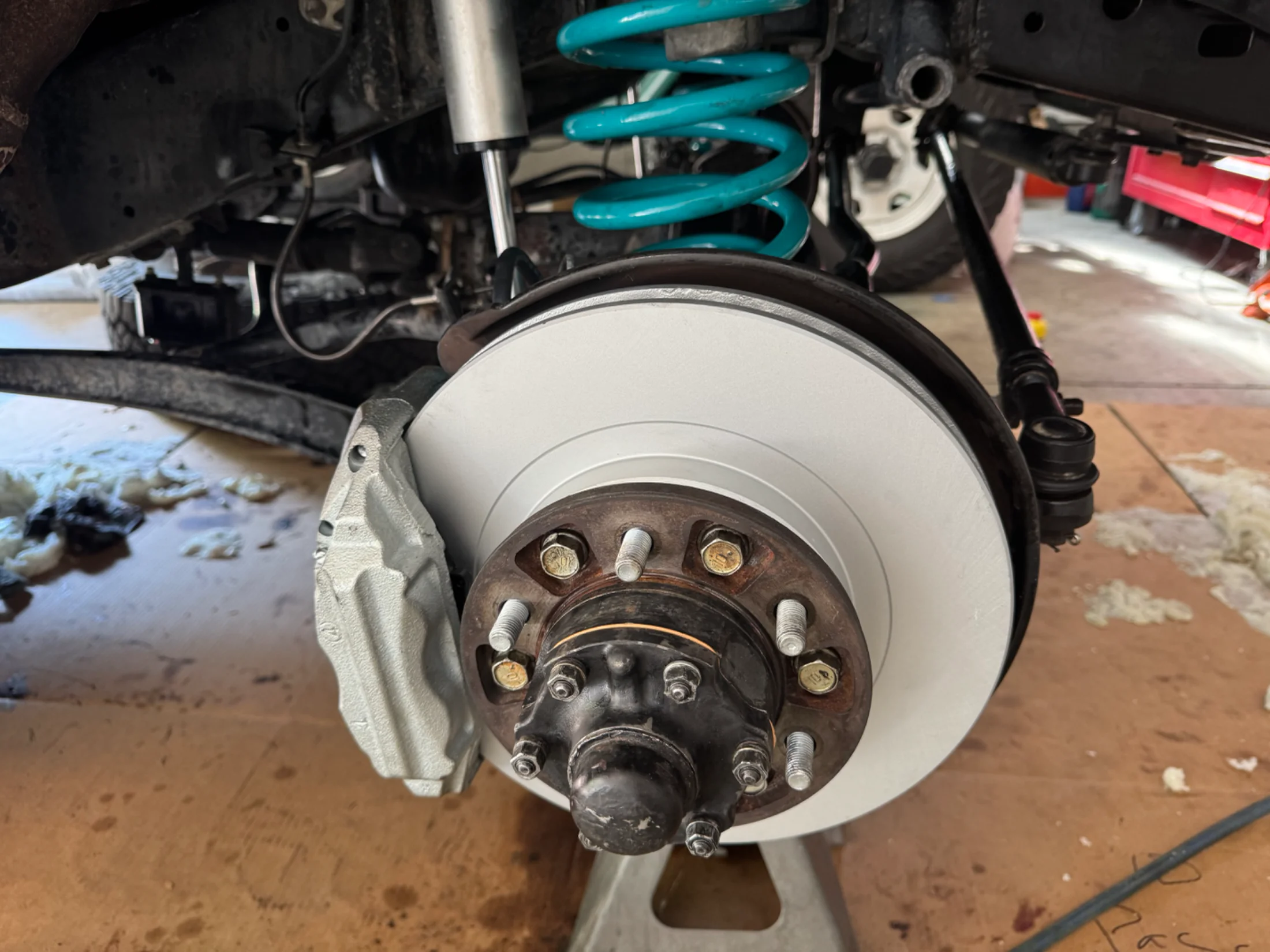

I rebuilt the front axle with parts from @cruiseroutfit and new OEM calipers and brake lines. Also added extended stainless lines from body to axle. Of course I struggled getting the system bled!
Ended up using posts on here to figure out how to activate the ABS module and that allowed me to get a good firm pedal back.

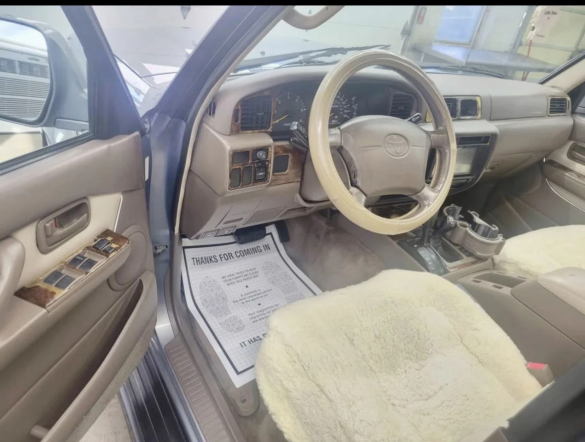

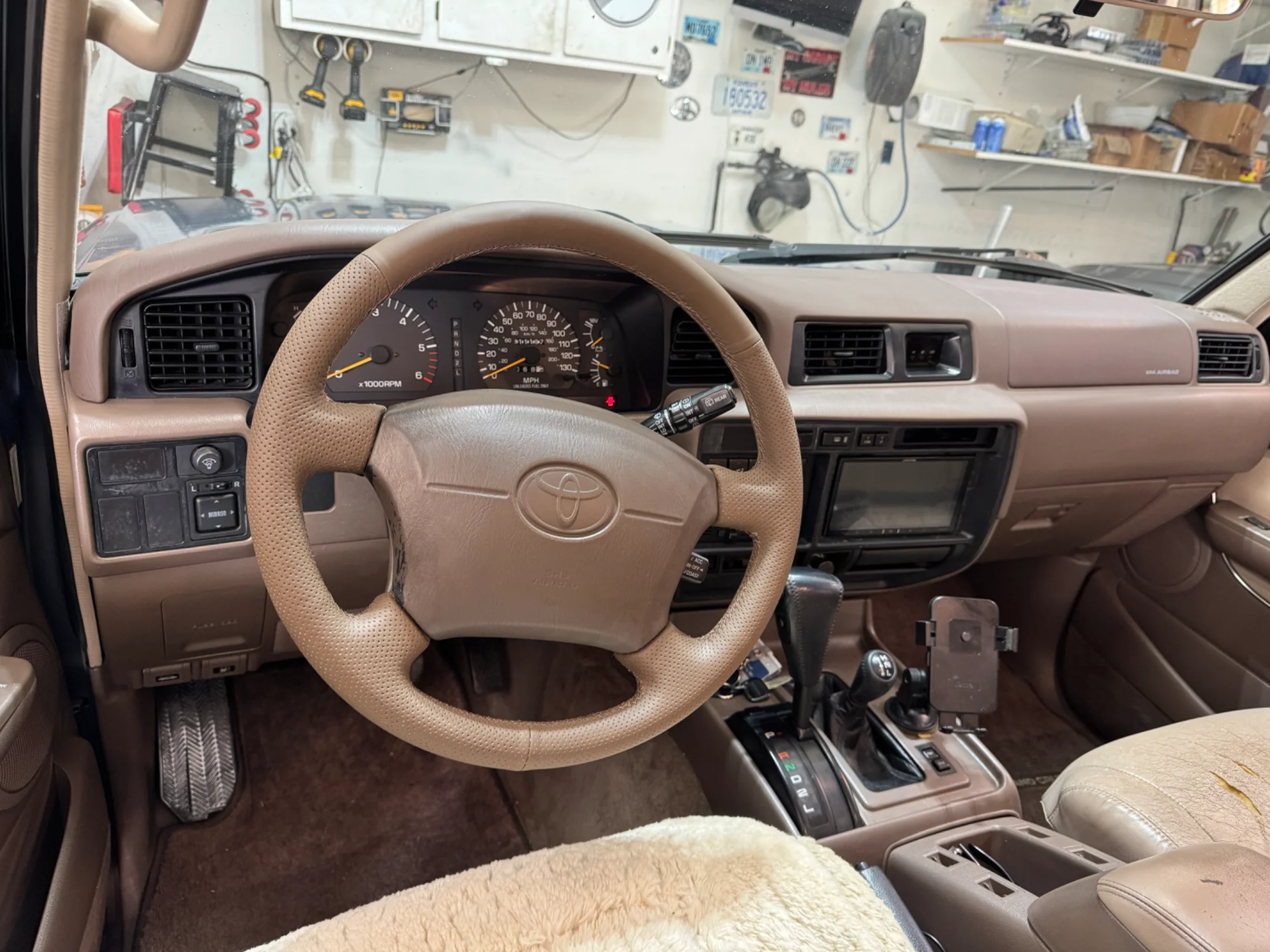

Like most of them at this point, this old cruiser had the typical trashed leather and the wood veneer on the dash was crumbling/flaking. I pulled all the old veneer off and installed a leather Loncky steering wheel cover.
I added a little bit more sound deadening mat from Spectrum in the doors and rear quarters. Also added foam between the door panels and the doors.

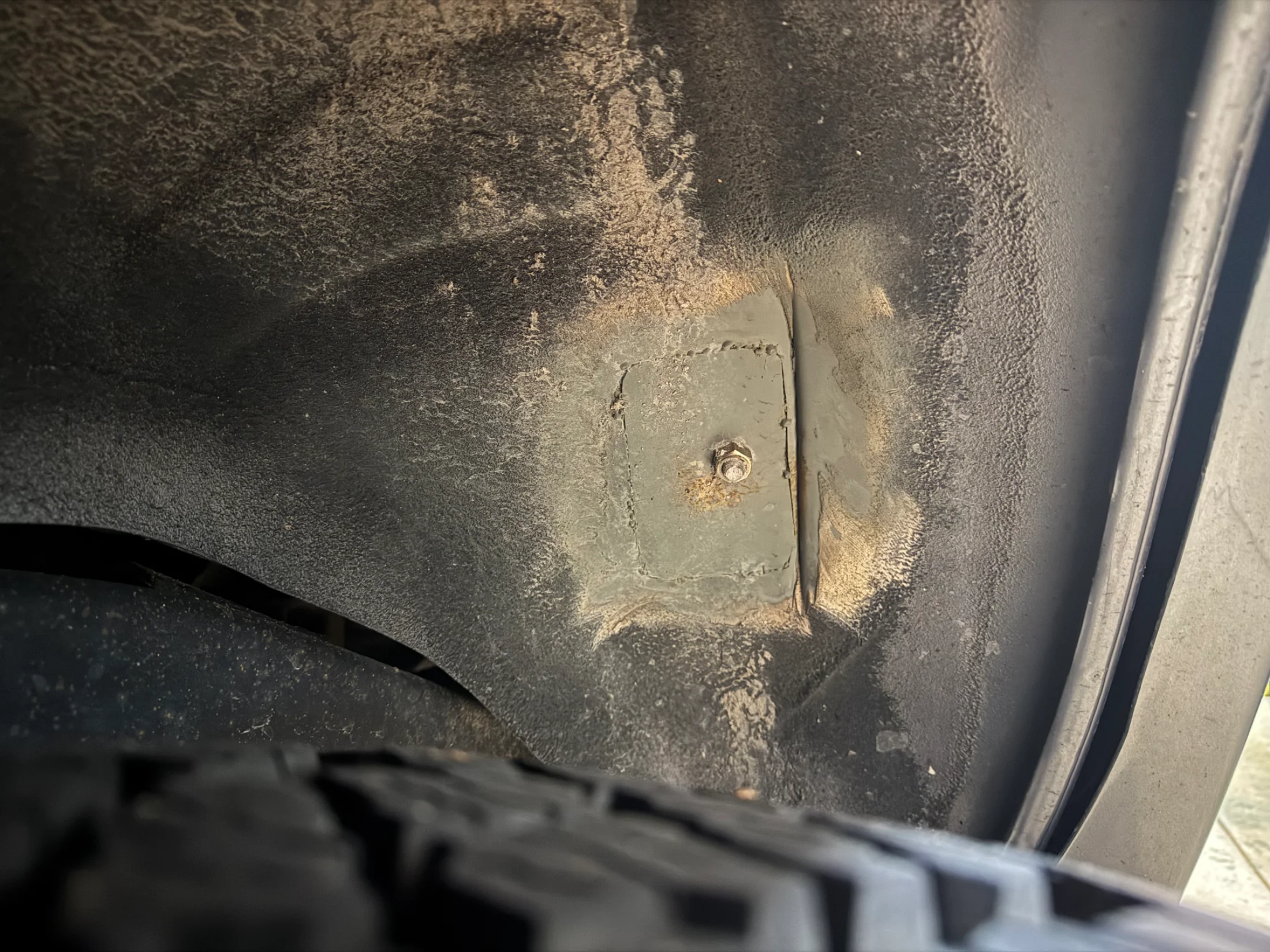

I gave the whole interior a deep clean. Pulled out the seats, carpet and trim. Scrubbed and steam cleaned the carpet extensively. It was in great condition with only a few stains. I did find the very common rust around the rear seat belt mounts but it was easy to cut out and weld in new 16g steel.
The PO had installed an Alpine double DIN Bluetooth head unit, so I built on that with new speakers in all 4 doors hidden behind the factory speaker grills. That sounded pretty good, but it needed a little more bass, so I built a little sub around an 8" woofer and parked it in the factory location.

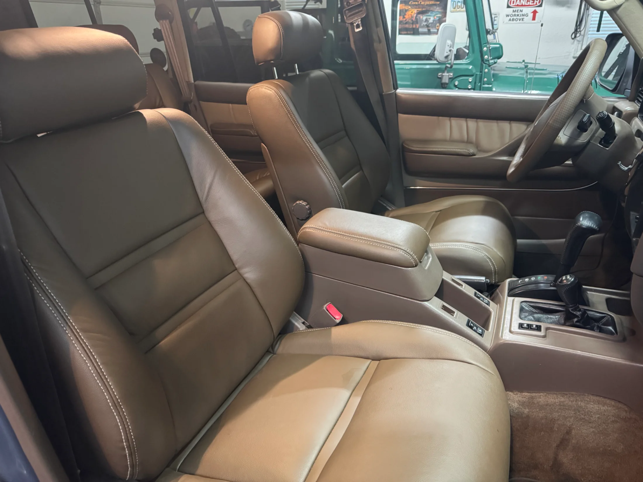

The big improvement was the new leather kit from @FJ60Cam. I ordered the dark leather from him and added heated seats via the JDM switches that go in the console. This was the thing that transformed the rig into a nice ride!

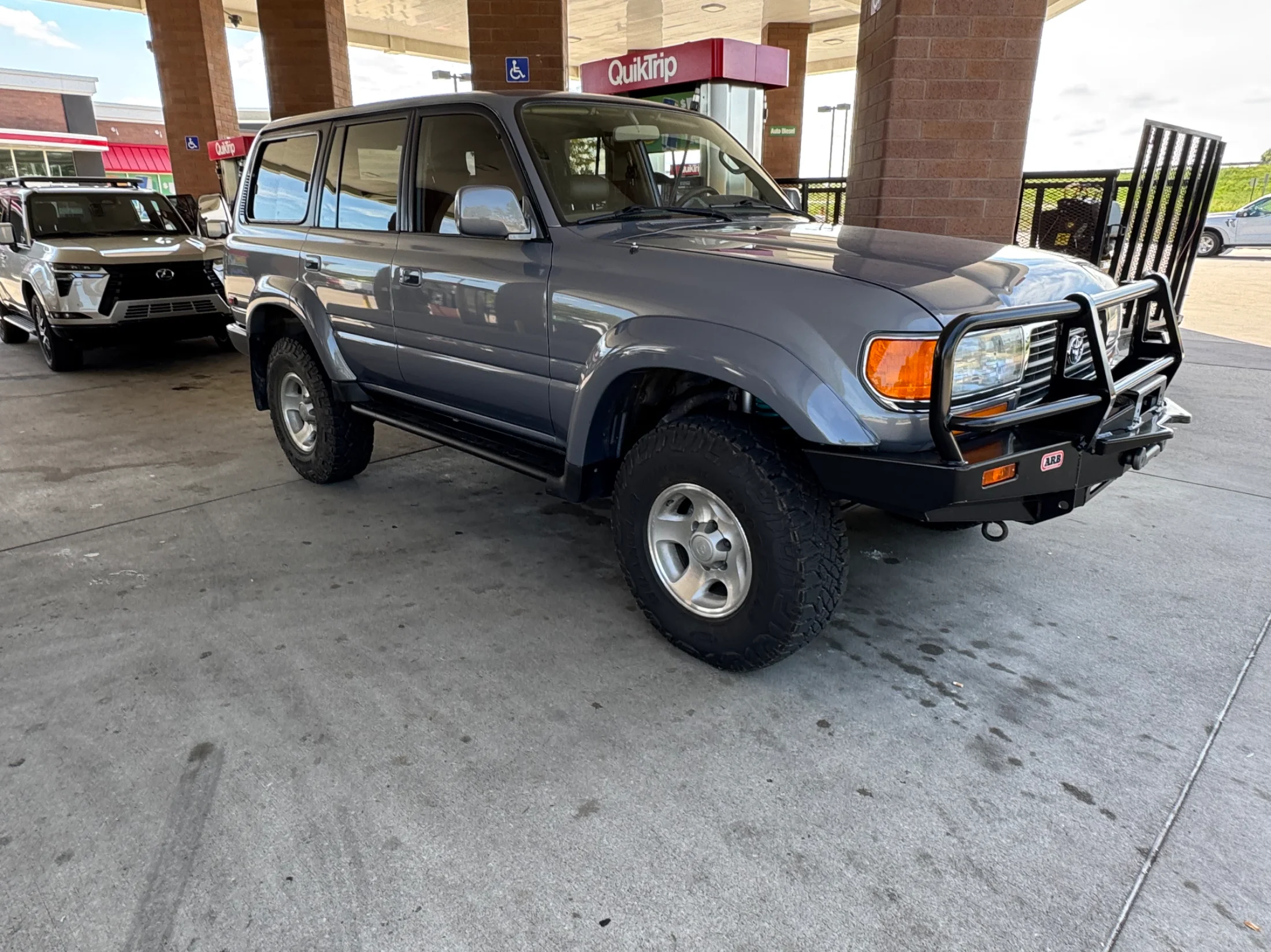

Of course, I had to turn the exterior from its existing Mom-car to something with a potential for offroad use. I kept the OEM wheels but went up a size to 285 75 16 Goodyear Wranglers at a nice discount thanks to @Flatlanderfj40 !
To make room for the bigger tires, I picked up Dobinson dual rate springs and Icon shocks. After a little back and forth, I ended up with a 30mm spacer on the driver rear corner and 20mm spacers in the front and now I like the way it sits and the ride is NICE!

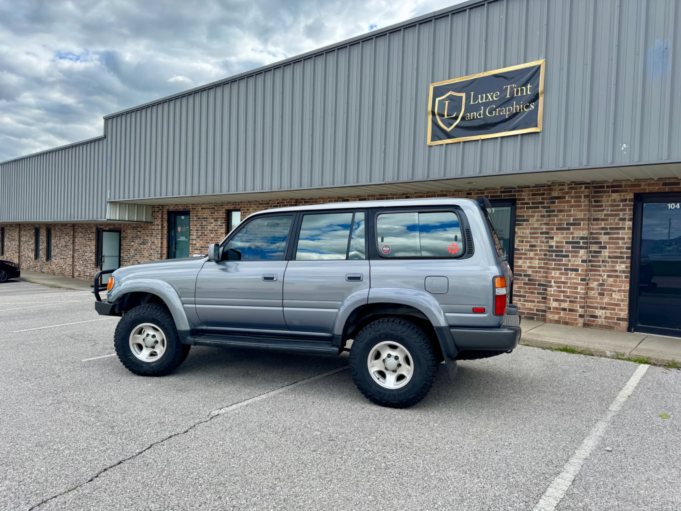

I had a local shop do 35% tint film all the way around to try to keep this fishbowl a little cooler.
I also added an ARB bumper and a Comeup 9.5 Seal RS winch for a classic look and some peace of mind when wheeling, and then a set of slider steps from @sleeoffroad . Makes it easy for the wife to get in and out, unlike the killer Metaltech sliders we had on my son's rig. They were angled and just too high for her to step up on.
What was the trick to removing the old veneer? I gotta get mine off, the look is atrocious.
Patience and a selection of plastic trim tools. Judicious application of Goof off.
