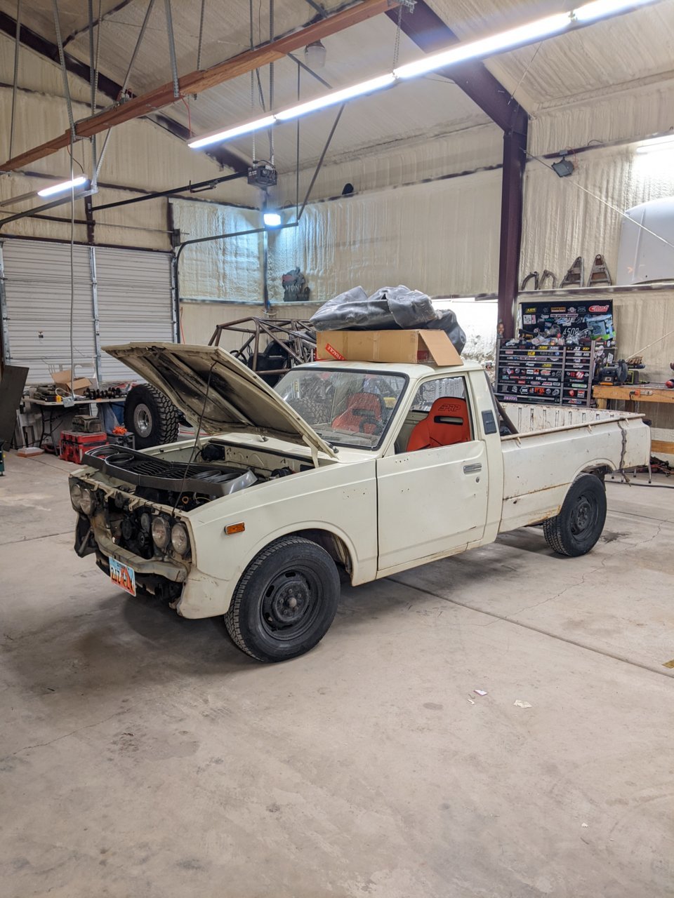

The buggy is a very slow project. My other project that I've spent more time on lately is a 1978 Hilux I bought last year for $300 with no engine, and swapped a 2JZ into behind a 6-speed manual out of a 350Z. If you want to read about that: Hilux - 550hp 2JZ 1978 Hilux Build - https://forum.ih8mud.com/threads/550hp-2jz-1978-hilux-build.1278258/
pxl_20230123_004323191-jpg.833568
And otherwise, I have some other Toyotas that are lesser of projects, but really the buggy is the follow on to the 80, and the Hilux is the parallel build with the buggy that is meant for the streets. Long answer to a short question :D
