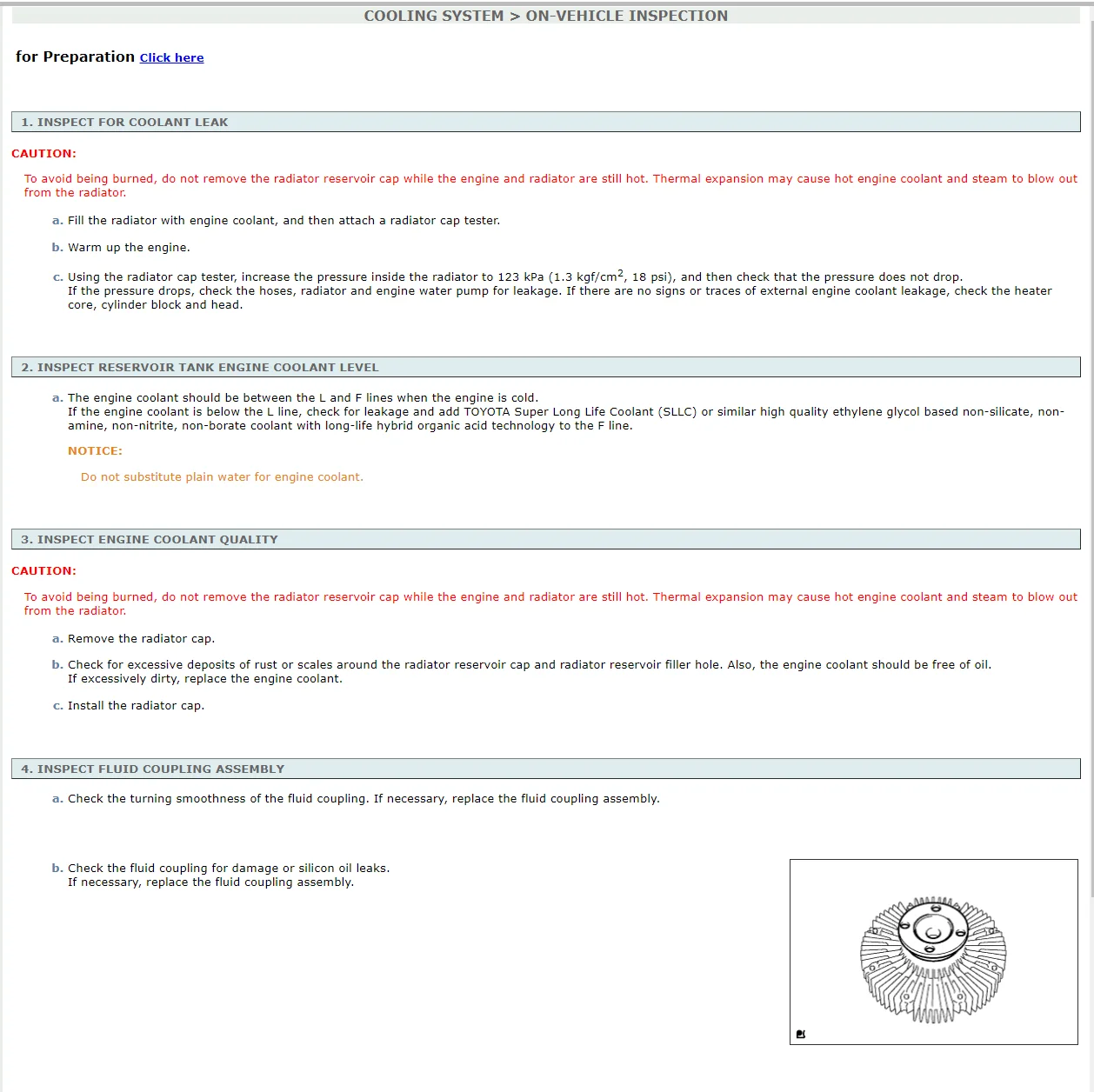

This is the FSM troubleshooting section for the 1UR-FE, I assume that's the engine you have.
Fair enough. The GSIC I have didn't show the 2UZ-FE so I don't have a doc specific to that engine. I would think it would be the same though.
