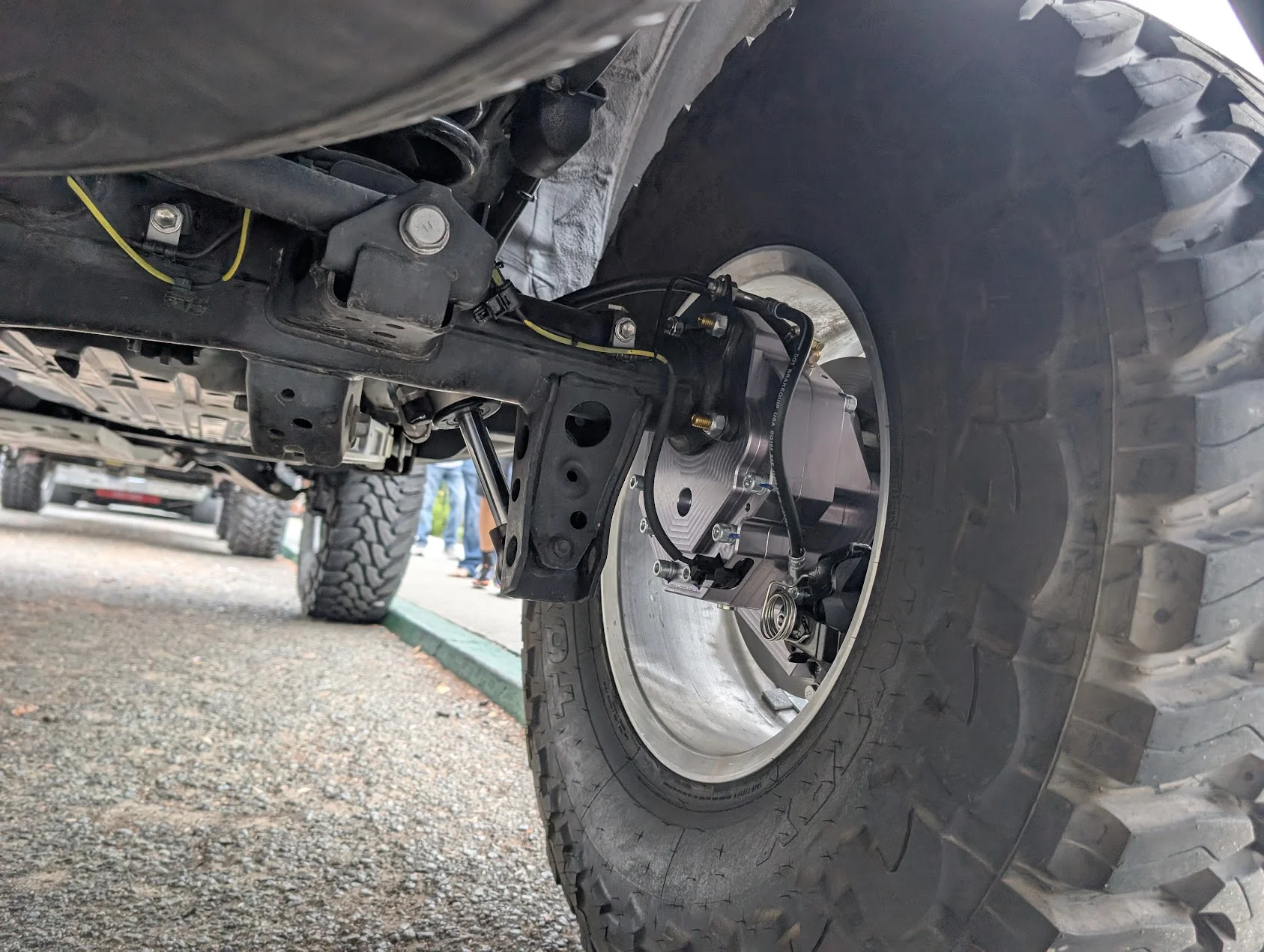

Definitely would want to beef up the rear axle flanges and rear suspension links / frame mounts.

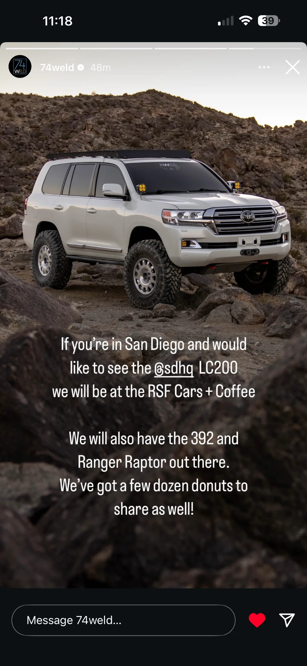

Heads up if you guys want to check out the truck they just posted on IG they’ll be at RsF cars and coffee Saturday morning @TeCKis300 @Boston Mangler

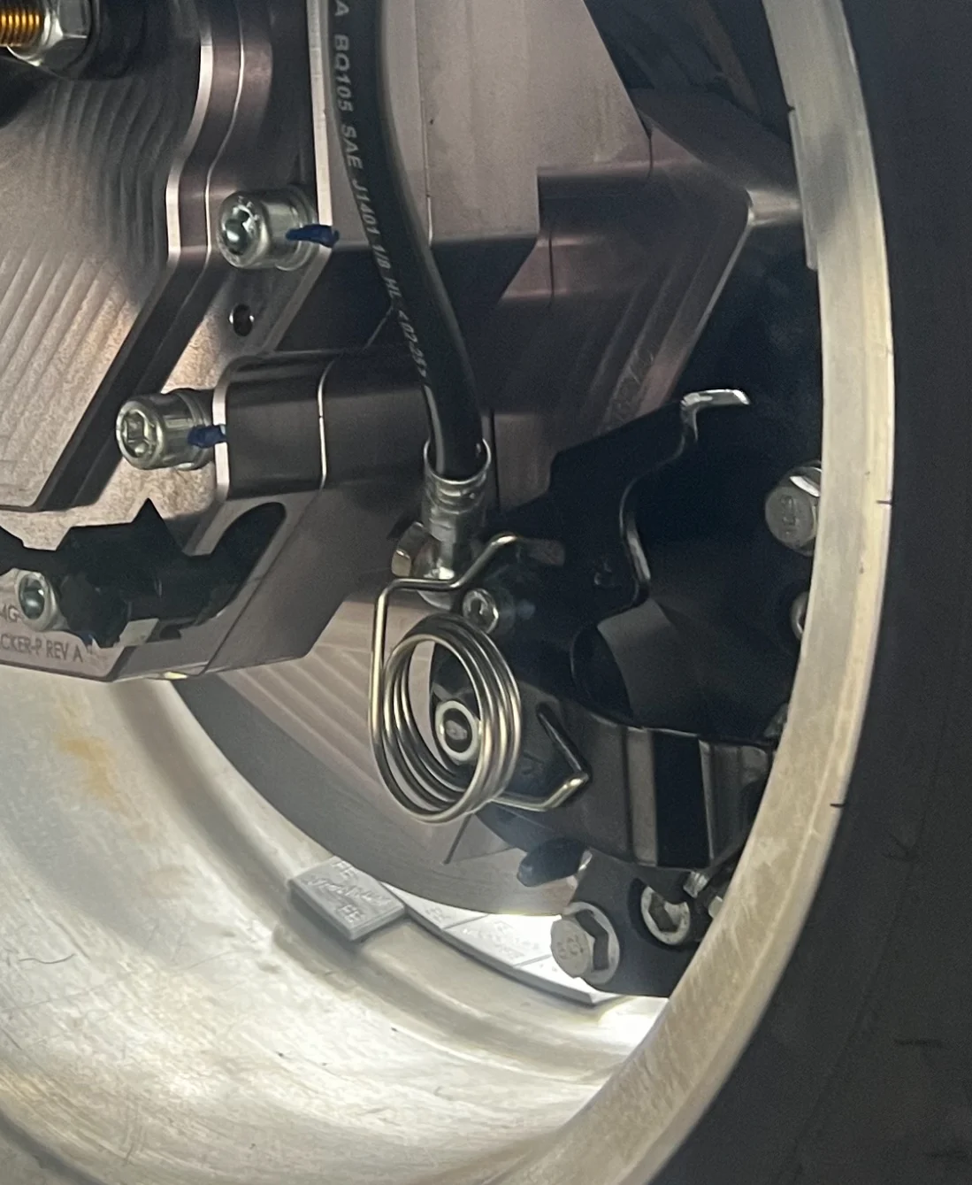

And for those that have done rear discs conversions on FJ40s or 60s and used the tried and true GM Monte Carlo caliper for the disc parking brake, you’ll notice something very familiar here:

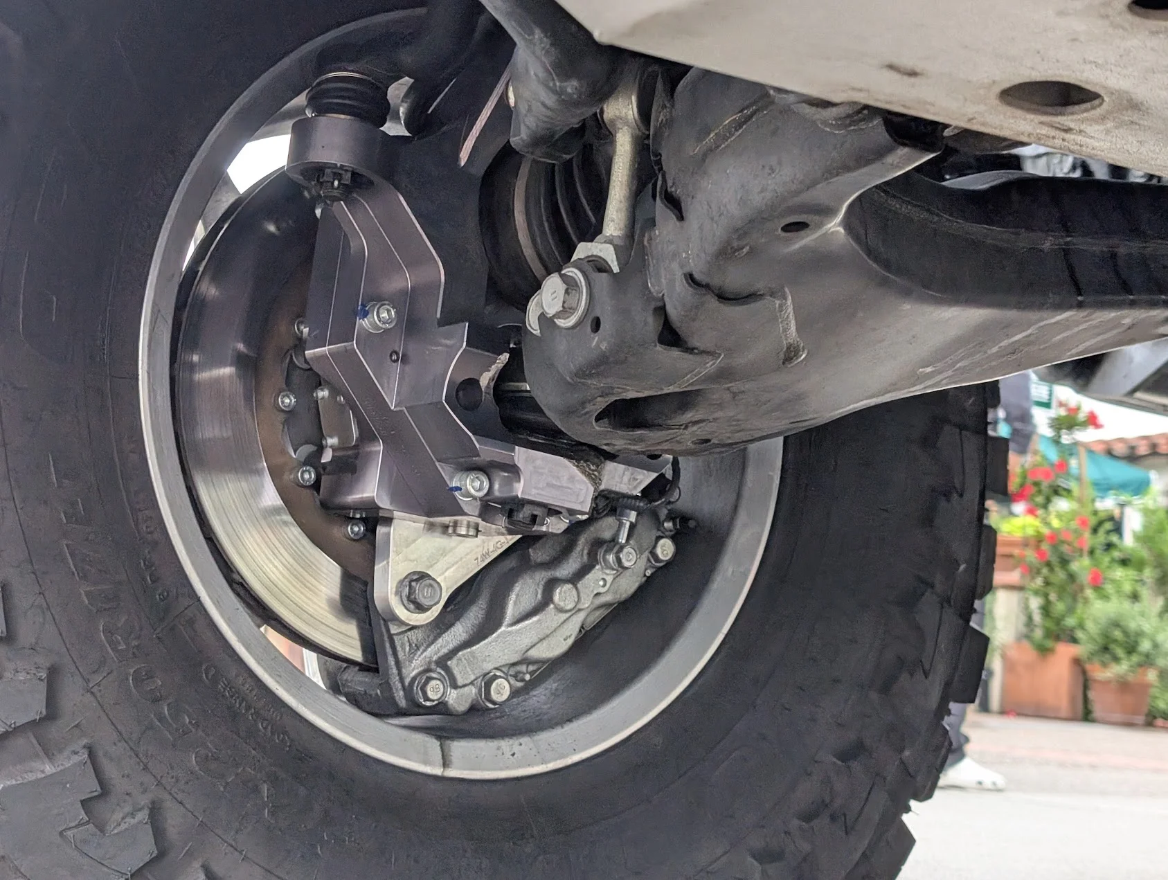

Some few pics I grabbed from the meet. Front brakes are re-using stock caliper with an upgraded rotor likely to accomodate hte 6 lug. Also looks to be a 2-piece rotor.
Rear brakes are an aftermarket Wilwood caliper and rotor.

No extra bracket / gusset on the rear 🫣🥴

Are the red circled bits part of the brake lines?
