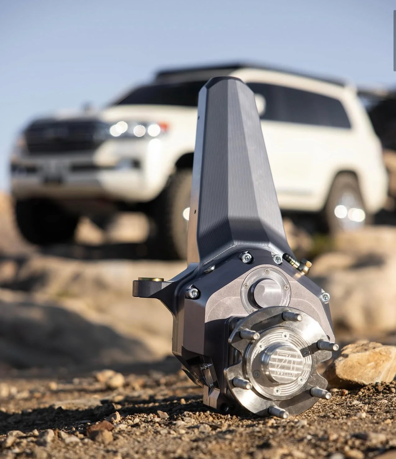

Full details tomorrow and more pics. We have been hounding 74Weld for the Ic200 for a while now and they delivered. As some of you know we here at Dissent offroad have been running and installing their portals on the new gen Toyotas for a while now and they are an absolute game changer. If we can answer any questions whatsoever or if you are interested in exploring portals for your Ic200 reach out to sales@dissentoffroad.com and we are happy help. Also feel free to start some discussion here and I will try and keep it updated.View attachment 3992456
Hey Ben, what are your thoughts on the optional rear gusset that 74w has provisioned? Do you guys fab them up when installing? Having so much leverage on those dinky rear hub bolts kinda weirds me out.
Yes. We fab our own on most of our installs but we are also working directly with 74Weld to maybe help manufacture some brace offerings.
74weld shared some more photos with me. Just needs some Dissent bumpers and it would be perfect 😉
