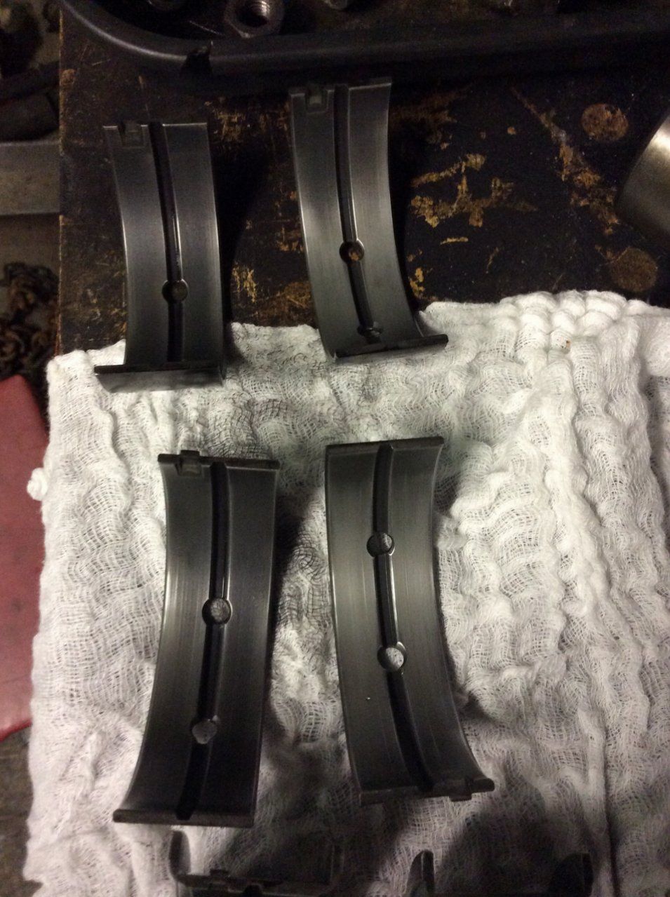

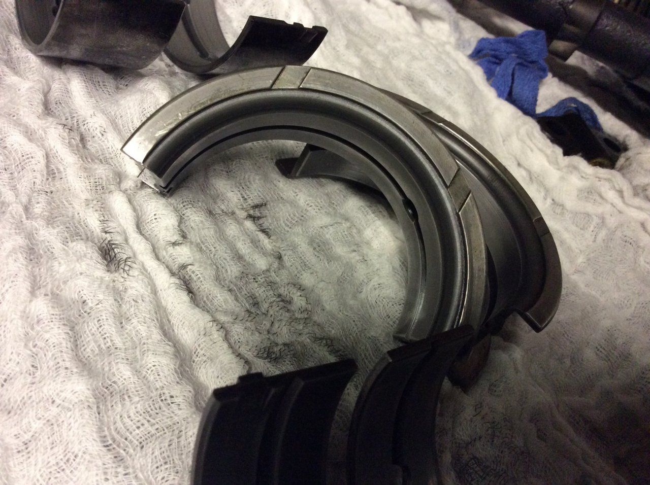

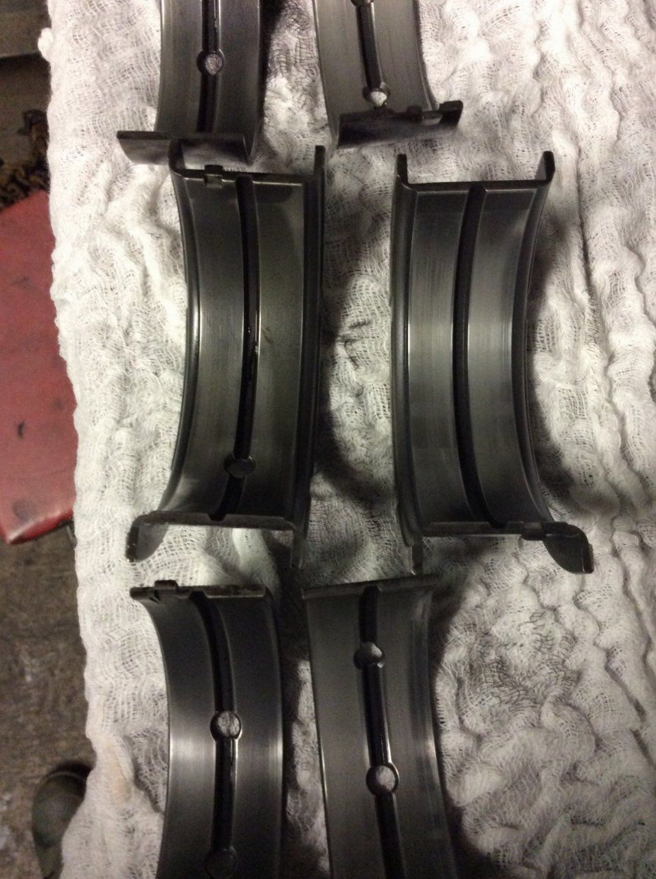

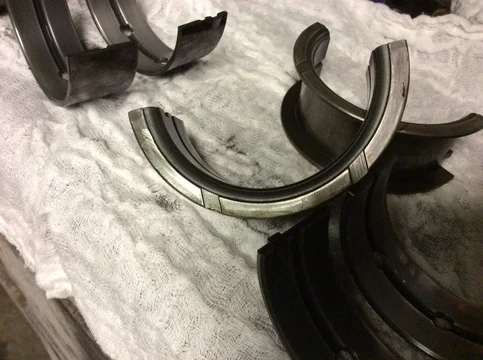

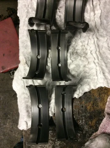

Just pulled the crank this morning. Fortunately the bearings are in great shape considering what happened, and no damage to anything else. Glad I shut it off right away. Now for for a good clean up, new crank and bearings and reassembly. If your wondering, the shaded areas on the bearings are what's left of the moly coating I had applied.

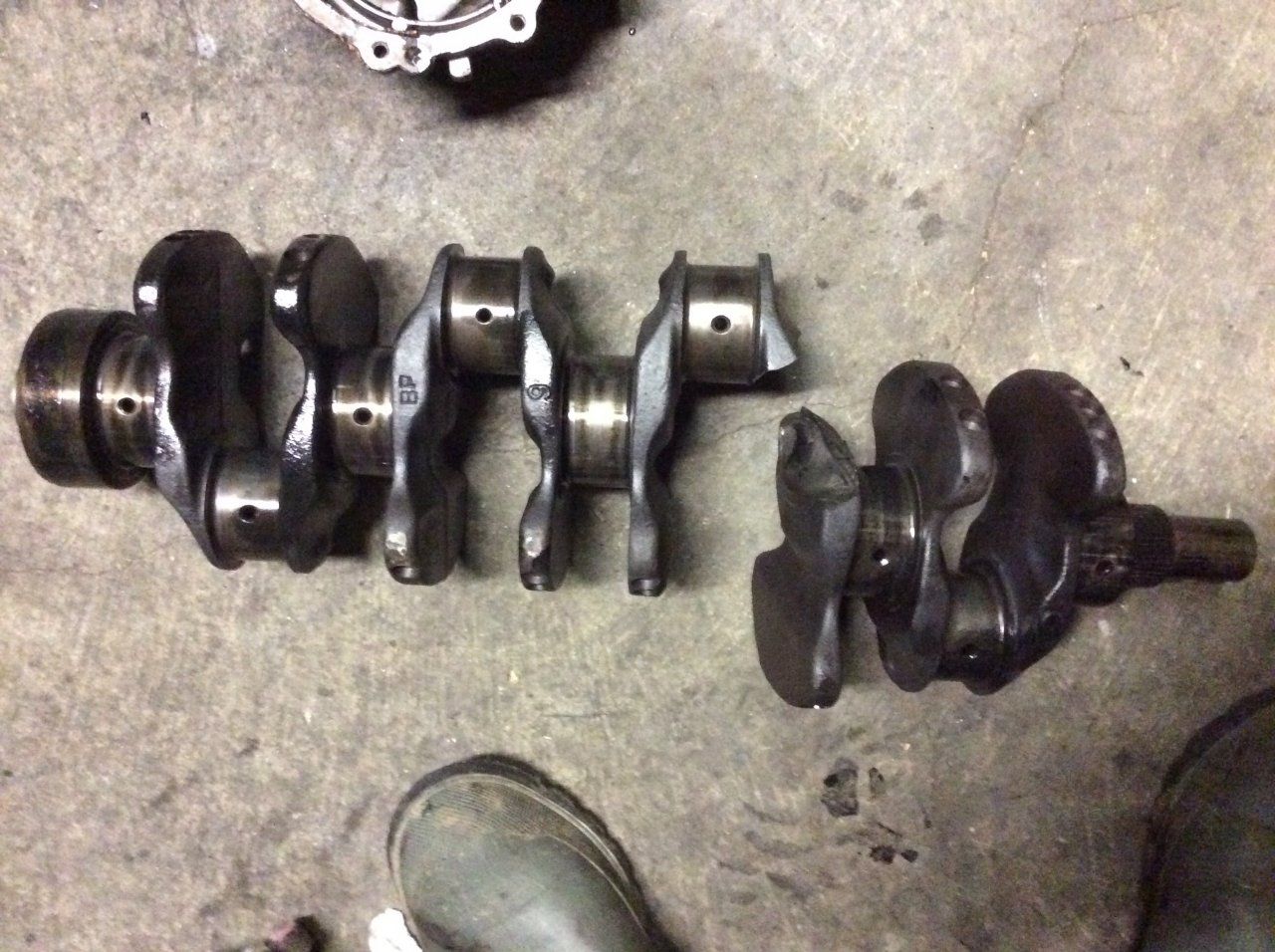

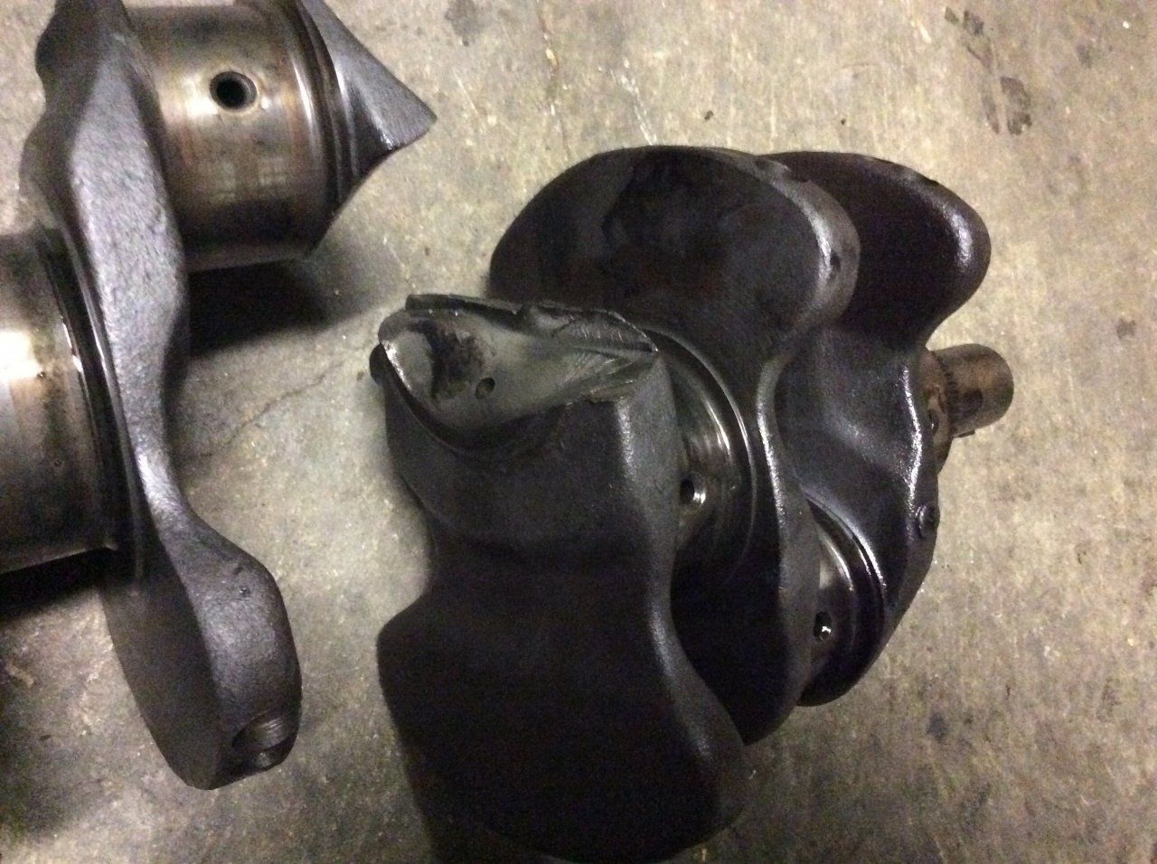

Course I couldn't forget the crank. Amazing that stayed keyed together. Praise the Lord!
That is a miracle indeed! How could you tell it broke? Loss of oil pressure? Are the 3B cranks forged? Hard to tell from your pics? I was trying to comprehend how you broke a crank but did not completely destroy your engine, and now I understand.
Well while climbing a gentle hill one click from my house, there was a huge bang! And my clutch pedal was pumping in and out a lot. Before I glanced to shut it off I made a note that it had normal pressure. I then shut it off and pondered a while. Then started it and watched the oil pressure build, but was too disturbed by the pedal movement so I got a tow home. About 10 seconds run time.
