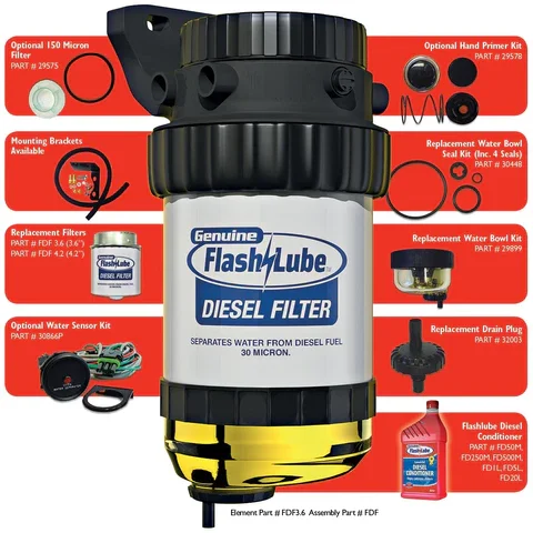

I added one of the below prior to the lift pump on a 2H (same setup as 3B) - it happily sucks fuel through it. I've got 100,000+klms on it now.
I did this because I deleted the factory sedimenter and because I often fill up at very remote fuel stops who have above ground tanks and questionable quality diesel.
The visual sight bowl, replacement sedimenter/water trap, and extra protection it delivers is important to me. My factory spin on filter just before the Injection Pump is 10Micron and I run 30micron in this pre-filter. I carry two spare spin on filters and a spare filter for the unit shown below. I can bypass the pre-filter fairly easily if I need to. It does make bleeding from dry more difficult but thats never happened on a trip yet. When I did it at home I used a bit of low pressure compressed air into the tank to assist.
