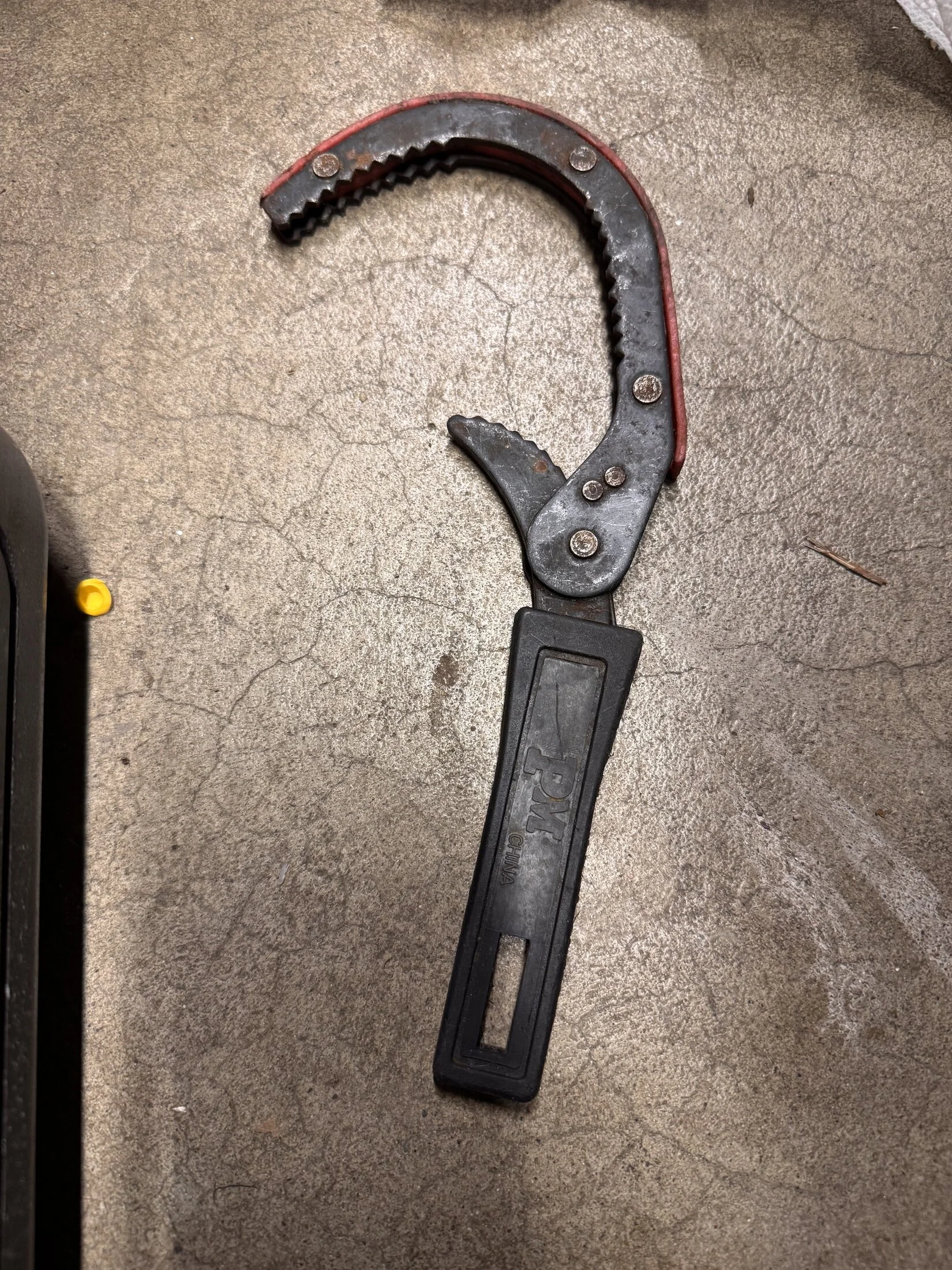

I just did this a couple days ago and had to use this jaw type wrench. It came off with moderate effort, but the risk is that this bites into the housing and then you’re committed.
Didn’t have to remove the mount.
Oh, interesting. I don't think I've seen one quite like that. I already dented it with the strap wrench I broke, so not much more damage to do unless I still can't get it off. Where did you get that thing?
