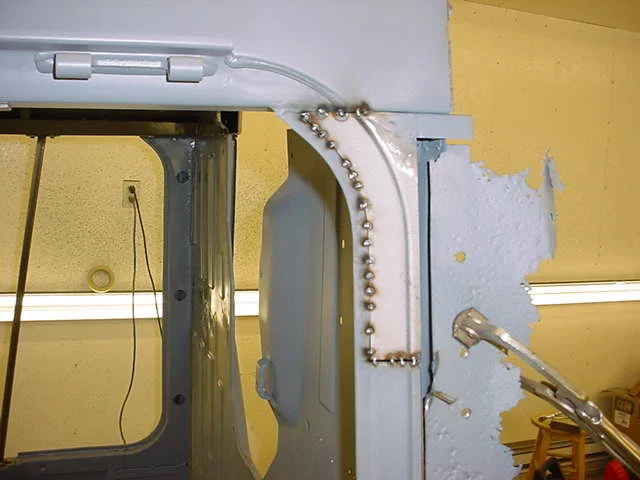

You may have answered this some where before, but how do you make those bends in the sheetmetal? Especially the curved bends...

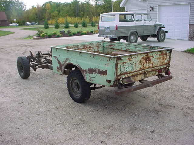

So what would have been the plan if you had to fix the rusted 76 frame ? I guess a few of us secretly hoped you would have to work on it just to get a superb howto pictured live on our screens :doh:
Could be done, but this new one should be a lot easier even with the parts swapping.
Nothing magical about what I was going to do with the other one. The main plan is that I was going to spit the frame and frame rails. I planned on grinding and punching out every buck rivet on the top and bottome and then seperate them. I then could sandblast the growth that was occuring between there and start fabricating new frame. I may have even ended up using a 40 frame for some of it.....and a lot of the brackets that were rusted off. Rear supports were gone, they would have to be made along with a lot of other stuff.
There was more, but that was the big thing....seperating those frame rails. That would have taken time along with all the time it would take to fabricate new frame and new parts. Then re-assembling everything and making sure it fits and looks stock................:rolleyes:
I'm glad I have this frame......
Matt
Wow just wow...
Depends what bends your talking about. On the rear quarters it was done 2 different ways.
One one side I bent a piece of steel straight and then cut slits in it every 1/2". I start tack welding on one side and slowly work the metal bending it by hand and tacking it every 1/2" or so.
On the other side I used a flat piece of metal tacking it the same way, bending it by hand. When it was all tacked in I cut a piece of metal that was curved to match the bend and then welded it in.
Clear as mud :)
Matt
Maybe he is asking about your break? Like for the floor board pieces etc.?
