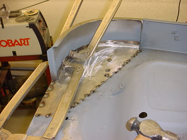

Not a ton done, pretty much started on that rear quarter. Hacked out the bad area and started making the new piece. I left the lower part in while I made the upper piece so I could get the curve exactly right. Made the flat piece first out of tag board first and then traced it and cut it out of steel.
After I got that where I wanted it I sheared a 7/8" piece of flat stock on tacked it around the edge. Took my time and slowly tacked it. In between tacking I cut the lower part out where I am going to replace that part of the quarter panel. After it was all welded I ground the inner welds down nice and smooth so it looked like a formed piece of metal.

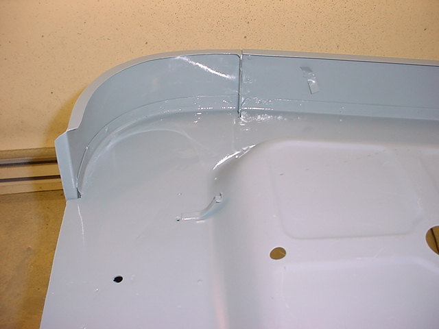

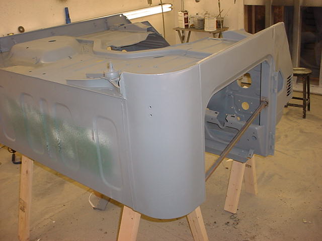

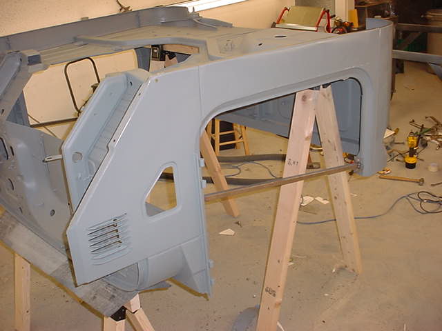

Got about 3.5 on the lpb tonight, pretty good night.
Started right back in on that rear quarter. I blasted that area inside the back, figured I was there, might as well clean it up. Gave it a quick shot of primer. I made a paper template of the quarter panel first (sorry no pic) and then cut it out of steel. I bent it up and started tacking it in. I really took my time and slowly started on one side as I tacked about every 1/2" as I rolled it along making the curve. I made sure everything was straight and lined up, tapping it with the hammer if needed. After it was all tacked, took my time and slowly stitched it up. After it was all done, ground everything down. I think overall it turned out great.
I then started welding that floor piece in that I made last night. That was fairly easy to weld in. Made sure I clamped everything tight against the outside quarter when I spot welded it. After everything was welded in and cleaned up.....I don't think I could have done it any better. Cleaned everything up, blew it off and shot a couple coats of DP50LF epoxy primer.

Few other shots mixed in tonight also.
