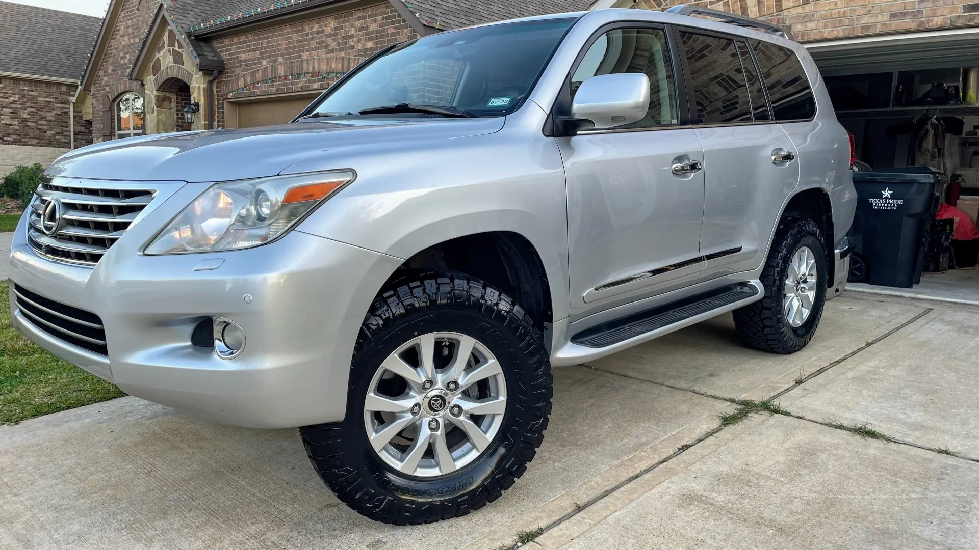

295/70/18 is a tire size that you should consider*
Big meats on a Lexus is such a fun flex :cool:
Had to get a picture before leaving Discount Tire
Almost no difference in feel driving it home. Kinda surprising b/c these tires are almost 10lb/piece heavier than my 275/70s
They fit soooo easy too. This should honestly be the default size to upgrade to from stock if you keep the 18" wheel
And STUFFED
1" spacer doesn't seem to be an issue at all so I guess I keep it
Thanks @tbisaacs for getting this thread started 👍
Looks so good!!
Doesn't it? Proper meats. Looks soo good.
Regarding weights, it's never been what the forum likes to make it out to be. That's not primarily where MPG and ride and handling is lost. Big tires are worth the weight as it's the best suspension, traction, and lift that can be added.

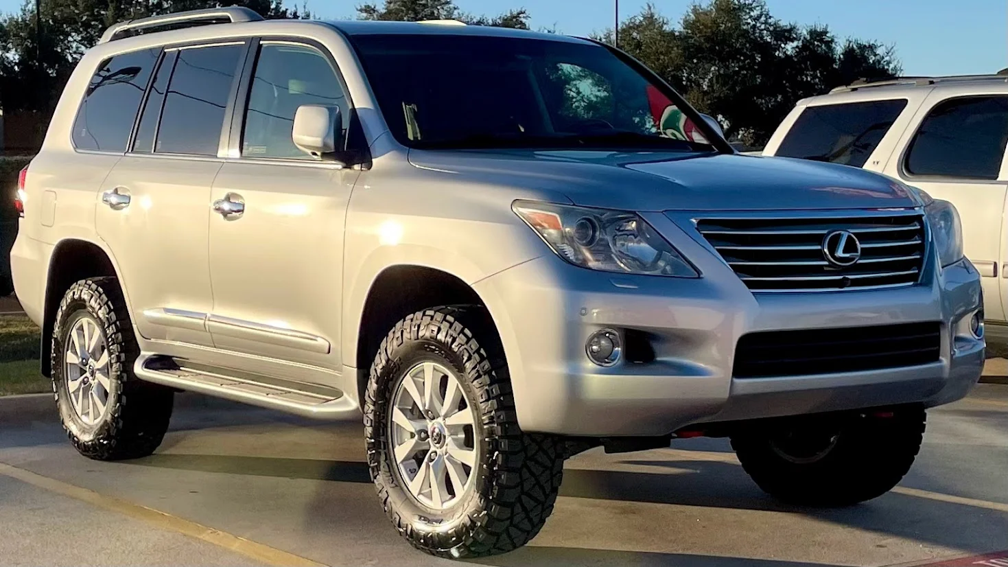

Another LX with 35s, cheers! :beer:
Tundra wheels, no spacer needed?
I'm running 1" spacers with the Tundra wheels.

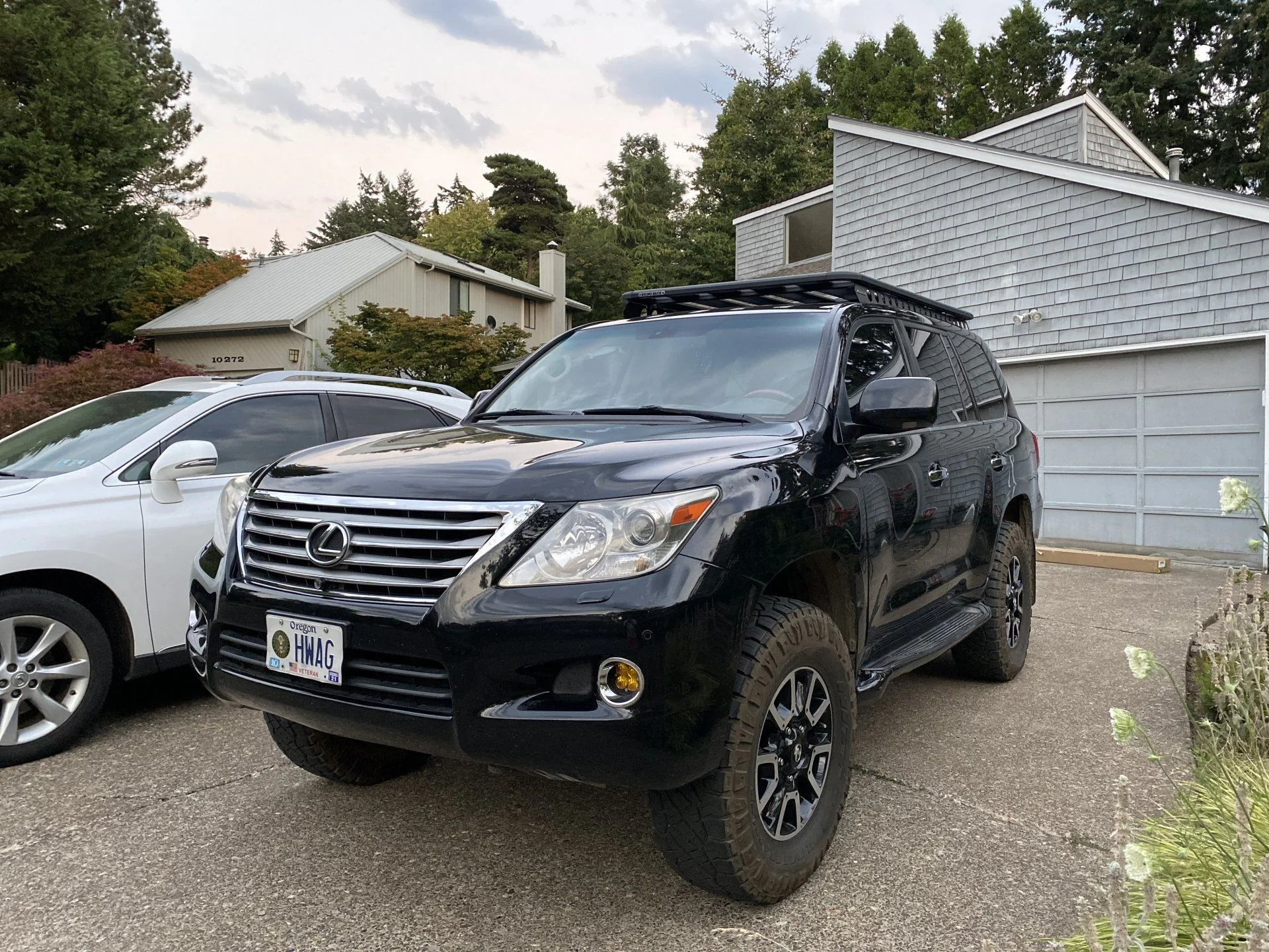

I recently changed my tires out to the Falken Wildpeak AT3W. The Falken's seem to run just slightly bigger than the Nitto RG that were on originally, and it required me to do some additional clearancing to prevent rubbing. I also finally did the AHC lift, but i don't think it was needed to make the tires fit
Here's a pic with AHC lift mod and normal mode.

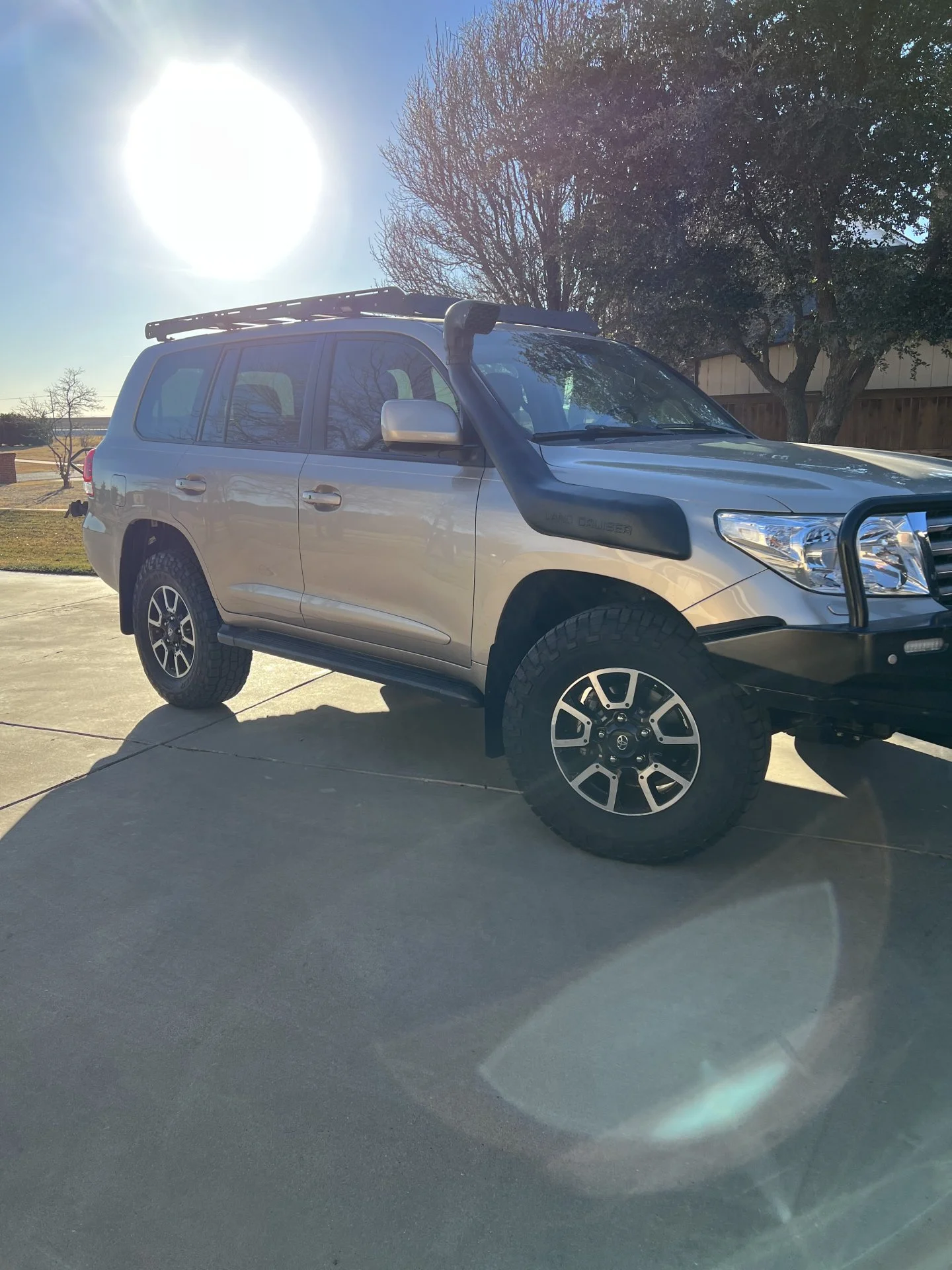

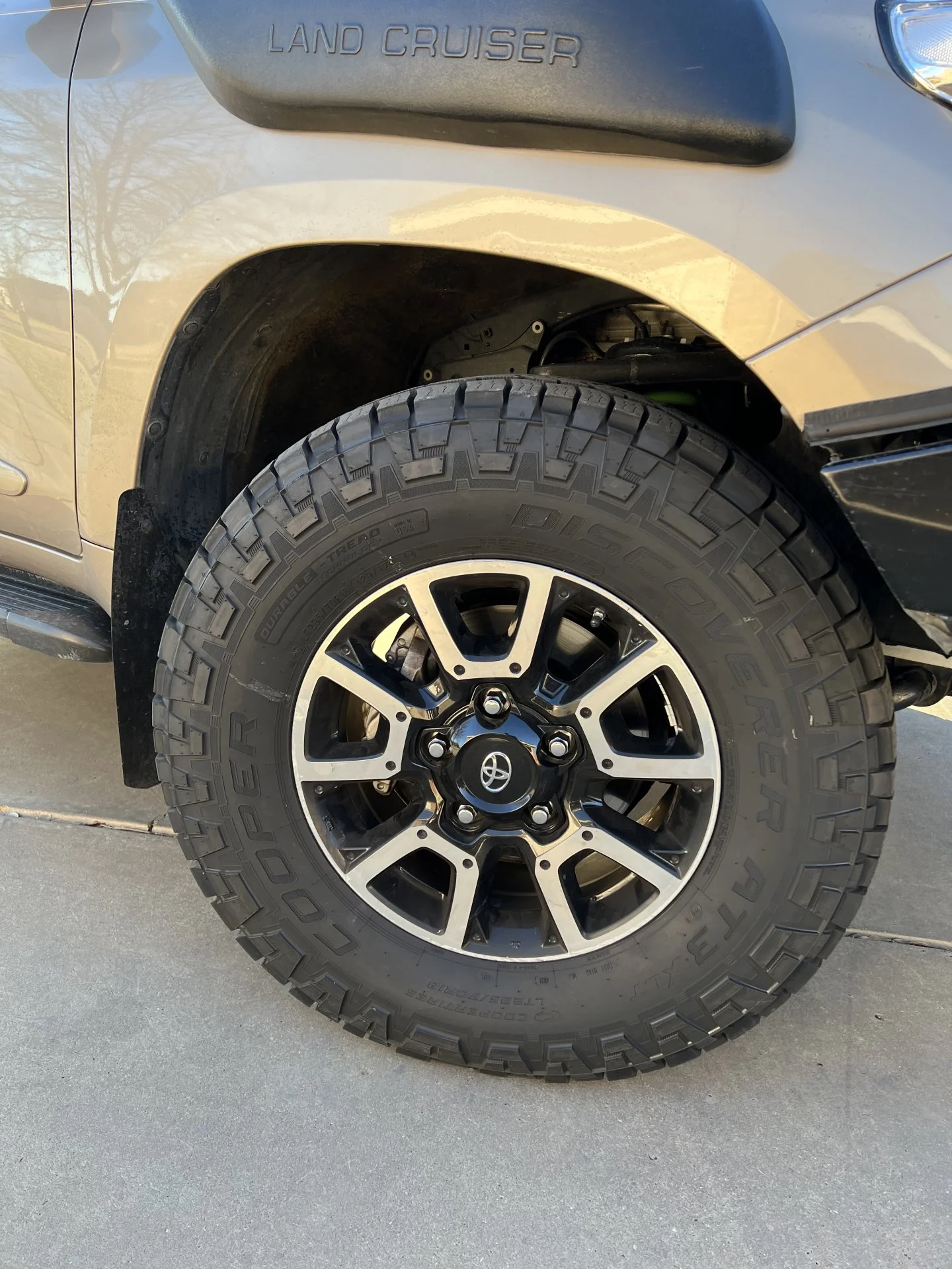

You can. I have SPC UCA’s and have about a finger width of clearance. Just switched to Cooper AT3’s.
Wow. Those look way better seeing them on the Tundra TRD take offs. I was considering what appears to be (from your signature) your former tire of the Yoko Geolander M/T 003. How would you compare them? I'm coming from Nitto RGs and they performed well but looking to mix it up.
For reference, I was also considering Toyo A/T III and Yoko Geolander X-AT.

The Yokohamas were louder and heavier. It feels lighter on its feet with the clCoopers now. The Yokohamas were great, wear on them for an M/T is impressive. For my needs an A/T is a better choice. That being said, the Yokohama A/T is a solid tire and was my initial choice, but they are not as easy to find in stock. Same goes for the Toyo. I decided on the Coopers because of the weight. They’re roughly 6-9lbs lighter than all the other tires offered in the same size. So far it’s proving to be a good choice, my fuel consumption has improved a fair bit.
