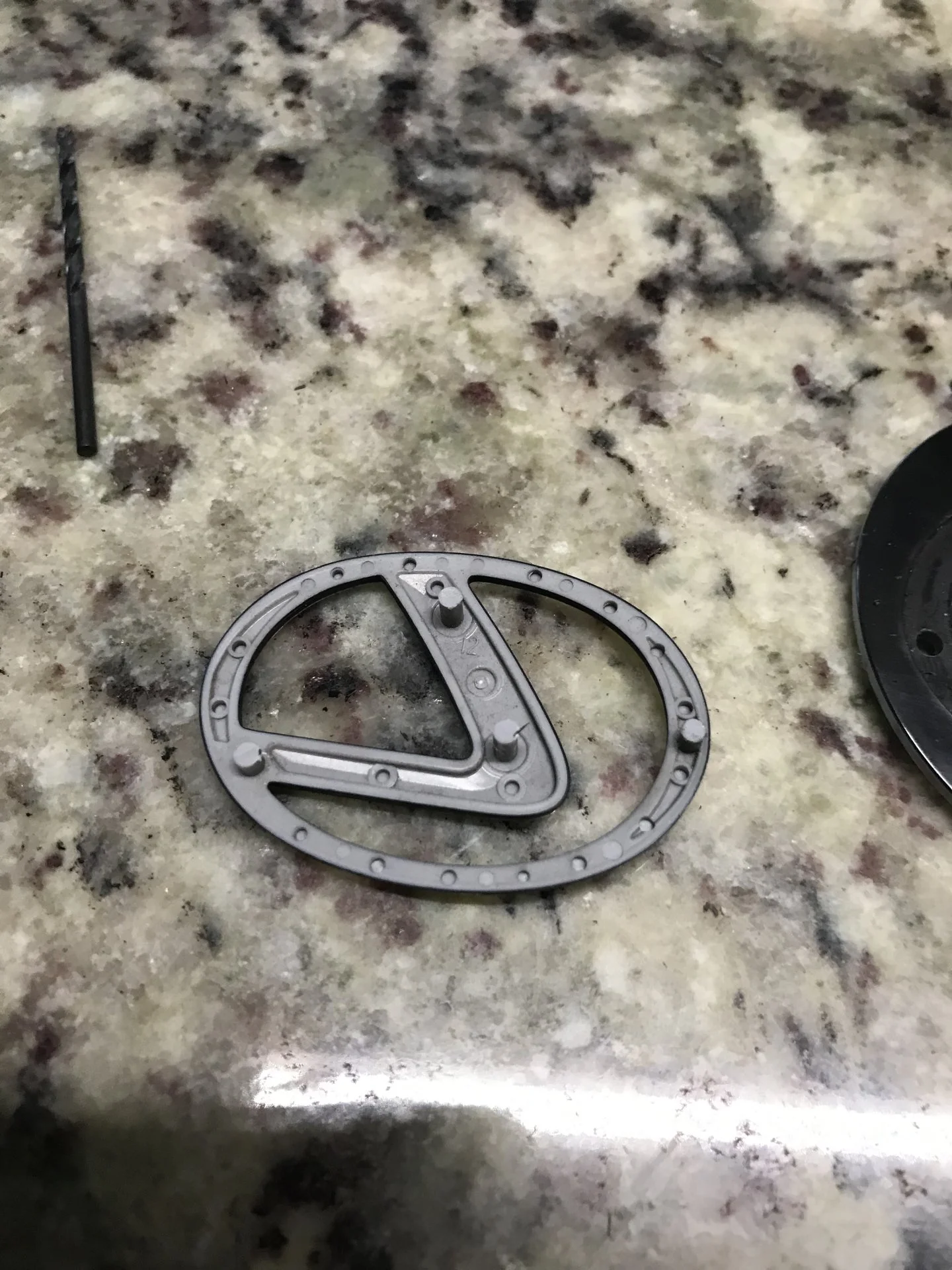

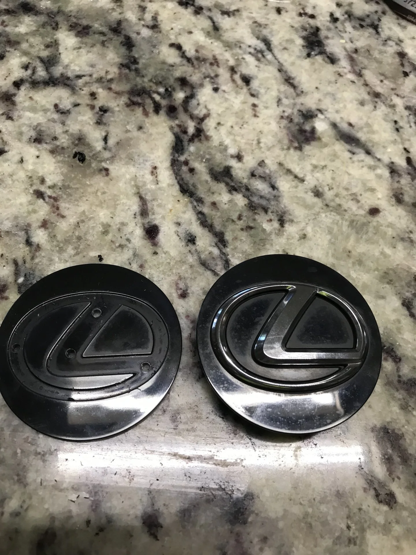

Hey dubyahard can i ask where you found the Lexus emblem for the TRD wheels?

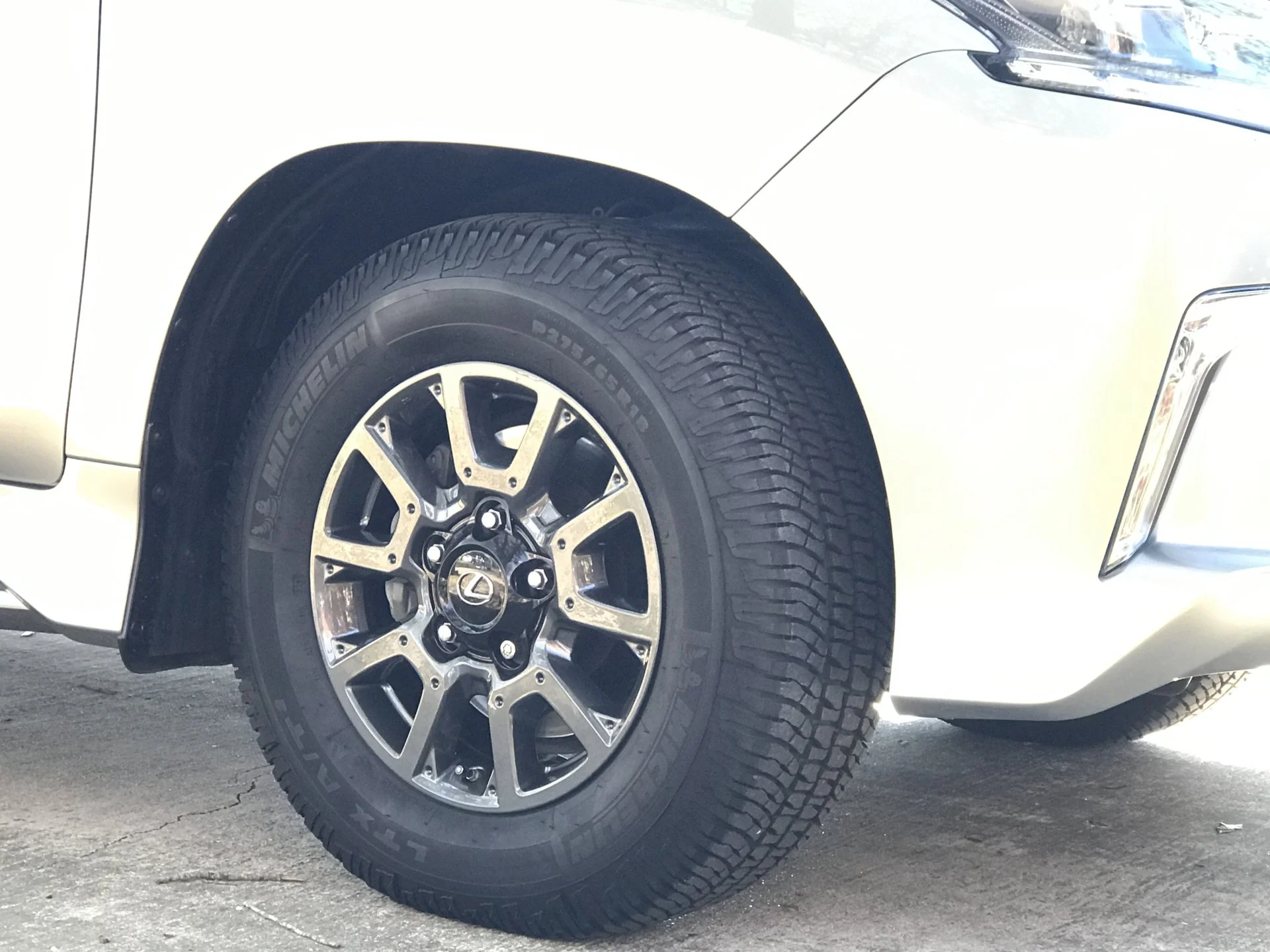

These look similar. They have the little clips on the back to pry them off easily. I also used a little adhesive to hold them on the the Tundra caps.

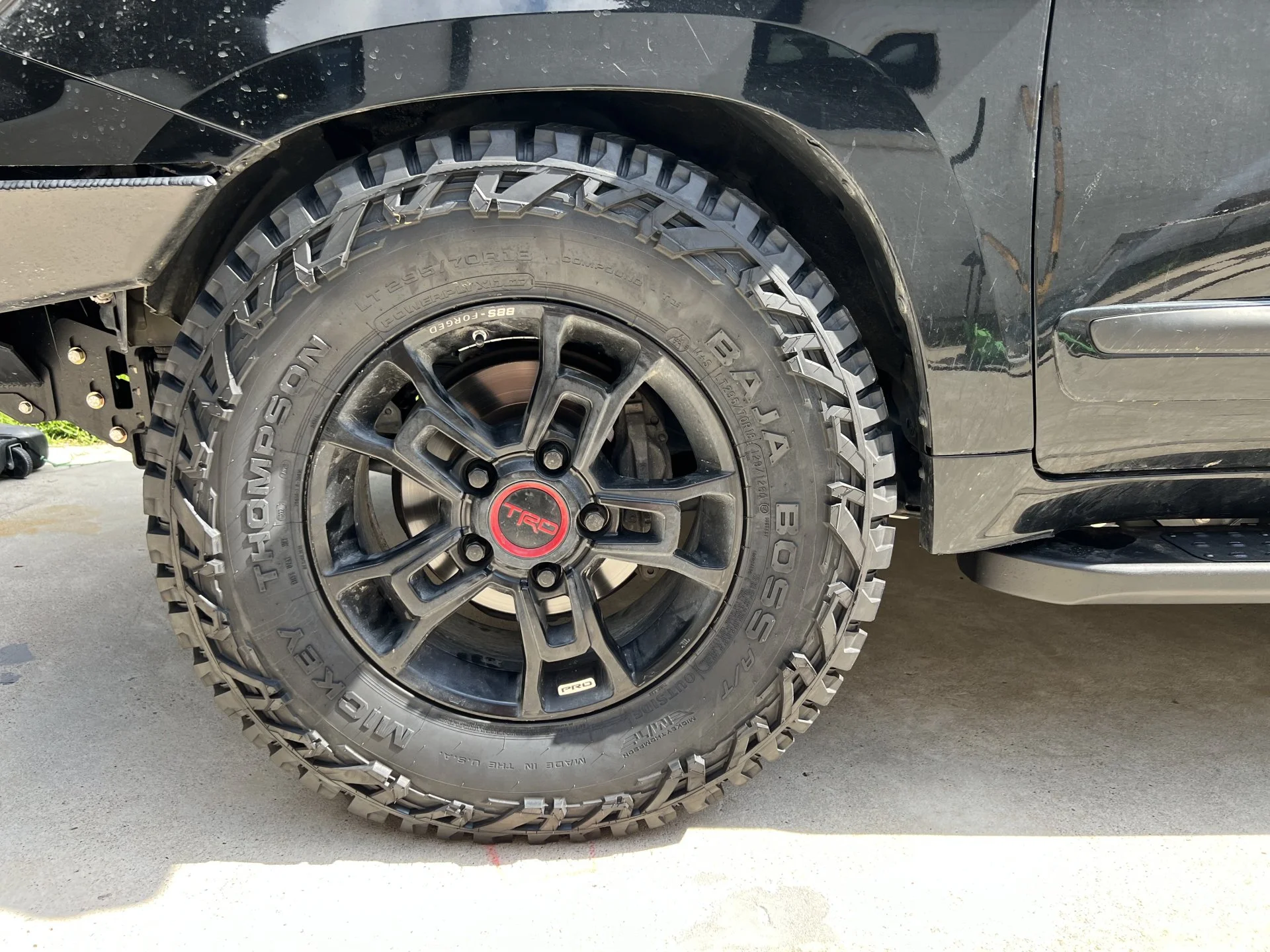

center caps

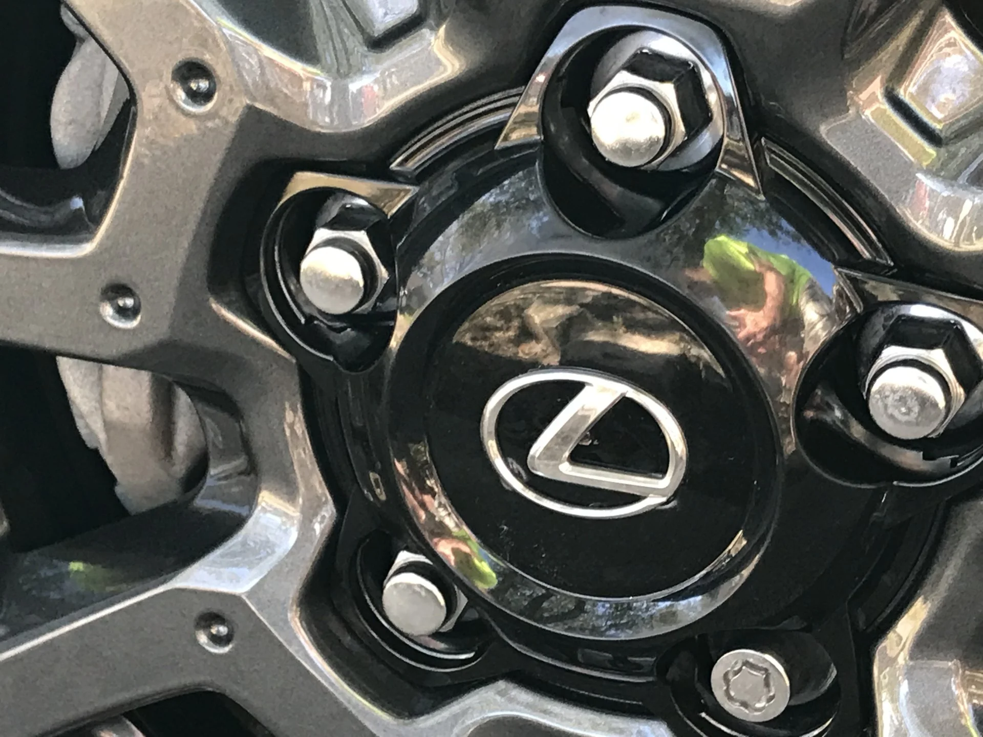

I took the 21” wheel center cap off and then the emblem you have to grind off the little melt nubs that hold the emblem, then you have the emblem with prongs the Toyota emblem just unsnaps easy , then i used the black piece as a template drilled holes to match the Lexus emblem then guerrilla super glue on .

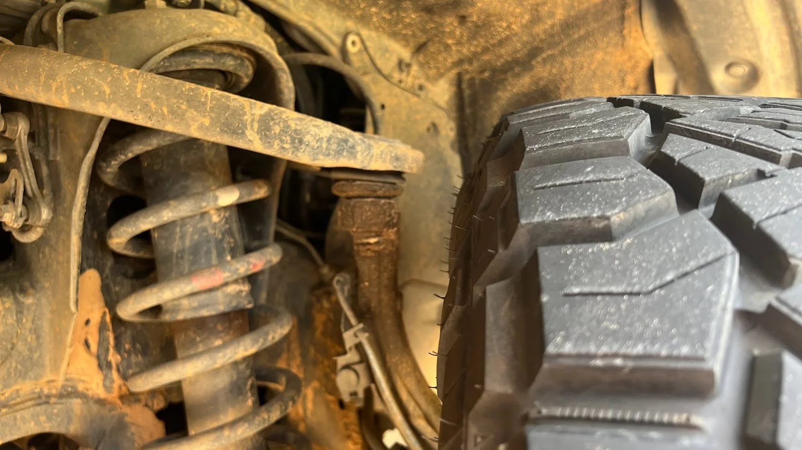

My offset is around +31 (LC wheels and a 1" spacer) and I have zero issues fitting the Ridge Grapplers. I'll try to get a pic of the UCA clearance but there's room to spare...
Don't mind the dirt... east Texas clay dust takes forever to clear off ;)

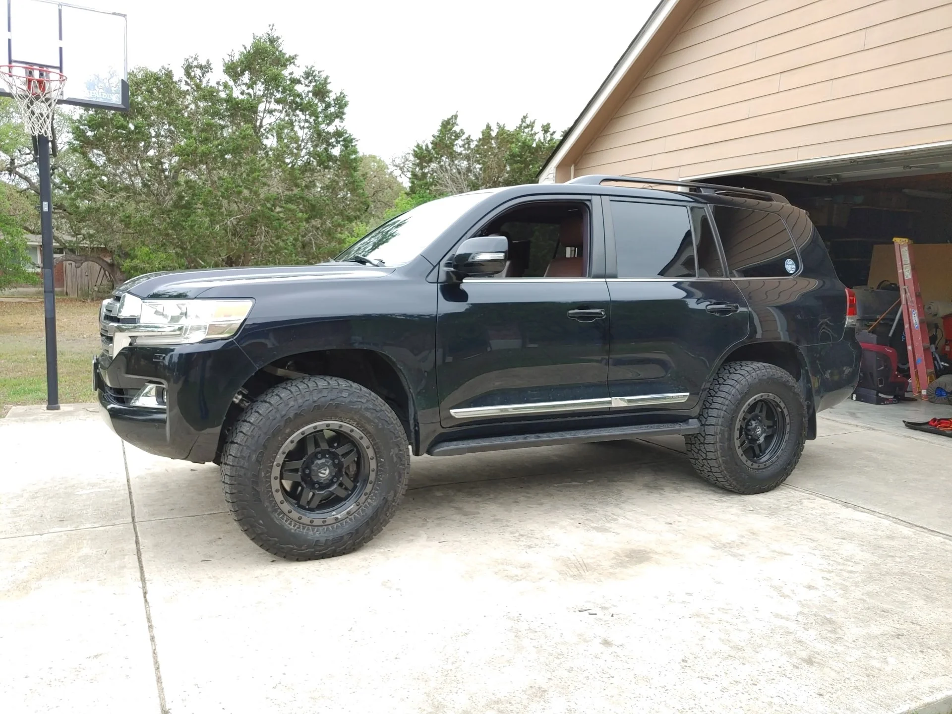

no spacers, Fuel Anza Wheels with I believe +20mm offset. I dont believe they offer another offset for this bolt pattern. This equates to about the same as Factory offset with 1.25" spacer
Rod, are you running spacers? are those wheels the same offset as OEM?

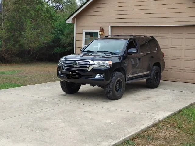

I just joined the club!

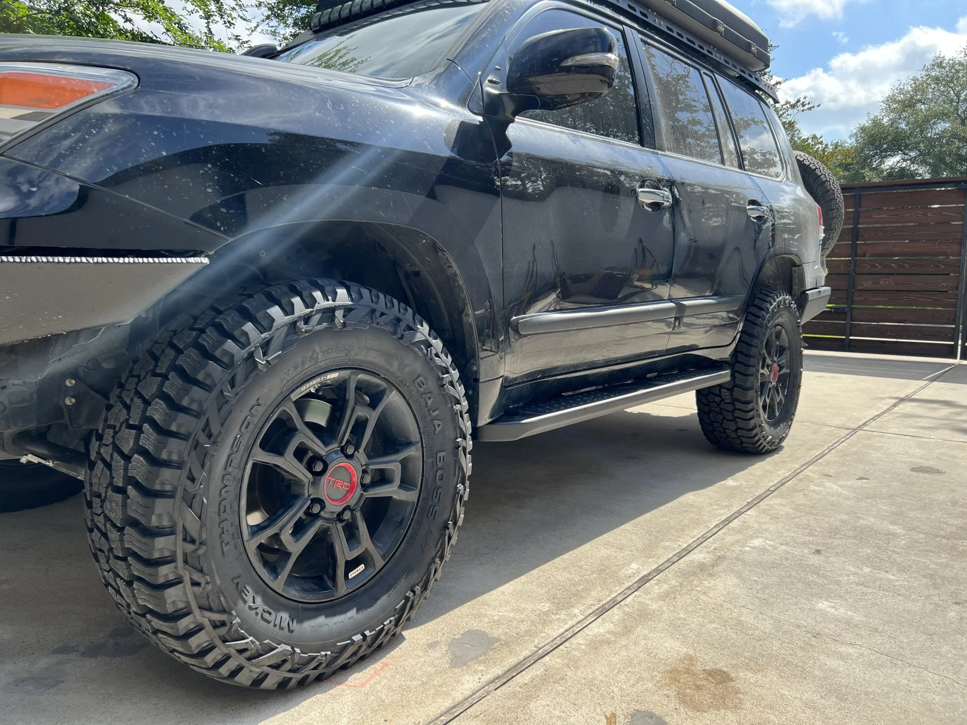

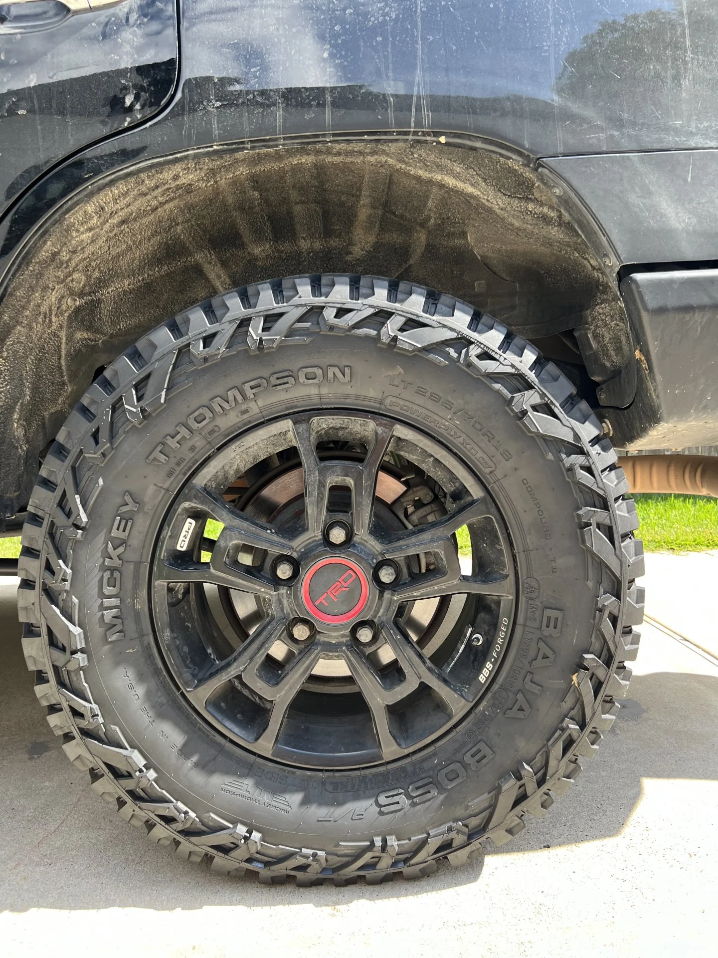

295/70/18 Mickey Thompson Baja Boss A/T
Weighted width is 34.5”
2 pics in High mode, one in low.
