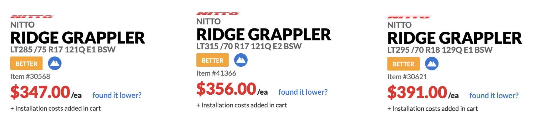

I had not considered 315 70 r17…it would be 34.4x10.6 and, with k02’s and 25 offset method 316’s add up to 86 lbs, which would technically, I think, be oem weight.

This is an 18" tire thread so take this for what it's worth (not much). If you are buying new wheels, going with 17" makes a lot of sense. Most fit over the brakes, the tires are cheaper, the wheels will most likely be cheaper. So unless you are after that slightly lower profile tire, the only reason i'd go with an 18" wheel is if I was sticking with a Toyota takeoff (with a 1" spacer) that i was getting either on the cheap or getting a high end forged BBS wheel. There isn't a perfectly equivalent 17" to the 295/70R18 but the 285/75R17 is slightly smaller and the 315/70R17 is slightly bigger. There are some 35x11.5R17s out there, that would be closer to the 295/70R18.
Technically correct but only if you already have the 17" wheels. If you are switching sizes and buying wheels, it's significantly more expensive. Your second set would indeed be cheaper.

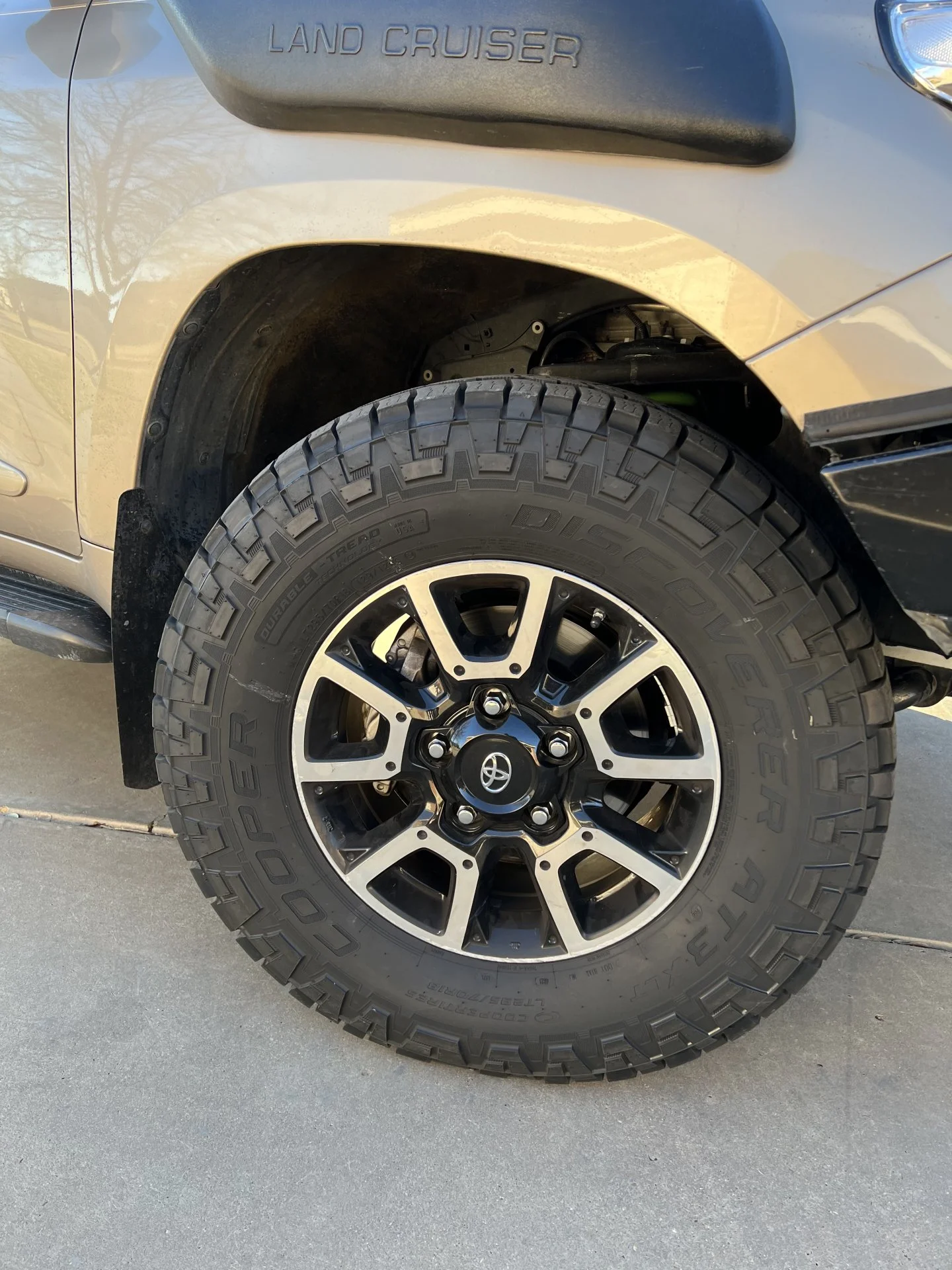

Aesthetically, the 18’s look excellent, almost an oem package with the 295 70 r18’s.
With 285 75 r17, it does not, to me, appear aesthetically right by comparison. Too much sidewall.
285 70 r17 looks great.

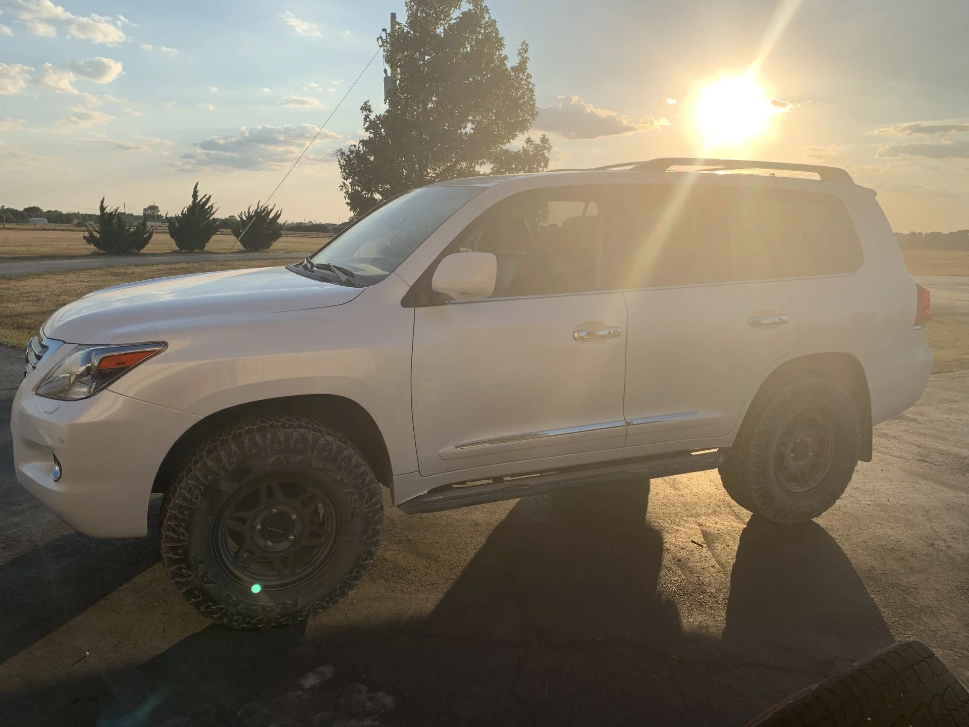

Here's an active forum member who has/had your requested 295/70R18 on a +25. Seems like he's already changed them out for something with less offset, so i guess the +25 didn't bother him.

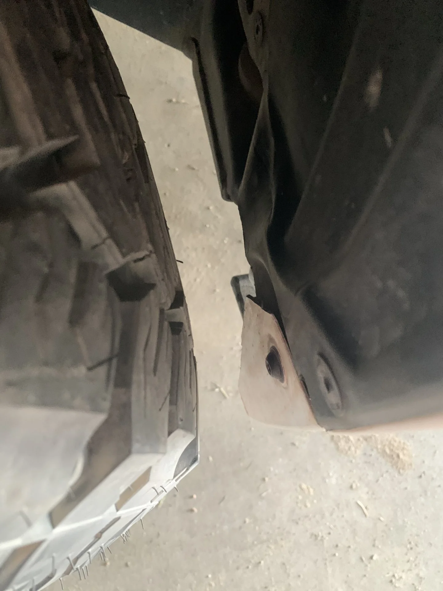

Finally got mine on, a little more pushing of liners to do: currently full lock under braking has minor liner scrubbing. Mr706 had the +35 offset so went with those.
Any rubbing on the body mounts with the 35 offset?
No, the mud flap mount bracket ( lower towards the inside of the wheel well) did though. The side lugs are larger than some others so towards the larger size that can fit. Also front wheel wheel towards the inner side (mostly fixed now needs to be pushed a little more). Only rub is under front dive type load (harder brakes and hard turn).
This is the area where the most clearance issues existed on mine: mud flap removed, trimmed step cover (already mostly done during rock slider install) , slightly pushed back metal bracket that is towards the inside for mud flap (~ 1 inch back), heat gun the liner pushed back a couple inches. Body mount is a little over an inch away in the worst case that I can simulate (full lock and compressed)

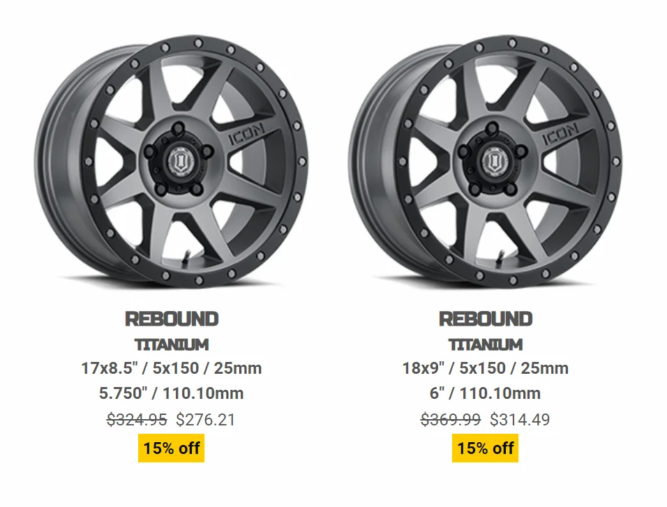

I know Icon has some nice 18” 25mm, I just couldn’t remember if that was enough offset to not need spacers. My heritage wheels and 1.25” spacers aren’t cutting it for 295’s

Most of the ICON options are +25 or lower. There are a few Method wheels at +35. Evo Corse come in a few offsets between 0 and 45, and if you don’t mind spending the $$ and time, can be custom ordered in any offset I believe. There is also Braid Winrace wheels in custom sizes. Haven’t seen those in person and they are pricey, but they look sweet in the pictures I’ve seen.
