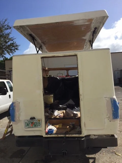

Concentrated on fairing and prep to paint the fiberglass shell.... it is a bigger job than it feels like it should be... body guys make it look easy. Especially the tail lights. Matching all the compound curves is a bitch....

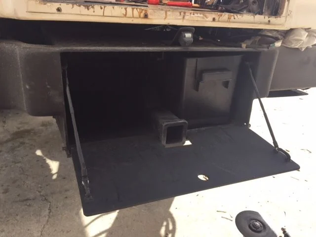

Also osphoed and painted all the welded steel...brush guards and finished step bumper box.

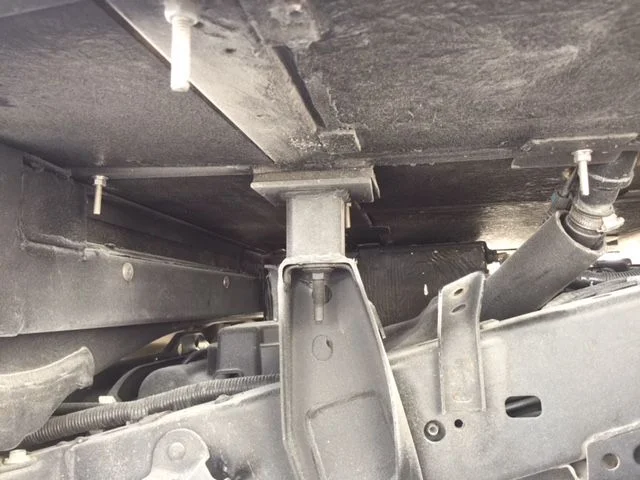

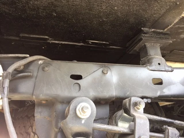

Crawled underneath and touched up undercoating while the utility boxes are uninstalled. Here are a few pics of the clean undercarrage. You can see how well the mounting points worked out.
Lazy day. Got the back step bumper finished with the cable supports crimped in. Used some shrink tube to finish them. I will install a rubber tread material on the inside...or maybe a piece of my grey interior flooring. Note the battery box inside for the house battery.

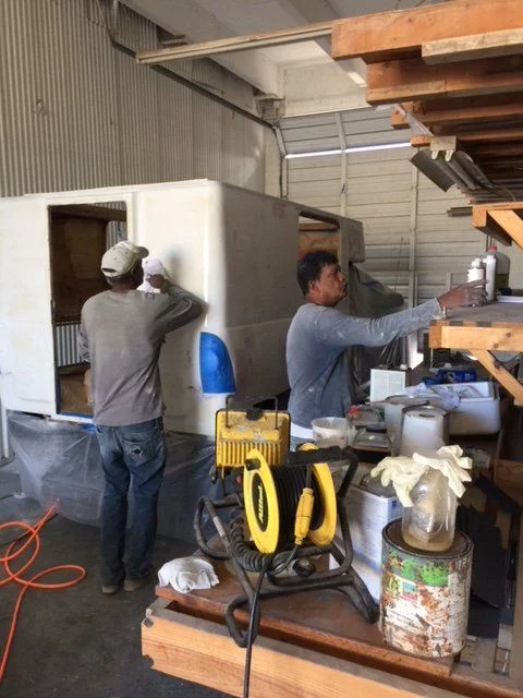

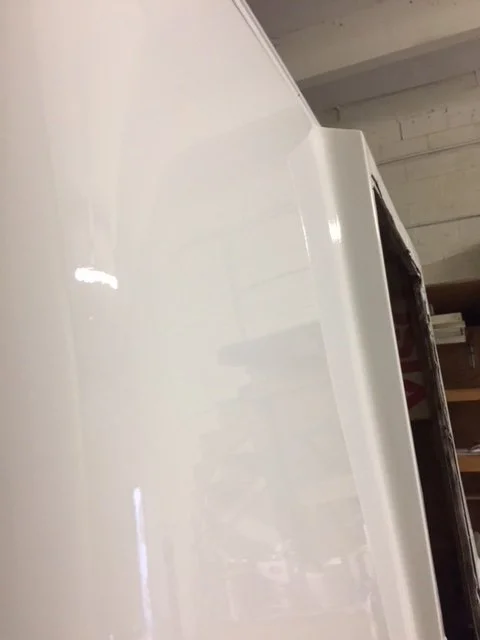

I have a friend who is a boat painter lined up for wednesday to paint the camper shell... shooting it with Awlgrip 545 primer then an off white Awlcraft top coat.... then windows and door go back on.

Things are looking great! It is a little scary how much we think alike. I was planning to put the Tacoma tail lights into the chinook shell and when I first saw your post I saw that you were doing this already. I planned on using diamond plate in the reconstruction of the back door and now that is what you have done. The scariest thing is that you are using the exact brand, size, and model a/c unit that I already have! I selected that unit because of the lower wattage requirements so my generator could easily handle it.

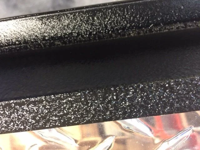

I sprayed the door frames with the wrinkle paint.... I like it! Sprayed 3 coats with a 5 minute tack off between coats... then warmed them up with the heat gun and the magic happens. Very much Luke the paint texture on the front bumper. Very happy!

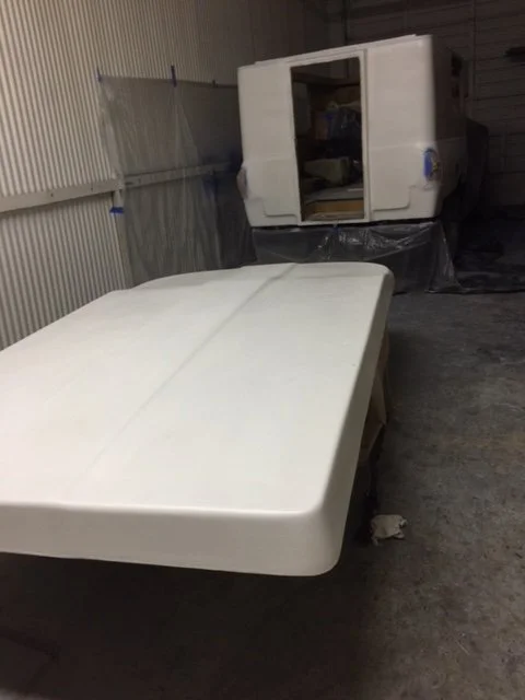

The camper shell is primed with Awlgrip 545!

Love the way the wrinkle finish turned out! I was going to have all the aluminum trim powder coated black but that looks like a very nice option. Would I need to do anything special to prime the aluminum before applying the wrinkle finish? I am using the original windows and door and the aluminum is very oxidized and dull so I don’t have a great base to start with. Maybe I should just stick to my original plan, the powder coater was going to sandblast and guarantees it will adhere. Your finish looks way superior though.

I like this wrinkle paint a bunch too... I hope it is as durable as I am being told it is... it is a high heat and impact paint designed for painting automotive headers and other engine parts.
You for sure need to get any corrosion gone before painting aluminum. Mine were pretty clean. I used Alumaprep first... acid based chemical cleaner. Rinsed good and dried. Then I used XIM primer. Zinc chromate is good too but the XIM is badass. Sticks to almost everything, even galvanized steel... then painted with the wrinkle... they look nice!
I am using the awlcraft because my buddy had it left from a yacht paint job... Awlcraft is better than regular awlgrip because it repairable if you have a ding... Awlgrip is tougher to do repairs on. The awlcraft is formulated like Imron, aircraft paint.... I would not hesitate to use a good automotive cataloged paint... and clear coat. I have used a lot of marine products in my project because we are boat people and I know and have used them on boat projects...
It is painted! Shiny and white.... all the windows and door are finished in wrinkle paint and ready to install. I need to do some interior upholstery work prior to bedding the windows as the trim rings are the finish...I also want to install the pop up headliner before I reinstall the roof.... it will come together now!

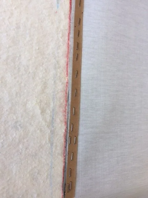

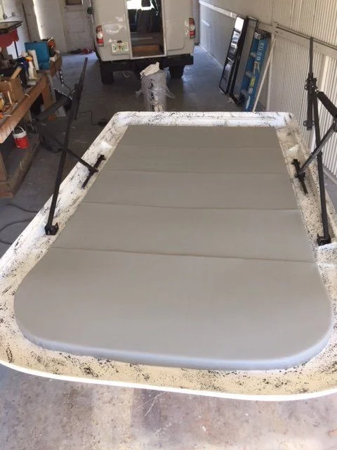

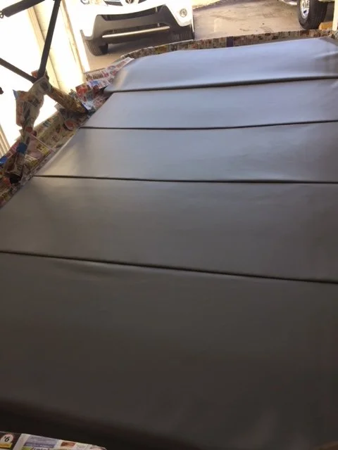

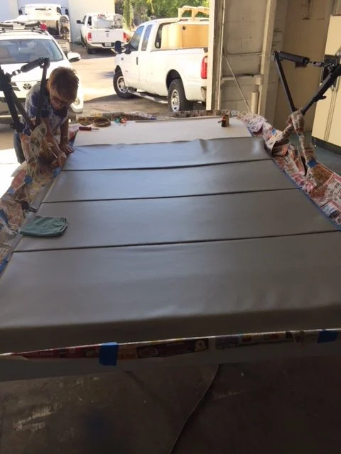

Felt good to get a start on the interior upholstery... started with the headliner... kept it simple with a no sew method. Grey marine vinyl stapled up with money staples through stiff 3/8" seam cardboard. Staple an edge then put the next panel upside down edge to edge, staple and then flip it down, stretch it and staple the other side...the fold over covers the staples and looks very tidy.... still have to stretch and staple the perimeter so there will be no wrinkles. The pop up tent will cover my perimeter staples....

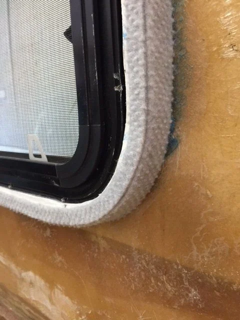

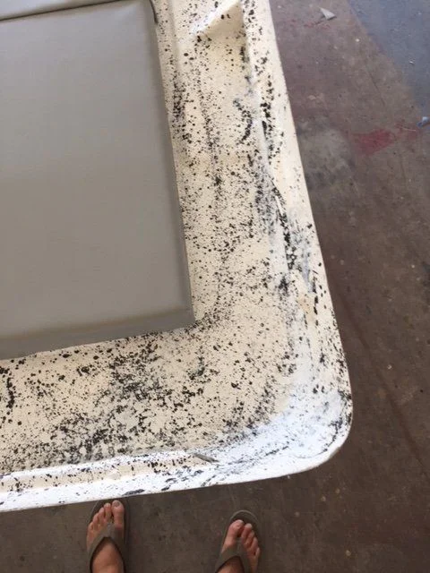

Great day today... finished the headliner project and upholstered the inside of the shell where the front Windows are being installed... also the wooden spacers for the side windows got done... the windows were dry fitted and can now be bedded and permanently installed.. .. there are black wrinkle finished trim rings that finish out the interior window openings.

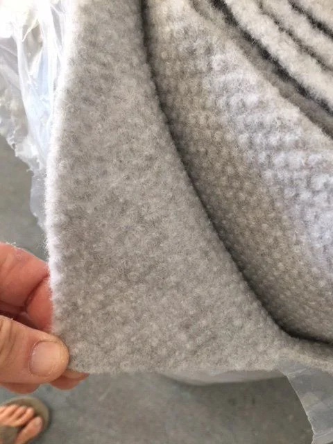

The wall covering is a marine hullliner used for boat interiors... a nonwoven polipropelene felt that is flexible and hood for compound inside and outside curved surfaces. Glue on using spray 3M 77 adhesive....My wife helped me and I think the curved front piece we did today is the hardest one we will have to tackle! Left the edges unglued so we can double cut and get clean joints on the next pieces.

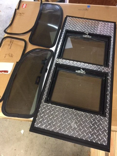

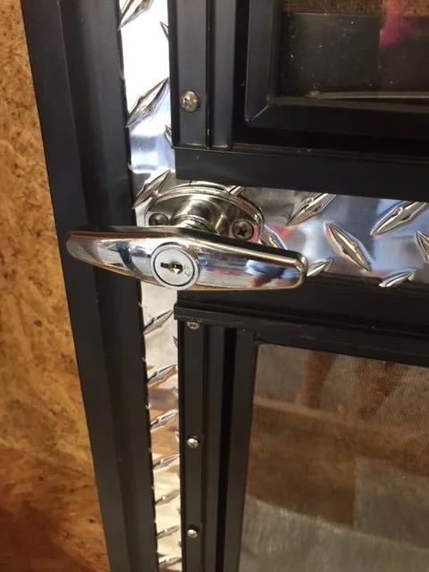

Installed the fill and vent for the extra fuel tank and dry fit the diamond plate side hatch. The side hatch will get stainless steel cables to secure it at 90° when open. It will be the shelf for a small propane grill.....
