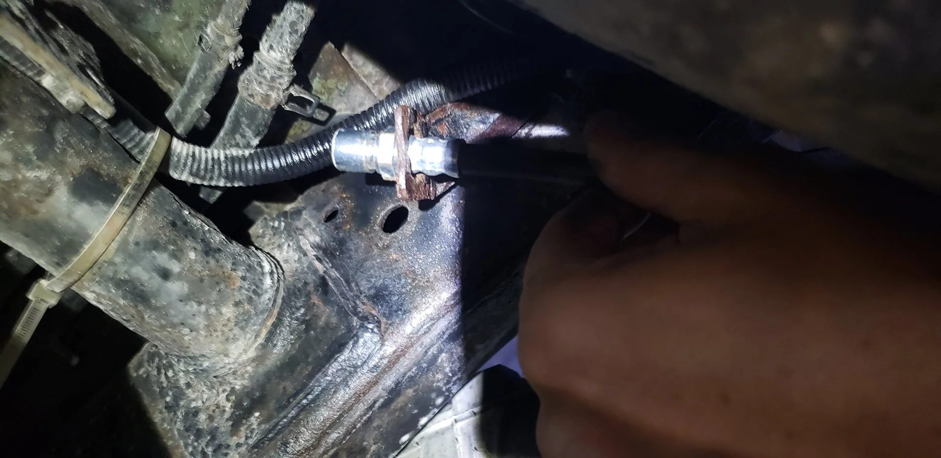

I have avoided any serious off road situations as in the back of my mind I knew after the 4" lift I would need to replace the rear flex brake line with, well, one that is 4" longer... the custom one I ordered made finally came in, and the replacement hard line as the existing one's unions looked pretty suspect.
As someone on these forums has been wont to say, "use the right tool!!" Well, I TRIED - I PROMISE!! But sometimes you just have to use a little more PERSUASION...
Even after heat treatment and penetrating oil, the union would not budge, the flare nut wrench stripped the head. I used the persuasion grips and ended up shearing off the brake line getting it out.
So I managed to get the old flex and #6 brake line out and started to put the new ones in, and discovered the new line did not fit the securement bracket and retaining clip... :bang:
It passed right through the bracket, so it would appear I would have to make some sort of washer or something to hold the one side and the retaining clip on the other...
I found that a washer was a little too thick in order to still get the retaining clip on the other side, so I began rummaging through my tickle truck of unused bits and pieces. I tend to keep anything that looks like it MIGHT be useful or serve a purpose in the future...
I happened upon a little bracket that looked both sturdy and thin enough to do the trick and proceeded to drill a hole through it and test fit...
I set it in place and put the retaining clip back in and it felt good and snug!
From there is was just a matter if installing the new hard line.
