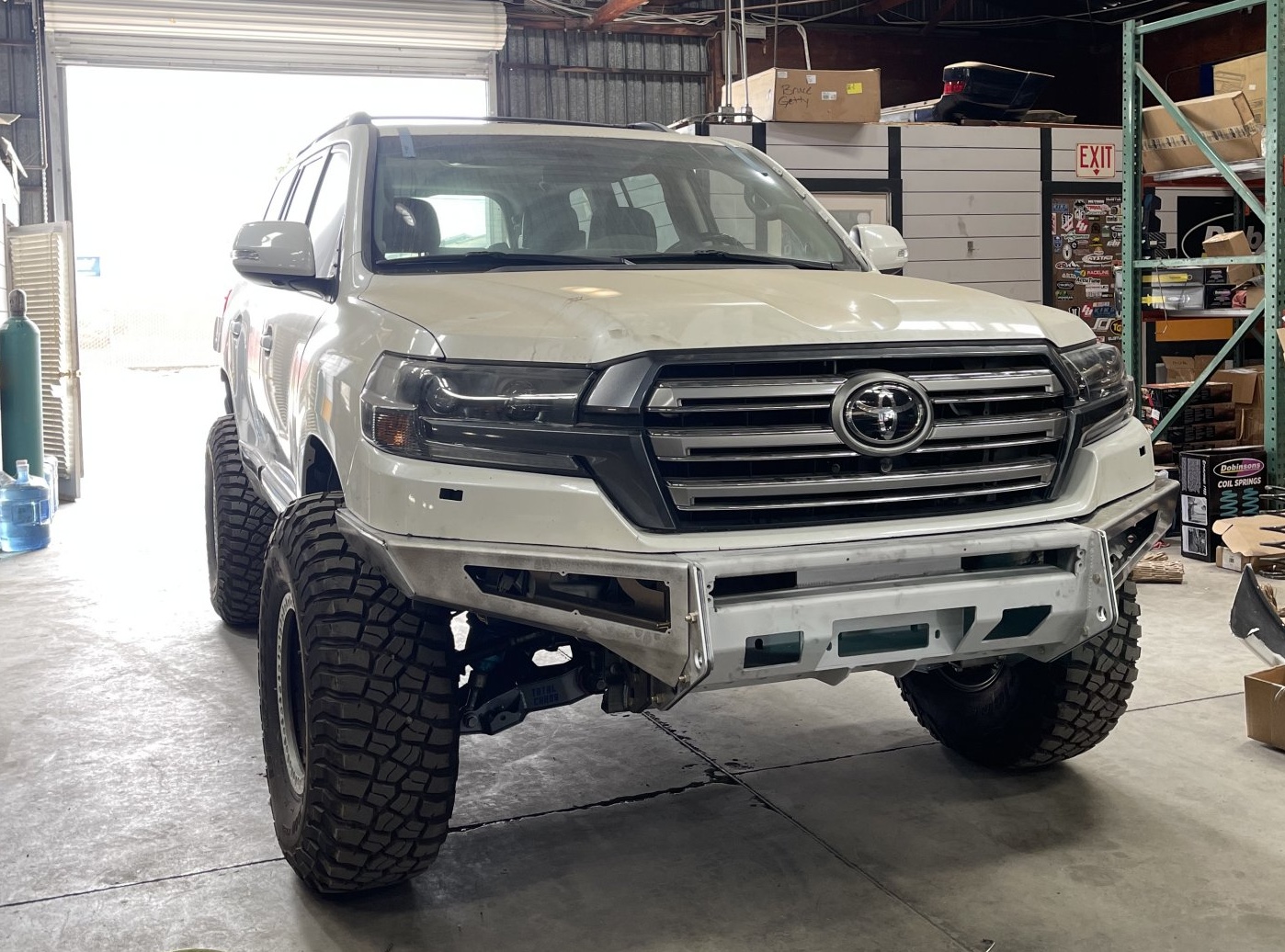

I'm mostly looking at 74Weld's portals. They increase track width by 3.5" per side. Wheels can be 35mm offset and so that is about an inch per side over stock..... 4.5" increase per side (9" total).
Folks running Tundra arms (~3") increased track width.... and zero offset wheels (~5"wider total) makes for 8" increased width total.
Pic of Stellerbuilt's 200 with Tundra Arms/0 offset wheels... so picture just 1/2-1" wider per side for 74Weld. Wide, yes but not ridiculously wide.
Also, the 56lb front portal weight also includes the integrated knuckle... and so you would subtract the cast iron knuckle weight from stock.
Ah yes, didn't consider the loss of the stock knuckle. What's everyone doing in conjunction with portal installation? Guess you don't need a spindle gusset anymore. Cam tab gussets? Body mount chop? What's the next weak link after the portals?
And agreed, that's not too too wide. But I will say if I'm doing a technical trail and I have to choose between my 80 and Tundra I'm picking the 80 every time and width is a factor. The Tundra is a boat on the trail and I only take it out to wide open desert trails, especially after installing King 3.0s, it's so fun bombing around
