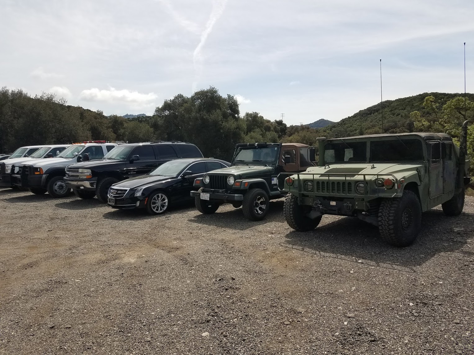

I enjoy the ground clearance portal hubs provide on my HMMWV, but don't think I would consider them on my LX.
Just doesn't seem practical for the strengths of this platform, and the increased rpms at the same speeds would be rough. My 6.3 and 3-speed only allow 55mph without creating problems on the AM General platform. It's rough.
