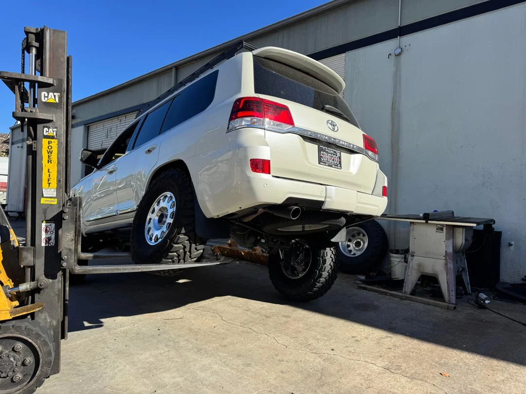

Is this the standard level of service that anyone purchasing Werewolf Portals should expect?
I don’t know what the official “policy”is, but I know I’m not the only one he has done this for - I know of at least two others. I did not know Rob previous to purchasing these portals, so I’m not pulling on a personal relationship or something.
Looks like 74Weld/SDHQ up to some fun today

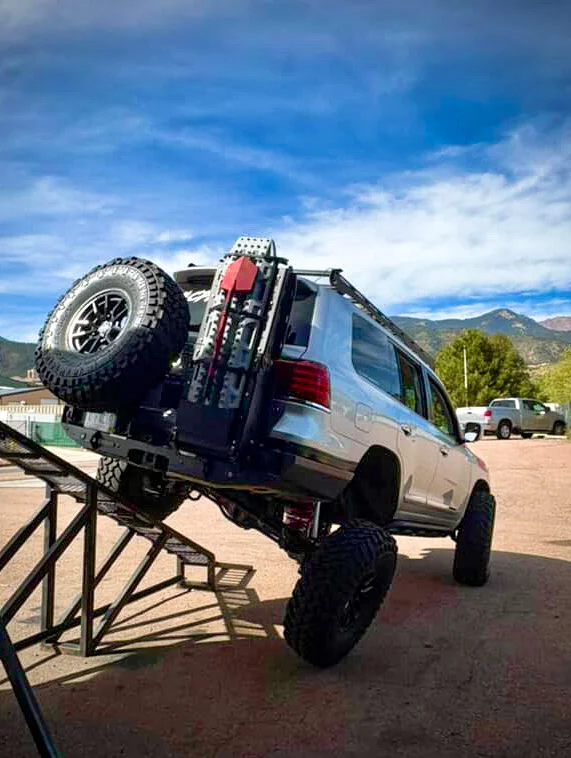

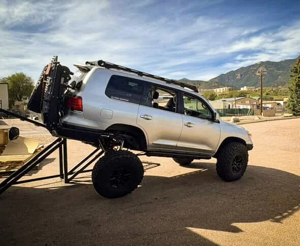

Glad the aftermarket suspension fits the bill. Has any of the full armored LXs put their rigs on a scale? It shouldn't be a surprise that AHC would be well out of its performance envelope after some weight threshold with stock spring rates and damping curves. I don't think any of you are running long travel AHC? The good aftermarket stuff will still have an edge in articulation, as it should, but long travel AHC is also night and day to the factory setup. Guess we're trying to feel out when that next stage of mods makes sense.
Funny thing as I do more technical stuff, I use AHC high less. Suspension geometry at lower lifts provides superior traction, stability, and performance. I use AHC high only when clearance is needed for big stuff. It's still a strong benefit of AHC to have selectable heights as I prefer not to be statically lifted. That's also where portals win because it's able to provide extreme clearance without extreme suspension lifts.
Glad the aftermarket suspension fits the bill. Has any of the full armored LXs put their rigs on a scale? It shouldn't be a surprise that AHC would be well out of it's perform envelop after some weight level with stock spring rates and damping curves. I don't think any of you are running long travel AHC? The good aftermarket stuff will still have an edge in articulation, as it should, but long travel AHC is also night and day to the factory setup. Guess we're trying to feel out when that next stage of mods makes sense.
I’m around 7500-7800lbs
