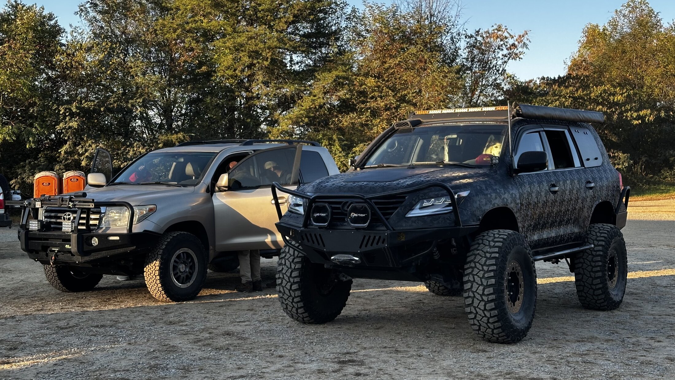

Height wise he’s never fitting in another garage 🤣. It does look cool, though for $20k plus the effort to install (which is NOT a simple swap) I imagine I’d also look cool rolling up in a trail-ready Fj40
Pic of the truck next to an LC on measly 35s.
