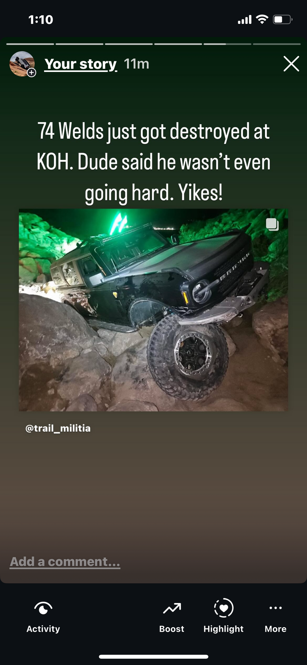

For those of you following this thread, someone with 74 Welds on their Bronco just destroyed them at KOH and said they weren’t even going hard - didn’t know they broke anything until everyone told him to stop. Reports of a second 74 weld breakage in the same spot on the case. Irreparable. Must be replaced. Stuck on trail. Trail Militia on IG and YT has more info. I’m not sure Billet is the right material for these? Glad I went steel, even though it’s heavier.
"Dude says he wasn't even going hard."
Preceded by "Watch this, hold my beer."?
If that trail wasn't hard, I'd like to see what he normally runs.

I don’t think the person was saying the trail wasn’t hard - but that he wasn’t going hard when it broke.
I'd be upset at breaking my $25k portals, but having been deep in the rock crawling world, breaking stuff happens. Even "unbreakable" stuff.
74Weld says Lifetime warranty on Uprights & Knuckles as long as you don't go over the tire limit... for a Bronco, it is 38" tires.

Will be interested to see if there's some insight into why the aluminum failed at the LBJ? Leverage on the tire, but is that a manufacturing defect (i.e., not design). My 4runner has fully fabricated and boxed steel knuckles, I never thought twice about the lower joint ripping off...
