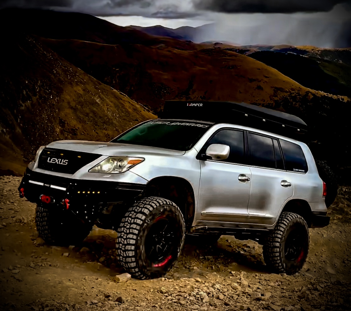

Accurate. Here’s my rig as it currently sits.

I’ve already ordered the portals, but the HMMWV is just not the right for myself and my family - we enjoy the comfort and reliability of the LX. Also it would be too wide for most of the trails here in Colorado. My goal and vision is to have one of the most capable 200 series Rocklanders there is.

4.25” wide on each side. +25 offset. It will do well counteracting the increased lift/COG. Also an extra 80lbs at the hub for added weight down low will help.

Another thought: One of the reasons I’m going with portals is because it will retain all the things that make the LC great. I even get to keep my AHC suspension while simultaneously adding 5” of true clearance!
