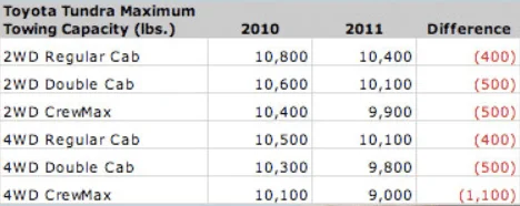

An example that may help understanding is the Tundra. Within the 5.7L motor range, towing capacity spans 10,200 to 8800 lbs. A closer example might be comparing the same bodystyle, but SR5 to a well optioned 1794 Edition:
SR5 4x4 CrewMax 5.7L - tow capacity 9800lbs
1794 Edition 4x4 Crewmax 5.7 - tow capacity 8800lbs
SAE J2807 more greatly impacts vehicle configurations with higher weights:
TL;DR more highly optioned vehicles based on the same chassis will have less towing capacity.

It does make sense if you understand that the new standard – SAE J2807 – that was adopted in 2011 takes substantially more capacity away for more well-appointed trim levels. The LX is the luxury trim level of the 200 series.
It's the same story for the Tundra and Sequoia: higher trim levels (platinum, limited, etc) have a substantially lower tow rating even if their extra appointments (like leather, seat heaters, and a sunroof) only add up to 200-300 pounds. Same frame, drivetrain, axles, and suspension as the lower trim Tundras and Sequoias (Platinum Sequoia's air suspension notwithstanding).
By the very nature of how the towing standard changed while the platforms did not at all, we can plainly see there are margins built in to the system. The LX's self leveling AHC system is fantastic for towing, even if it took a hit to its tow rating under the new standard simply because of the luxury appointments while the LC 200 did not.
