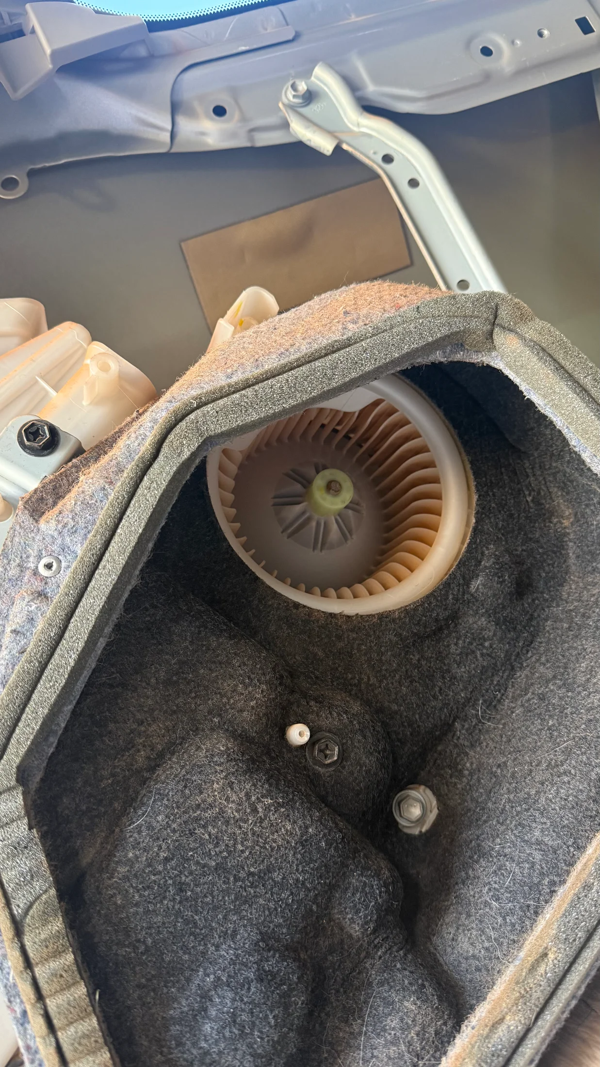

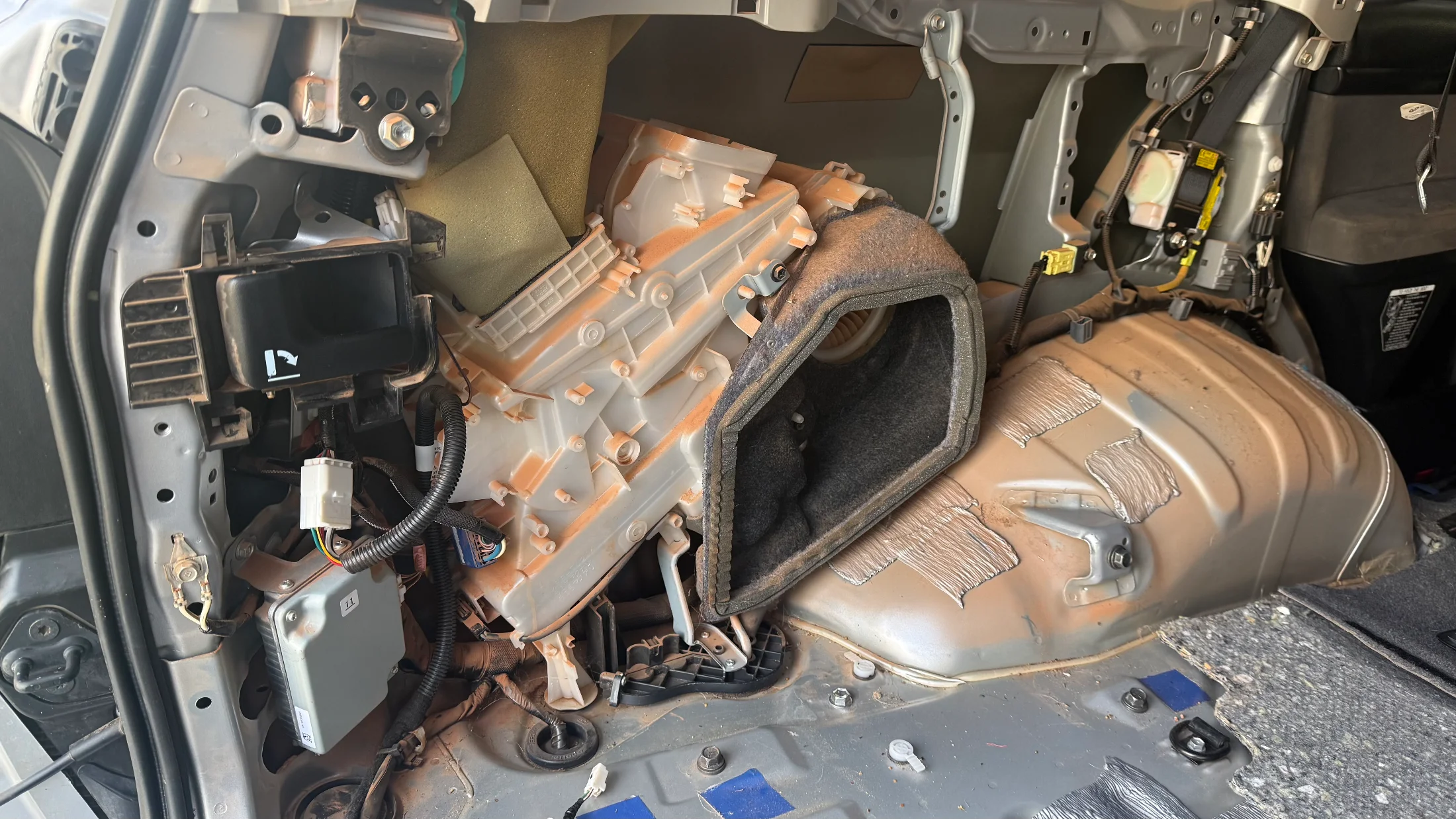

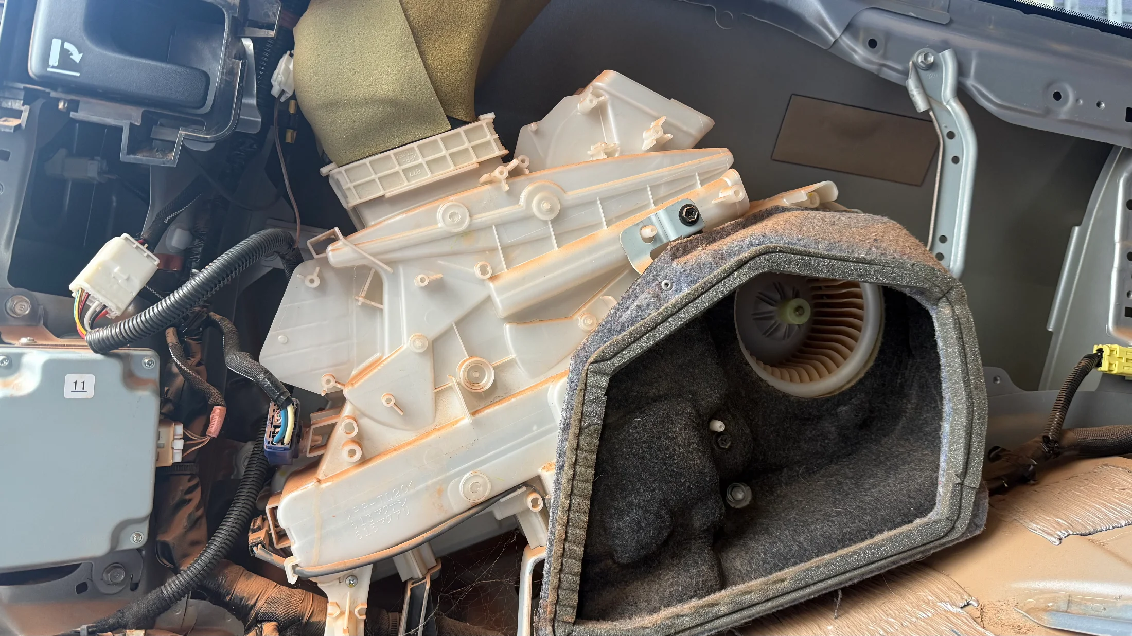

I will check as it seems dust is right through the air ducts in the cabin, even the heater duct behind the plastic panel in the cargo area is all dusty inside

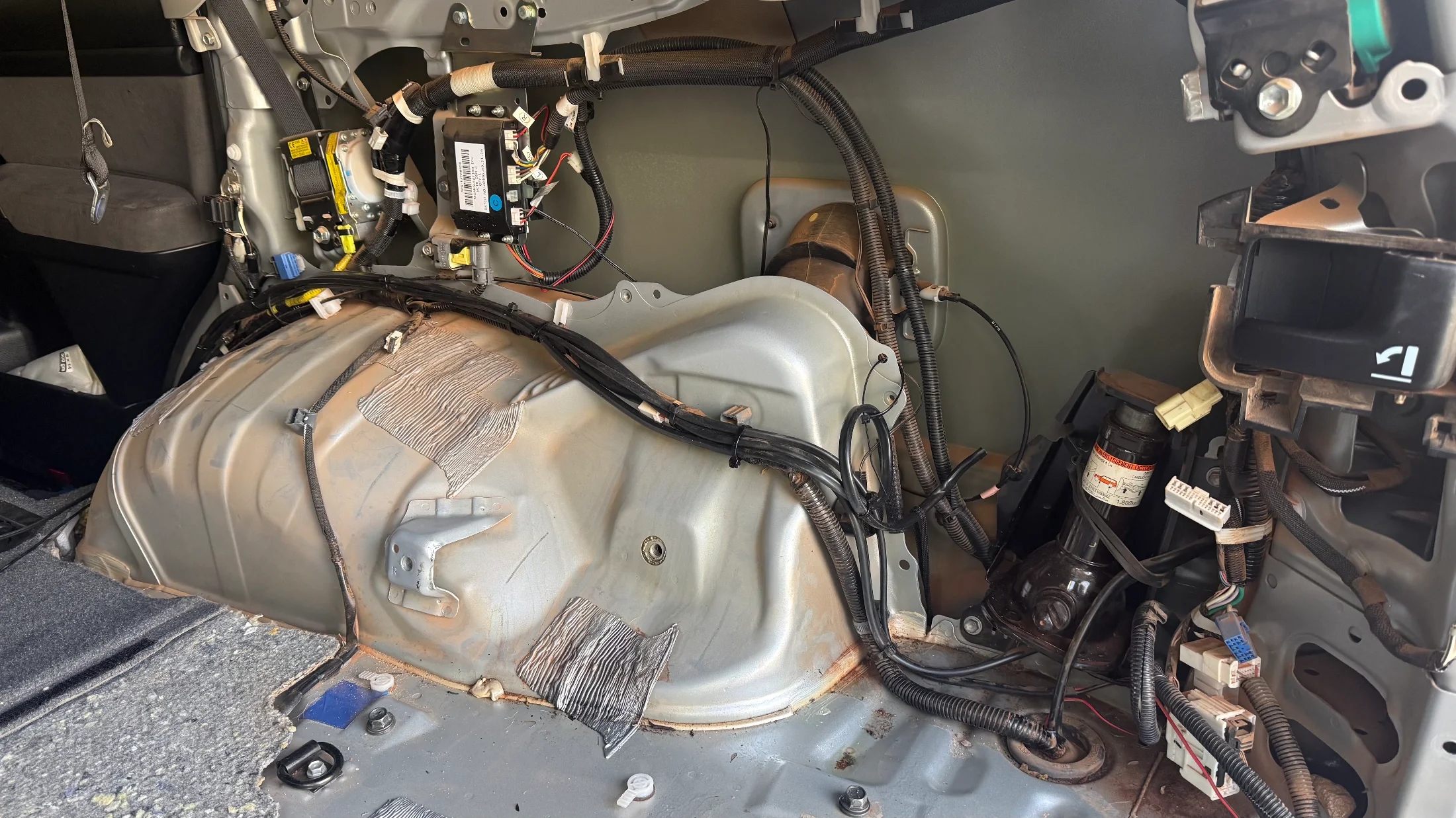

I can’t seem to find the panels that let the air out when you close the doors. It’s been mentioned that they are behind the plastic panels in the cargo but I can’t see any. Mine is a 2016 facelift model.

I can’t seem to find these vents. I have the plastic panels off. Mine is a 2016 facelift model

The holes someone mentioned are farther forward kind of under the step beside seat 2nd row, and it doesn't look like you have dust there in the pic posted. The other ones are visible and do not show dust coming in from them.
From what dust I see looks like the rear vents. (just my guess)

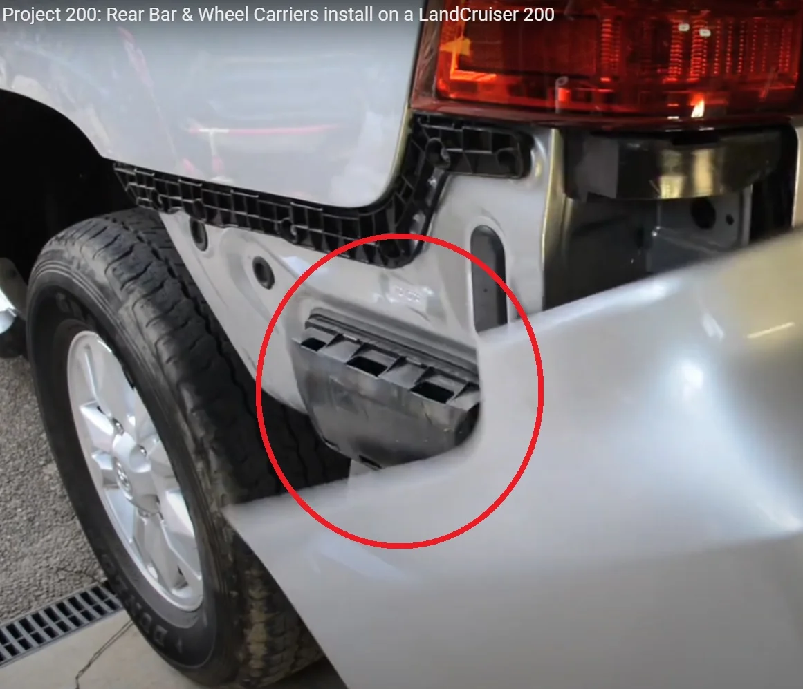

As for the vents, the outer skin that covers the rear quarter panels on the outside just pops off.
You need to first undo some screws by the rear wheel well then maybe the rear trail light loosen it? Then the skin just pulls off starting at the wheel well.
There were some pieces of black plastic covering the vents. This outside area is where I was thinking you could put in some kind of filter.
I have not had them off since I installed my rear bumper.
Maybe look at the threads on installing the rear bumpers where you need to cut the skin it will show the vent?

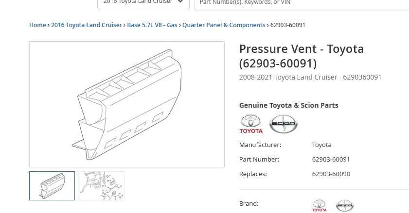

I have a 2016 LC200 Sahara, but the part is 2008-2021
If you have an aftermarket bumper it will likely be behind the bumper.
You get at them from the "outside".
this is the vent
I also had a dust problem while driving hundreds of km gravel roads. My understanding is that the pressure vent exists to ensure the vehicle does not get pressurized (closing door, air expansion when parked in hot sun, etc...). However, the car inside pressure is lower while driving, relative to the outside pressure, so these pressure vents suck in outside air, and with that also dust. Can they be filled with foam to prevent dust leaking to the inside, while still preventing pressurization of the cabin?
How can they be accessed from the in or outside?
The pressure vents have thin rubber flaps that act as a check valve to prevent air/dust/moisture being sucked into them while driving.
If you want to have a look you’ll need to pull the rear bumper skin. The vents are behind the rear tires on the sides of the body below the large side panels of the plastic bumper skin.
