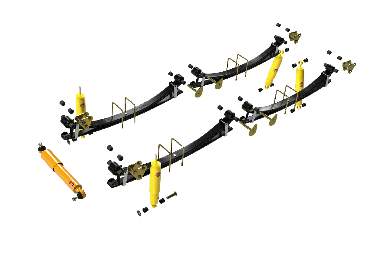

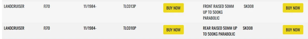

A good friend of mine has been urging me to give the TT springs a try on my troopy, but this is an immediate need:
Might as well put a 2 inch lift on it:
I like that it would be a complete kit

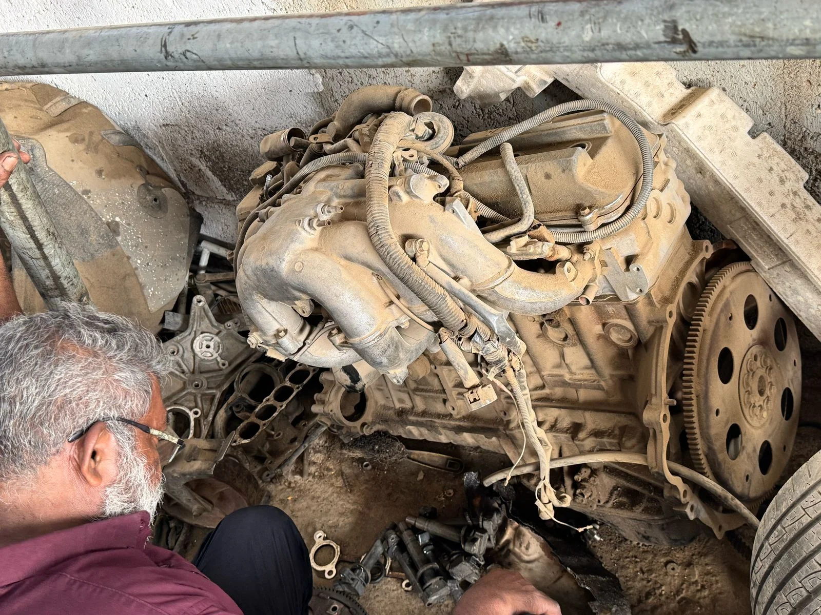

Have I mentioned that I decided to do an engine swap too? The LC70 came with a 1FZ-F and I really wanted a coil pack motor but a member of the community here had an early distributor type 1FZ-FE, frozen because of lower end issues, and I decided to get it an swap in my head. Probably none of that would work, but anyways, here is the engine I picked up.
I'm familiar with this engine because my 1993 80 has this style in it. I think the power boost from the carb 1FZ will be worth it. The story was that this was a freshly rebuilt 1FZ for which overheated 30 minutes into its first run so it seized up and then it freed up once it cooled down that the guy didn't want it anymore. So we're going to rebuild it again. But the indications are it's doable. I got it for a price consistent with this history.

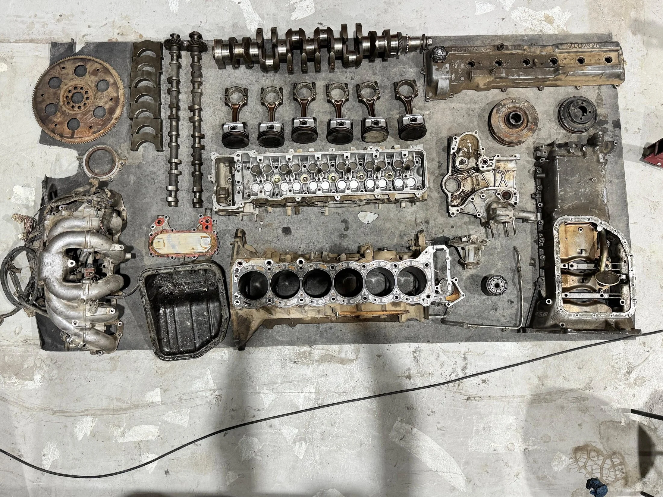

The guys took it apart and it looks surprisingly good aside from one cylinder which we will have to see after machining / honing.
