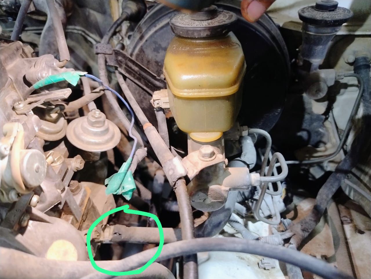

The guys figured out why the brakes sucked:

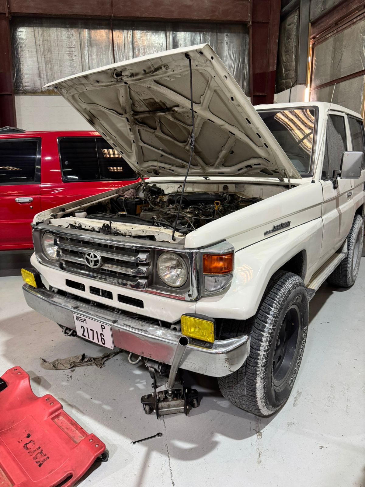

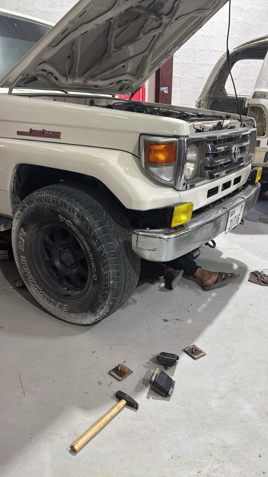

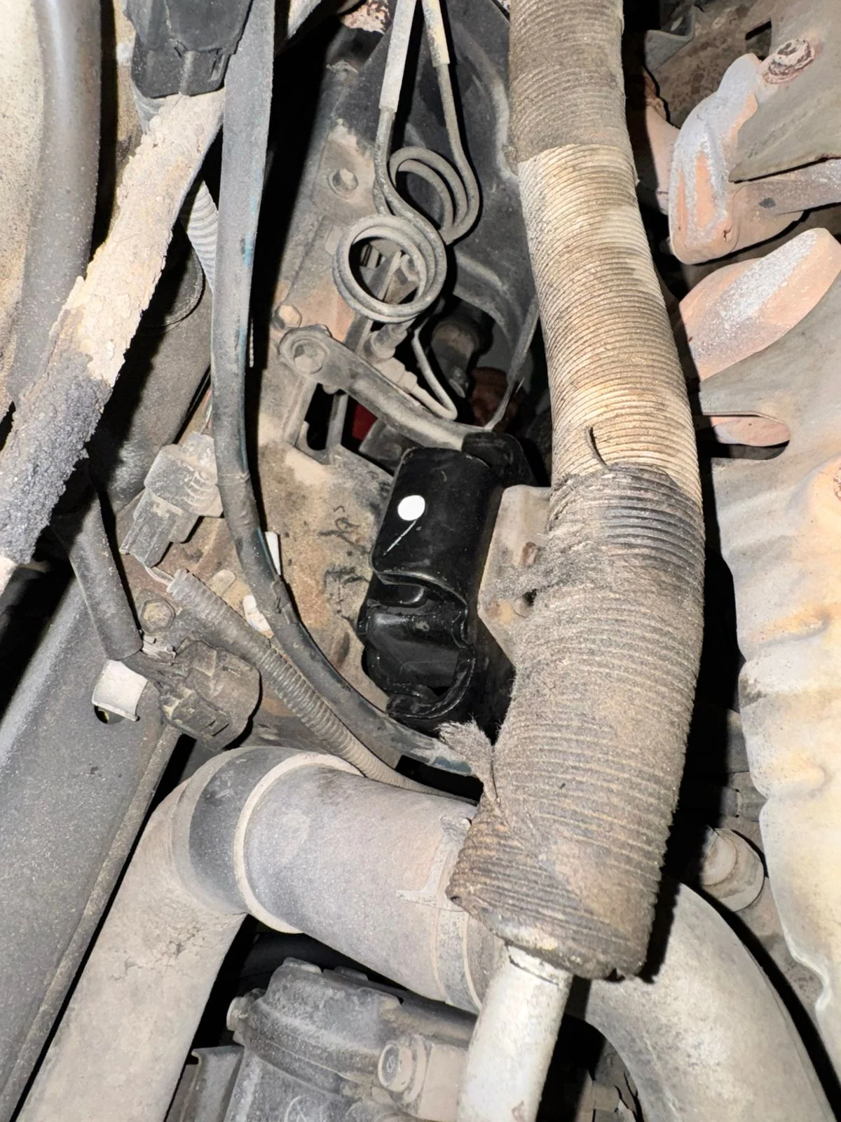

I went to the closest large parts store and was offered either Indian motor mounts, which looked good, honestly, or Mr. Toyoda's motor mounts for double the price to be delivered the next day. Initially I said yes to the Indian parts but then pulled back from that slippery slope and paid full freight for OEM. Ran me about 180 USD for the two front and one rear.

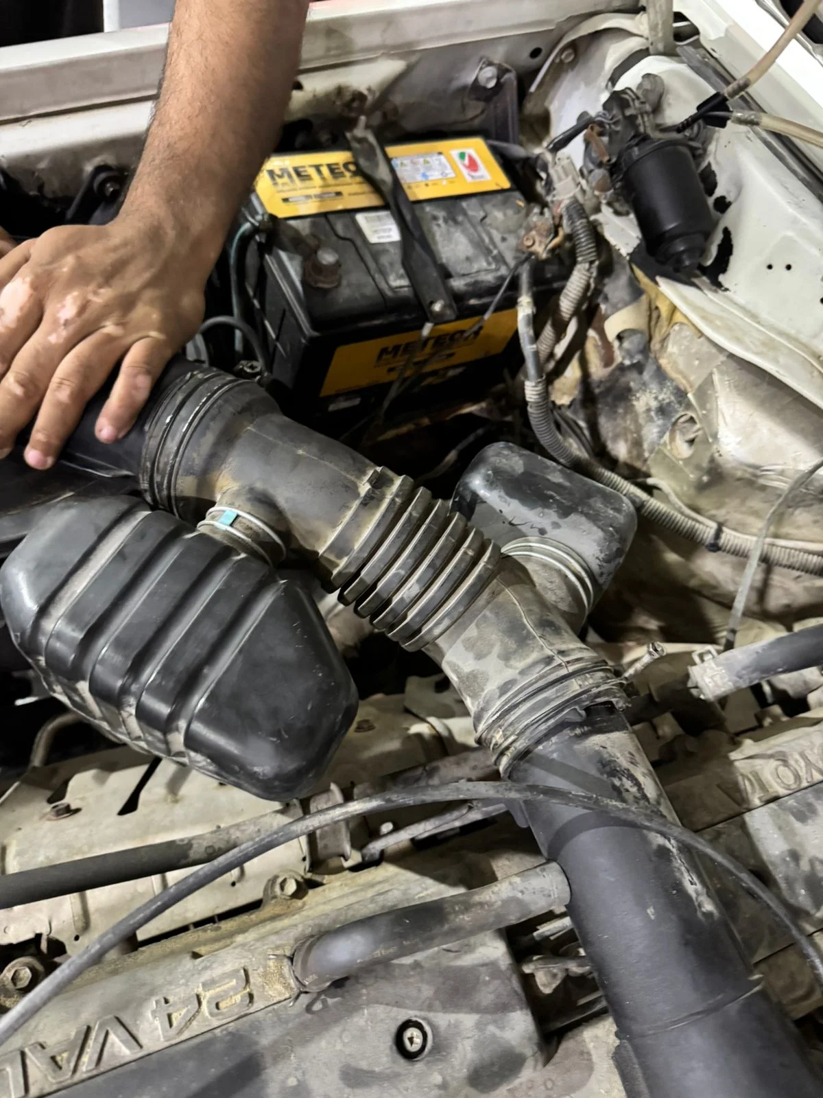

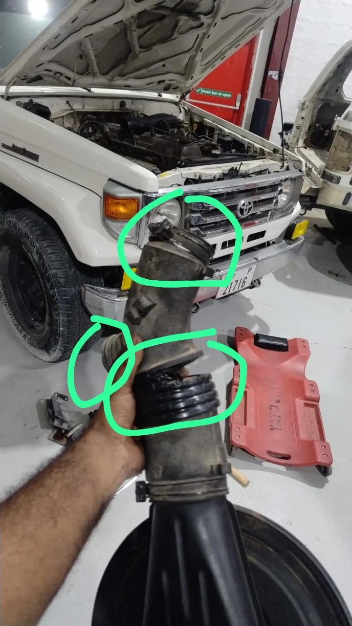

The accordion hose from the air cleaner to the carb intake was also toast.
But the good news was that we had just cleaned out a bunch of stuff and among the items was another accordion hose. I think this might have come from the Omani diesel 80, but honestly, I'm not sure. It might also have come from Mr. Blue the 105 from when we switched the 1HZ for a 1HD-T. All I know is that it fit.

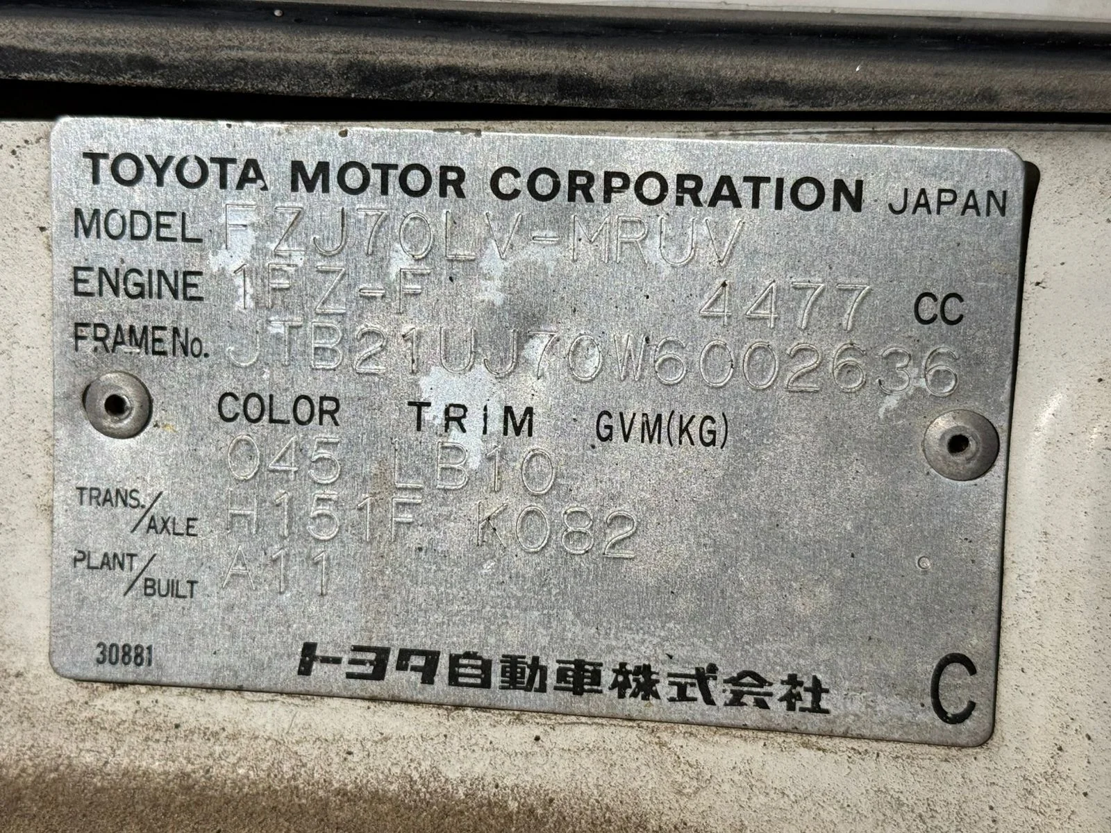

Vehicle characteristics
GRADE: STD: STANDARD TYPE
DESTINATION: GCC: GULF CORPORATION COUNCIL
BODY: HT: HARDTOP
DRIVER'S POSITION: LHD: LEFT-HAND DRIVE
ENGINE: 1FZF: 4500CC
FUEL SYSTEM: CBR: CARBURETOR (GASOLINE)
TRANSMISSION: MTM: MANUAL TRANSMISSION
GEAR SHIFT TYPE: 5F: MTM, 5-SPEED FLOOR SHIFT
BUILDING CONDITION: CBU: COMPLETELY BUILT UNIT
COLOR CODE: 045
TRIM CODE: LB10

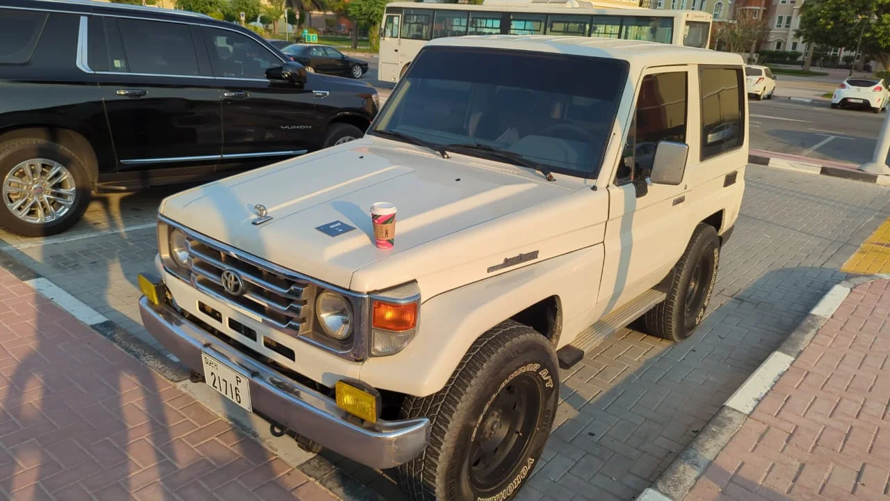

Here is tonight's beauty shot.

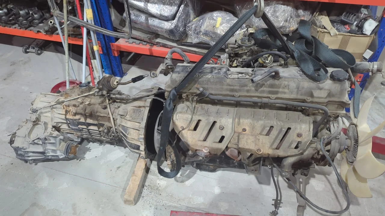

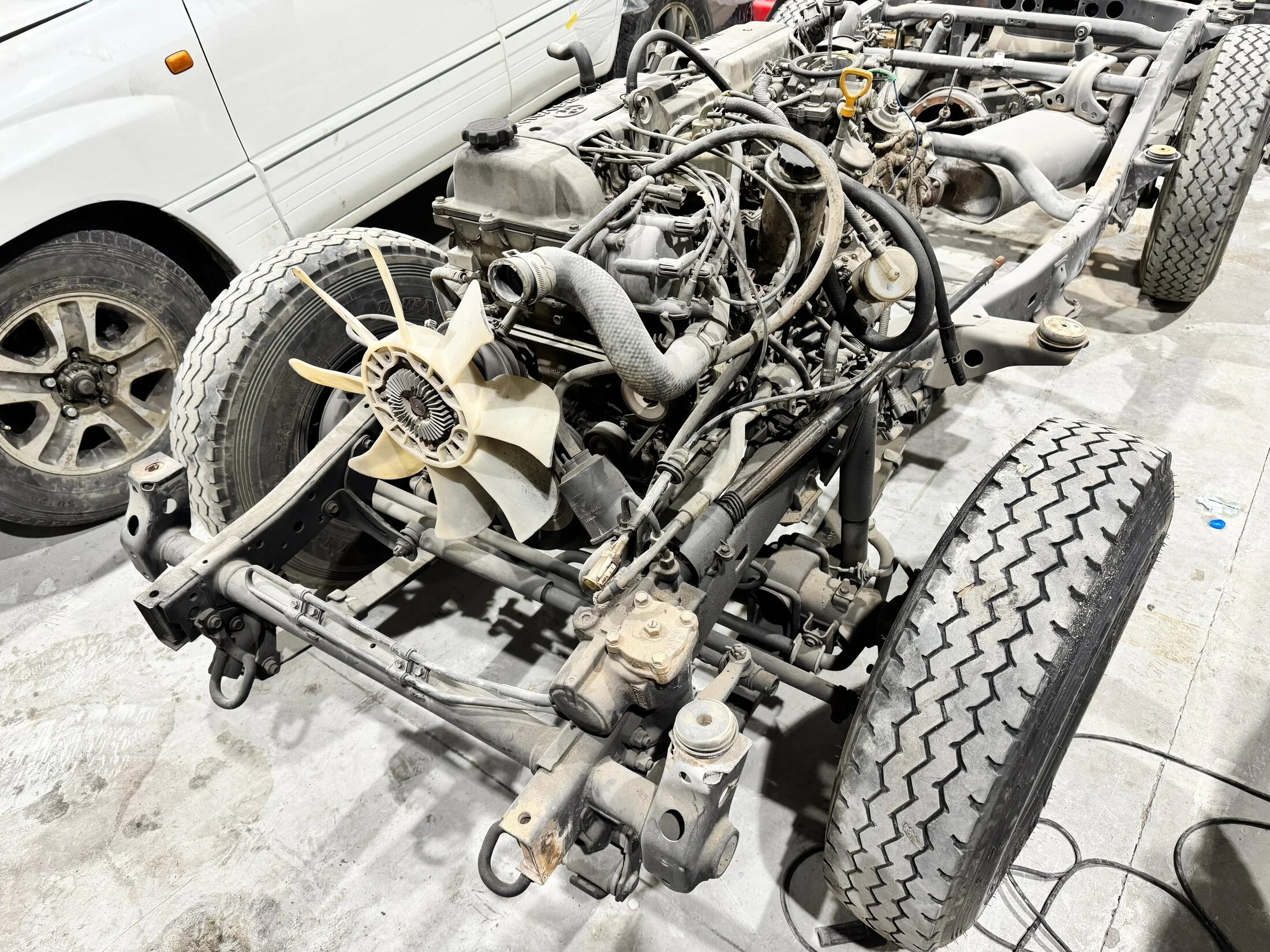

I'm way behind on posting about this project. After a careful assessment I made the decision to replace the body. The rollover damage was just too severe. Chassis looks a bit of alright tho.
Engine was running fine (until a fire) and it still looks ok

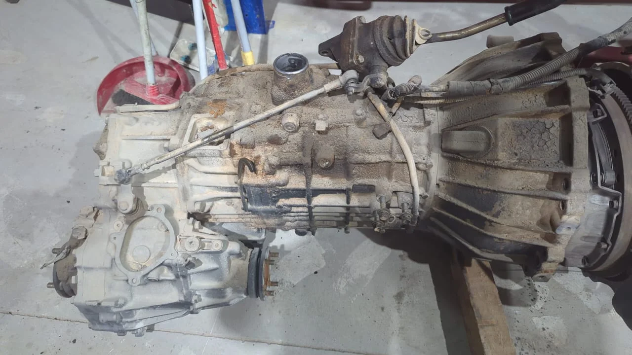

I will be taking apart the transmission to inspect and clean it, and give it a taller 5th.
The only evidence in the frame of the rollover was a twist to both front body mounts
I"m thinking this should be pretty easy to correct.

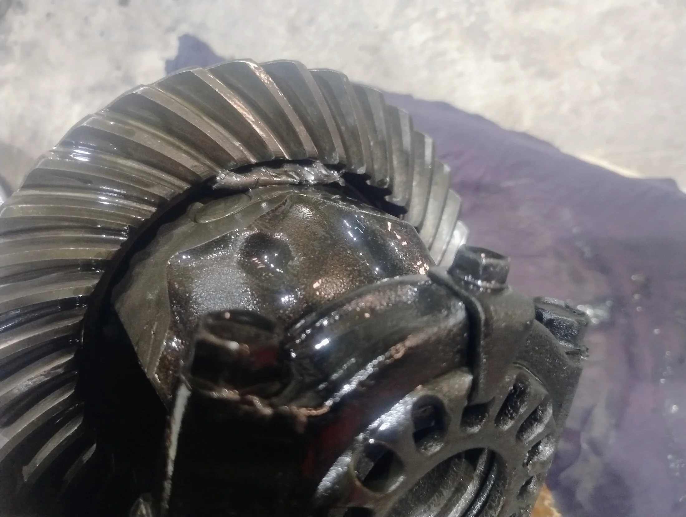

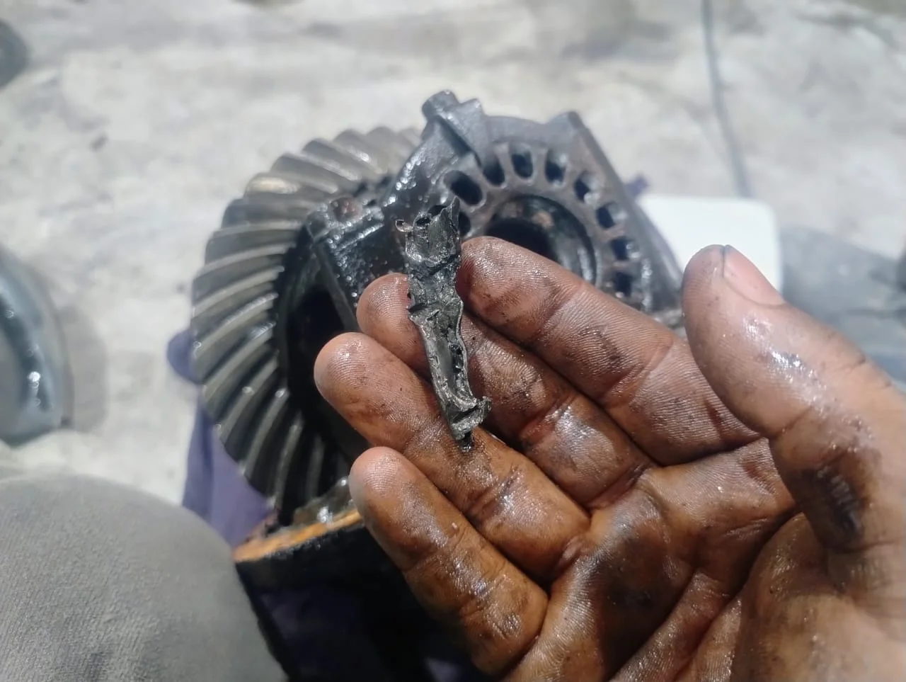

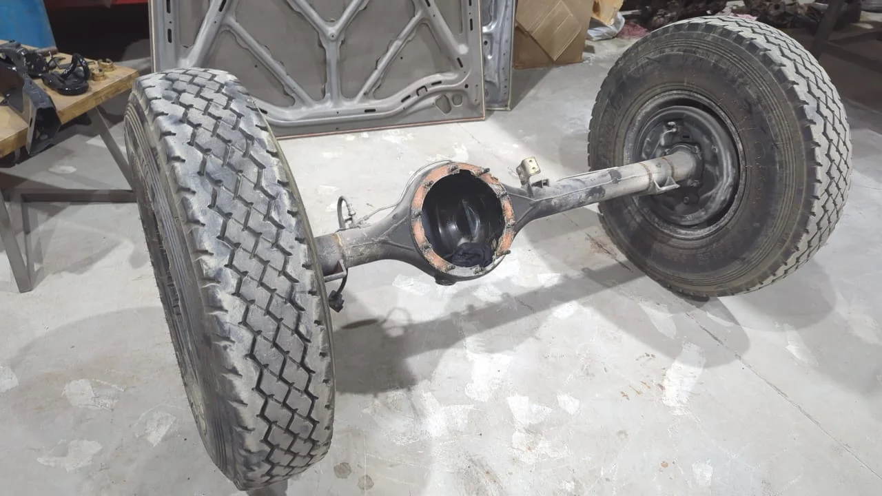

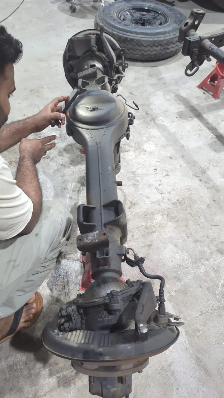

While the shorty was still drivable the rear diff grenaded. The guys partly rebuilt but I am going to take another hard look at it. It is apart anyways.
Front diff was in terrible shape with lots of metal shavings. I considered converting to spring front suspension and getting a new OEM front diff but ultimately I decided to just refub the front diff.

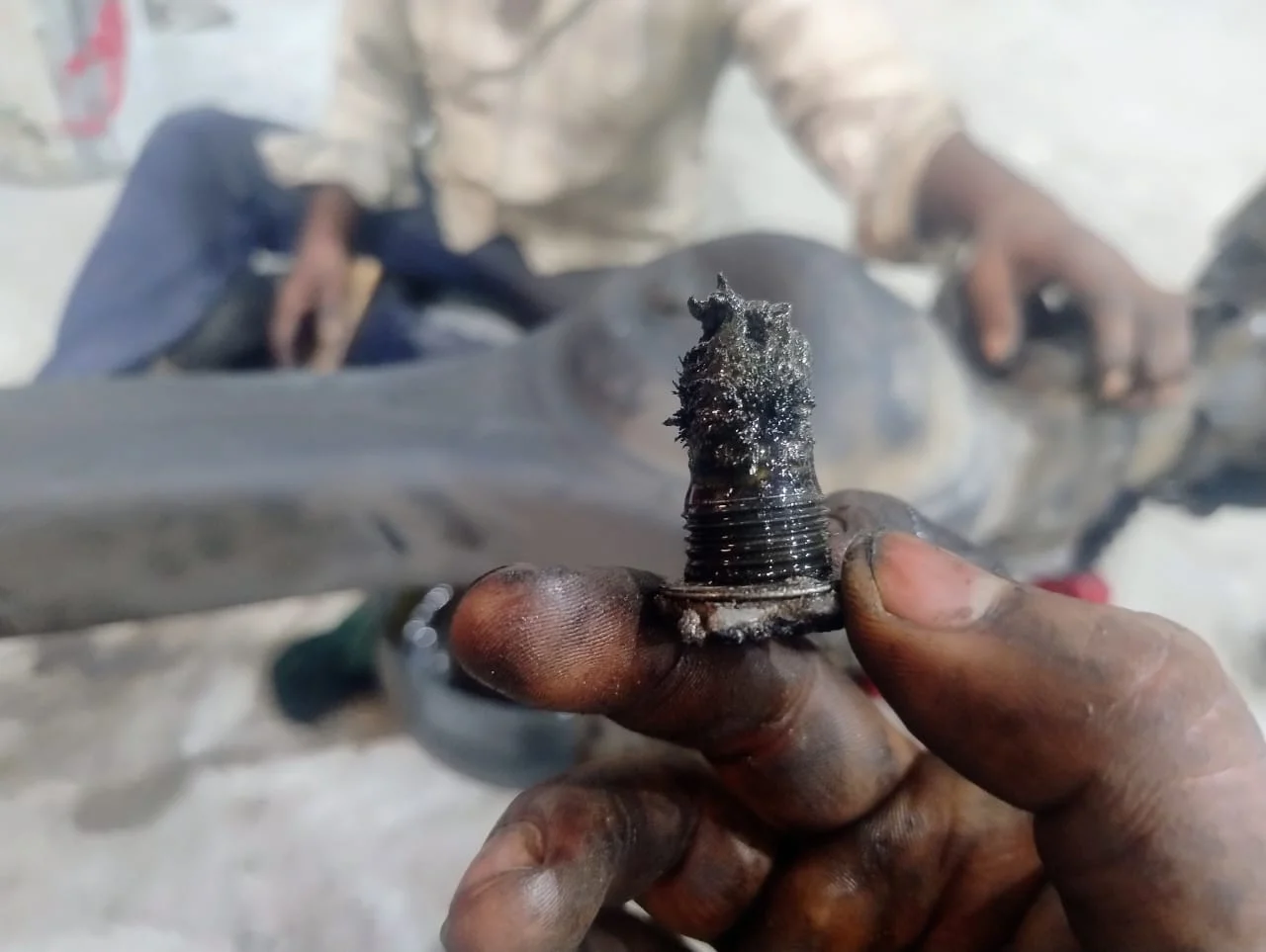

Get a load of the gear debris on the drain plug from the front diff:
There were some pretty big shreds in the bottom of the front diff.
Pretty common to see this here.

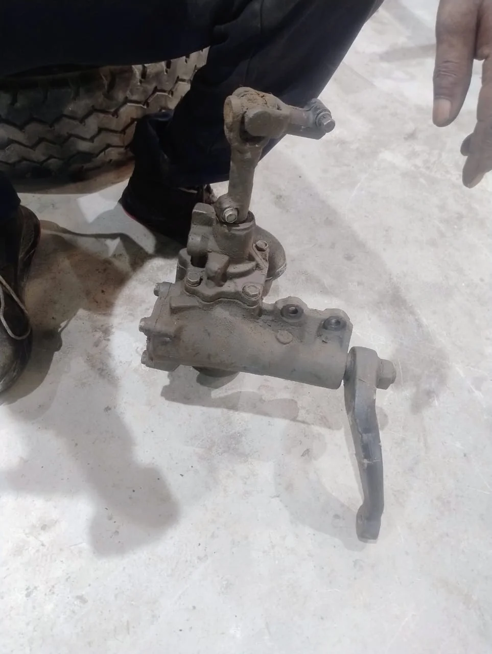

Big unknown is the steering box. I can't remember if there was a lot of play in it. I'd like to just replace it and may still do that.

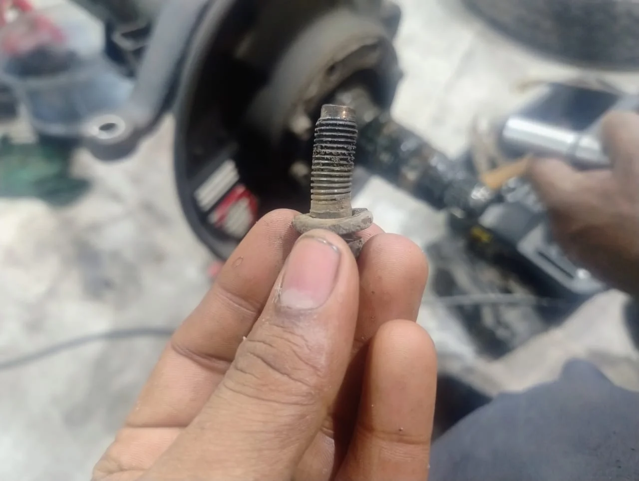

Front lug studs had obviously seen some pretty hard duty.
That wear pattern is way off from what I have been learning.

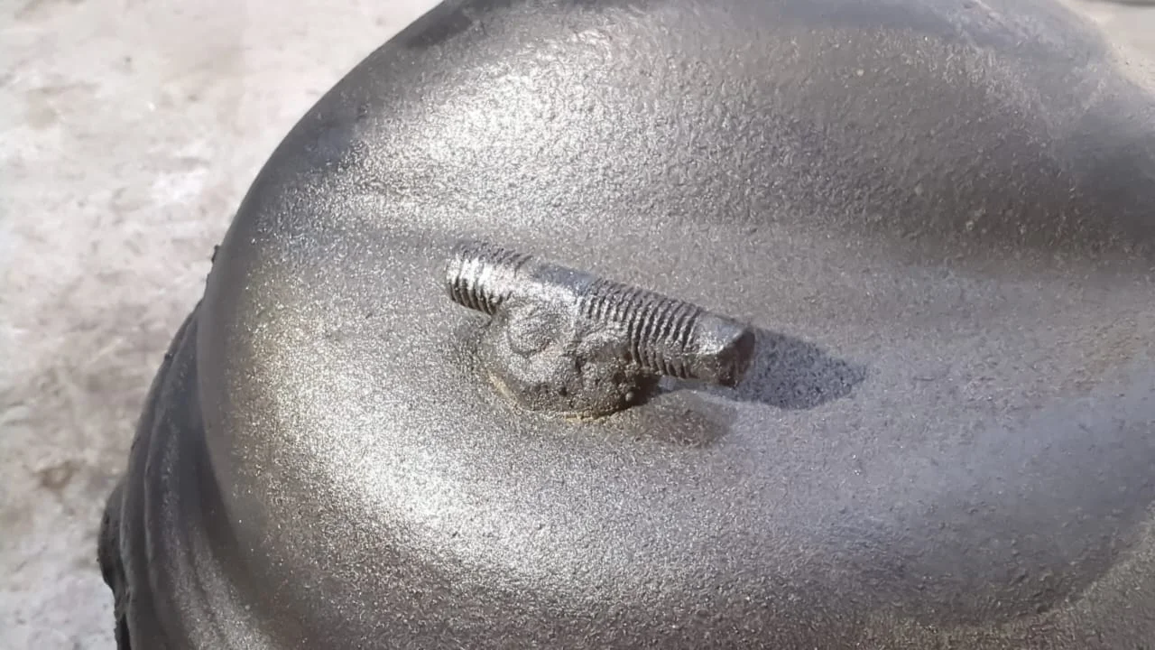

Not sure what this was:

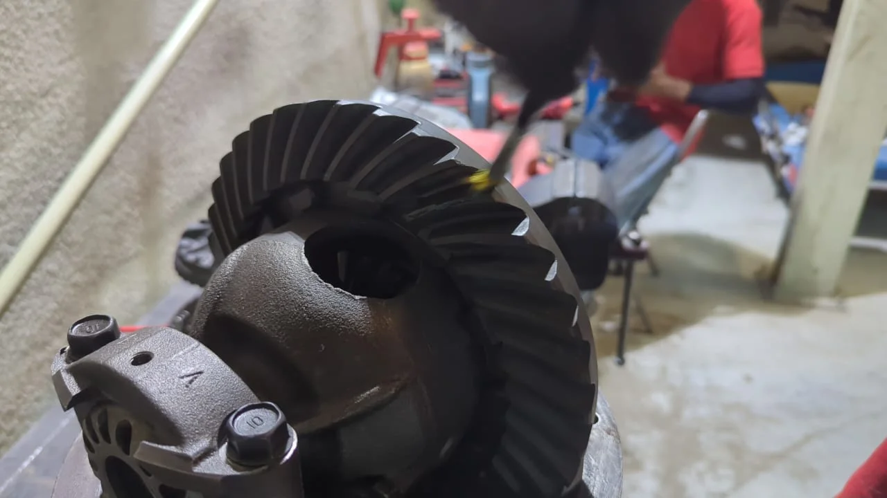

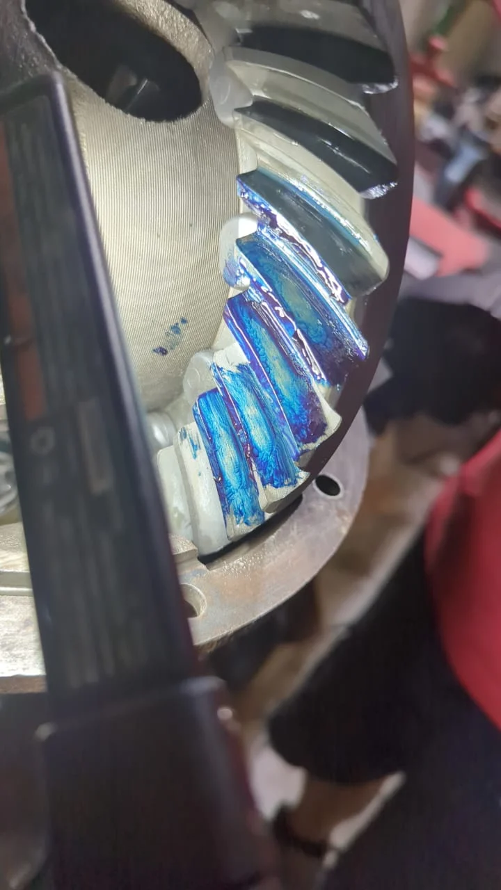

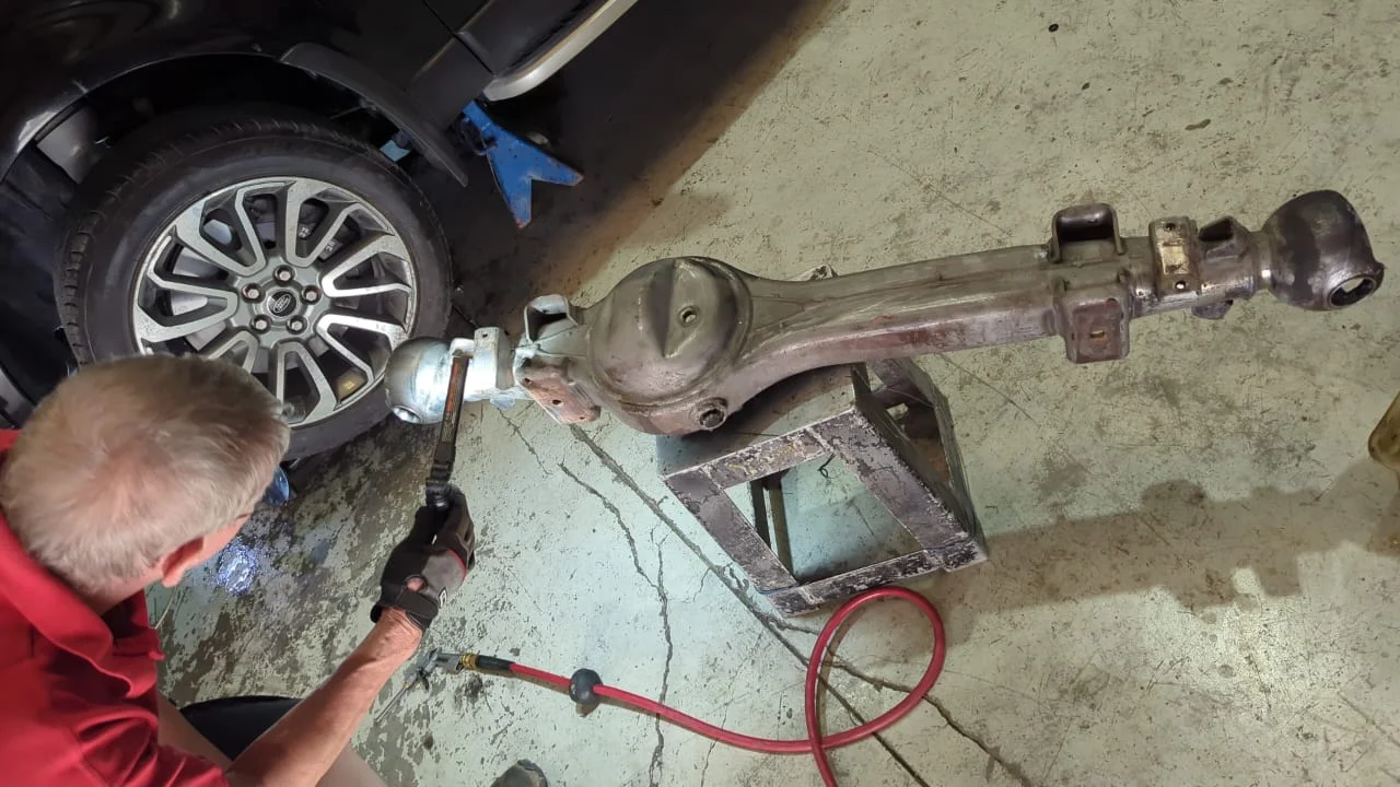

As it happens the troopy front and rear diffs are being rebuilt too (a schoolbus in a former life), and the Ancient Swede has been teaching me how to set a proper backlash on the new ring and pinion.
Armed with some new knowledge I will give rebuilding the shorty diffs myself, most likely.

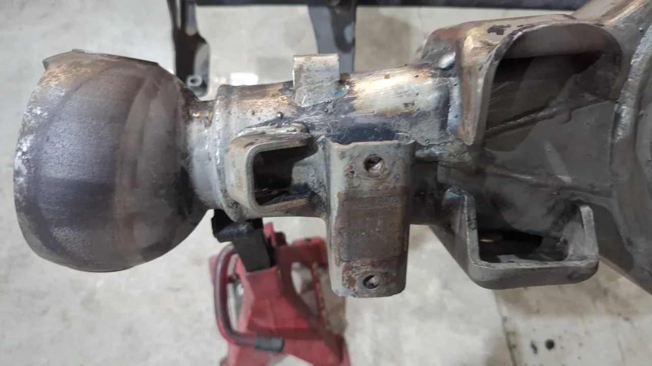

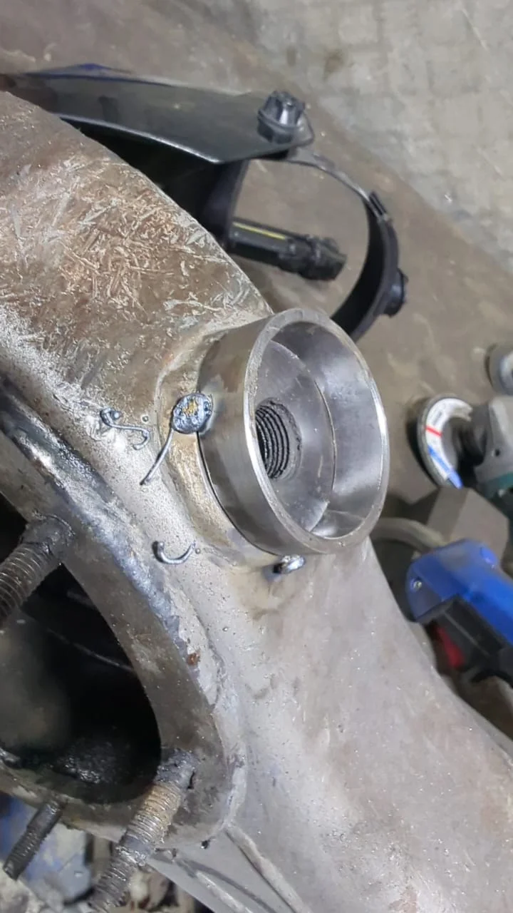

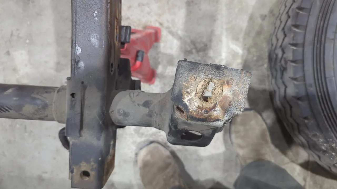

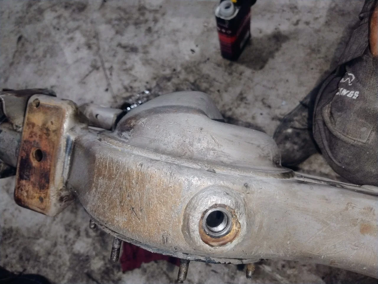

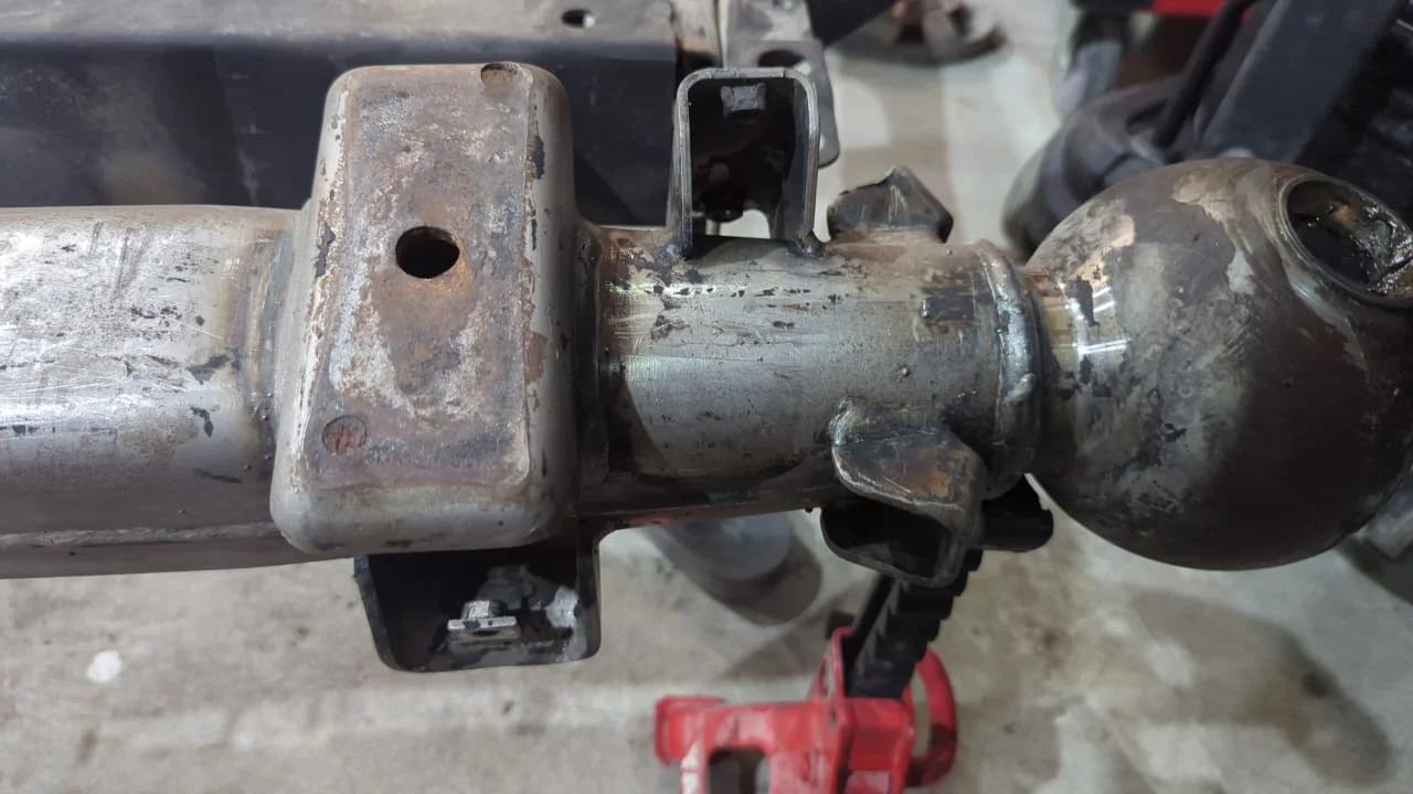

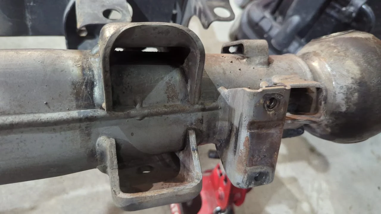

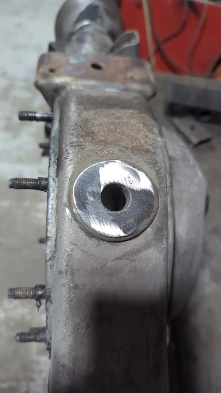

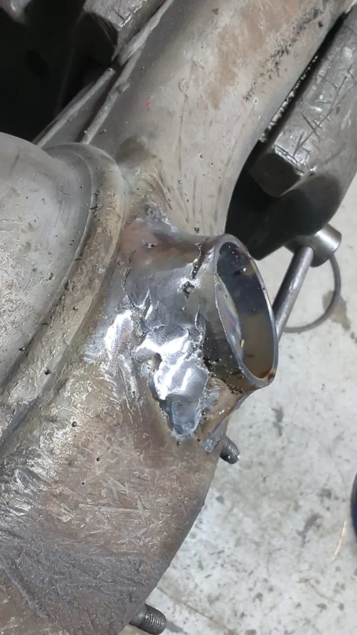

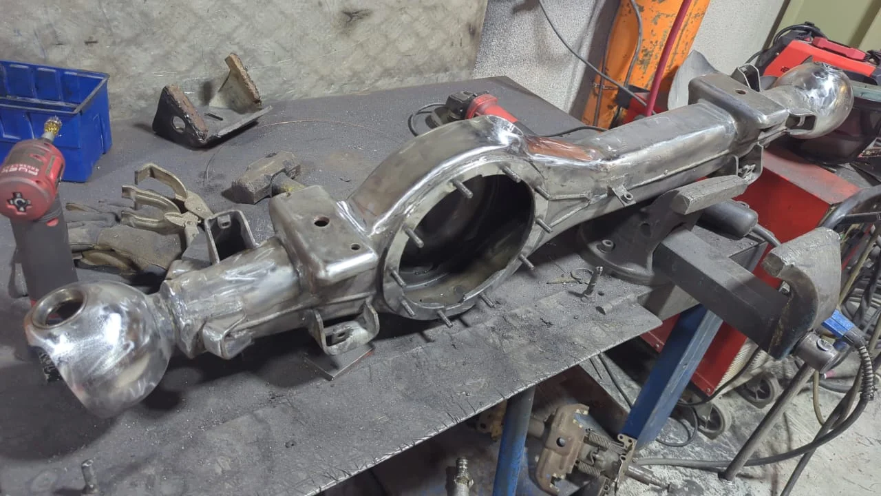

Getting back to the shorty front diff tube, the guys scraped off the gunk and most of the paint to reveal:
At first I thought it had been welded up and repaired but looking closer maybe it was factory?
Anyways I took the tube over to the Ancient Swede and he was kind enough to look it over and his feeling was that it could use a bit of freshening but could be reused.
It has definitely hit some rocks over the years.

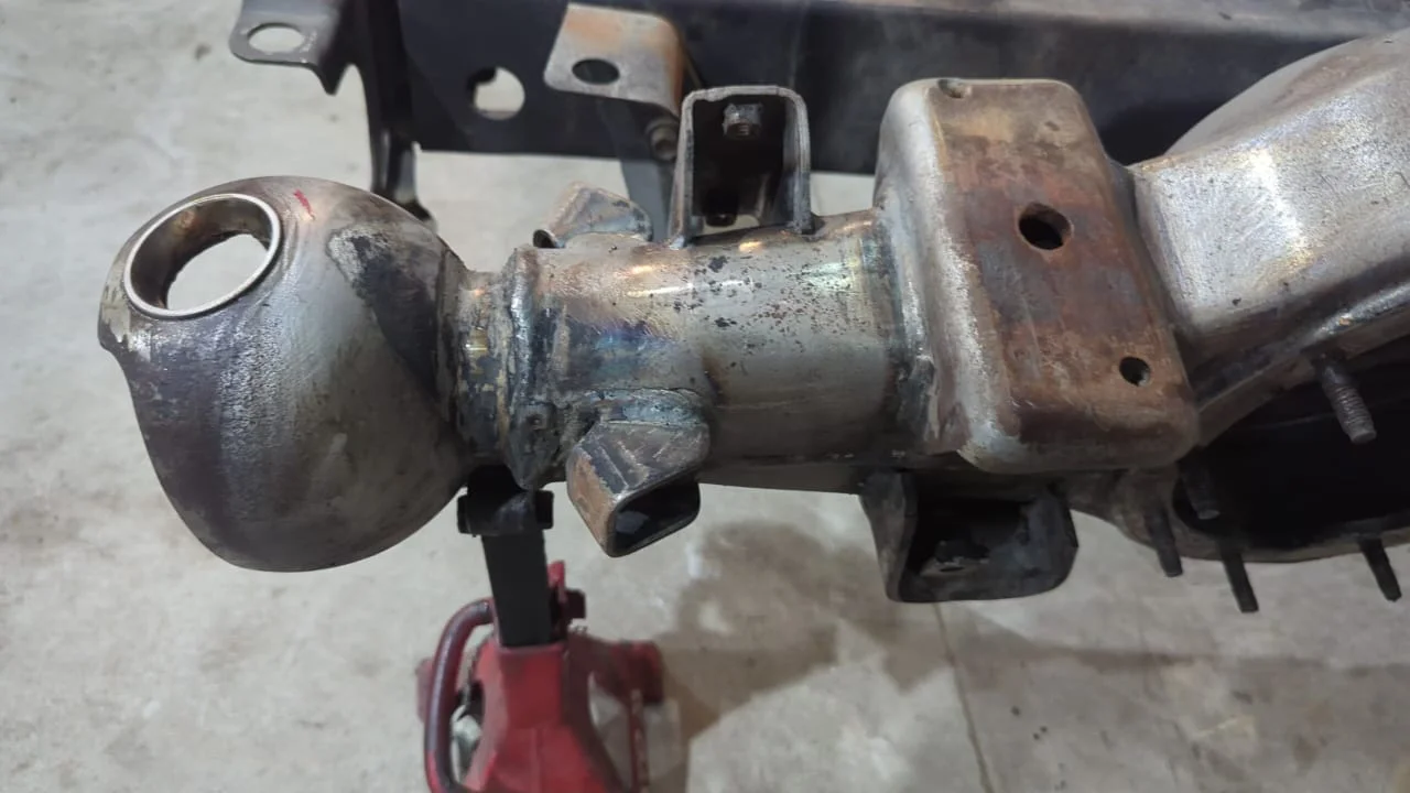

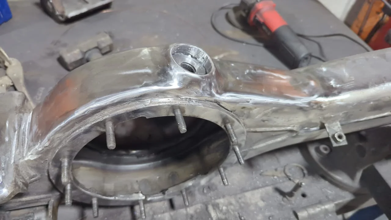

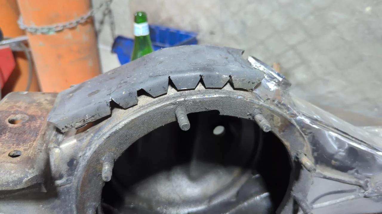

I decided I wanted to do the freshening myself, never having done this before.
Just call me John the Welder!
Yeah. Pretty awful.
But I persevered.

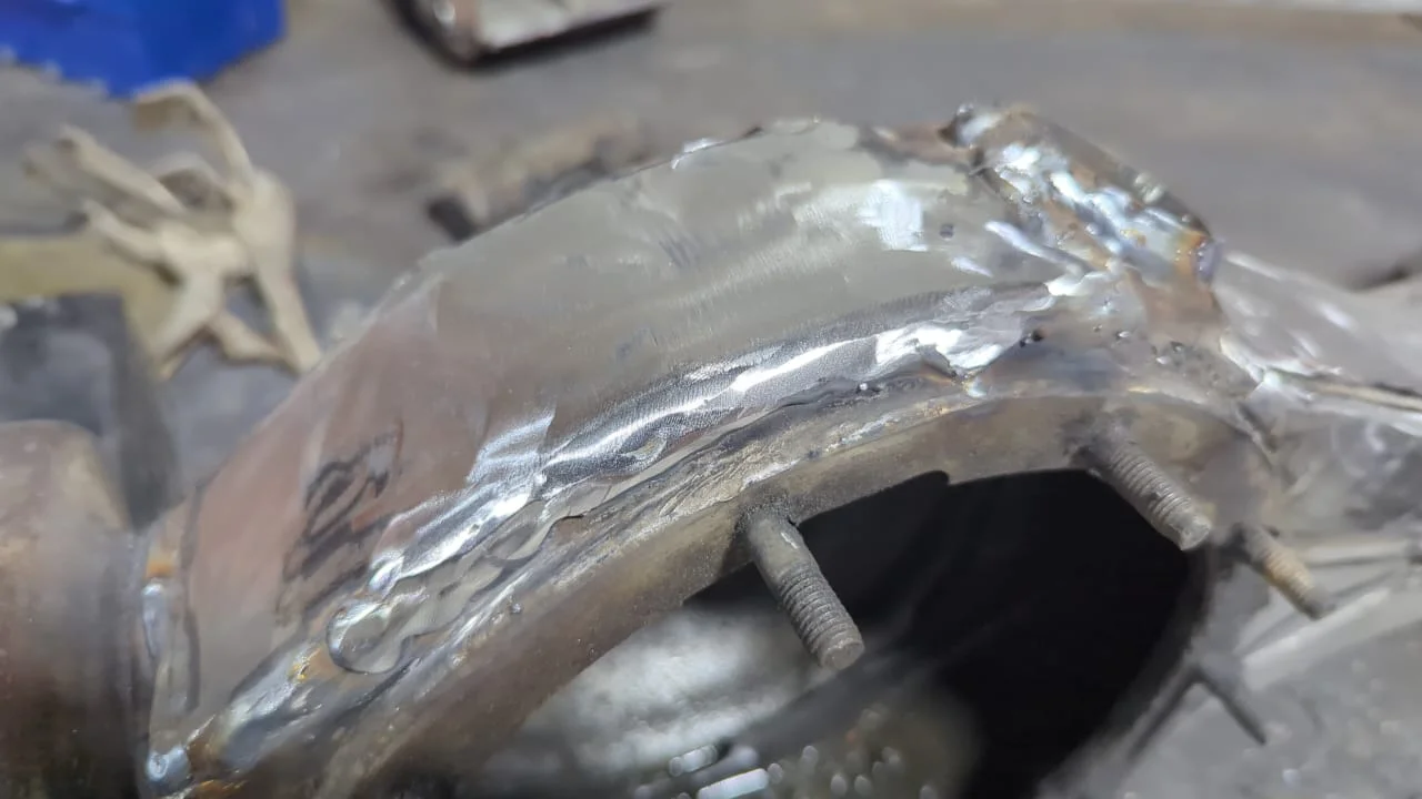

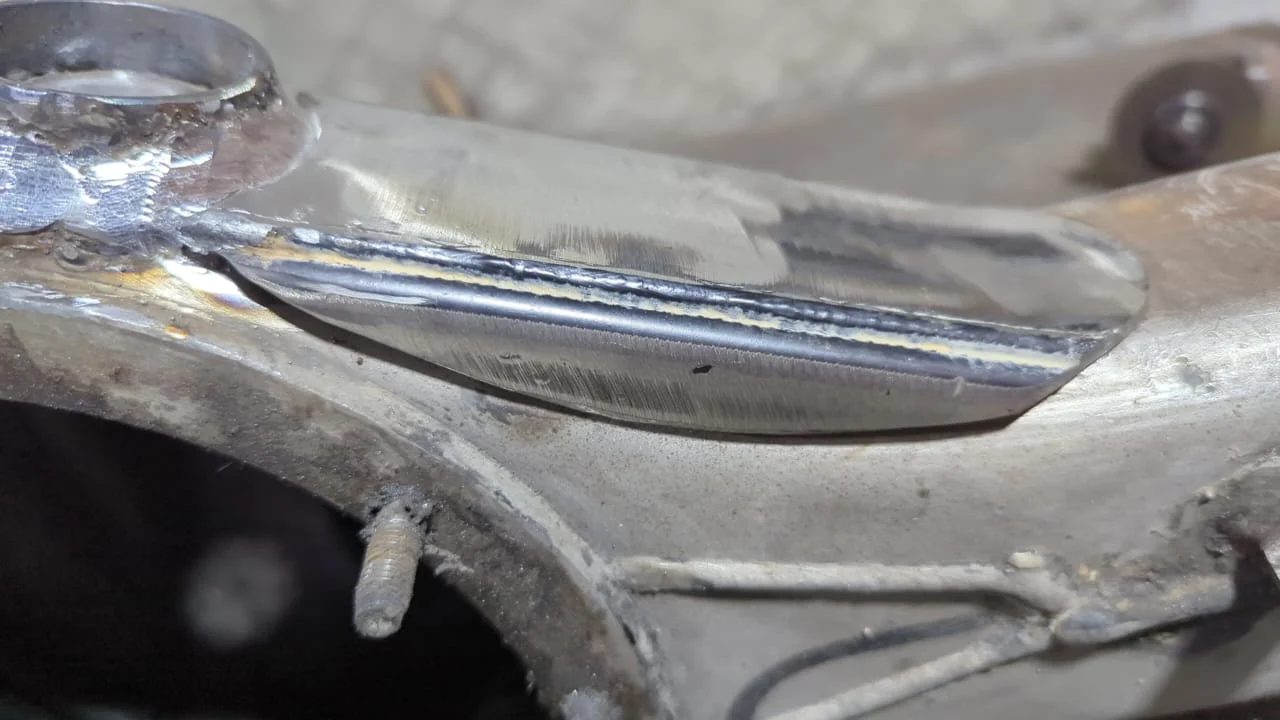

And I wanted to do something about all the gouges. And maybe also protect the pumpkin on other side of the drain plug.

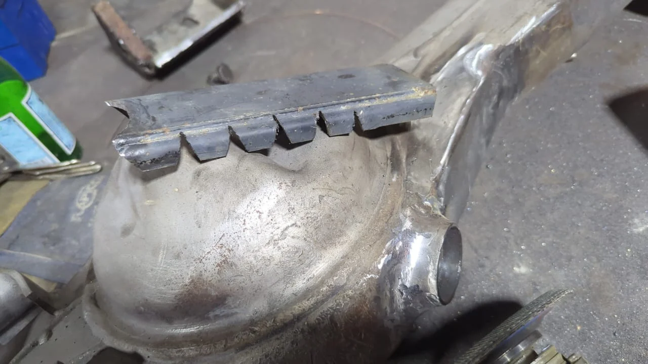

I took a section out of a handy Prado frame using a plasma cutter for the first time, and ground it into submission, starting with the easier side.
And after a while I had more or lest 'welded' and ground it into submission

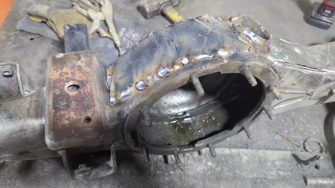

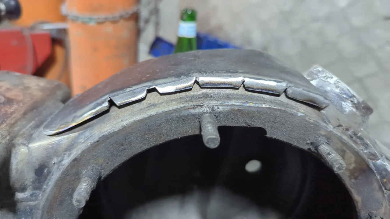

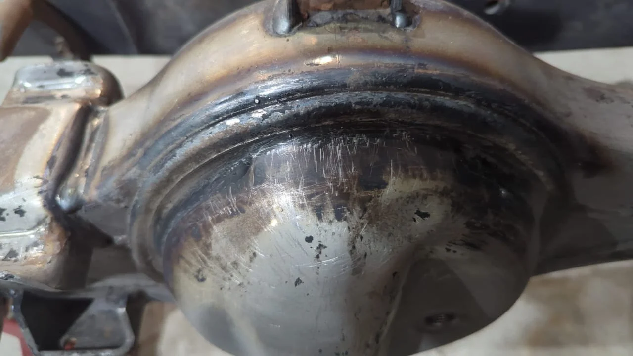

Then it was time for the more challenging other side--the side with all the gouges.
This is another chunk of Prado frame.
Took me a lot of trial and error
More "welding" and grinding
Gradually it started looking like something I might actually want on my Shorty
Today I finished it up. I am pretty pleased with the result

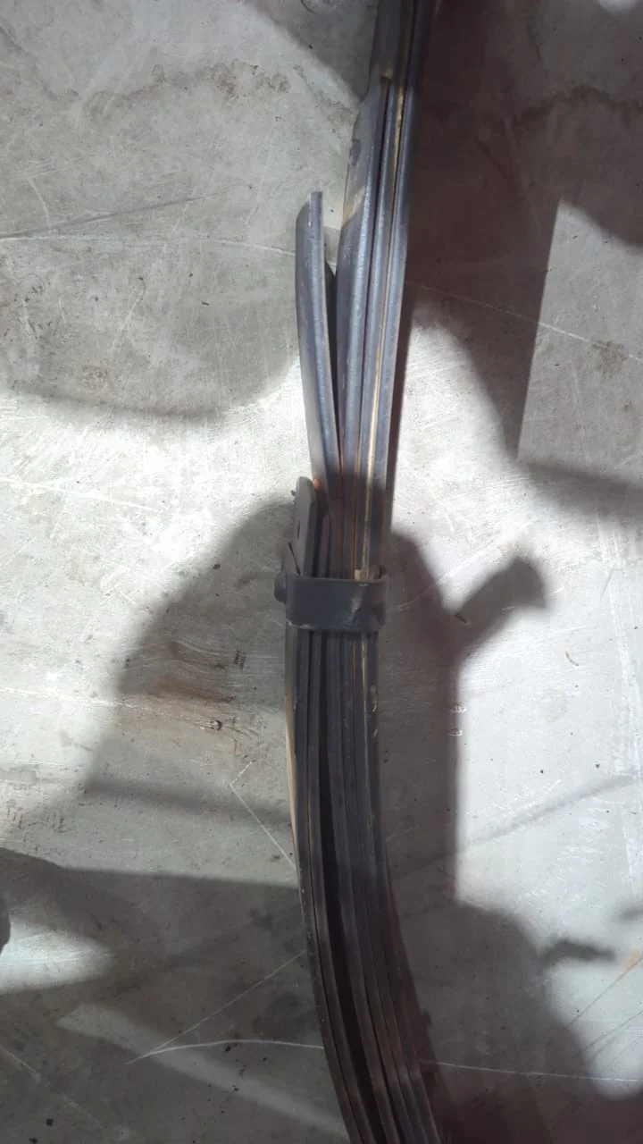

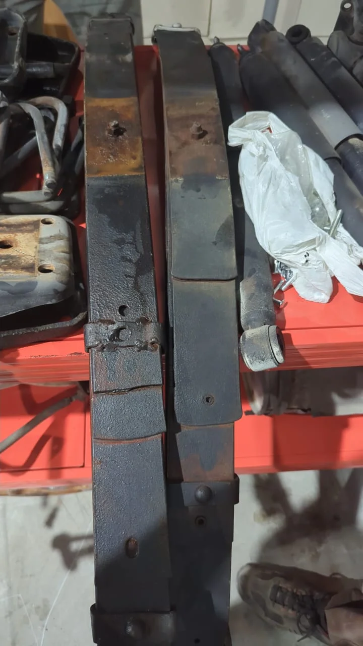

On to the next job... leaf springs front and rear. Had some broken leaves.
I took a close look at them today and took some measurements. No telling if these are original or even Toyota.
Front spring was 55cm from center in one direction and 61 in the other
Rear spring was 63cm in one direction and 60 in the other.
Given the damage, I think the springs have reached the end of their useful life. I'm contemplating trying the Terrain Tamer parabolic springs on the Shorty instead of hunting up something from the scrapyard or seeing if I can buy new OEM.
