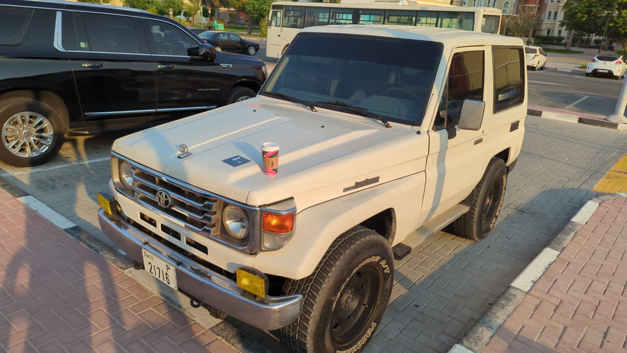

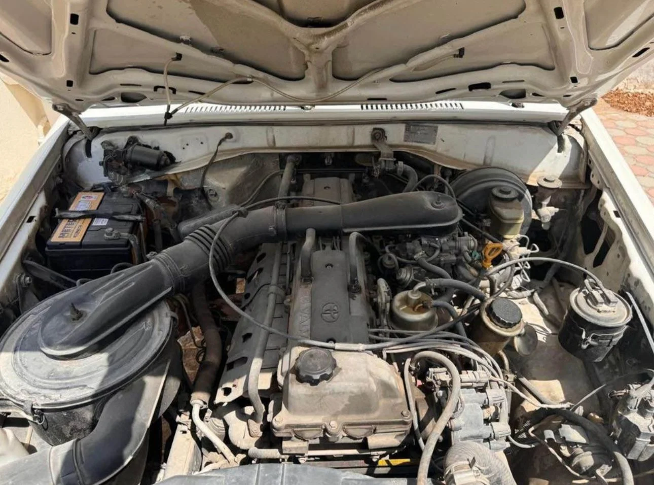

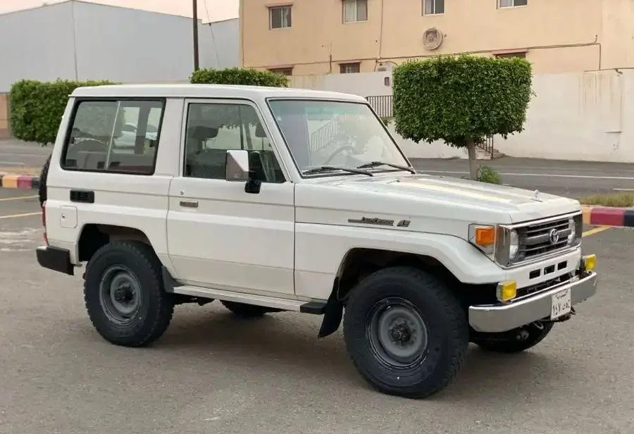

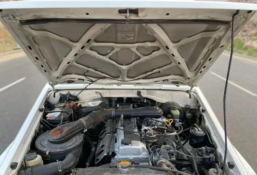

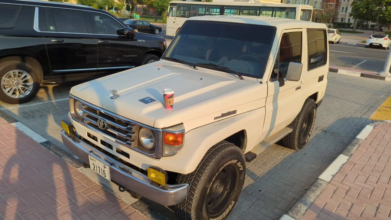

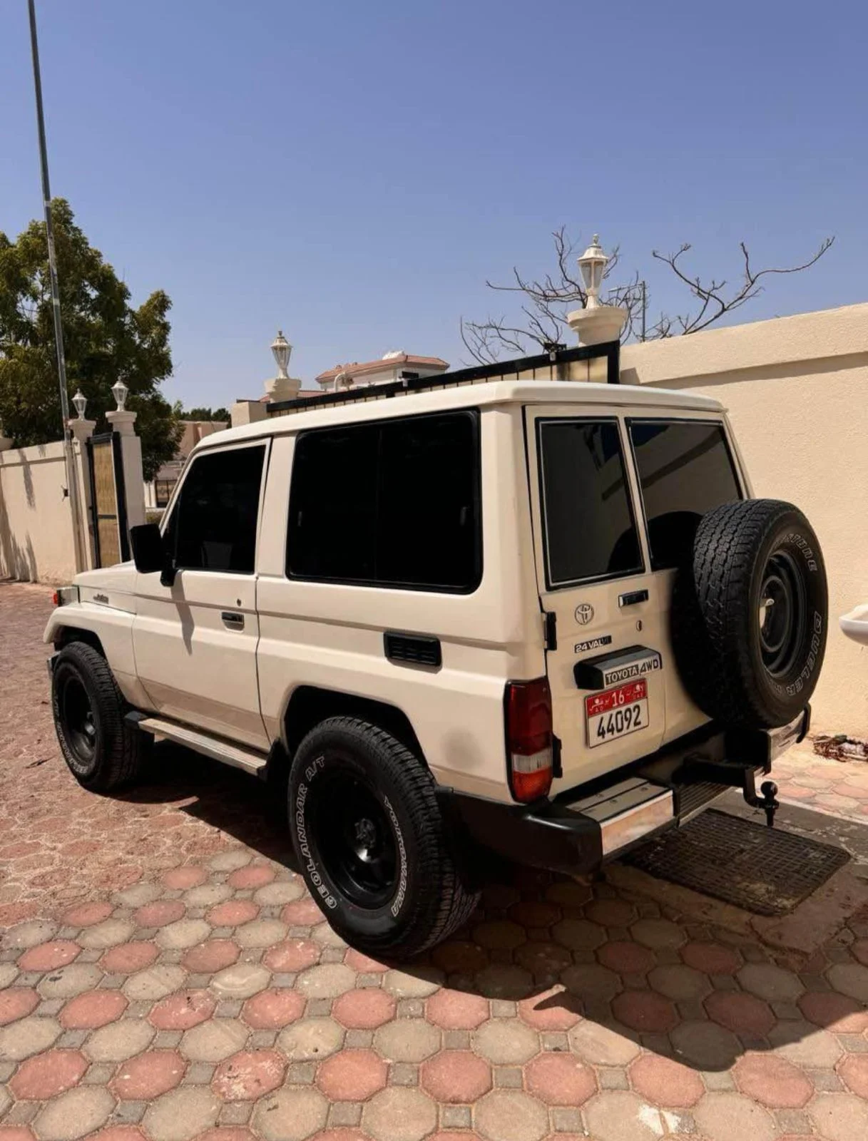

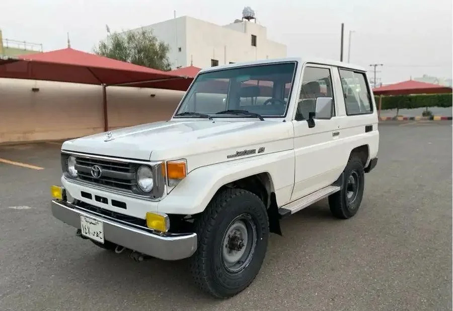

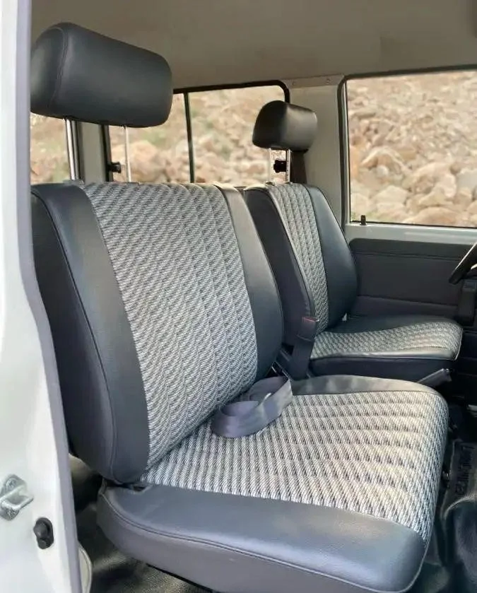

I was minding my own business getting ready to head to the US for the holidays when a friend who runs a garage I use whatsapped me about a 1998 Shorty. I have mentioned a few times that the very last LC I intend to buy is a 70-series 2-door. I was holding out for a 1HZ, but shorties in general are not common here and sometimes something comes along at a weak moment. This was one such moment. I've just retired and I had my legally-mandated 'end-of-service' payment burning a hole in my pocket, then this friend send me these photos--sellers photos!
That is 490k km or about 205k miles, which is manageable on a 70 series.
It looked cute in the photos and I have been thinking that a shorty 70 series would complete my 'collection' of Middle East Land Cruisers. And this one was a 1998 model year which meant that it could come home to the US immediately and be a little daily runabout for me. (Yes I was stretching to find some kind of justification.)

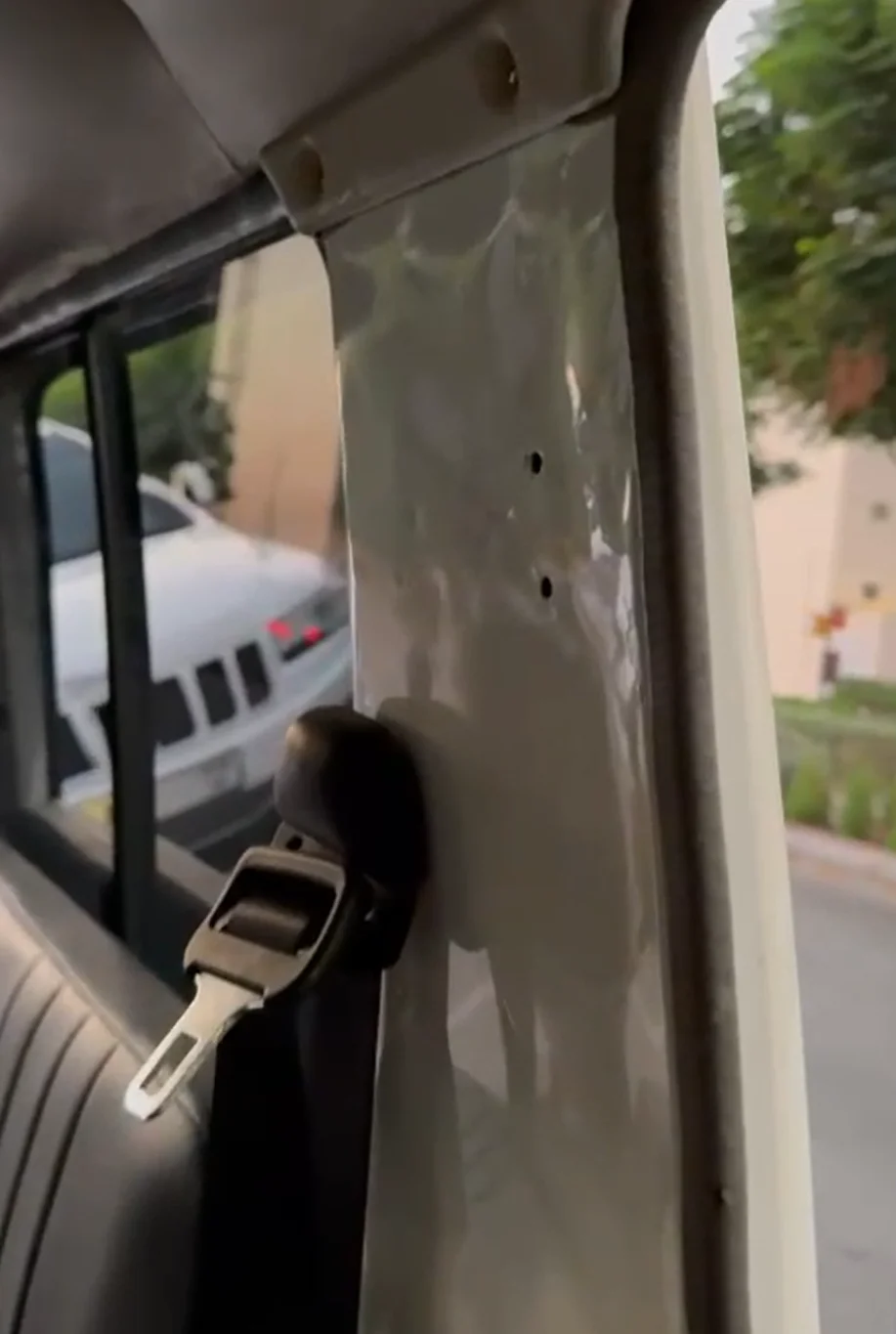

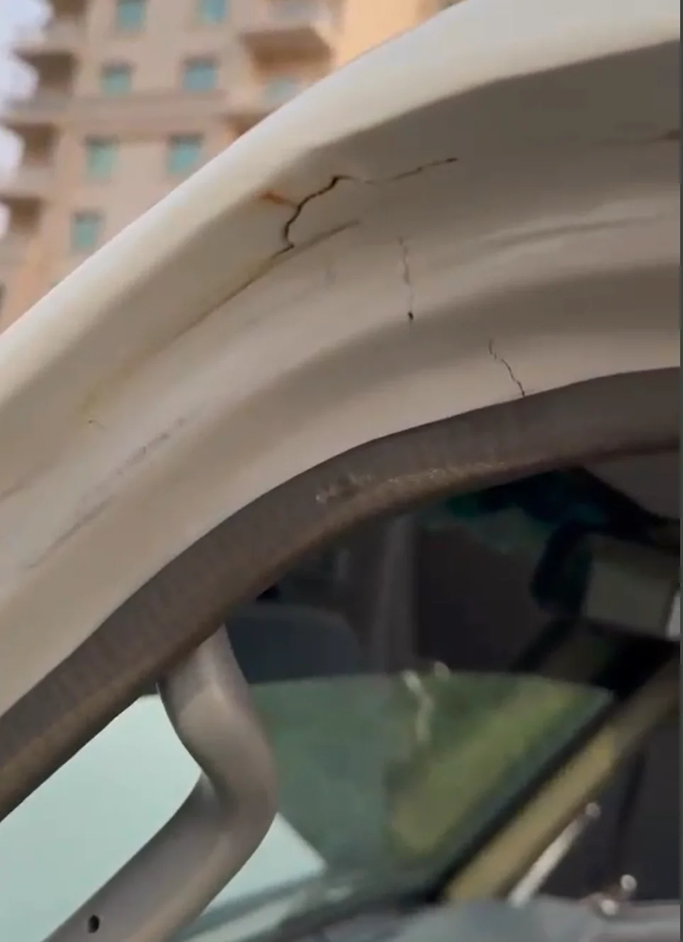

My friend reported that he noted some body damage on the left side and he suspected it had been through a rollover event.
But my friend said that he had crawled under it and the frame looked good and there was no apparent body damage to the underside. Just driver side above the beltline.

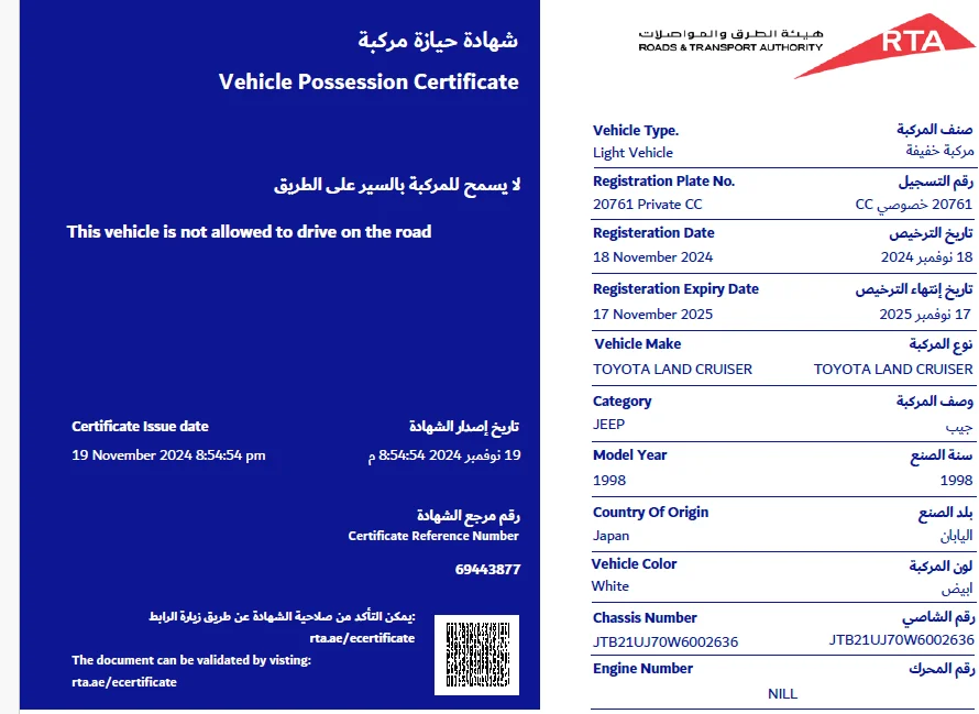

My friend schlepped the seller over to the Roads and Transport Authority office (which is open quite late) and otherwise facilitated the transaction and I ended up with a Possession Certificate:

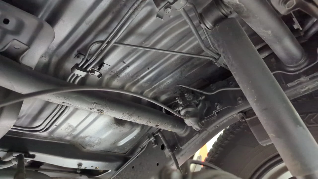

Today I was able to go see my purchase. And we put it up on the lift.
It is kind of interesting that the wheelbase is so short that you have to drive forwards and backwards to get both arms of the lift under the car!

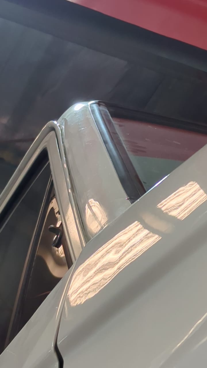

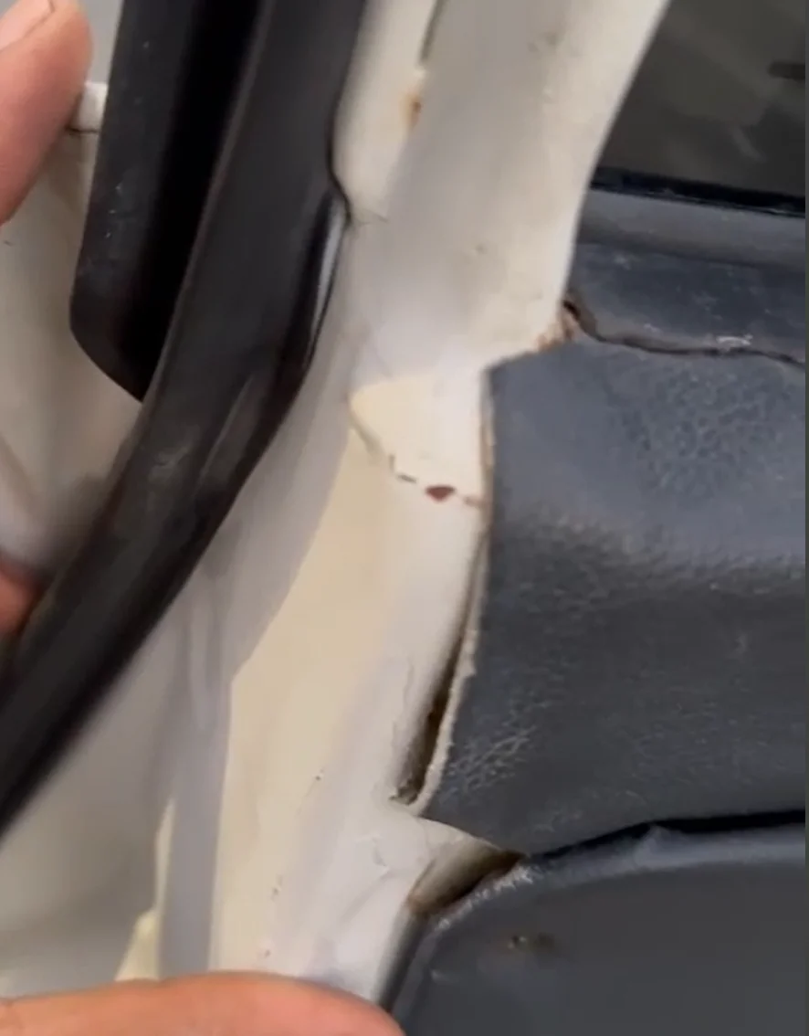

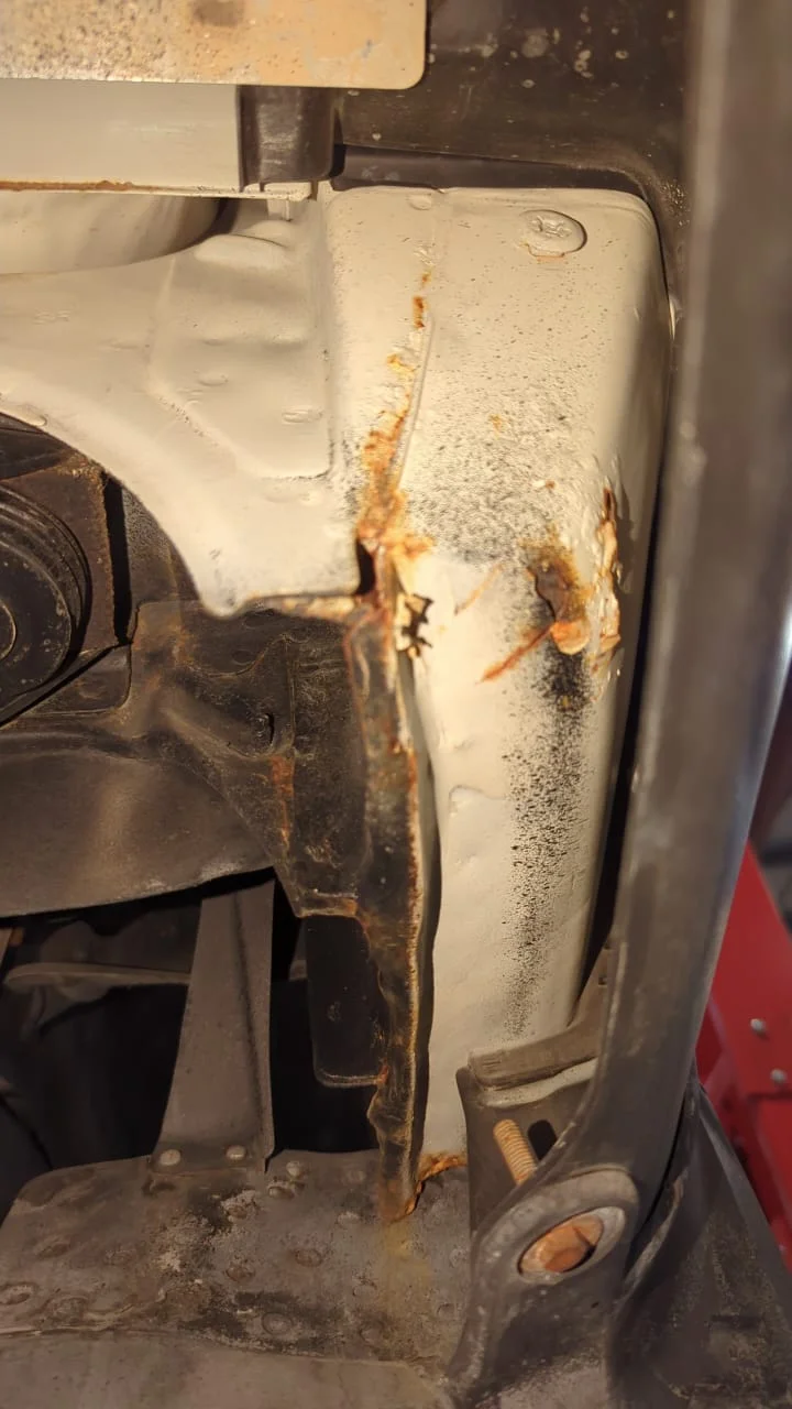

It definitely has body damage of some sort. The A pillars are loaded with a thick coat of bondo.

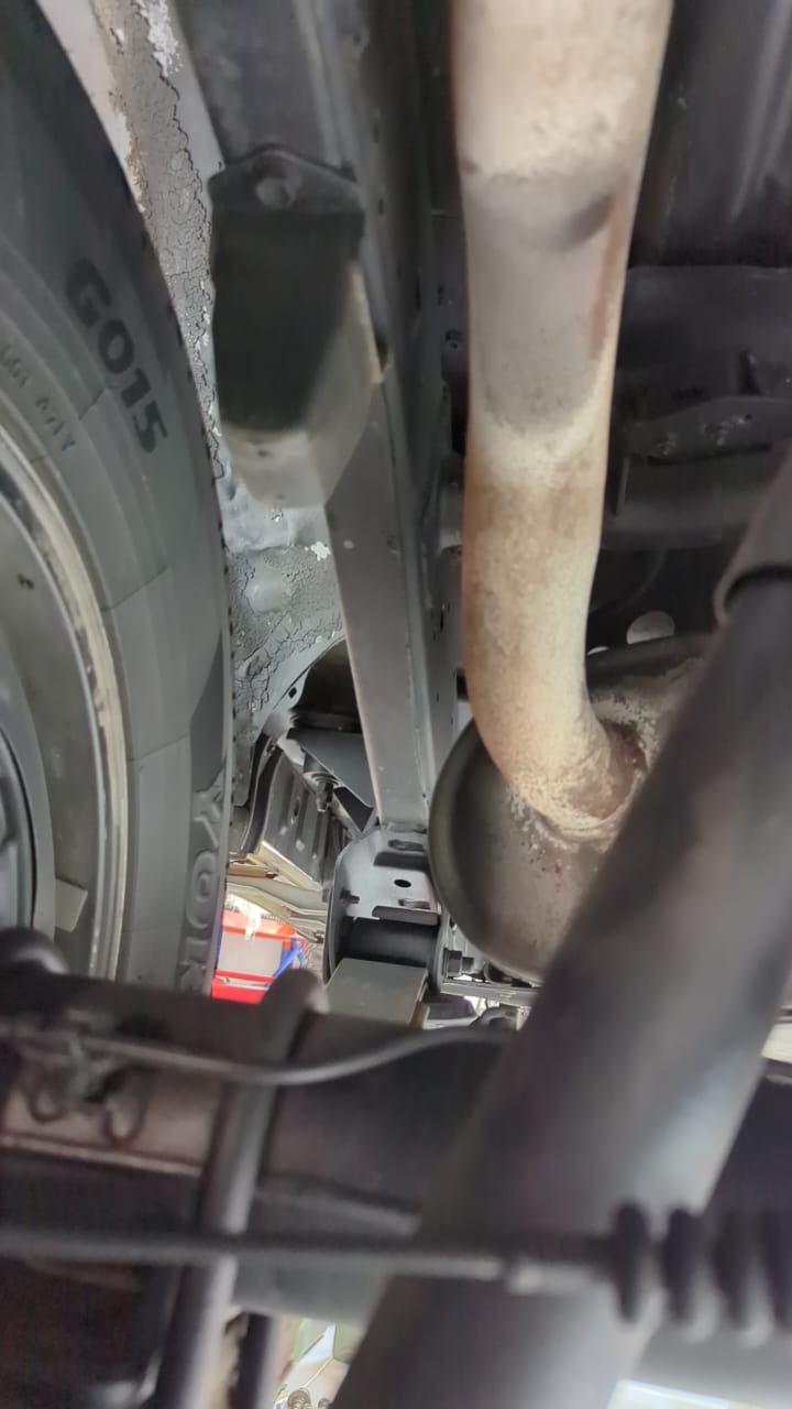

But generally underneath looks good.

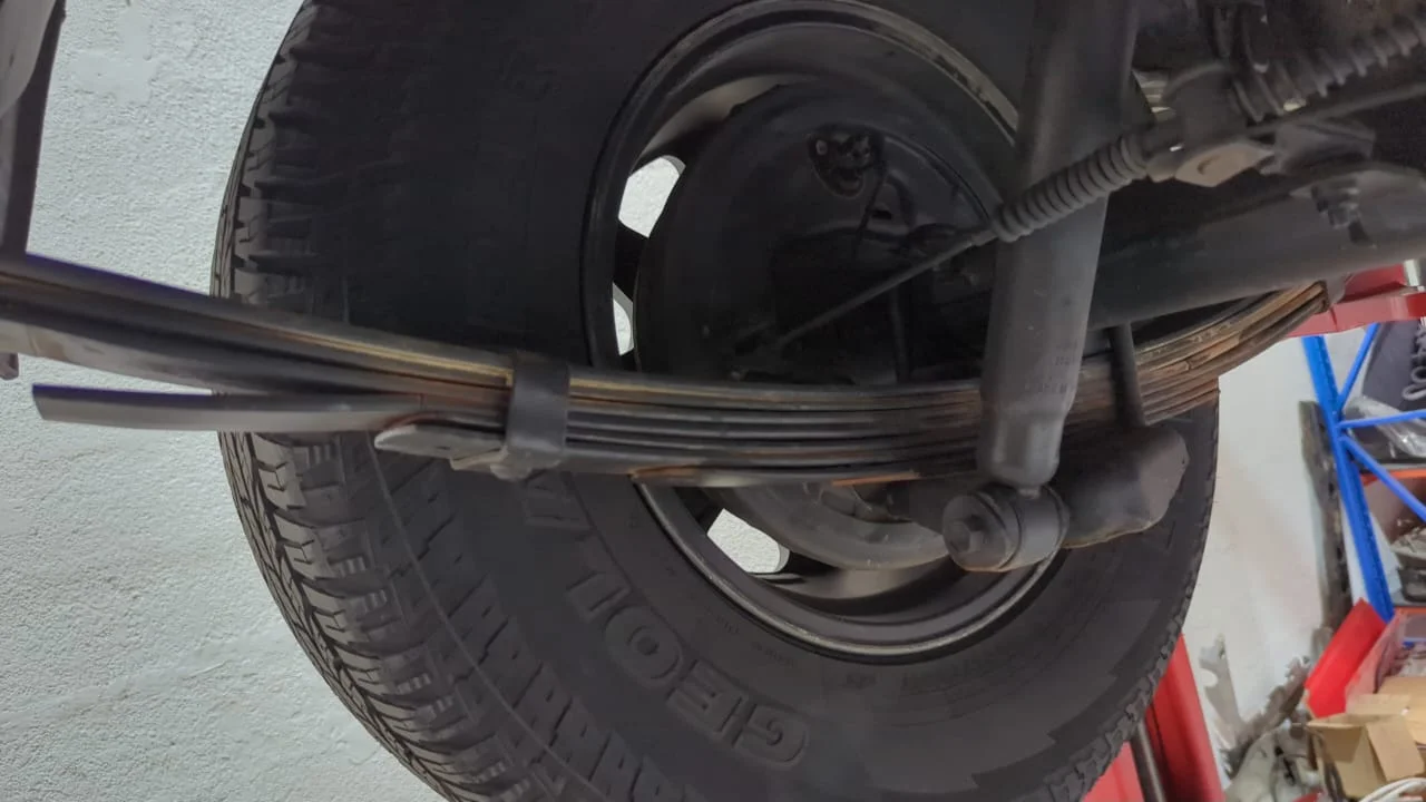

Here is the right rear end. We will get the paint off entirely to make sure there is nothing untoward under there.
It has a broken leaf

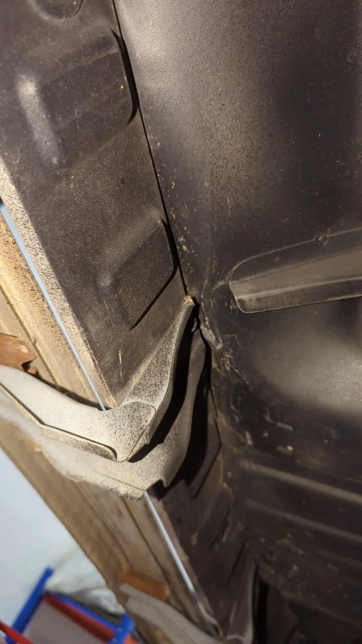

The sill under the left side looks undamaged to me...or very close to it. I tentatively am thinking that the damage was restricted to the upper sheet metal.

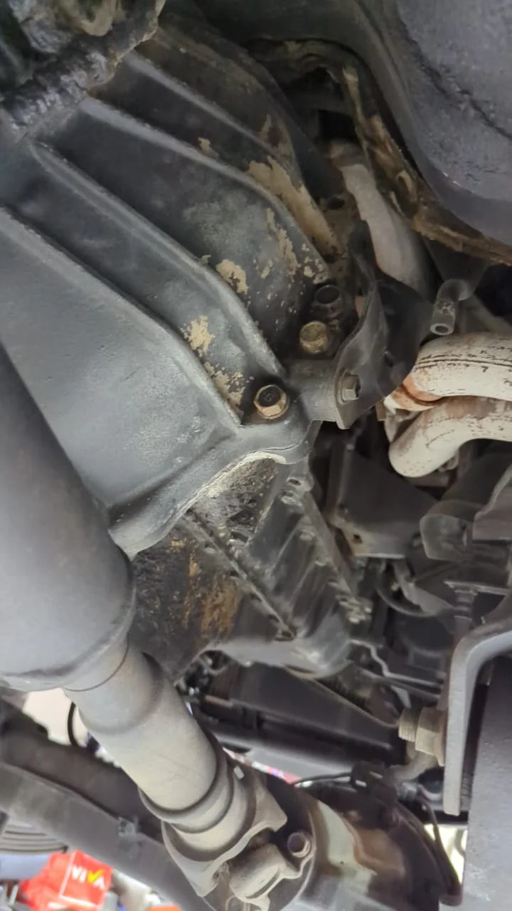

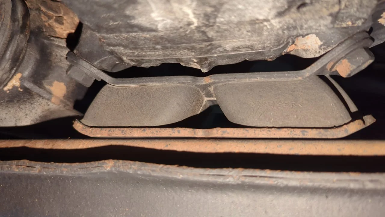

Normal amount of grime:
But straight frame rails near as I can tell.

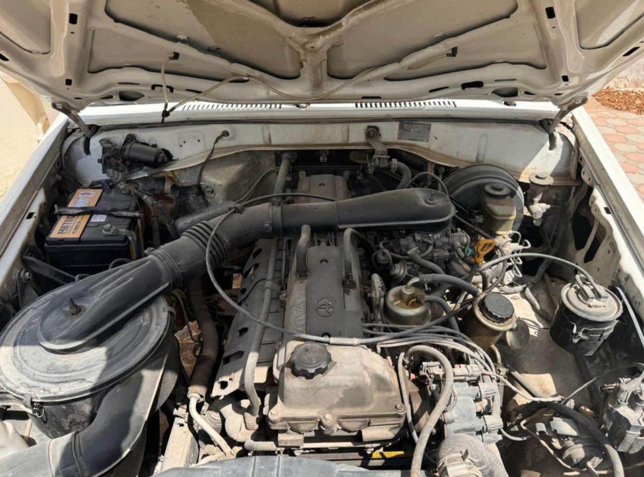

I needs new motor mounts of course--they are so sagging that the fan is rubbing on the shroud.
So, Chick needs new perishable all around, which is fine, a new muffler, a new leaf spring and it just passed inspection so the brakes would have been checked. I think the bones are there mechanically.

Probably from doing two wheel side drive stunts? Or a roll in the dunes I suppose it possible as well.
Cheers
A roll in the sand is quite likely. And if it rolled all the way over onto its top and crushed the A pillars that would explain why there is something funny going on with both A pillars not explainable by standard 70 series A pillar rust. If it turns out to have serious issues with the A pillars I think I will try to find a cab somewhere to graft in.
