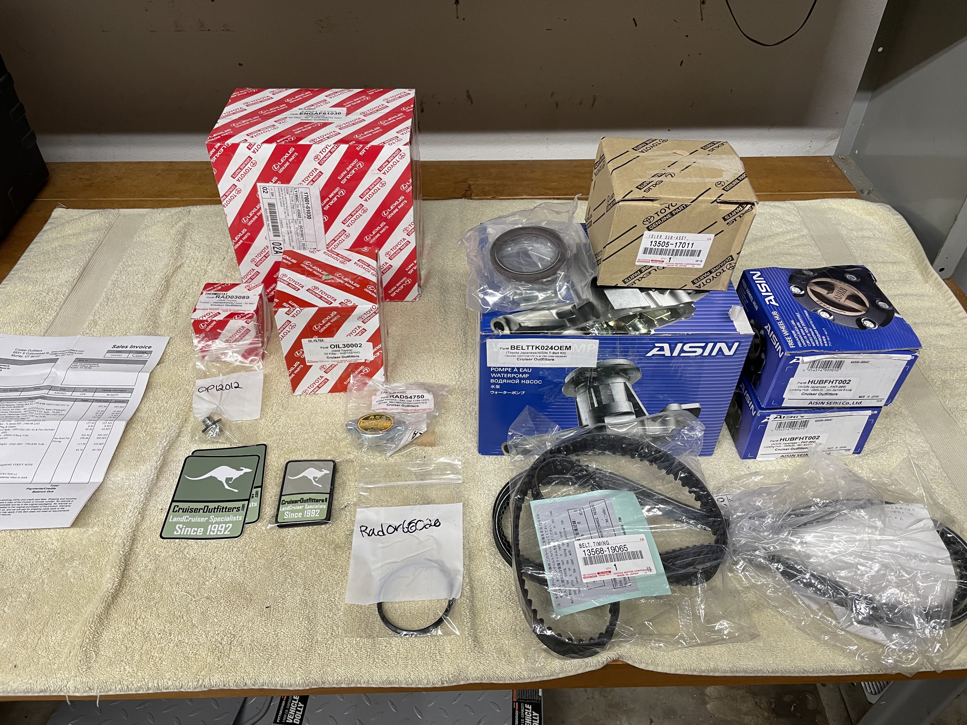

I know I am going to install a new timing belt and tensioner. But should I go ahead and pull the No. 1 cam gear and cam oil seal retainer and install a new water pump and cam seal? What about front crank seal?
My inclination is to leave the water pump and front seals alone. The cooling system is performing well, and the seals aren’t leaking.
What do y’all think?

Replace the water pump at the same as the timing belt as one of the bolts from the water pump is hiding behind the timing belt anyways , front main seal is not really an issue with the 1HZ so I would leave that alone
10-4. What about cam seal? Go ahead and replace?

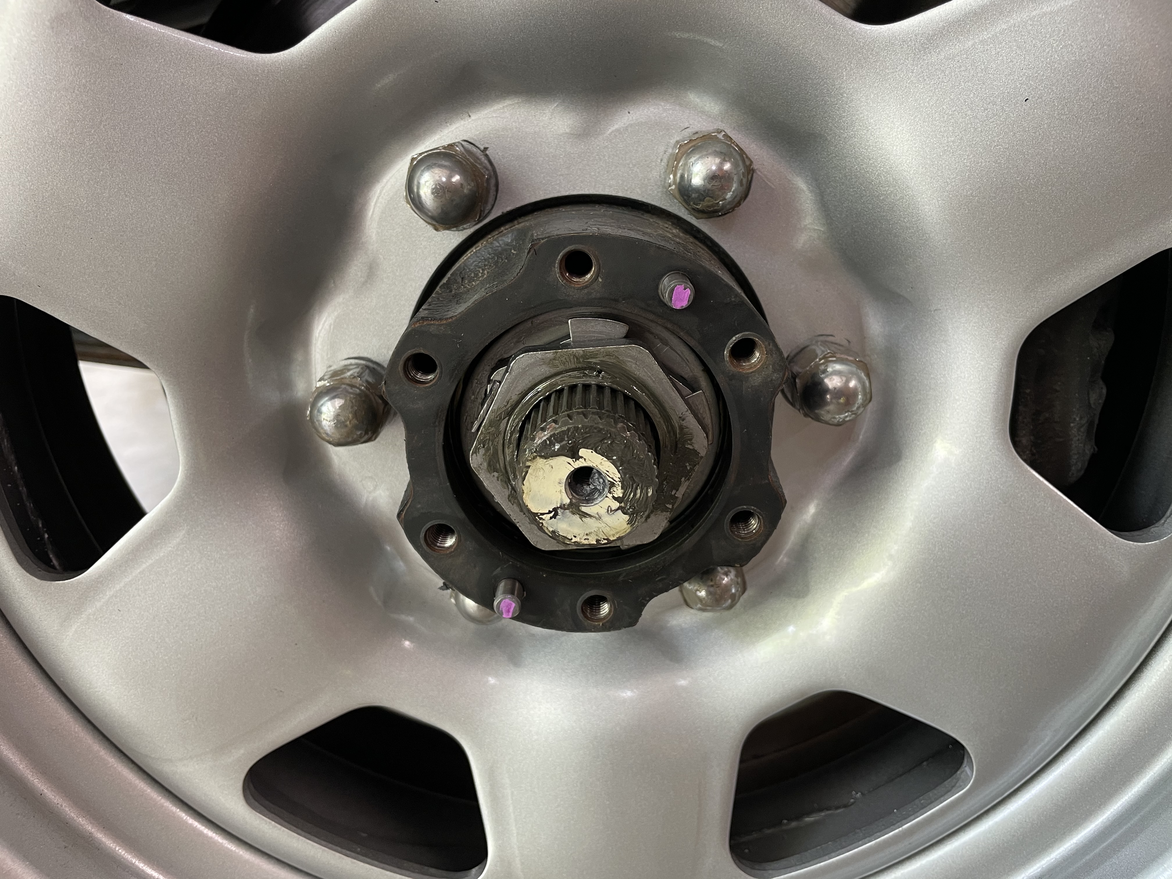

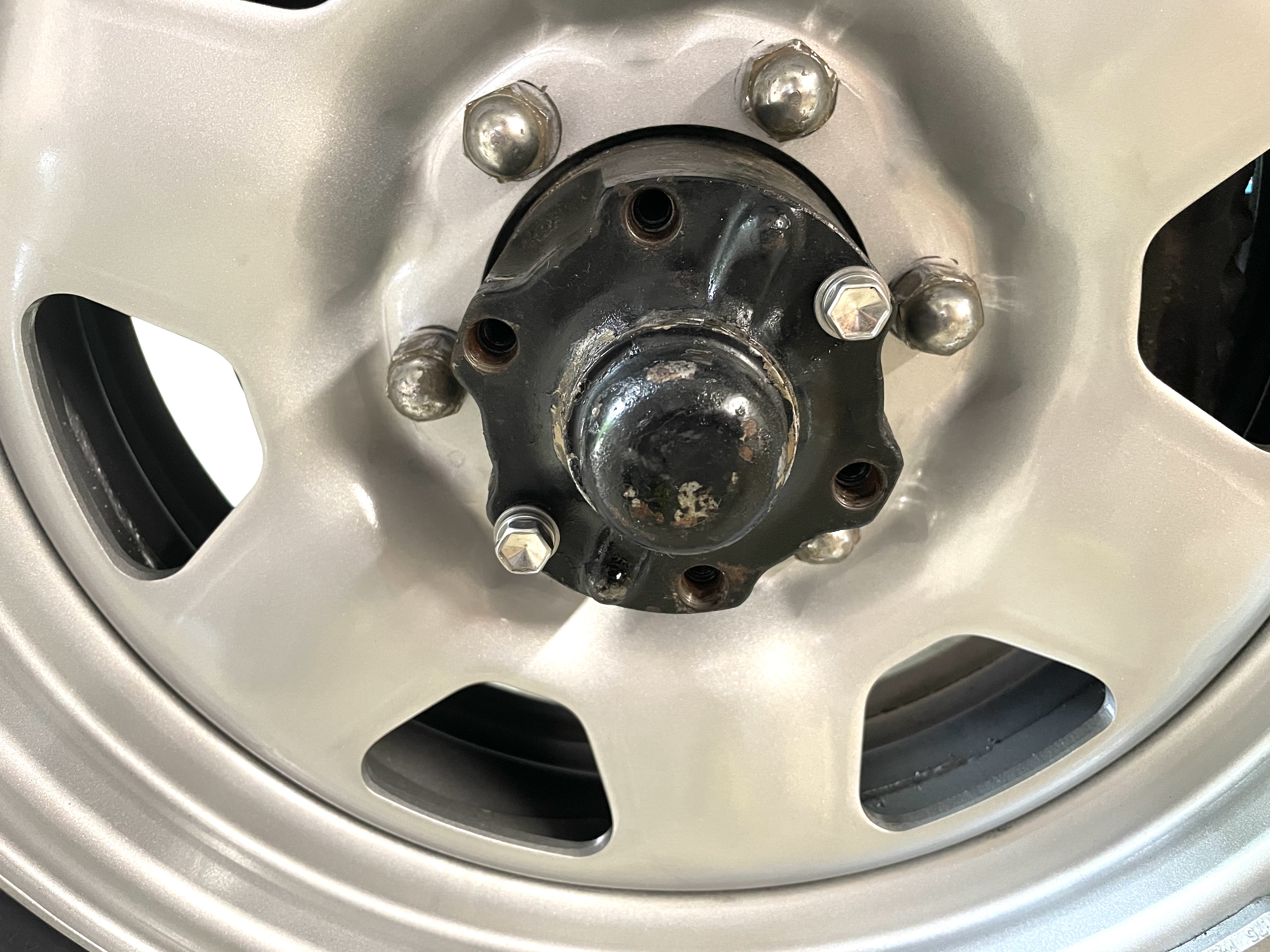

Decided to “quickly” swap over my drive flanges to the Aisin manual locking hubs.
Broke an M8x1.25 stud while running my impact the wrong direction (“Sh*t!!!”).
I was able to get it out with an EZ-Out, but slowed me down pretty good.
I decided to go ahead and replace all of the studs, cone washers, split washers, nuts, and gaskets while I’m at it. They were all pretty gnarly.
What is your favorite tool to remove M8x1.25 studs? I have always used the “double-nut” method with mixed results.

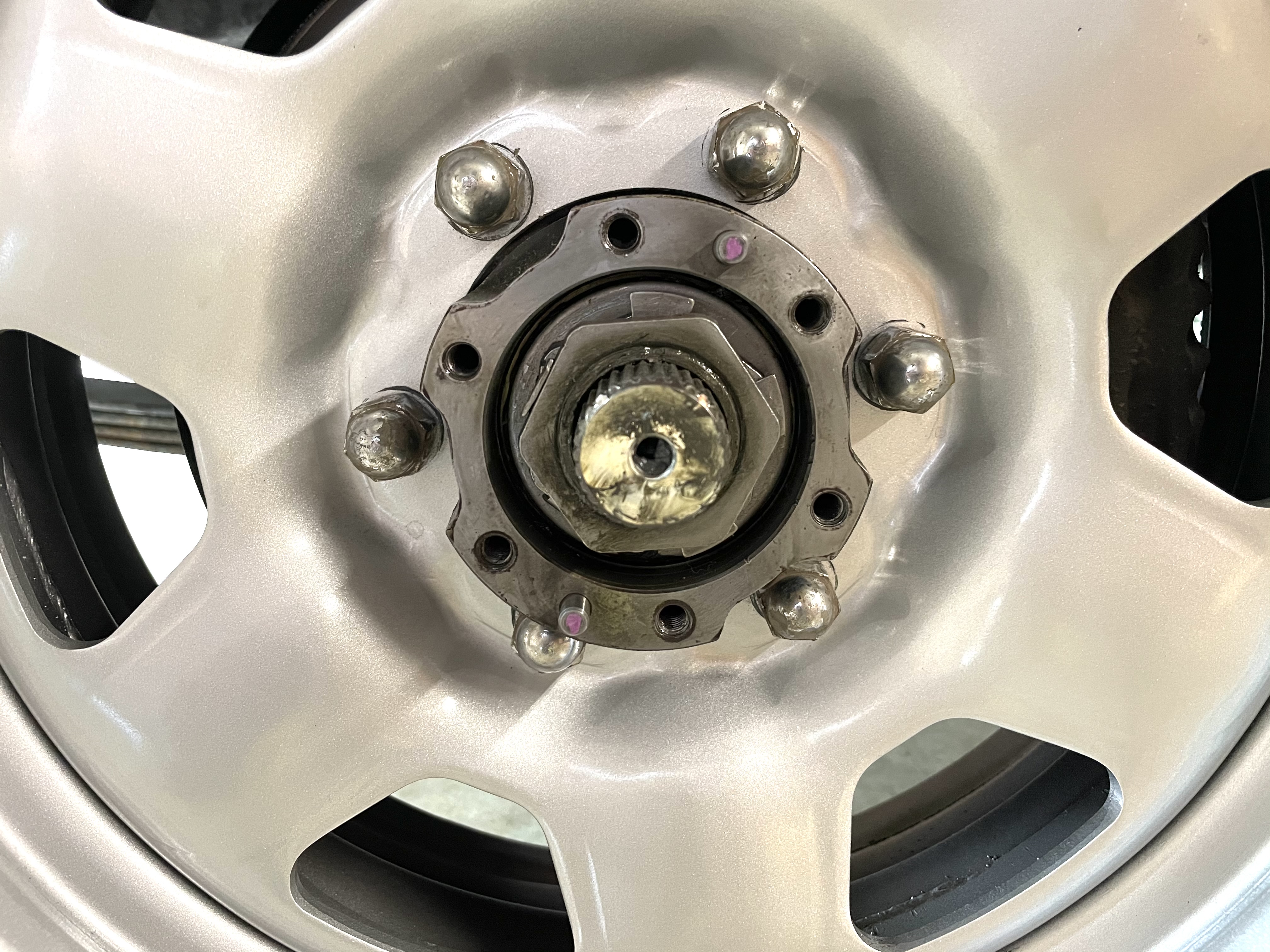

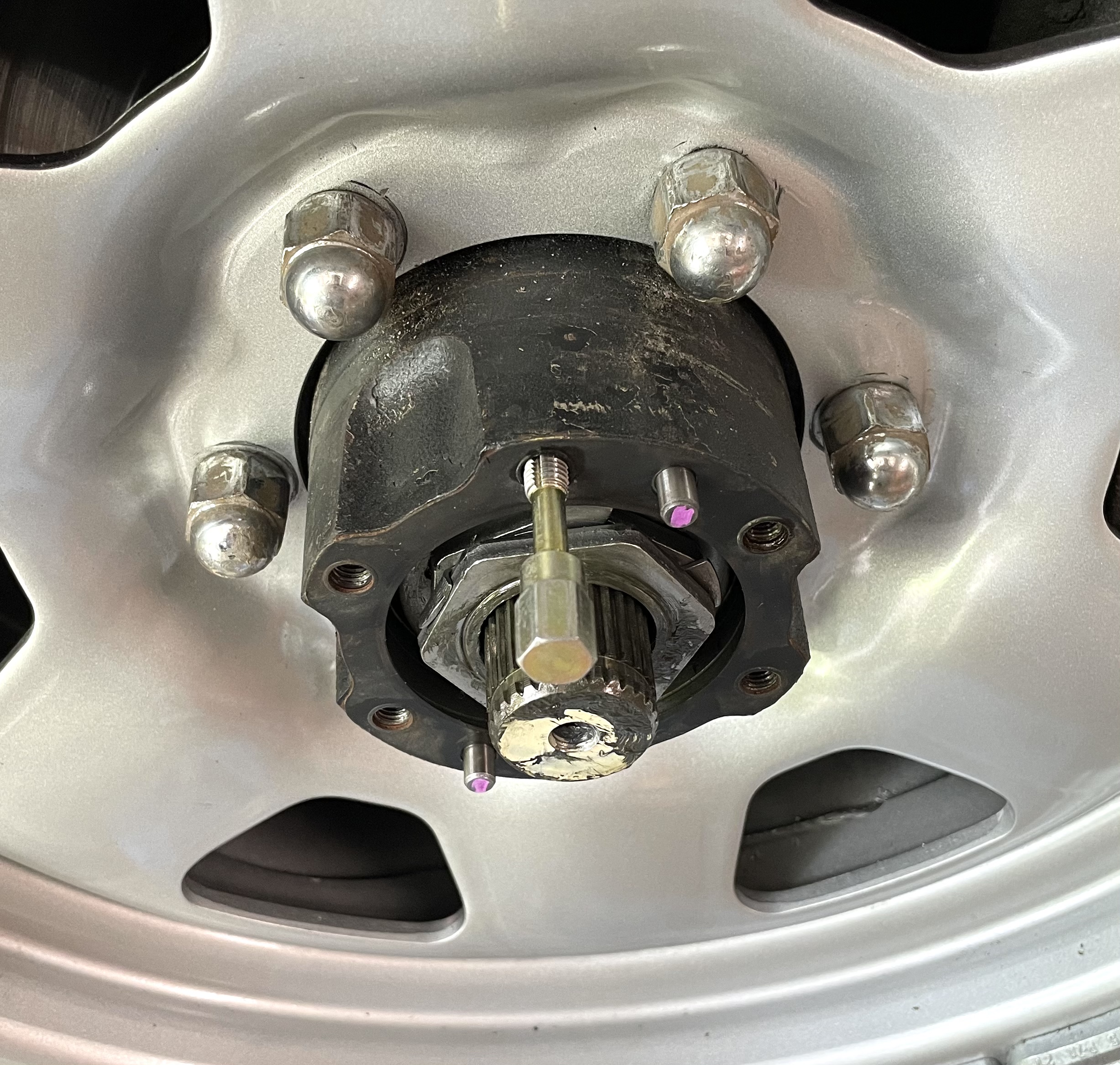

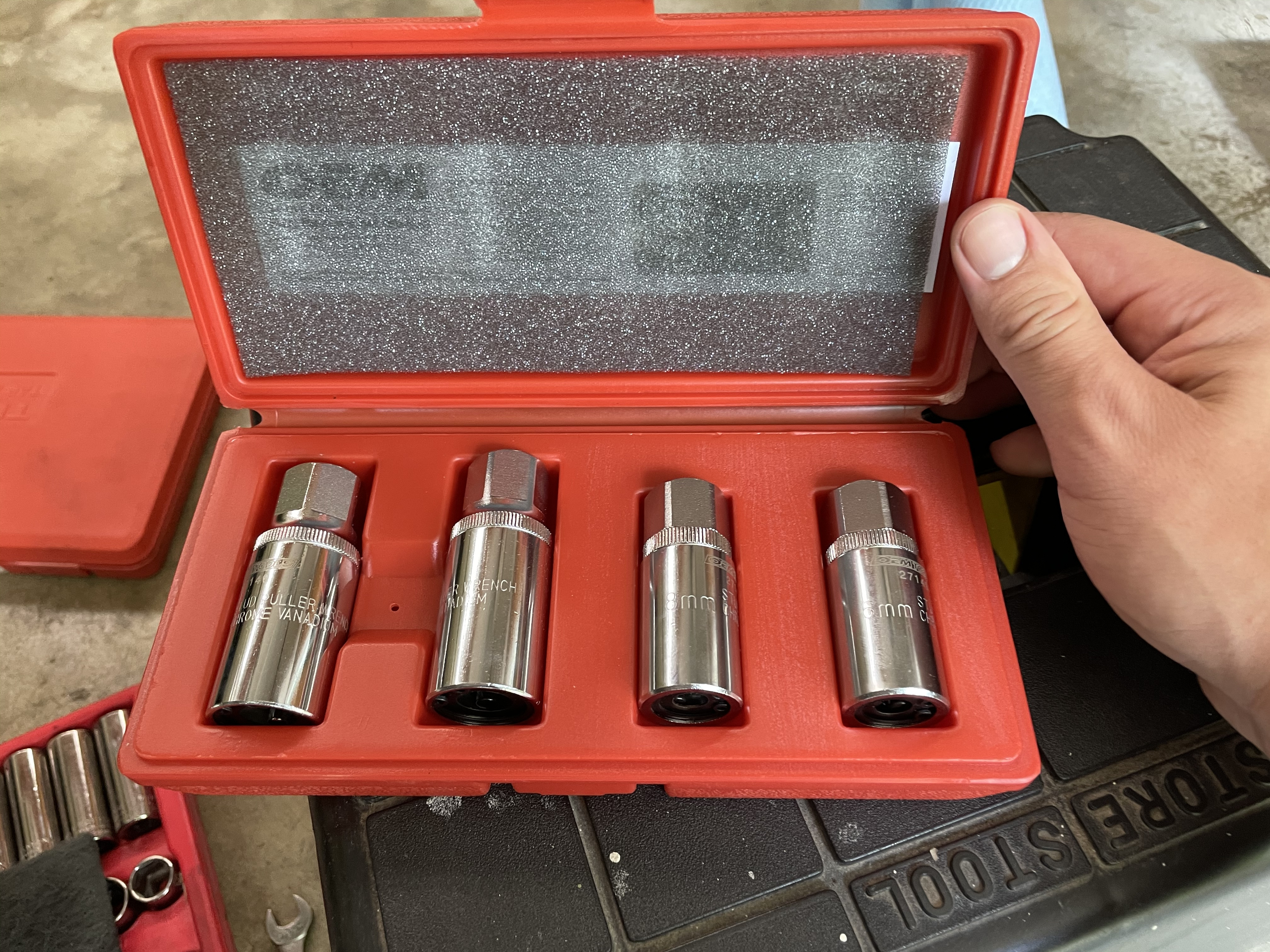

I remembered I had a stud-remover kit after @Onur posted the link. I was able to get all of the studs out using the double-nut method, except for one. The last one was pretty mangled from hammering on it to knock the cone washer loose (I usually use a brass drift, but this one wouldn’t budge unless I hit it directly). Luckily, the stud came out easily with the stud-remover tool.
I decided to clean out all the threads to prep for new hardware.
Then I prepped the mating flanges with some Scotch Brite (to remove the old gasket material, applied a small coat of oil to prevent them from flash-rusting, and temporarily reinstalled the drive flanges to keep dirt out until the hardware arrives.
That’s all for now. I probably won’t have more updates until more parts arrive next week.

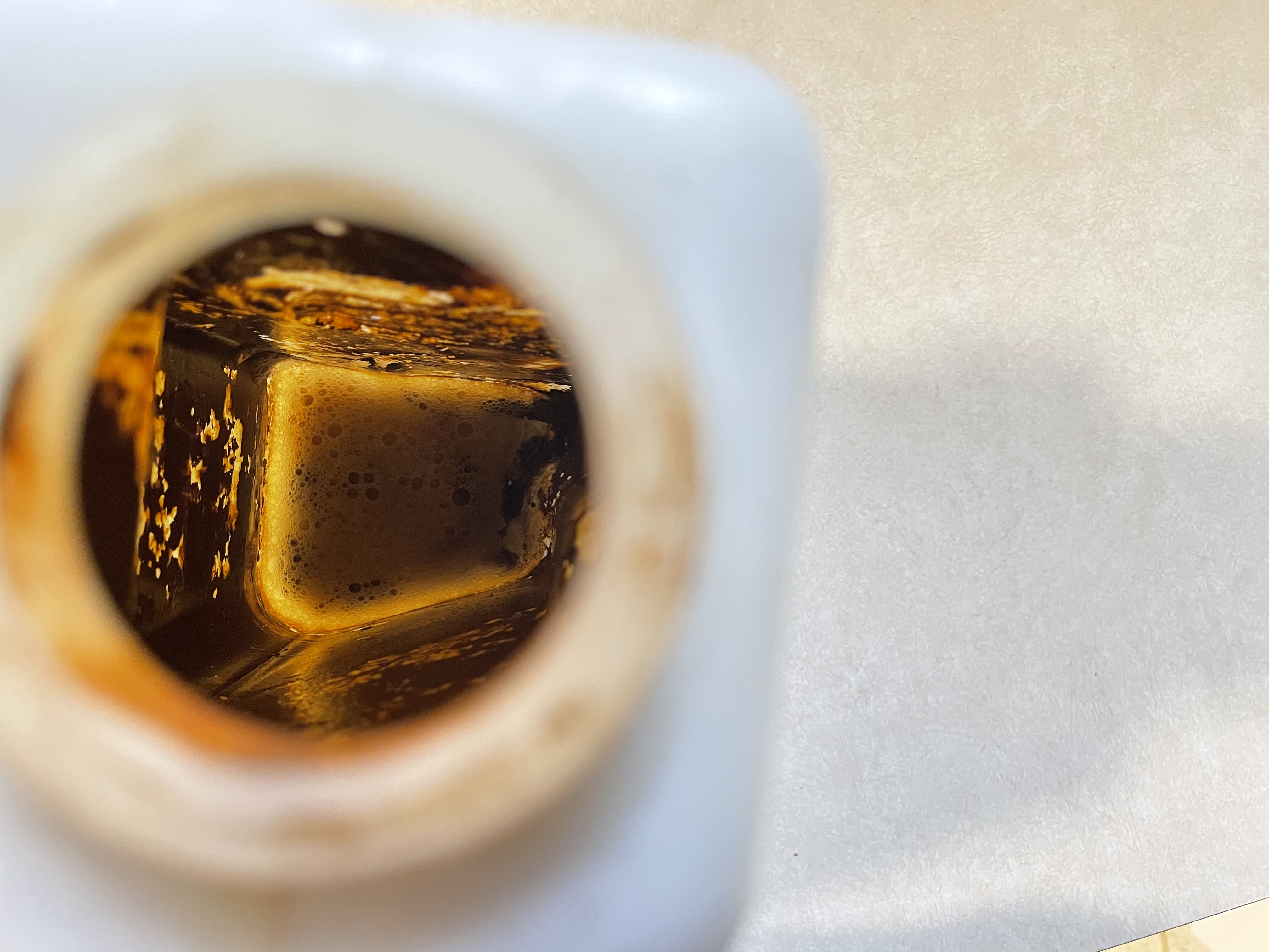

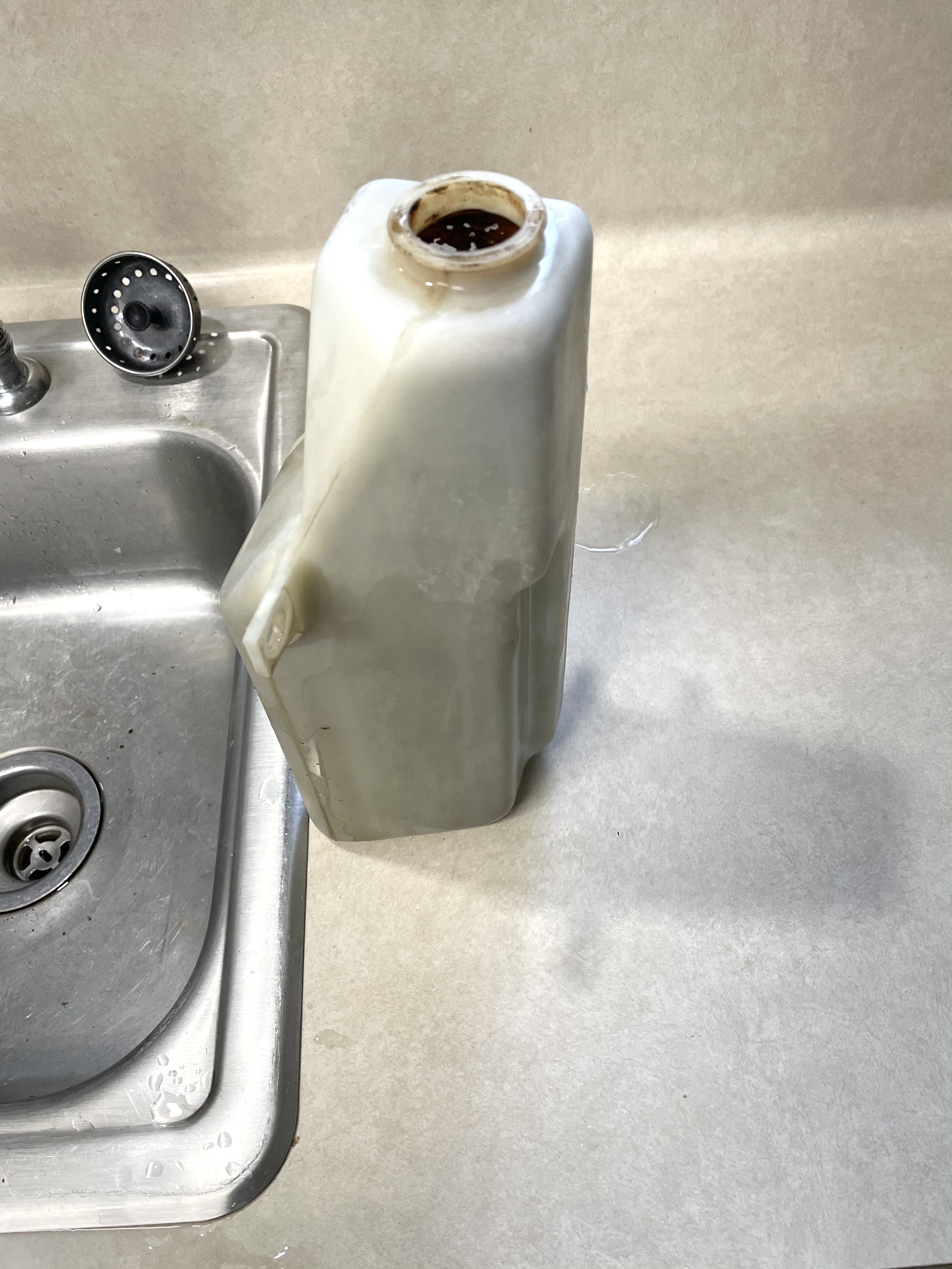

Does anyone have a coolant flush/cleaner that they like?
I pulled the overflow tank to see if I could clean it up. It’s obvious to me that there is tons of rust and buildup in the cooling system. Obviously I can replace the overflow tank, but what about the rest of the system? I’ve read lots of people have luck with Thermocure for rusty coolant systems.
I have no luck cleaning the tanks and just found a replacement on ebay. I have written before but If you are in replacing the timing belt and water pump etc pull the injection pump and the oil cooler cover and inspect. If you want then you can replace the cover with the 17012 version which accepts the filter drip tray a $69 part from amayama as of April 2021- see compete acsd delete thread. Oxalic Acid/Baking soda wash is best to clean system - see thread, a GM service bulletin exists to clean the heater on some cars.

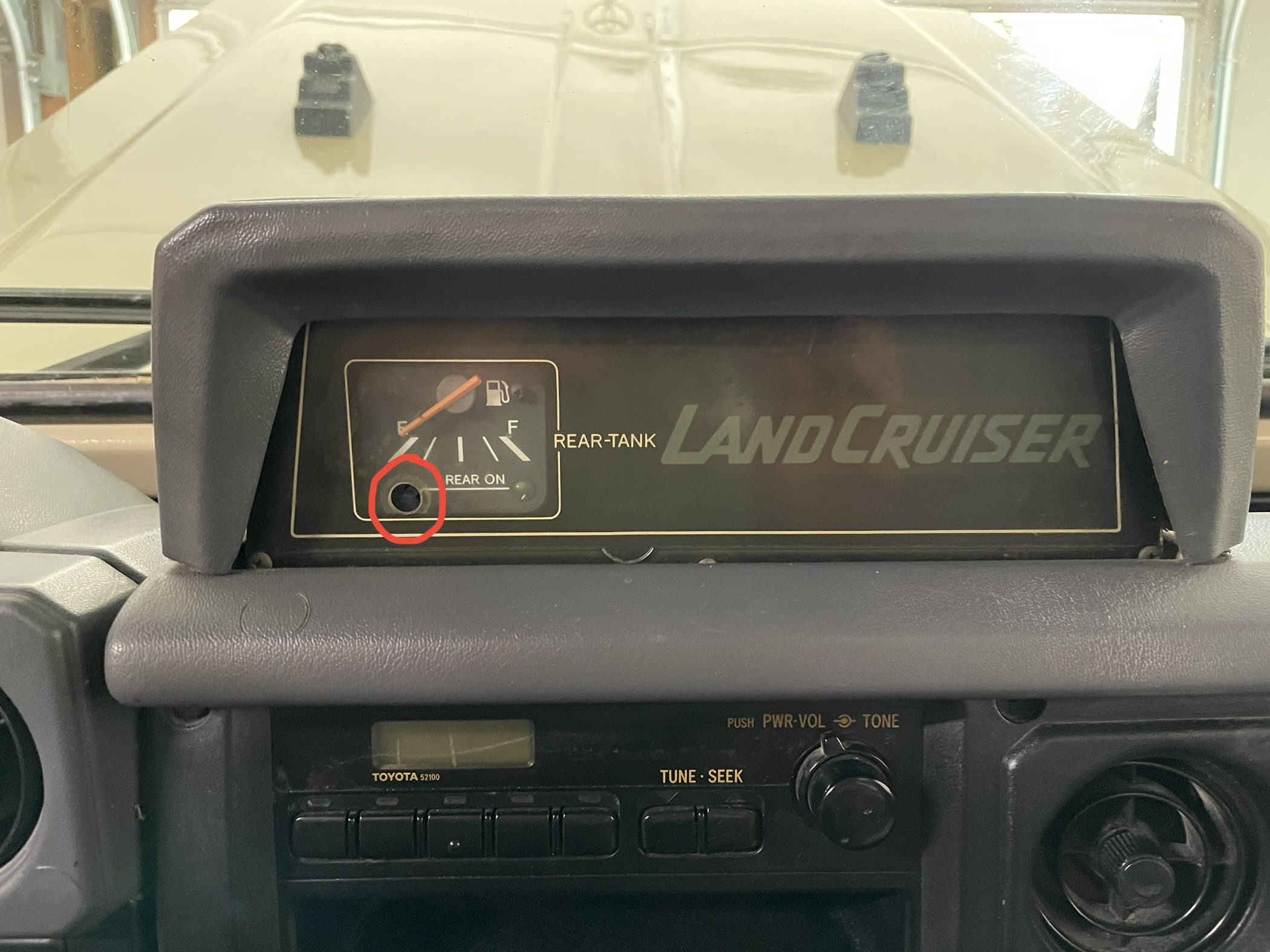

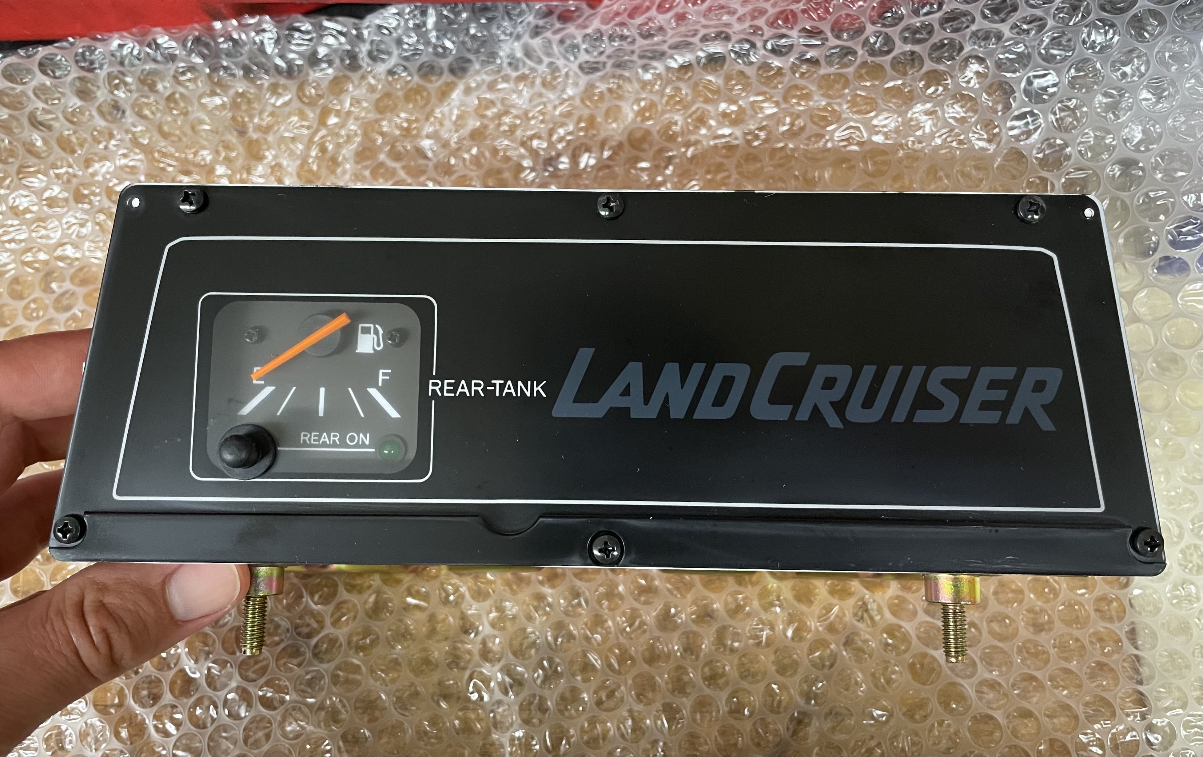

Yesterday was my birthday. The Pickup has dual fuel tanks, but the button was broken on the dash for switching the tanks over. Everything worked, you just had to use the end of a pen or a punch to activate the remaining stub of the button.
My brother bought me this replacement for my birthday! Now I just need to figure out how to install it.

In a sense you’re lucky, it’s usually the transfer valve that eventually fails. 😊
