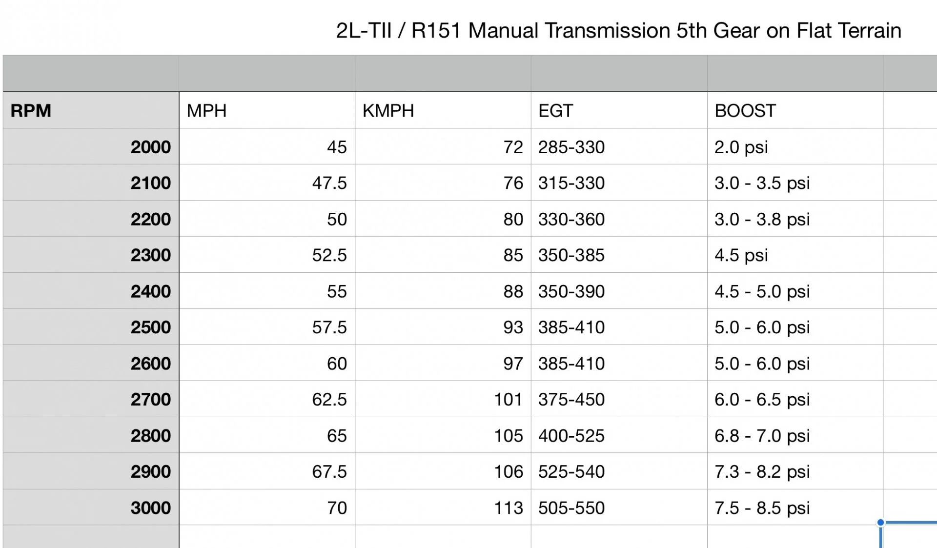

Thank you very much for the information on the pressure sensors and solved the problem, the problem was that it had no negative, but I have another question to how many RPM should I turn on the indicator in green I await your answers since they help me a lot to repair the hilux 85 with 2lt engine
@SlmBa8865, Green light should come on at 1.6 psi. Red light should come on around 9-10 psi. Glad you got it sorted.
Here is a chart you may find useful.
