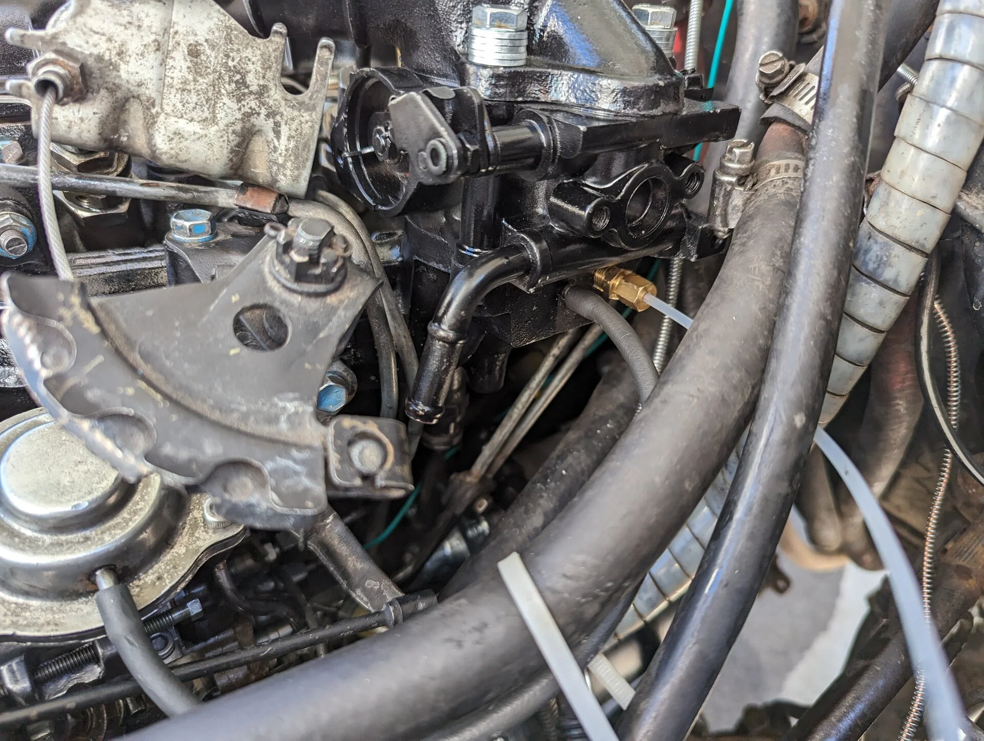

As others commented, you just have an uber safe lean tune right now. Maybe just play with that fuel screw if you can't get more using the boost comp alone. Take a picture or mark the screw somehow first though.
