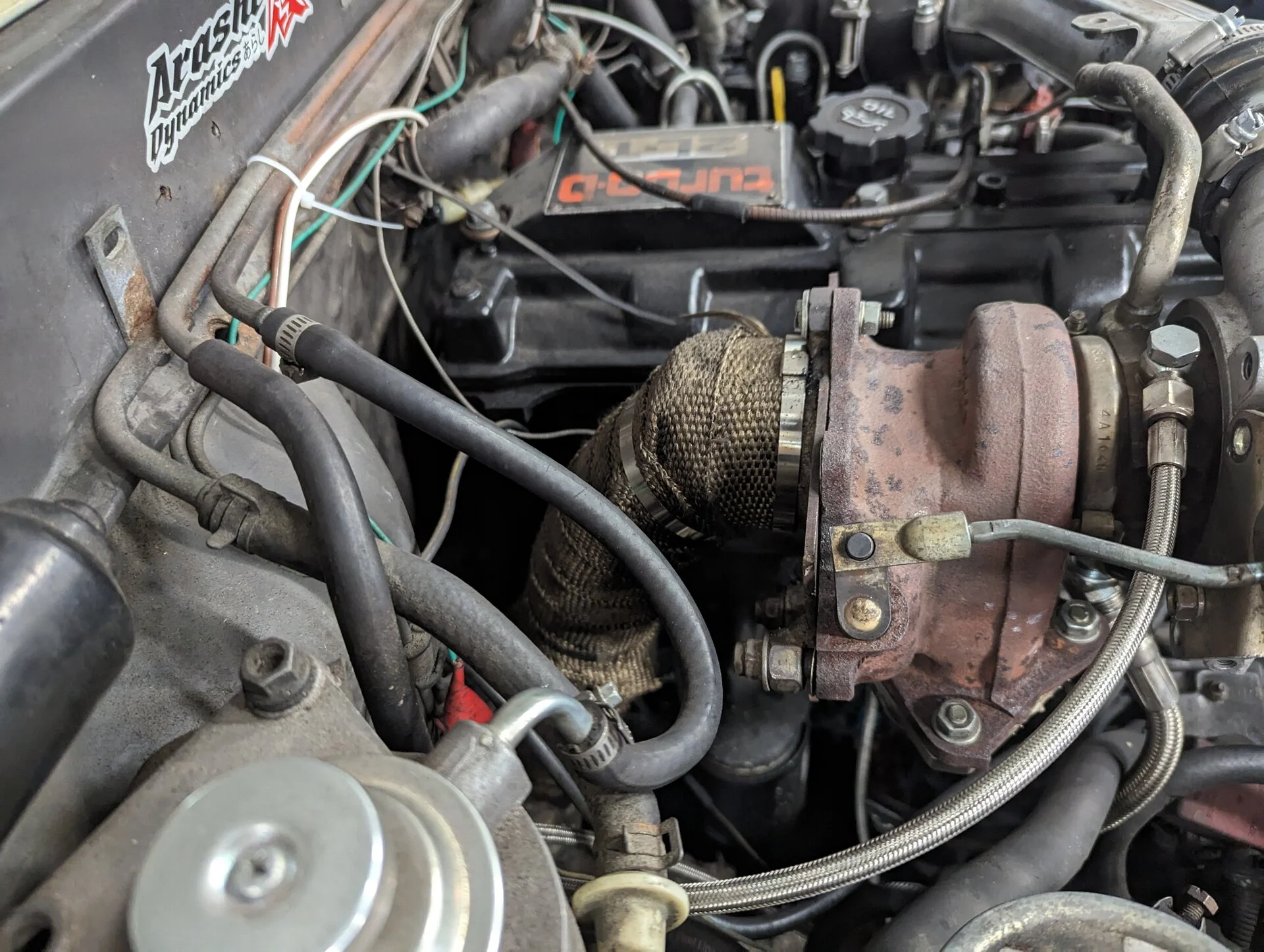

My egt probe is right before the turbo where all the cylinders collect. I don't know the exact timing but it's advanced a bit more then when I set it with the gauge last year.

what exhaust you running after the DP? I would be really interested to see your drive pressure ( pressure before the turbo.. just take the EGT probe out and put a gauge on some copper tubing. you want 1:1 boost/ drive pressure or better .. if you muffler or turbo are at fault that will show you.

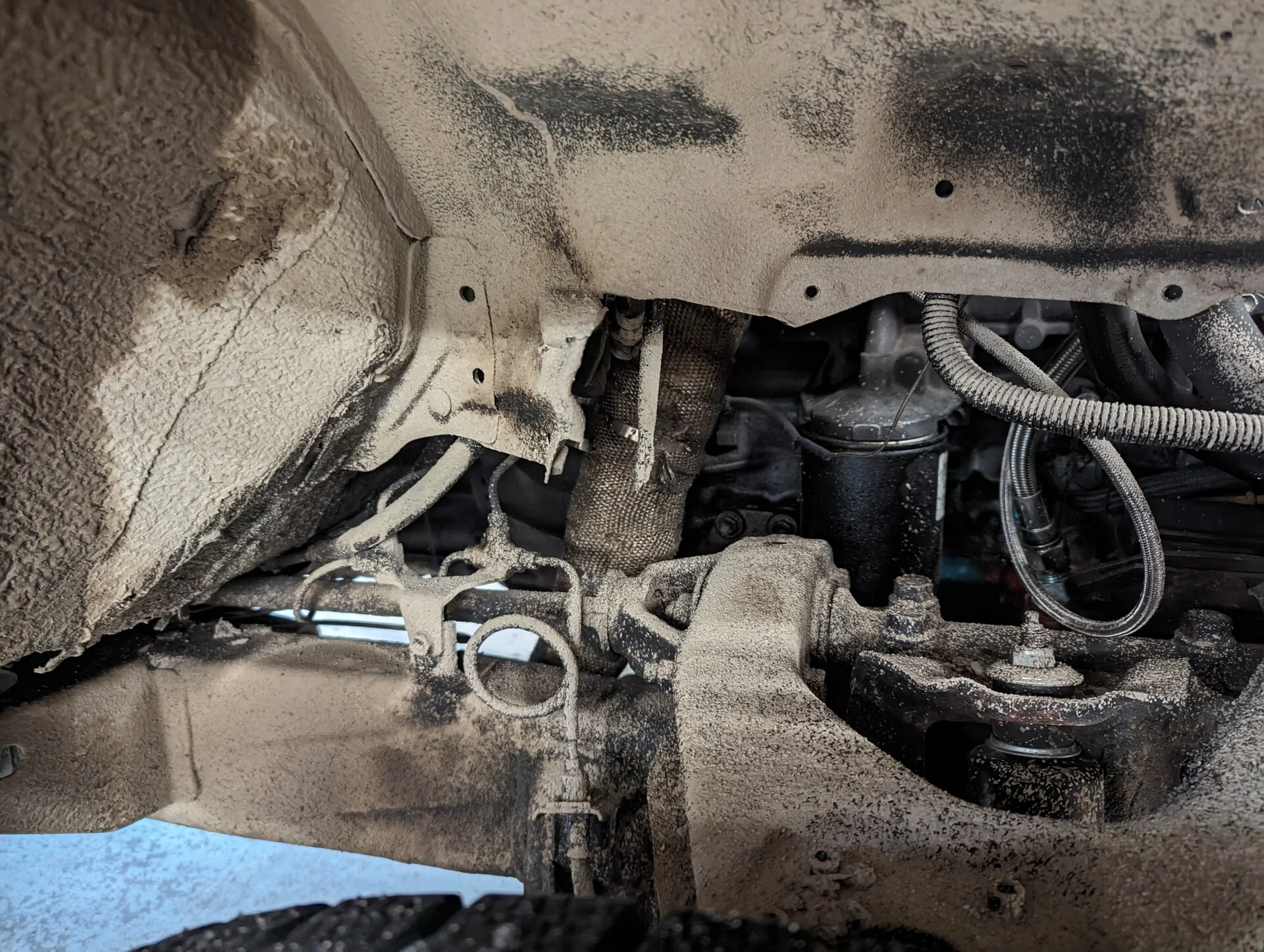

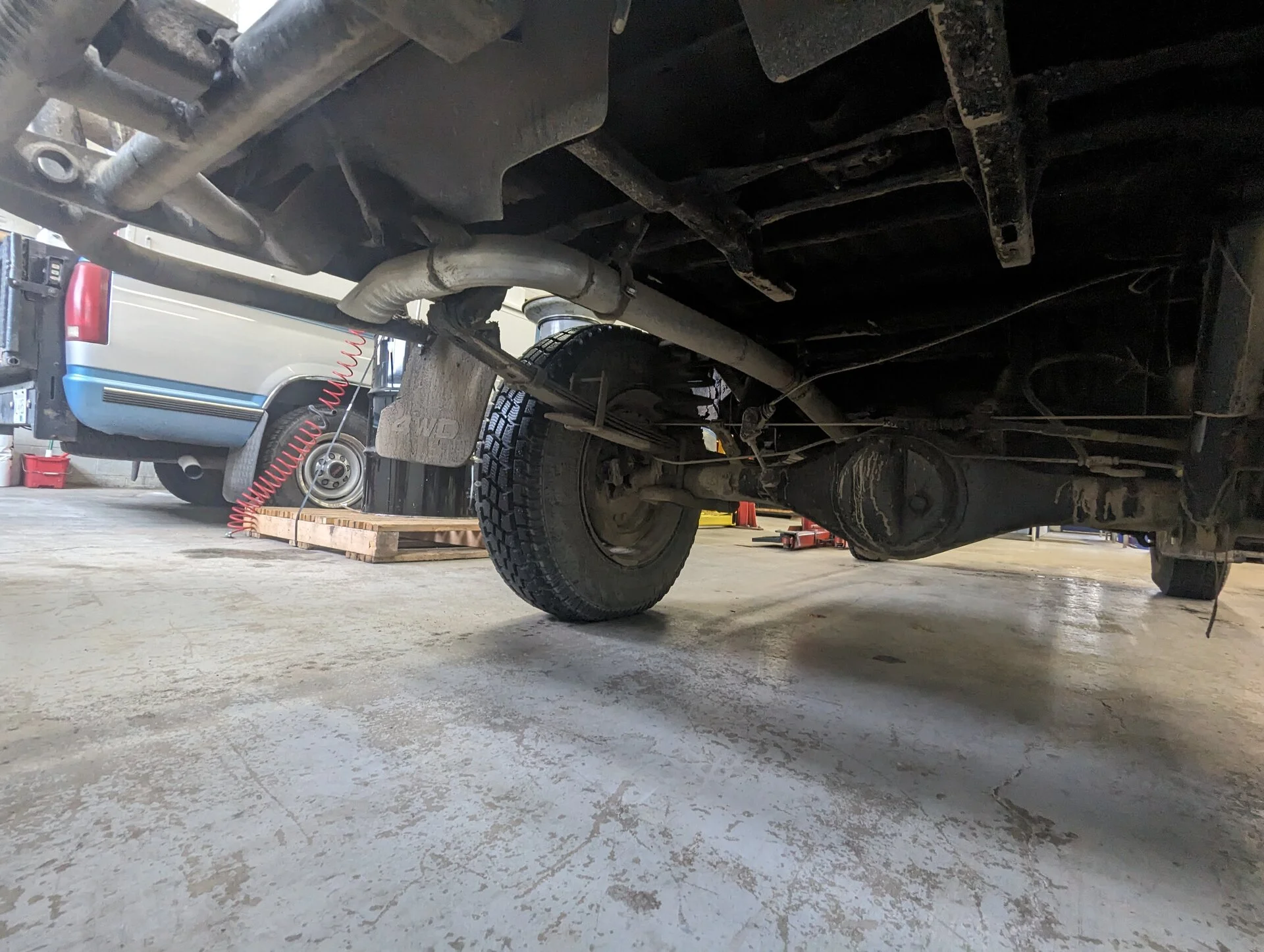

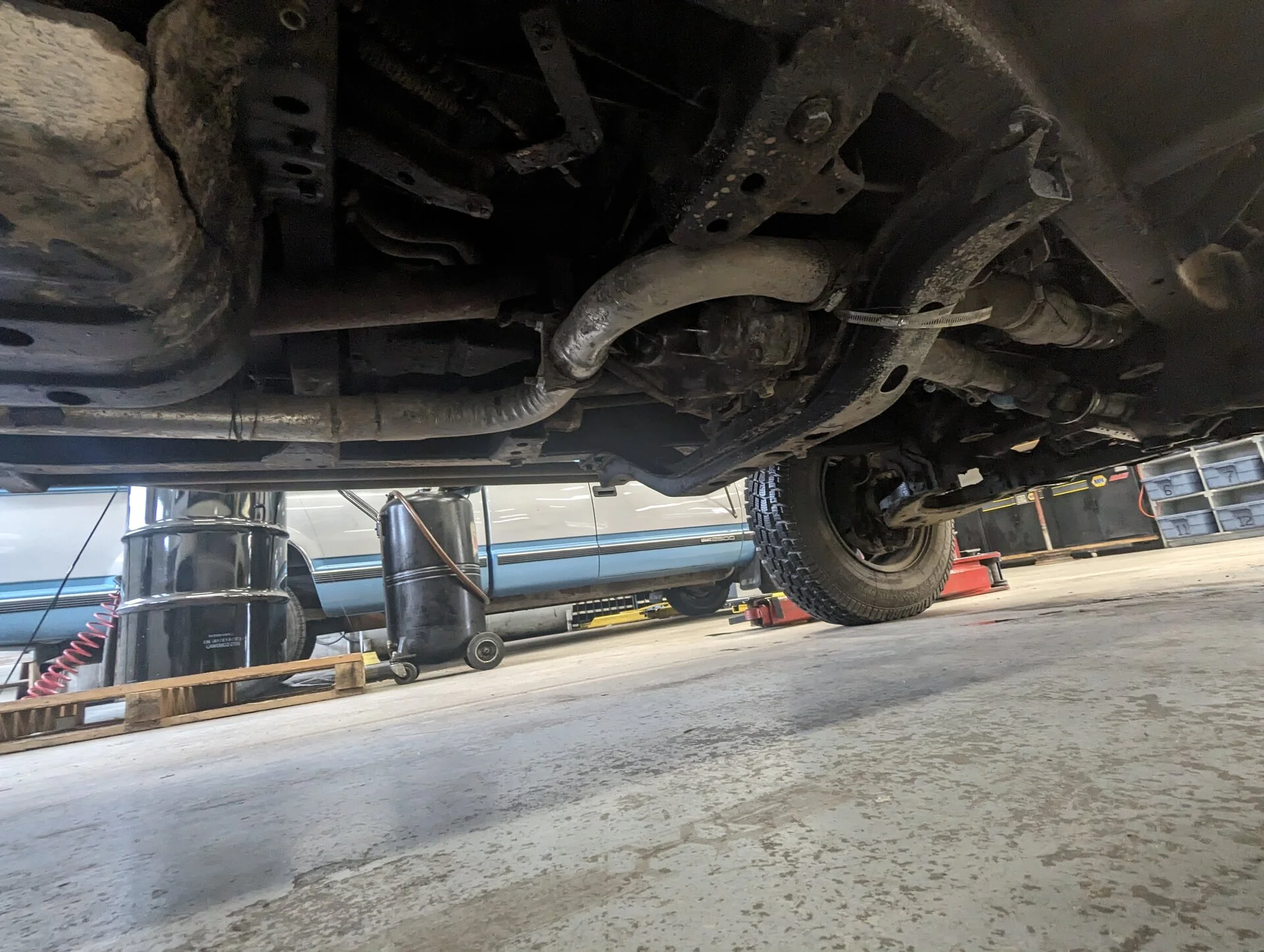

I am running 2.5 straight pipe I welded up myself. I'm actually pretty proud of it. The downpipe is flattened a bit since I tucked it a little close to the block but it shouldn't be too big of a restriction.

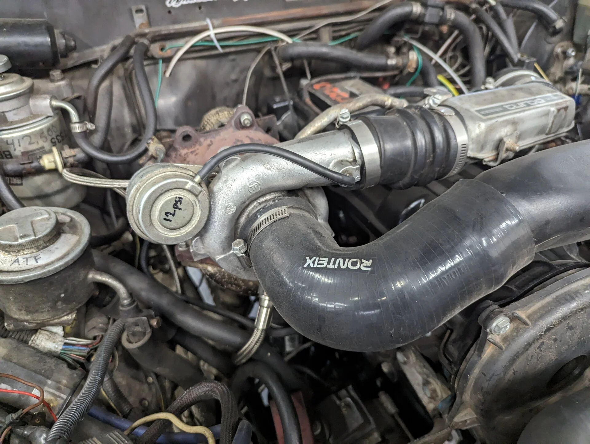

Another question, do you have a functional wastegate or is it wired shut or something?
Yes the wastegate starts to open at 8 PSI and stops building pressure past 13 PSI

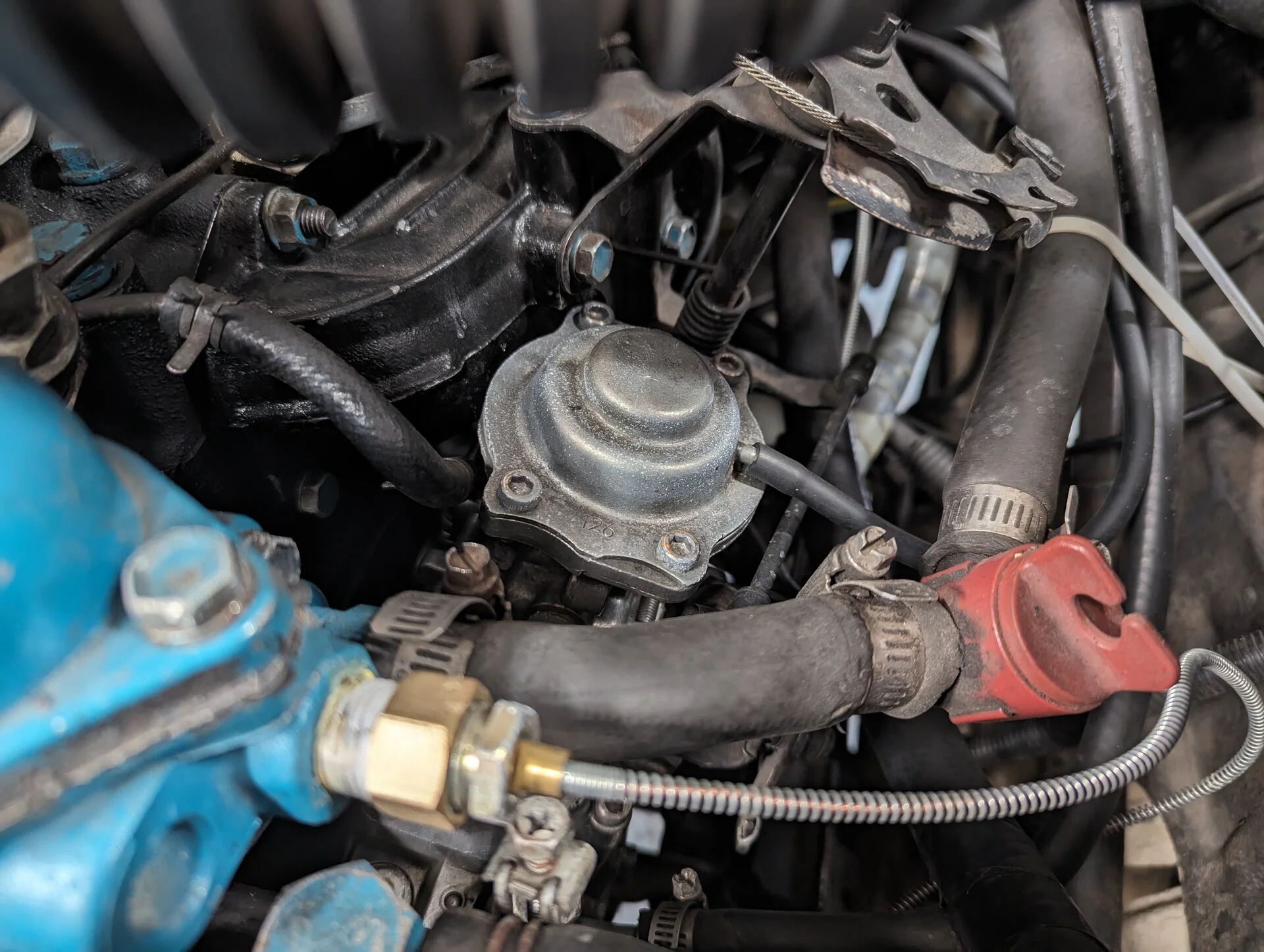

How is the boost compensator set up? Do you know at what boost the rod starts to move and at what boost she's got full fuel?
From when I was testing the compensator, it has full range on the pin, it starts adding fuel around 2 psi I'd say. I have it rotated to the deepest setting.

That turbo is on the map at 25psi still, you don’t need the WG opening that early. That forfeiting valuable spoolywind. Set the WG to open at 25psi or just disconnect it.. the 2l will survive 25psi mine was eating 30 happily. Also don’t expect boosting hard below 2K rpm, these thing need revs unlike a mammoth 6cyl

if you feel the need, then intercool it, and disable the wastegate (its wasting your boost too early)

Here's some more photos
