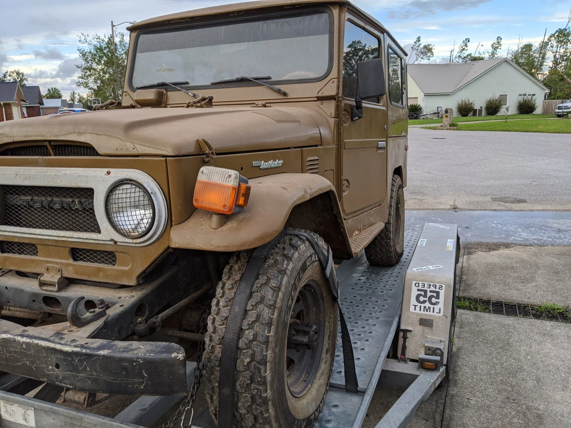

My 1977 FJ40 used to be my Dad's. When he passed away back in 2003 he left me his old Cruiser. Being 11 at the time, I didn't have any of the knowledge, resources, time, or ability to do anything with his old cruiser so it sat in my grandfather's barn until July 2020. Now that I have a stable job, a house, and some garage space to work in, I decided to finally get the cruiser out, dust it off, and get to fixing it up to working condition once again.

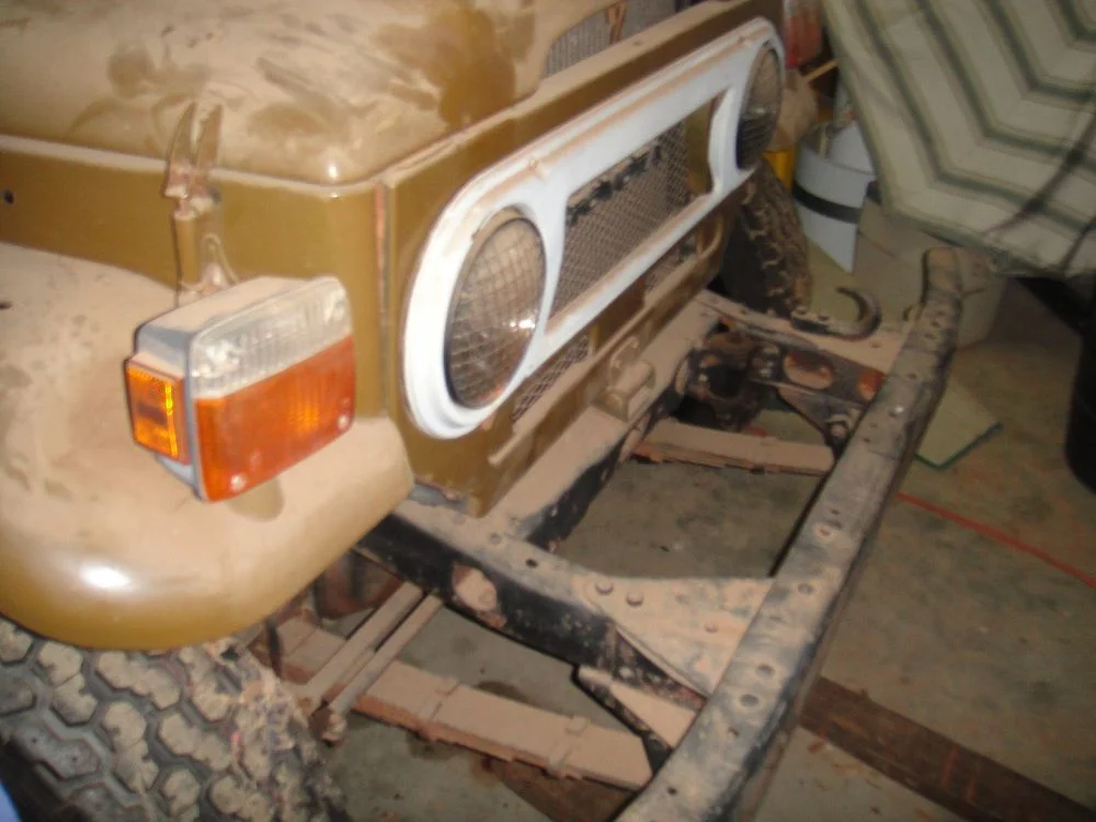

Now to get her started again! Unfortunately didn't get too many pictures of these steps :/

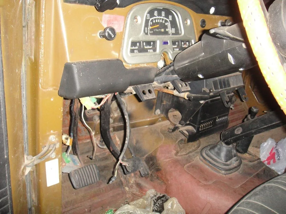

Clean out the mouse nests, dirt, and junk piled up on the inside! Gave her a good hose down and clean.
I inspected everything for any issues & replaced all the fluids.
There had been a bit of an electrical fire, which had originally taken her off the road to begin with, so I replaced the Dizzy Cap, Rotor, and spark plug wires (fortunately my dad had already stared collecting these replacement parts before he had passed).
Inspected the grounds based on research here and they looked okay. I fixed the melted alternator leads.

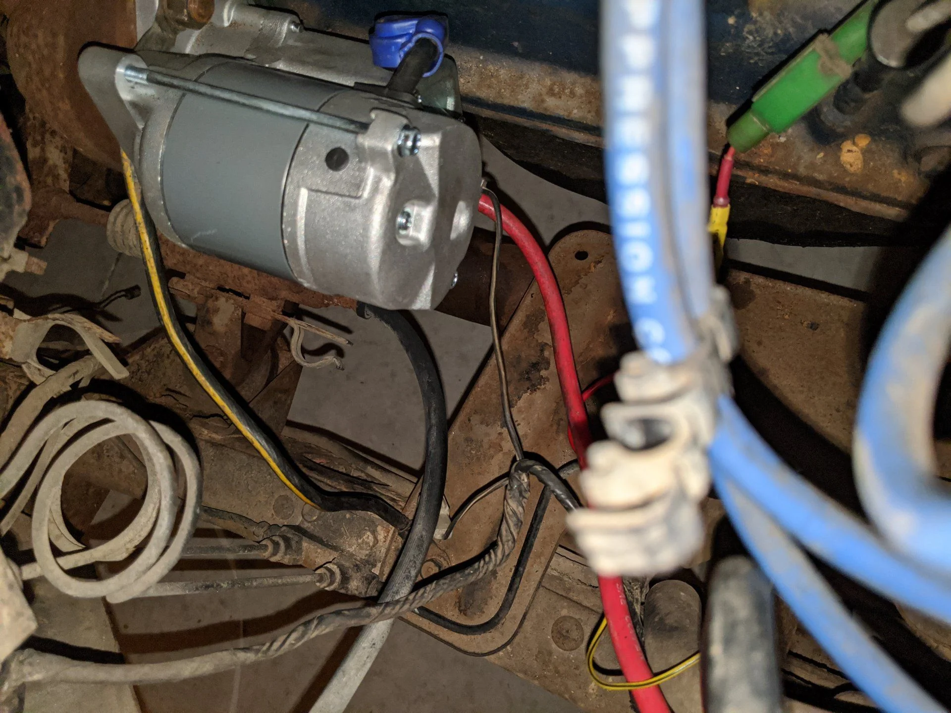

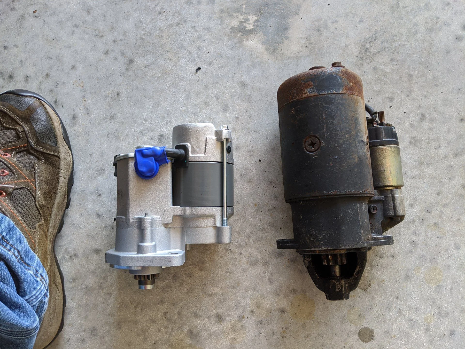

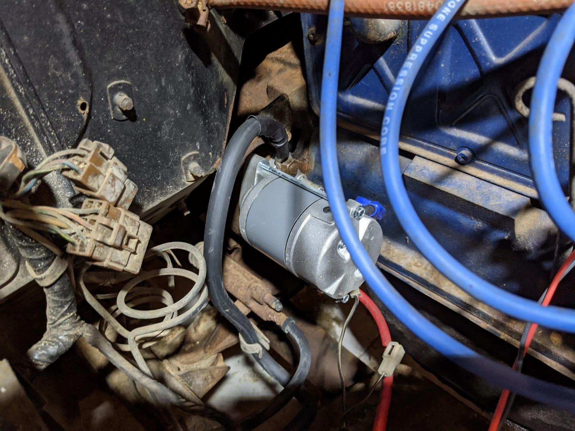

Voltages were good, so I ordered a new gear reduction starter. (based on an IH8MUD thread)
Tried again, and she was turning over great, but still wouldn't start up. After 30 seconds, I saw that I had let out the magic smoke from the fresh alternator ground wire. So I replaced all of the ground with 00 gauge welding cable and fixed the alternator ground once again (couldn't get 00 to fit, so I had to resort to 10 gauge, lol).

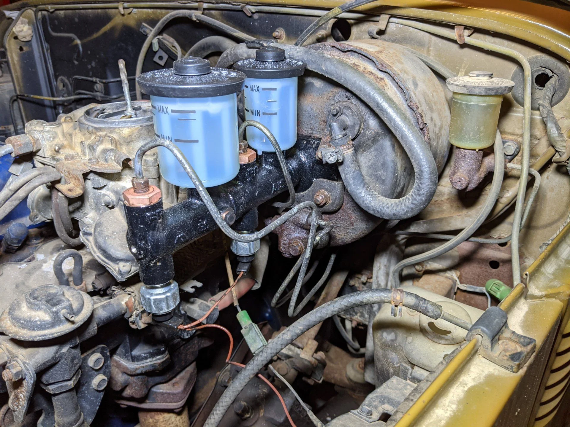

The master brake cylinder was leaking, due to a missing (read broken off) sensor that I can't get un-fused and out of the port. So I replaced it.
