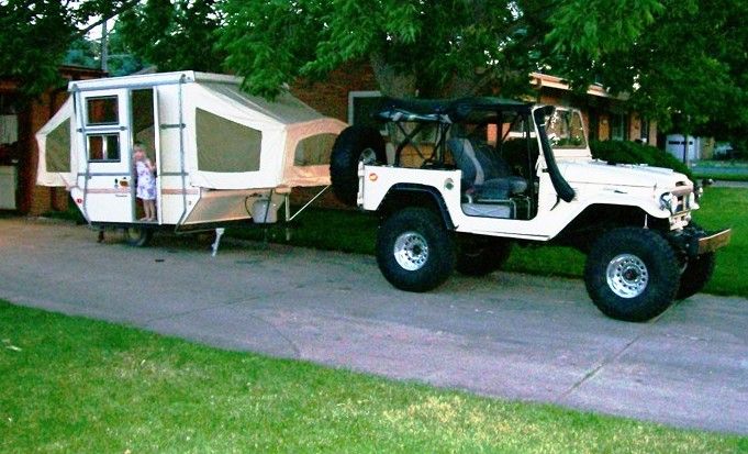

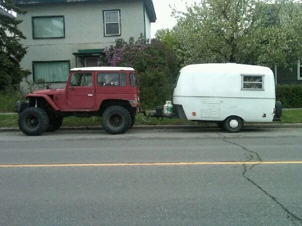

I towed a small popup just basically around town YEARS ago with my Fj40 on 37's. Of course it had a fuel injected V8 and had no power problems when the trailer was back there. It was around 14' total. Talk about a drop hitch! It was less than 1,000lbs. Wish I still had that to use behind my BJ74 now.
100_0473-jpg.5247

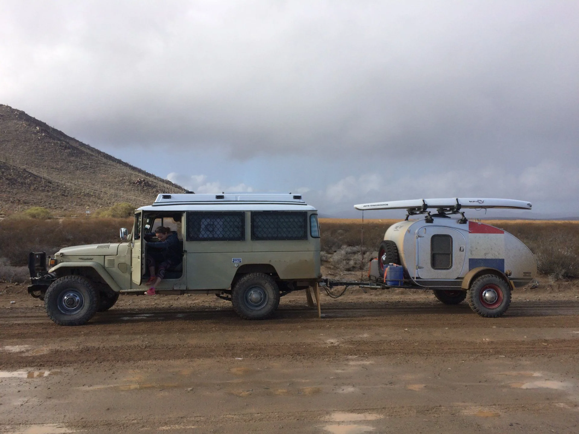

This is our set up.
The trailer is about 700lbs dry. (Fully loaded with water (approximately 20 gallons) etc... I'm guessing around 1000 lbs). No brakes on the trailer.
When both are fully loaded it gets heavy, the Troopy can carry 44 gal of fuel, as well as 14 gal of water and a propane tank, along with the 4 of us and luggage.
We have driven this extensively with no issues, you need to plan ahead when braking and use the engine and gears. (Power discs with drums on the back). Also, I often try to load the troopy more than the trailer, specially if expecting ice/snow on the road.
Not sure if I would want to go much heavier with one of the trailers you mentioned above, I would try to not add any additional weight to the trailer when towing.
Hills are slow, flats around 68 mph, with a 2F.

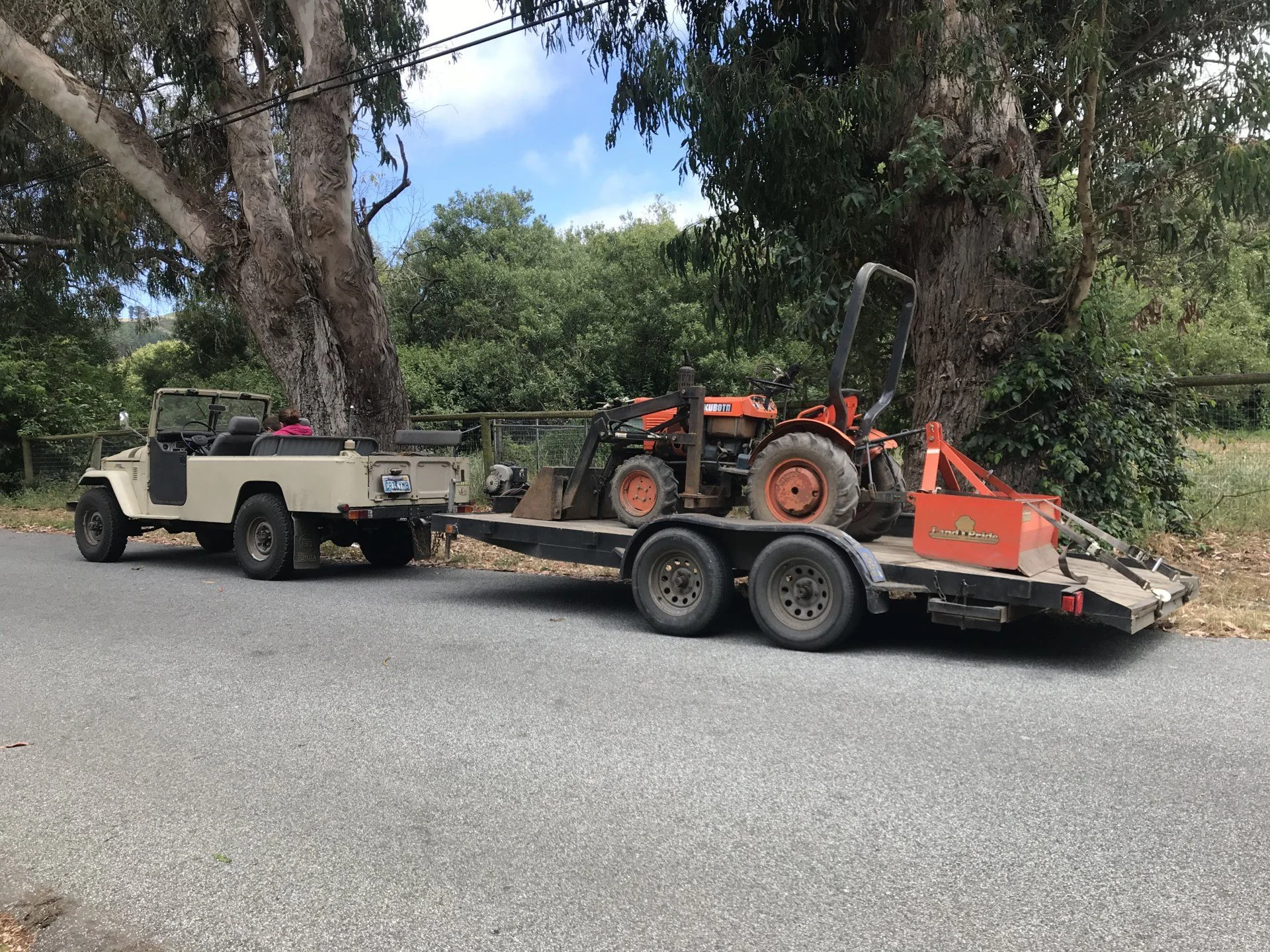

Fwiw, I towed a small tractor the other day to see how the Troopy would tow. It did surprisingly well and it was about 2500lbs with the trailer. And it’s a bj45 3b diesel with a turbo, 130hp max! The longer wheelbase certainly helps but I wouldn’t do this all the time, it was pretty heavy! I once saw a 40 towing a 20 ft travel trailer!! It was a v8 conversion so the power was there! I prefer my crew cab dually Duramax!

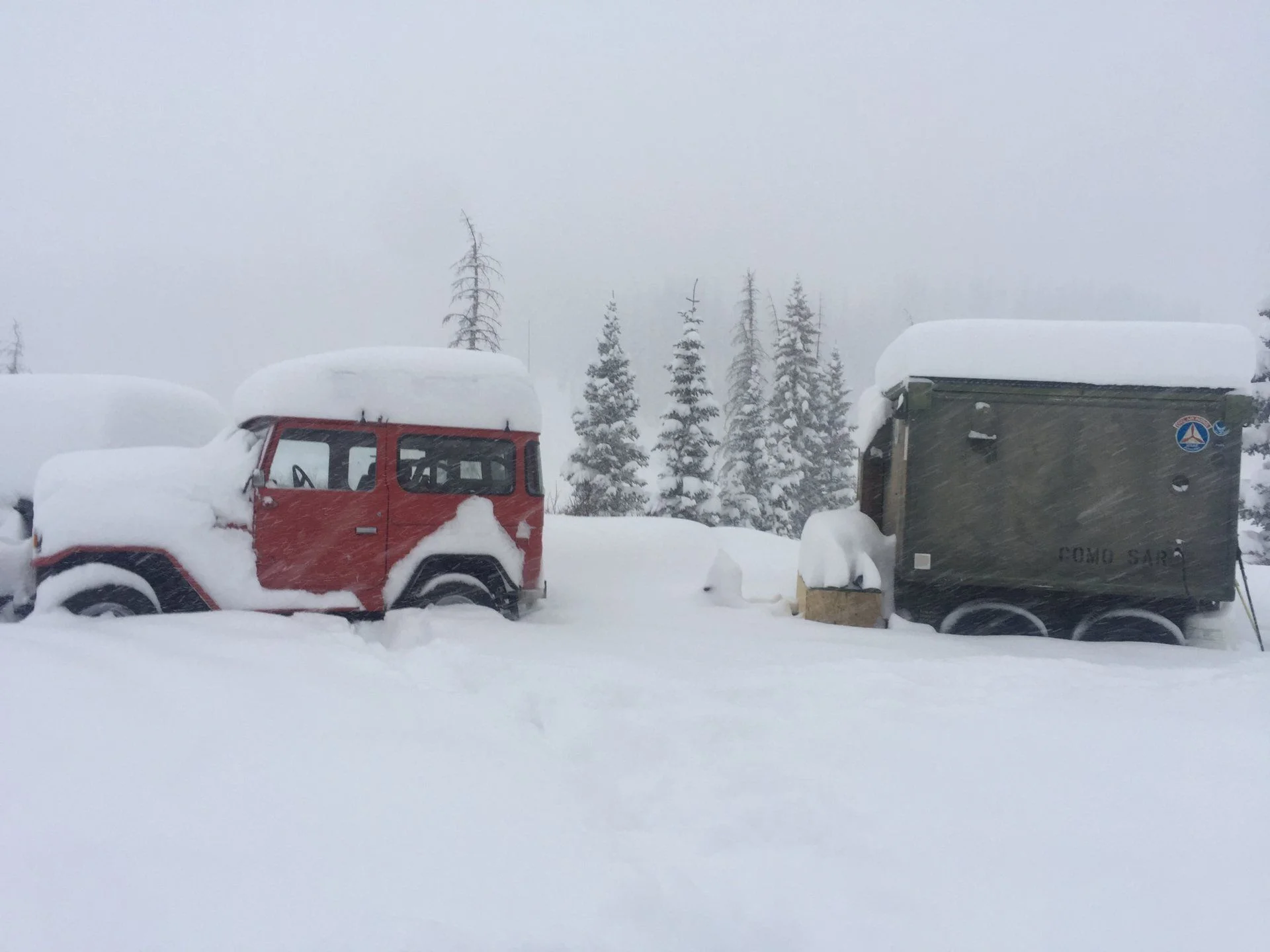

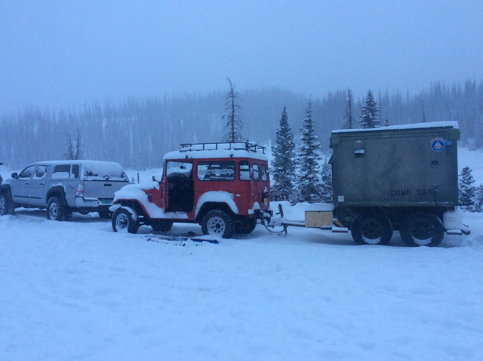

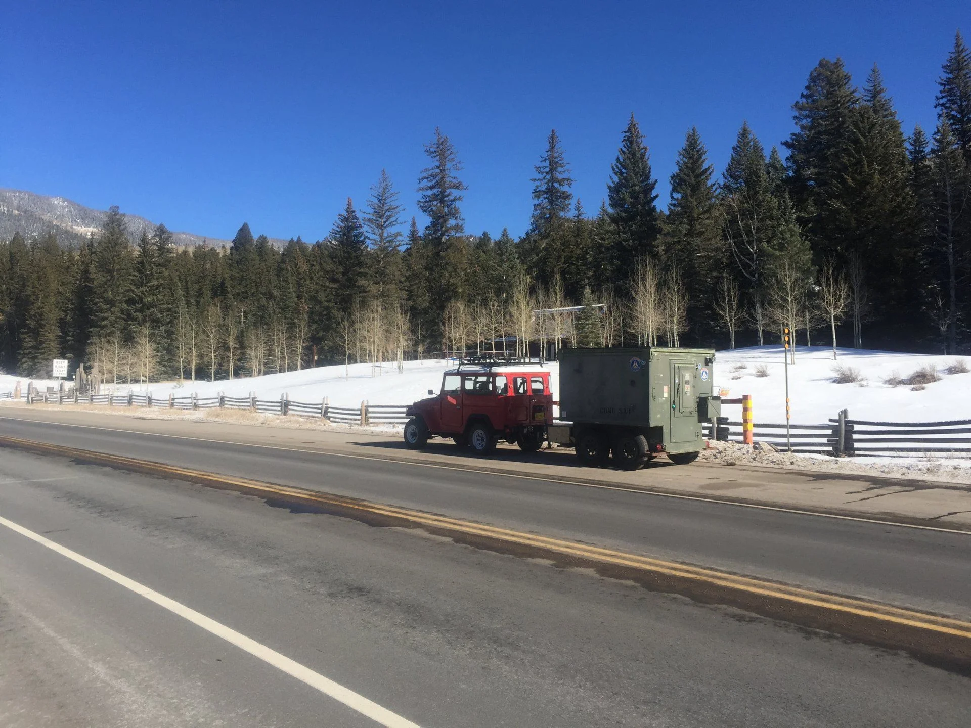

The Zombie Apocalypse Trailer is roughly 2000lbs with a tongue weight of about 220lbs. It has the aerodynamics of a brick. No electric brakes (. I know I know it’s on the list).
I’ve towed the trailer about 10k miles this year alone and the 40 hasn’t had any problems. Drive sensibly and leave plenty of room ahead of you and you’ll be fine.

Agreed. Some time this year I’ll be replacing the torsion axles on the Zombie Trailer for ones with brakes. That said I’ve been up and down most of the mountain passes in CO this winter in search of POWder and felt that the truck/trailer combo performed admirably in all conditions. Judicious use of engine braking and a “never in a hurry” attitude probably helps.
