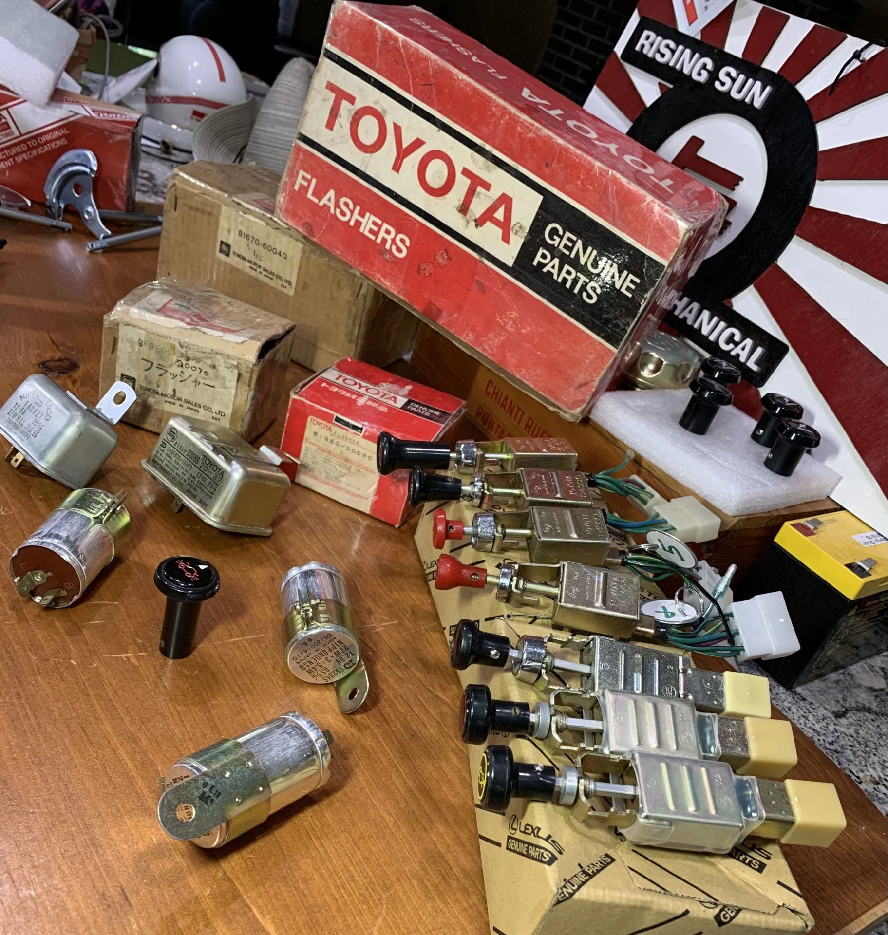

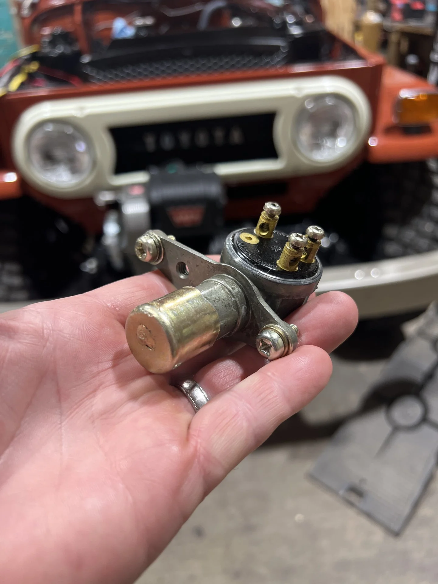

The OEM foot switch did the trick and now we have low beam and high beam lights
Headlight switch permanently in place.

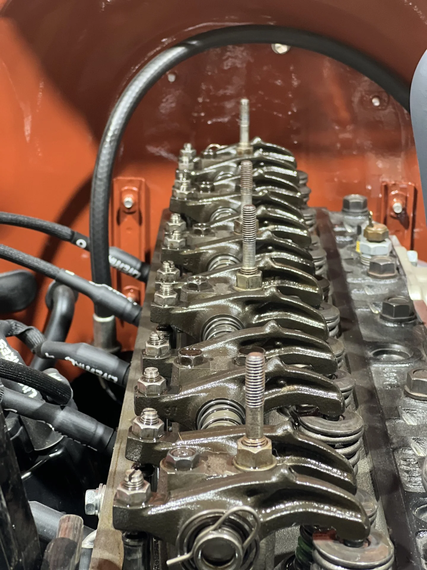

I took it for a nice long test drive then came home and confirmed the valves once the engine was hot.

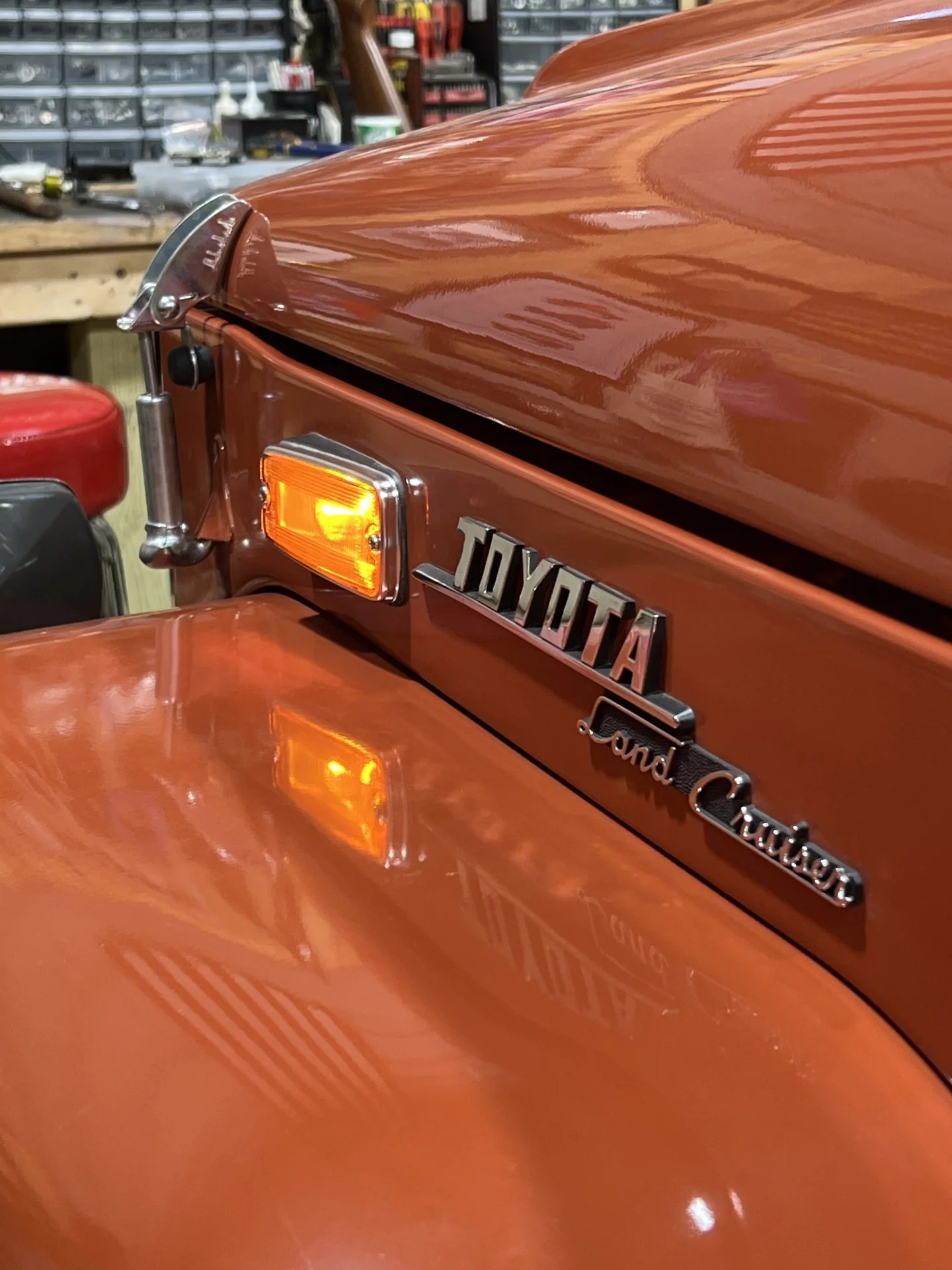

Right now I have no blinkers. This harness has no hazard switch and the blinker switch on the column is new. Not sure what I’m missing on that.

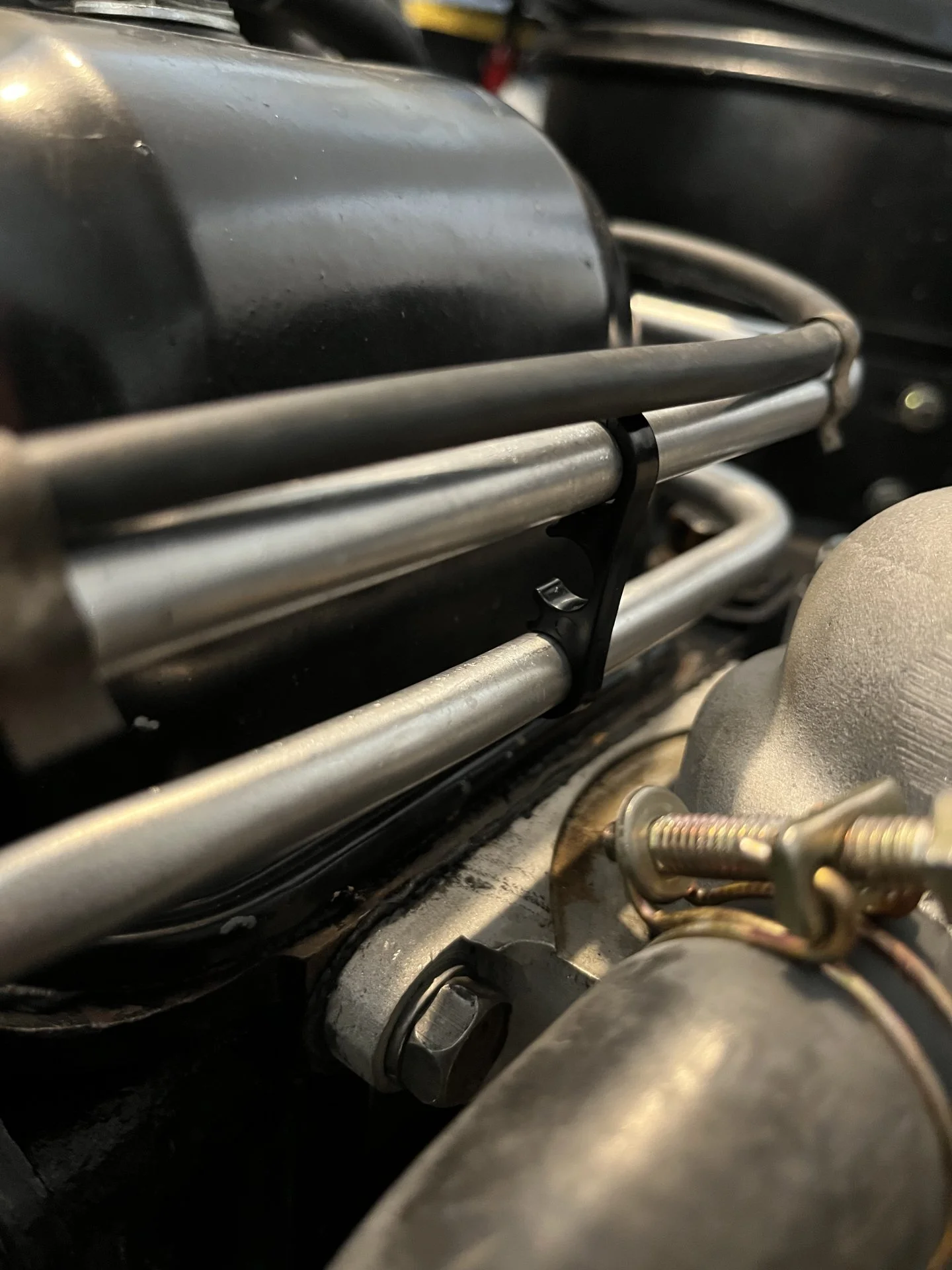

I removed the feed hard line and replaced it with a rubber line wrapped in head shield.

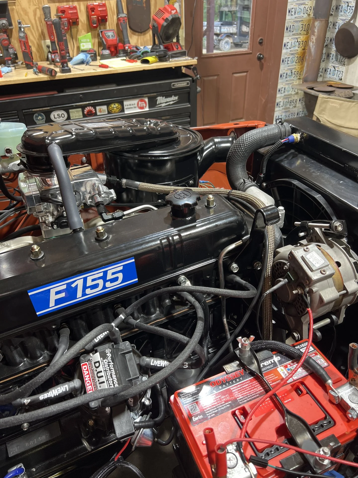

No noise.

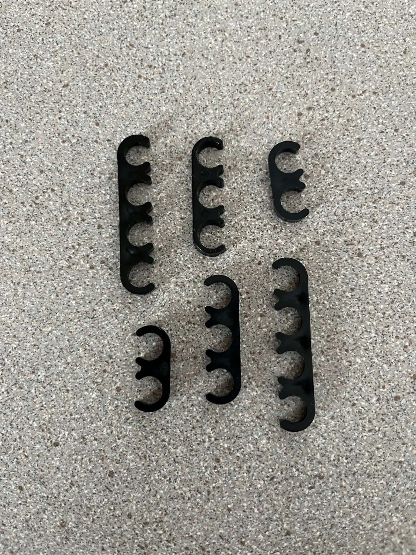

Not to sidetrack this any further. But…. I removed my aluminum separators and temporarily install some cheap plastic plug wire separators. No squeal.

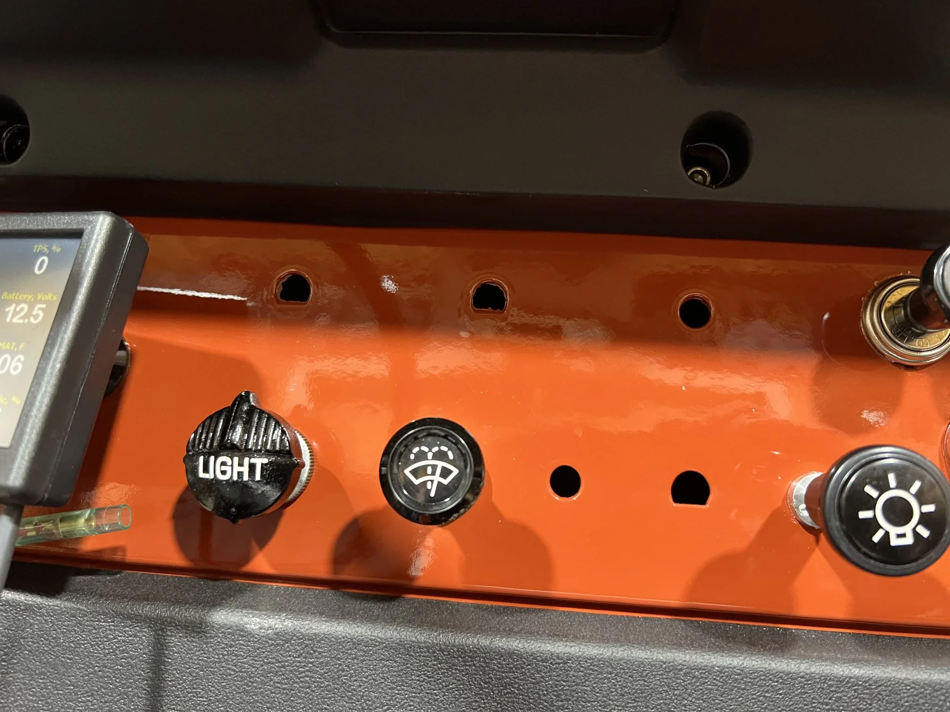

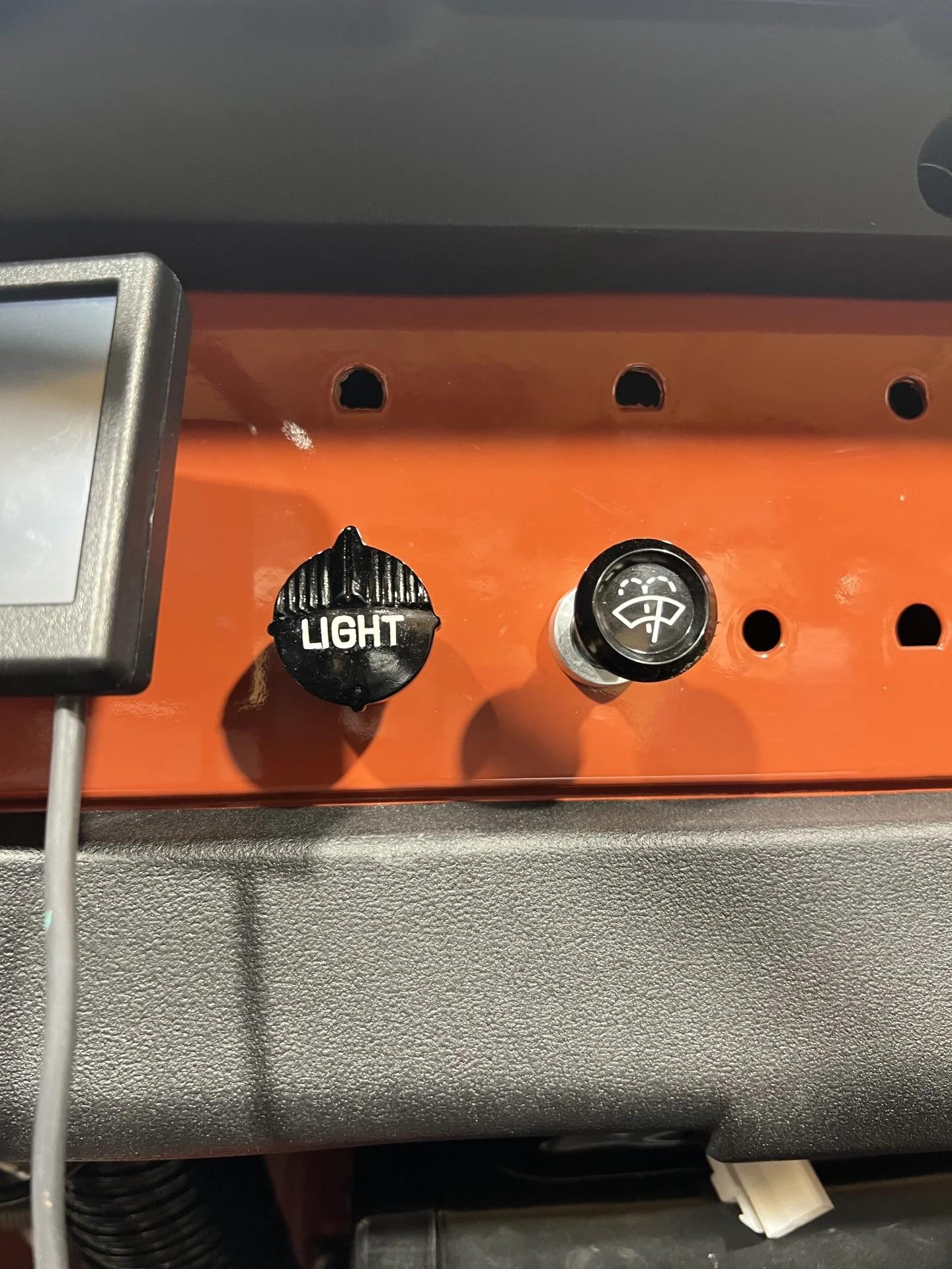

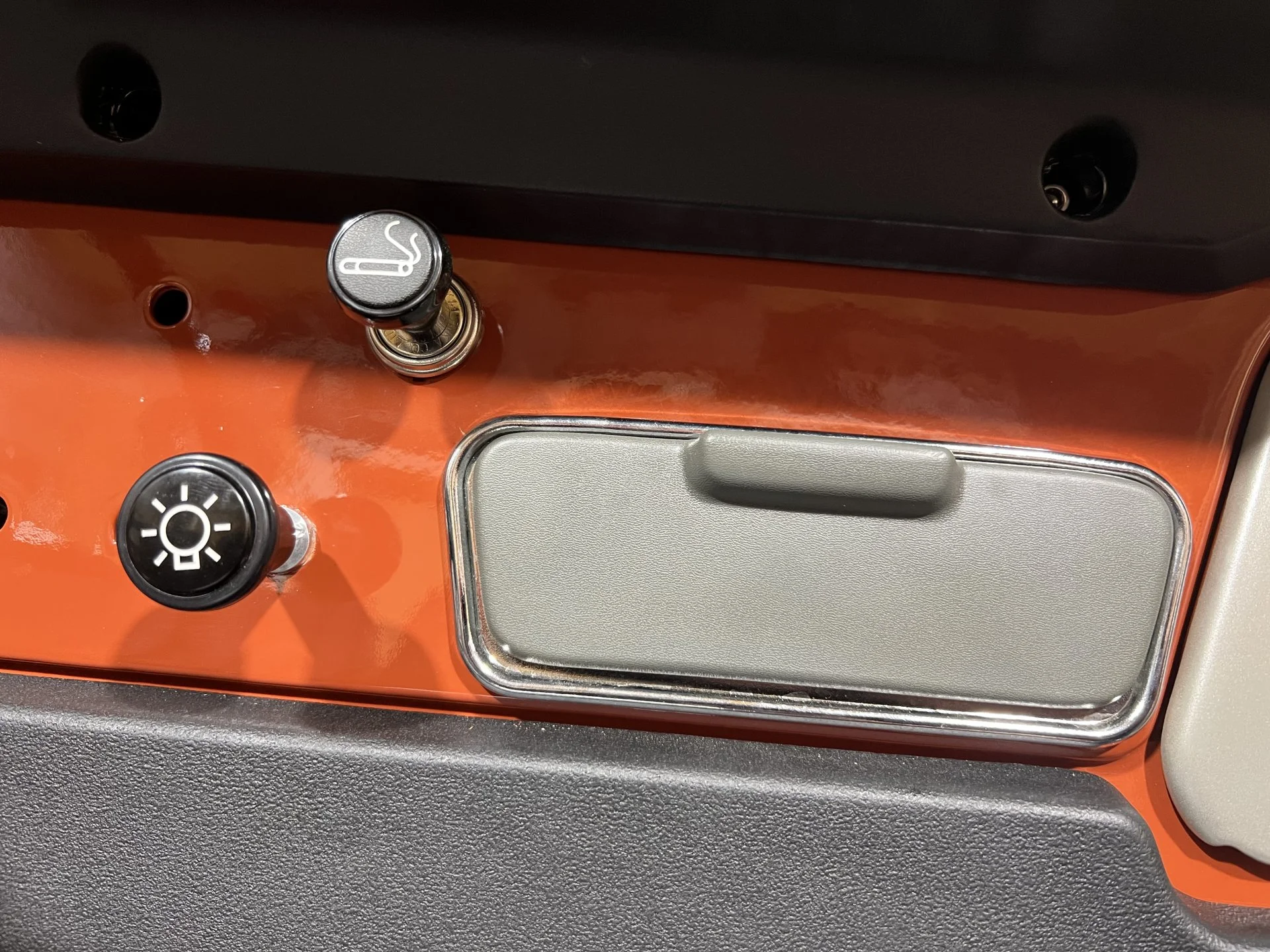

Vader light. Decided to use this switch versus the old style with the tiny knob.
@ToyotaMatt ….. these are the holes left to plug ….
One has to be a working blower fan and the rest just dummies
Did you check the valves with engine running? I’m trying to muster the courage to try it.
Jesus no.
I know you could check them that way if you had to be no way to adjust them.
Jesus no.
I have a 72FJ40 that needs the adjustment, I’ve looked at five repair manuals, including Landcruiser Bible, haynes , 1972 Toyota FSM, etc. Three of the 5 books say to do it with the engine running! Yikes.
I've done it with the engine running. Once you get the hang of it, it's really not that bad. Moving a warm engine by hand to open the valves is preferred, but if you have a worn cam making it more difficult to tell if the valves are completely open or not, adjusting them while running works better.
- there should be a incorporated :
- ( originally optional port installed equipment feature Sub-Harness Section & a HAZARD Switch assy. itself Kit 1962-12/68 )
1/69 - Later the HAZARD switch , and it's Sub-Harness circuitry became standard equipment feature )
Mark confirmed this harness was not built with a hazard. I certainly don’t have the wiring poking out for something so obvious as that. It can be wired through the blinkers but I don’t even have blinkers now so I’m not introducing more stuff
