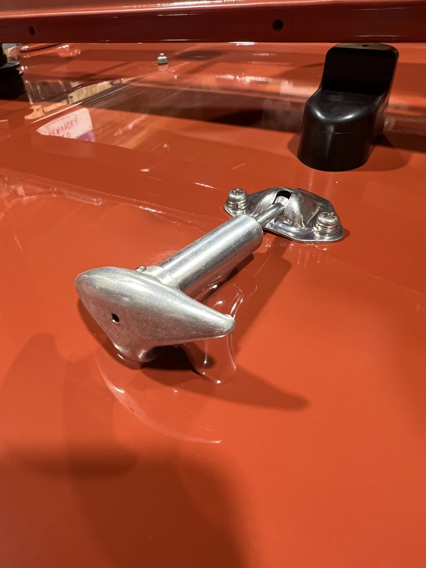

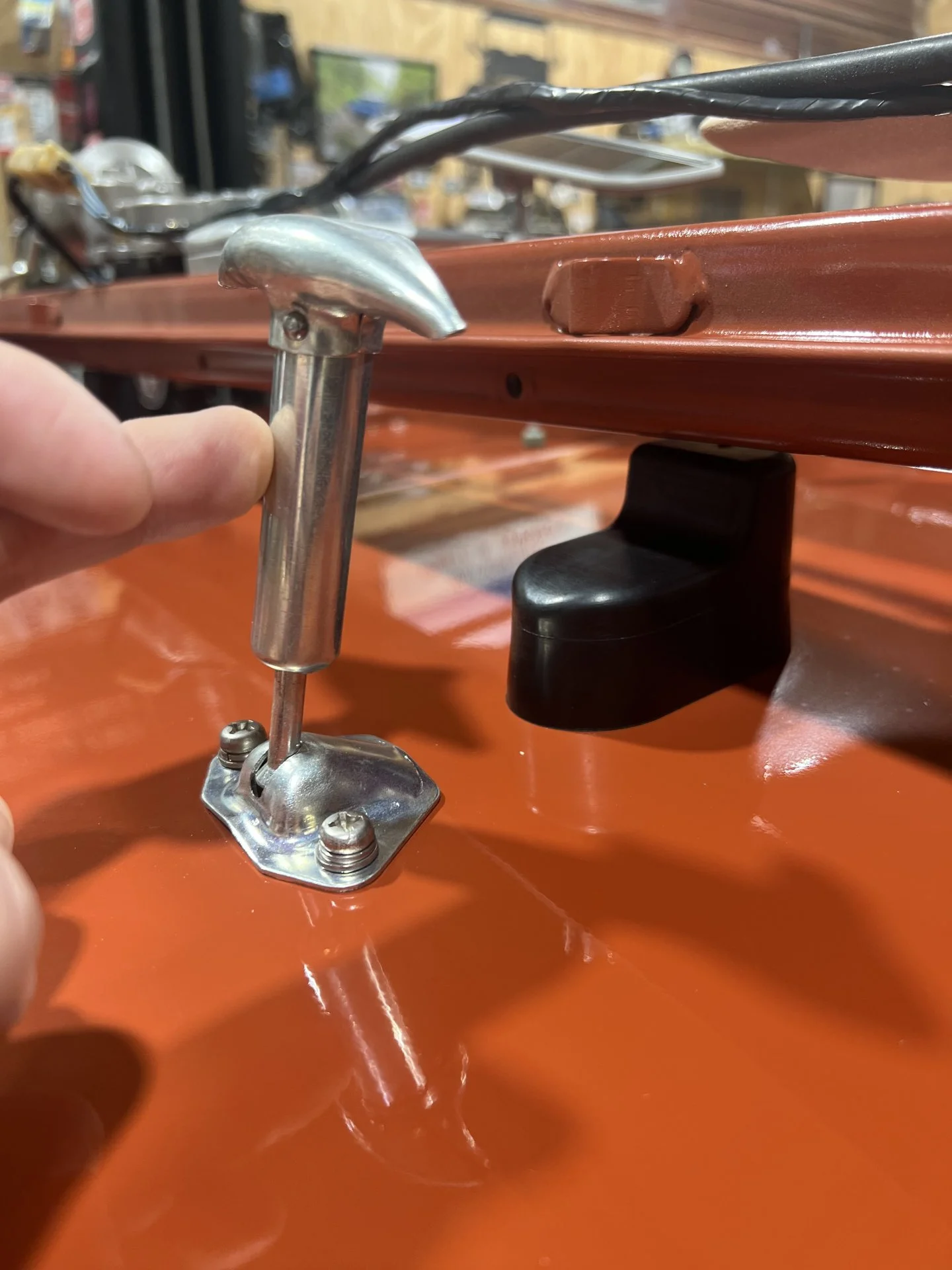

Added the beautiful OEM door straps and dropped the windshield for todays ride.
Weird though, the hood latches don’t have the proper groove to latch it down. I don’t have another one here to look at but is this the only way they come now?
Yep, updated/superceded style only readily available nowadays. The earlier design with the fiddly l shaped brackets allowed a lot of pivoting possibilities

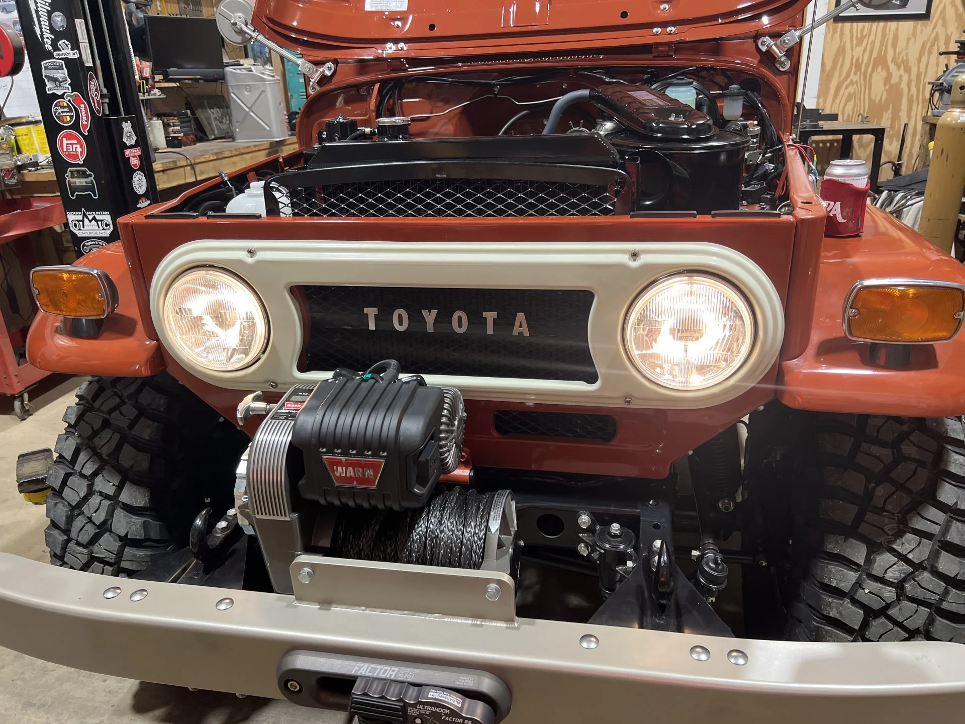

Man. Totally frustrated today.

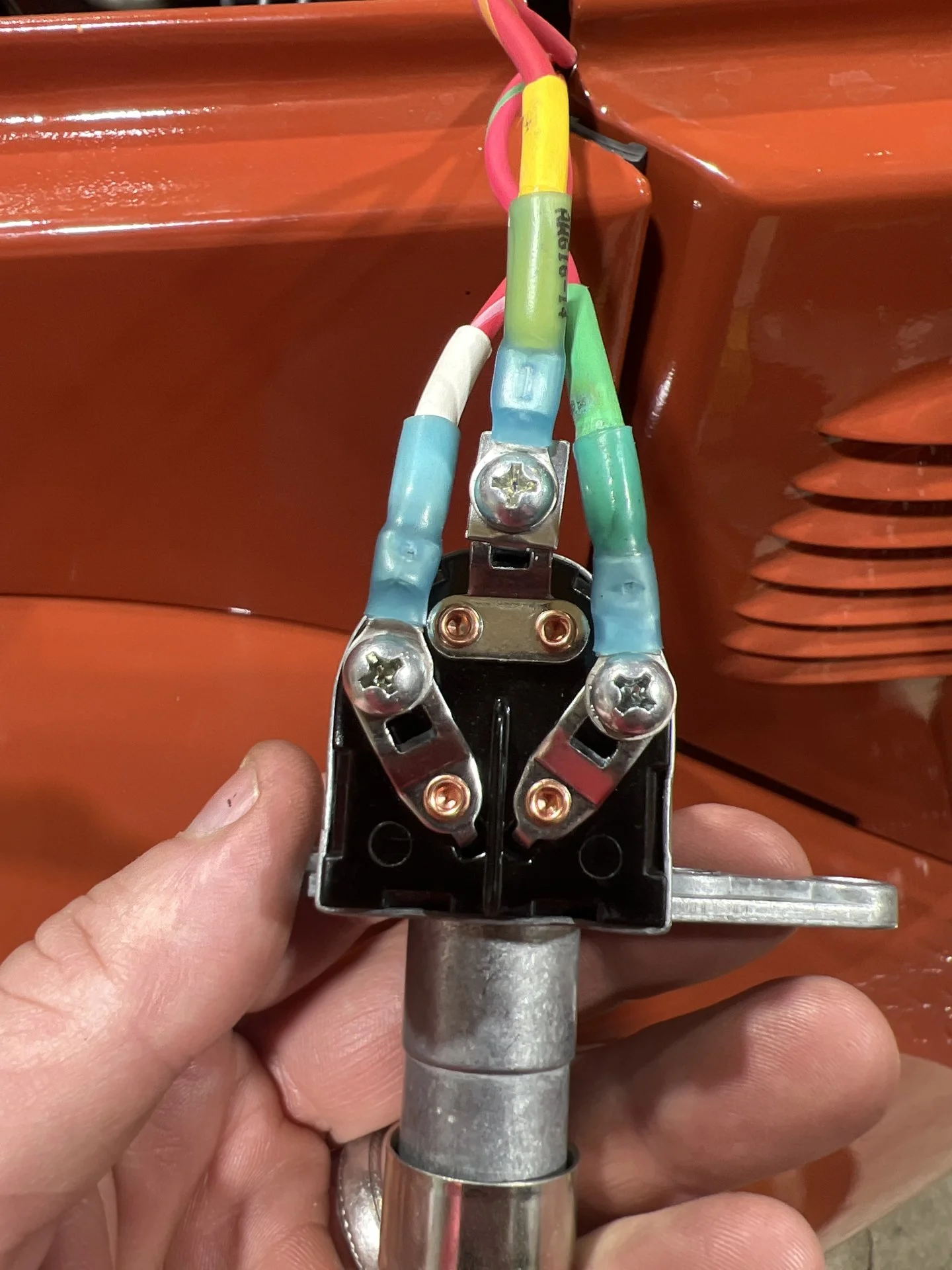

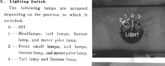

I got the 4 position light switch installed.
It works great but only to the rear harness and to the dimmer switch on the floor.
It’s like the entire front harness is just dead. No park, flasher or headlight power.

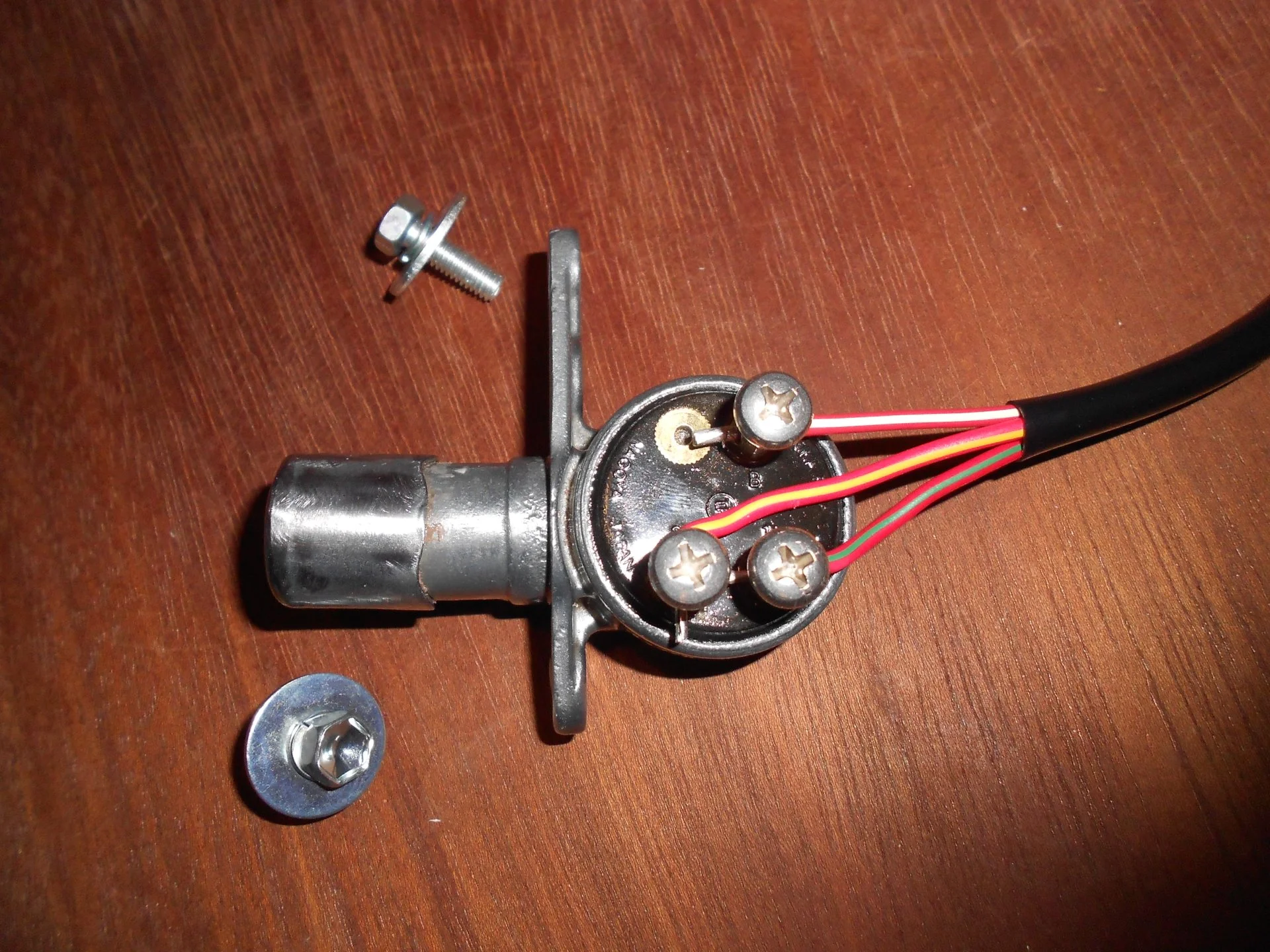

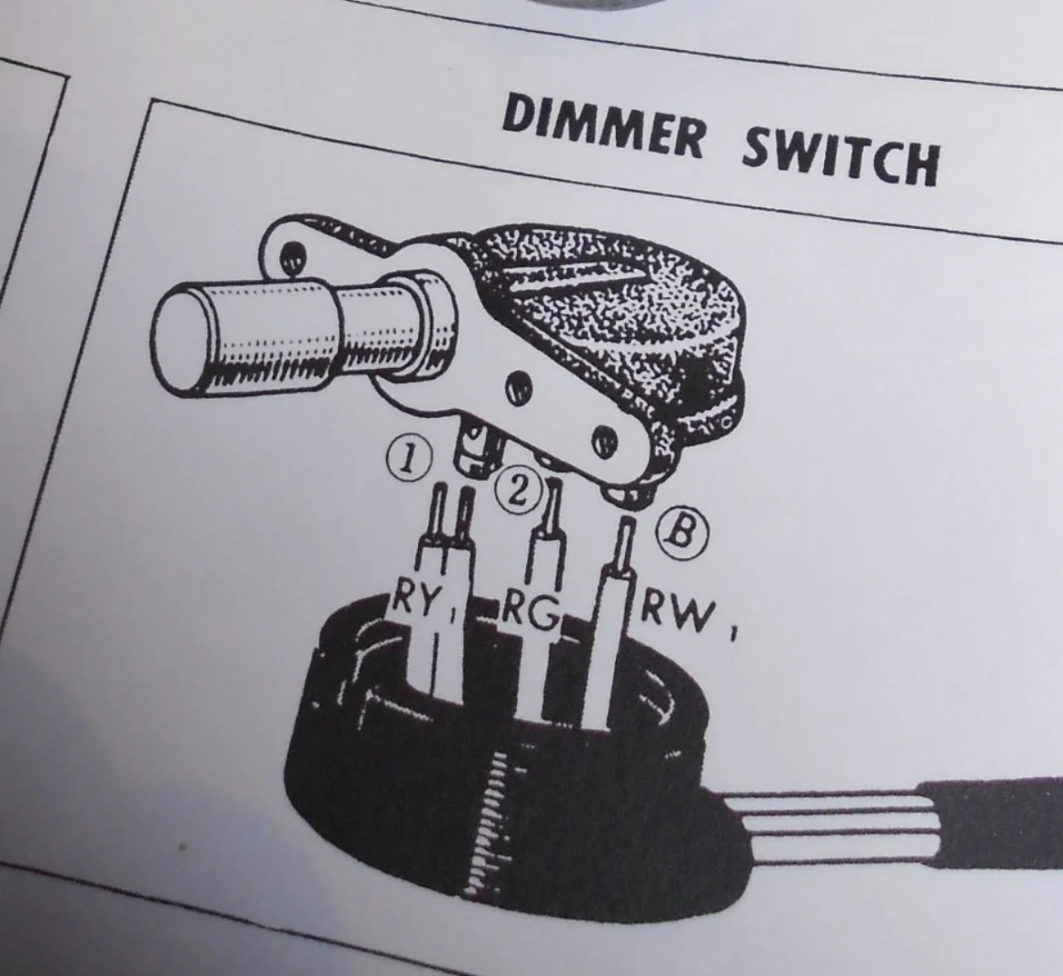

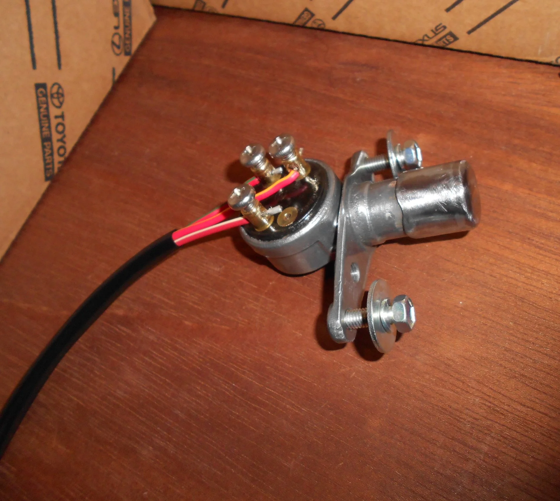

Does that new switch have any markings on it? RW is coming from the battery (fuse).
@ToyotaMatt is sending me a NOS dimmer switch. I’m pretty sure that may be what’s keeping me from getting low beam power to the front of the truck.
Cowboy was not interested
I’ve chased all the leads I have and I think that is my log jam.

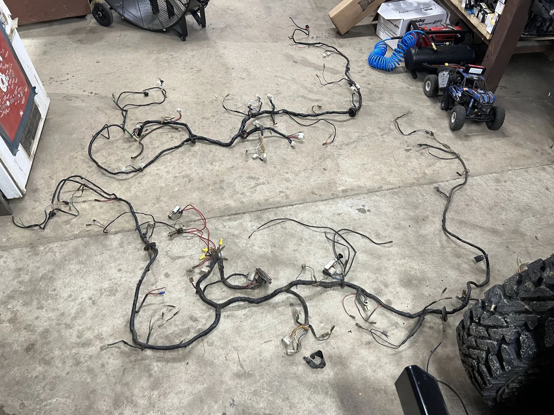

I also went as far as laying out the old harness and the Yemen harness and considered starting over but I think that’s a pre mature idea.
I have an email out to @Coolerman to see if he can actually draw me a diagram for this harness. It does not quite add up to the one from his site I’m using.

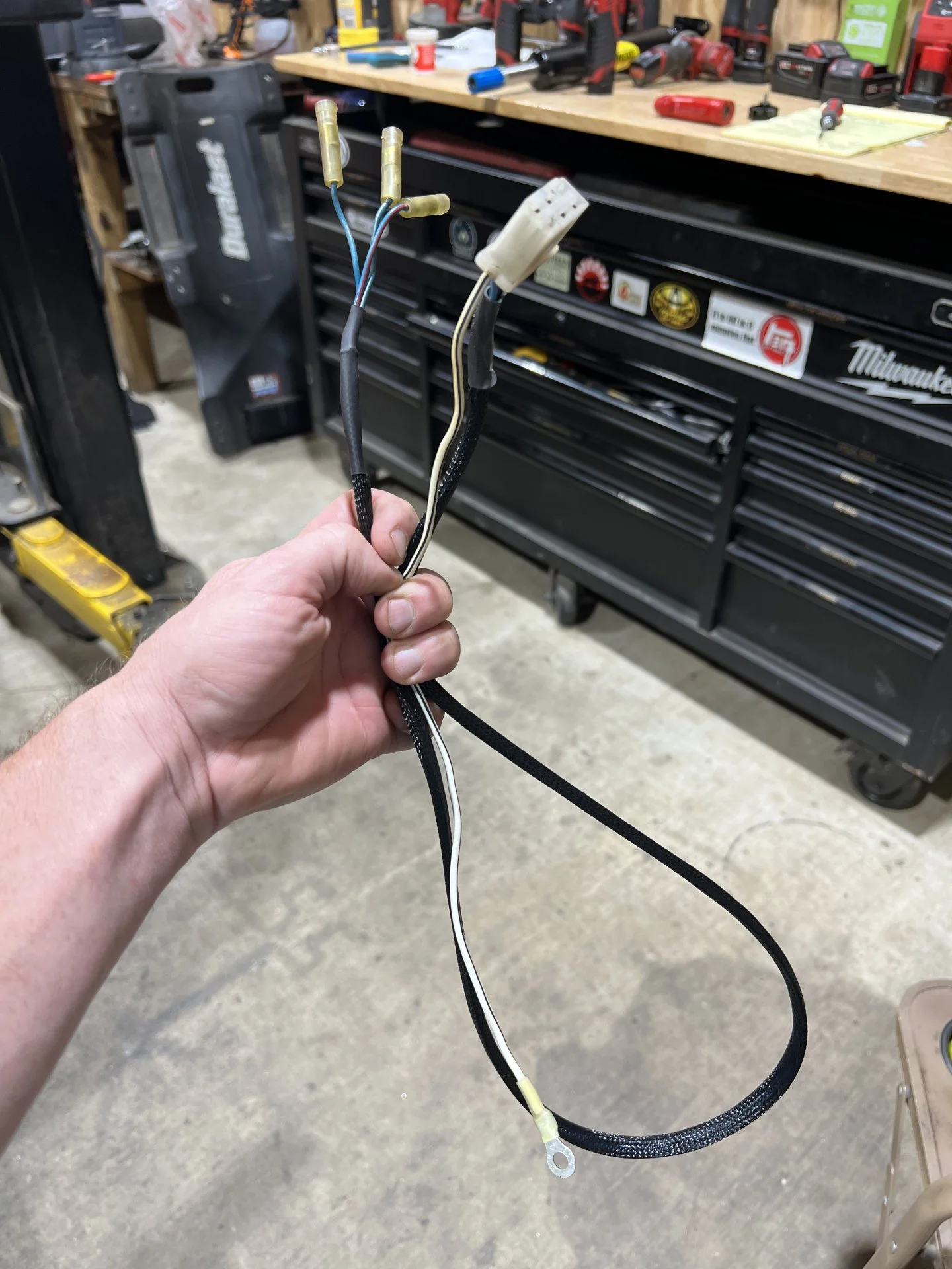

I was going to use an old single position wiper switch but I decided to dissect out the new style plug and harness with bullets from the old harness. I loomed it up and now we have working wipers and a modern switch

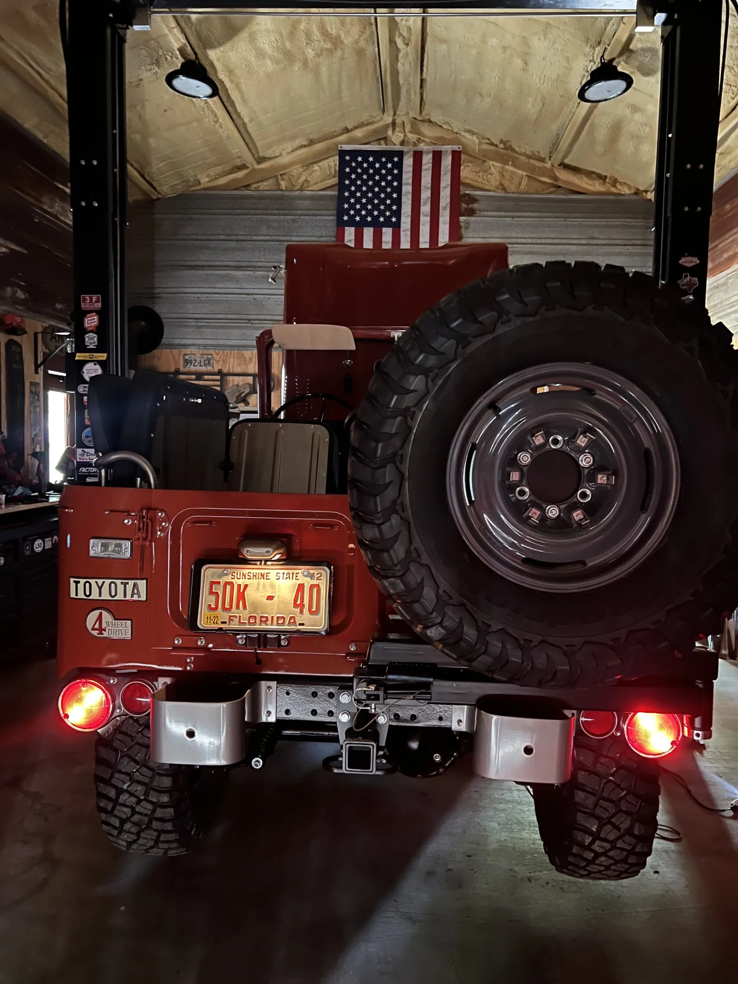

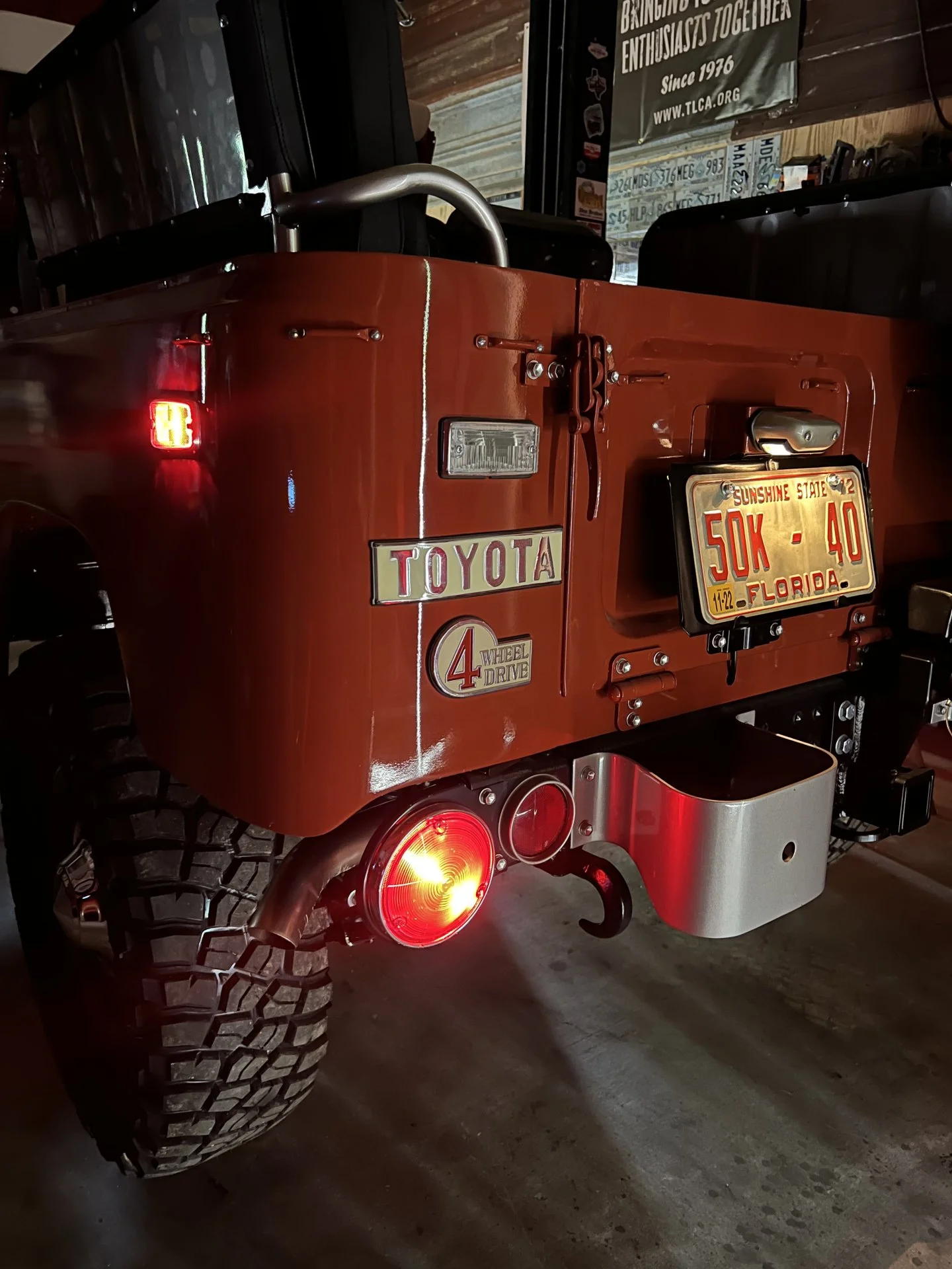

Then I moved to the back. This harness will get you close but I had to add all the side marker and plate lights. Both brake lights work now.
Rear is DONE
