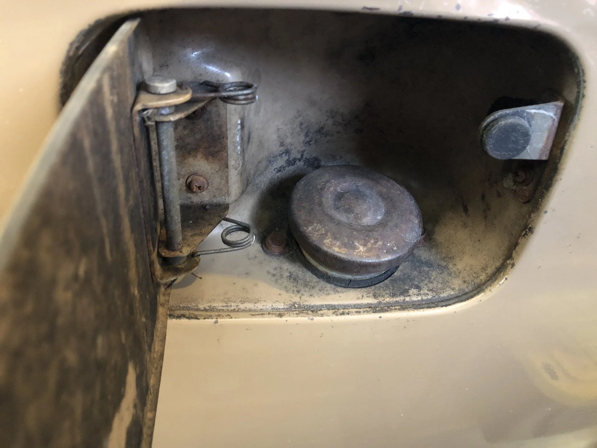

What color is the inside of the gas door?

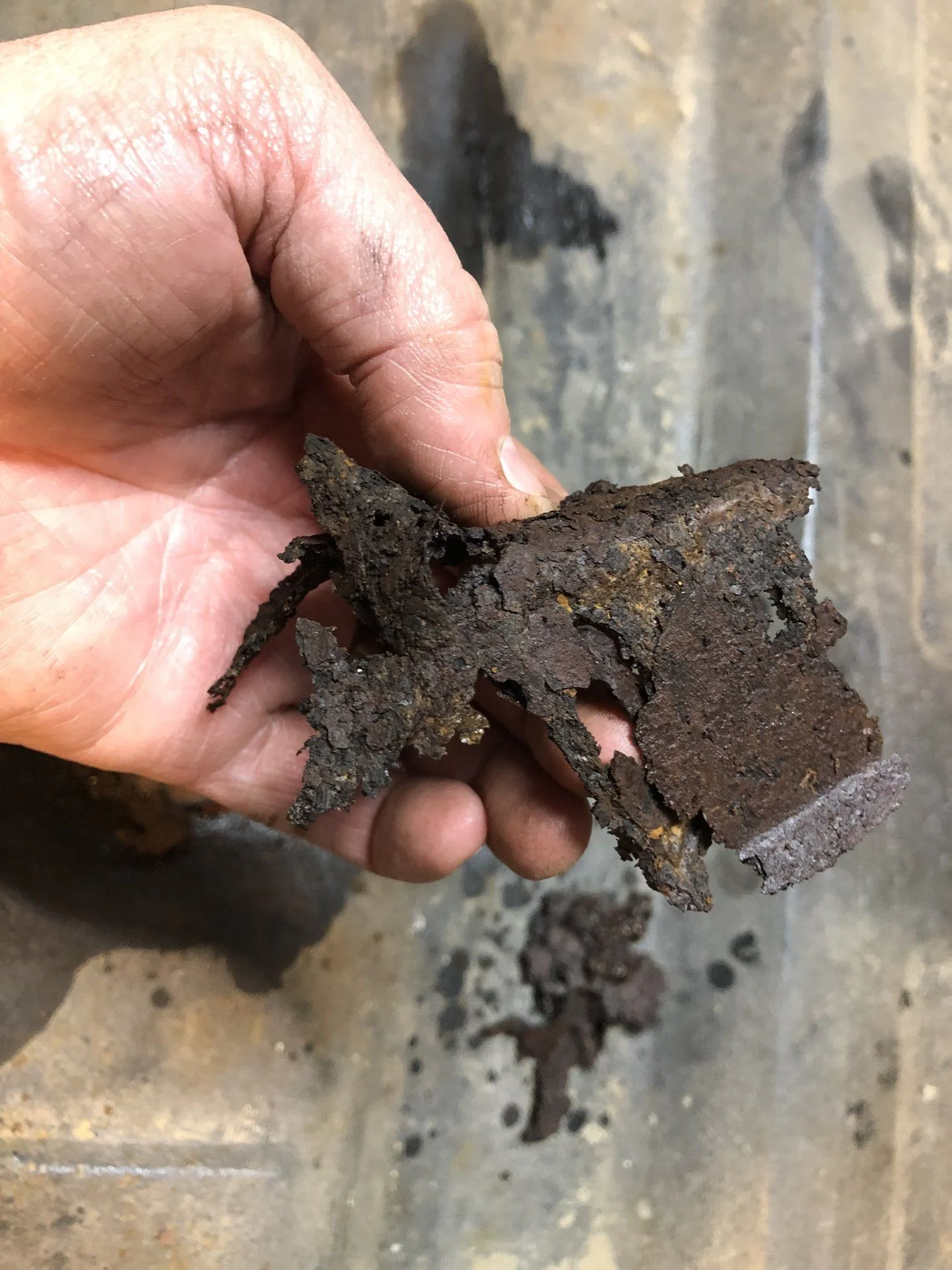

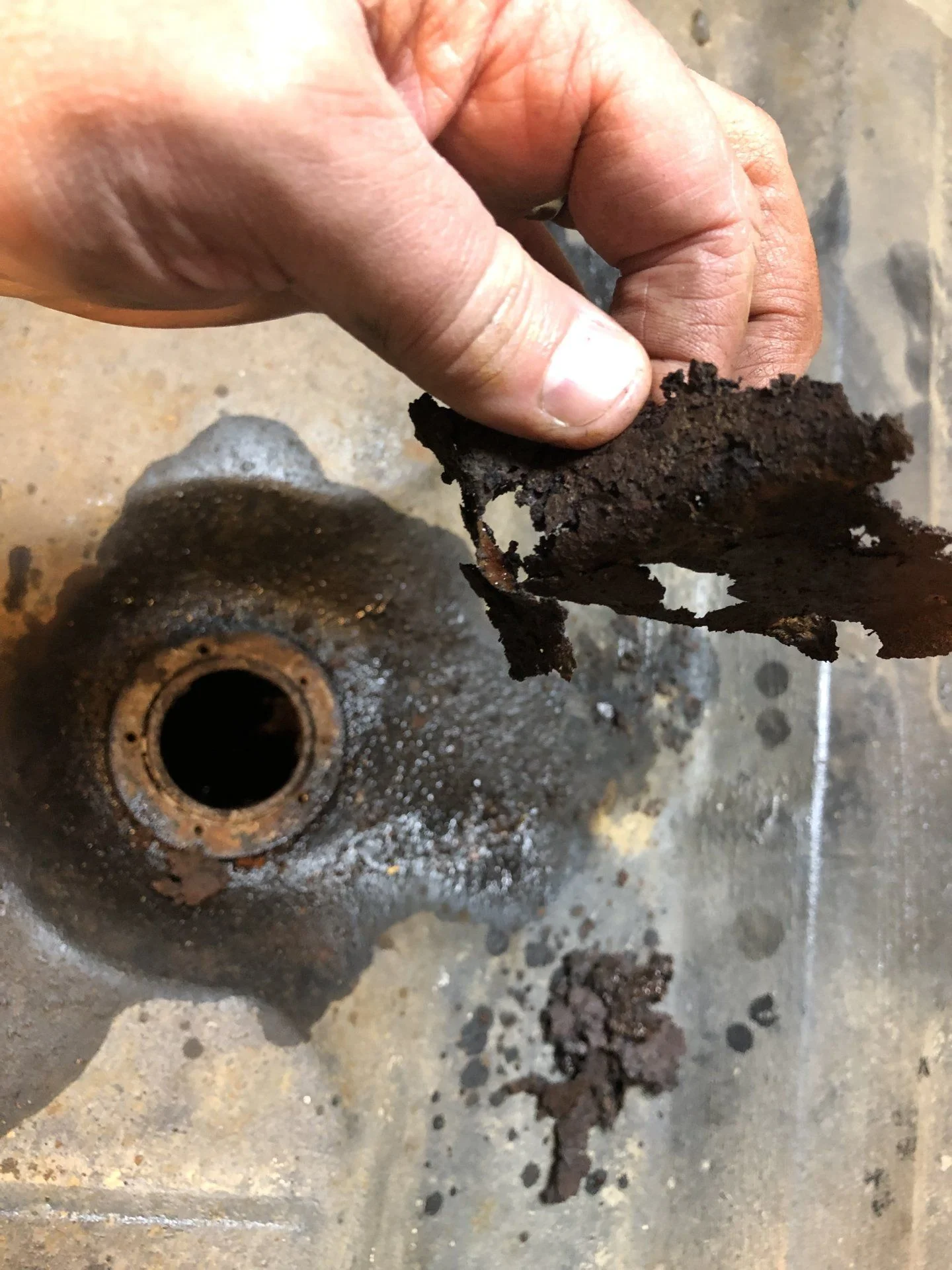

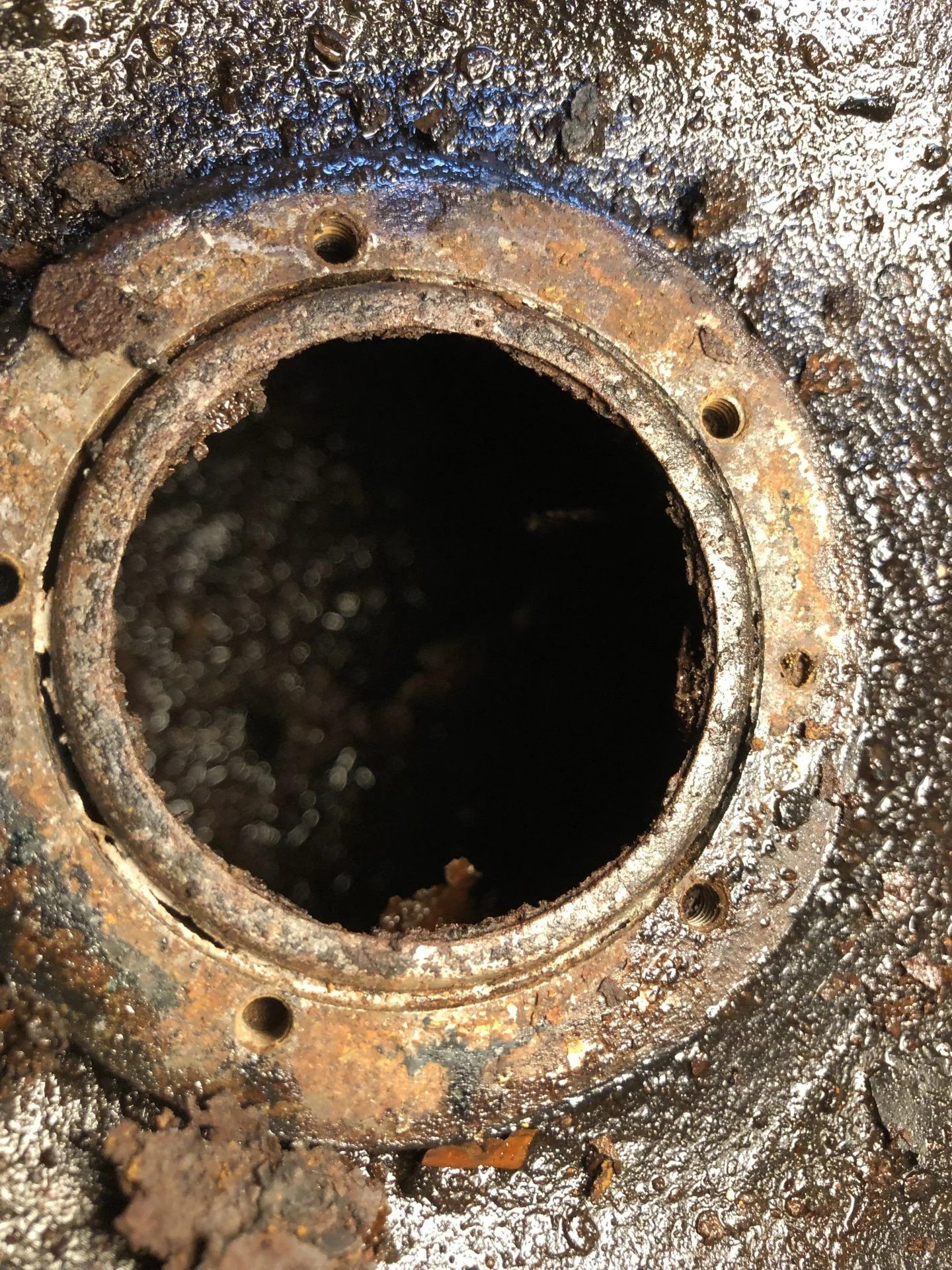

Bucky has some fuel issues. In the small amount of driving the truck that I have done just moving it around the yard and a couple of trips through the neighborhood, I have already filled up one fuel filter with gunk and clogged up my carb. My folder of old receipts shows that a PO had the tank cleaned and lined in 2000. I decided to drain the gas and drop the tank to see what was going on. Not good.
1926365
1926366
1926367
If you've ever wondered what a failed tank liner looks like, this is it. The gunk came off in big chunks. There is probably a gallon of this stuff rolling around inside. It is flexible like plastic or some sort of epoxy. I think this tank's days are up.
If it isn’t rusty I would send it out to a radiator shop for cleaning.
I'm going to try but , as you can see, there is quite a bit of rust mixed in with the failed sealer. I may have to have a tank fabbed up.
My tank was ridiculous but came back perfectly clean, not cheap but looked new inside.

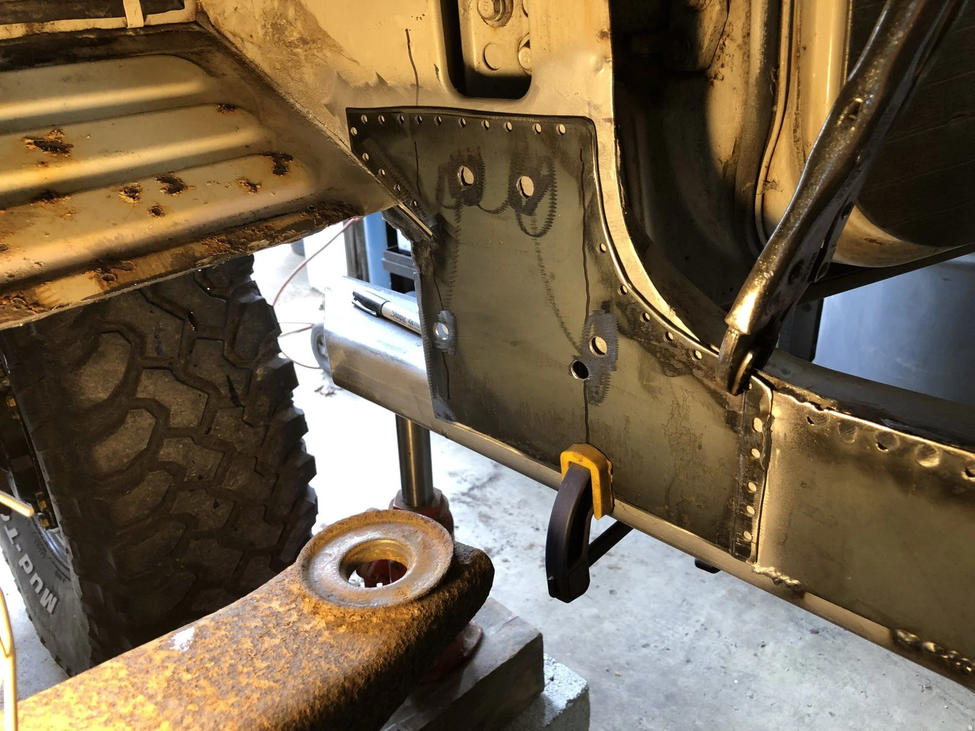

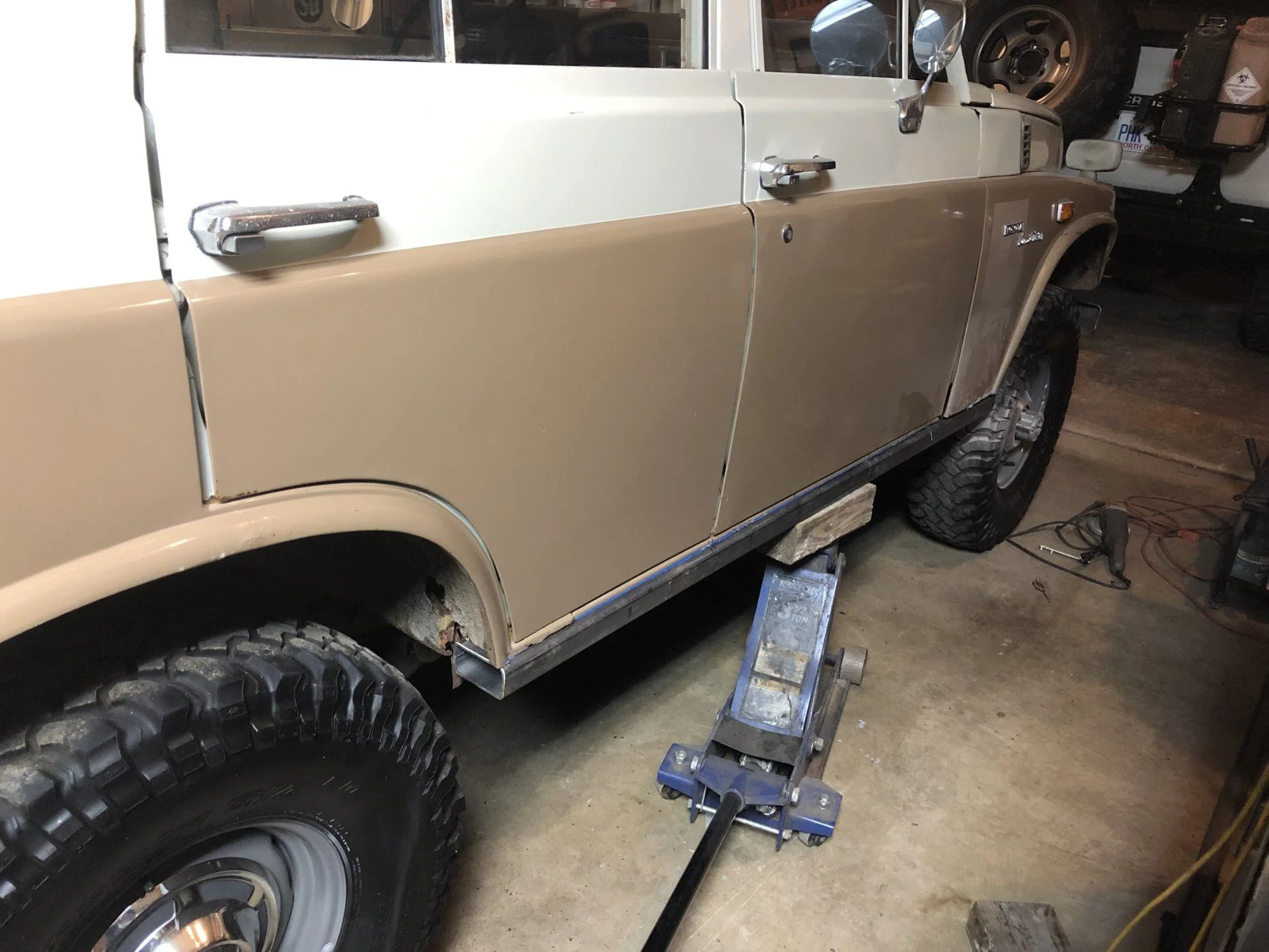

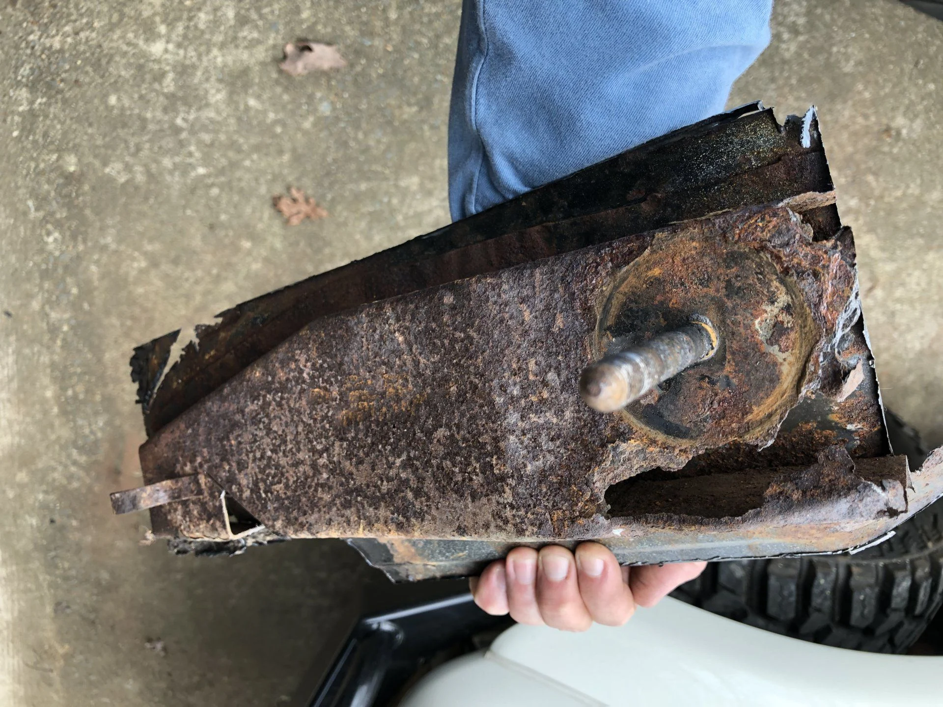

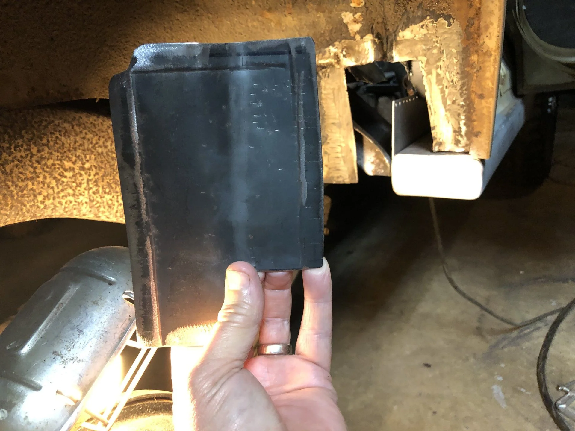

So I dropped my tank off at a local shop to see if they can work a miracle. I guess we will find out soon enough. Meanwhile, work continues on the passenger side of the 55. Rusty rocker cut out. New tube rocker going in.

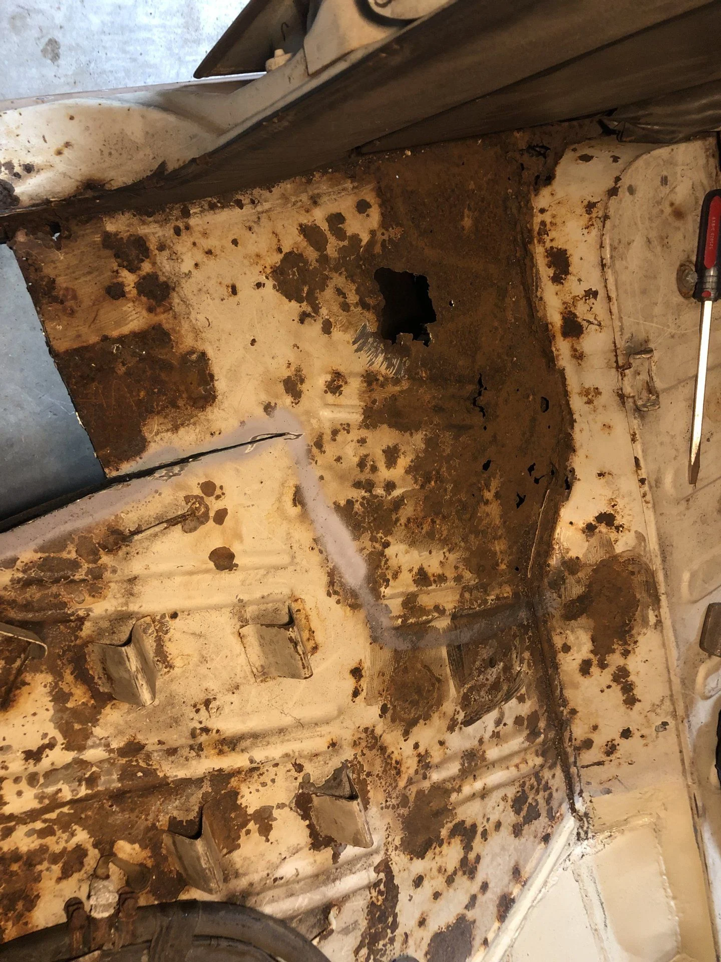

I am much happier with the condition of the passenger side of this truck as compared to the driver’s side. Overall it is more solid and, while it may not seem like it, it has been less work.

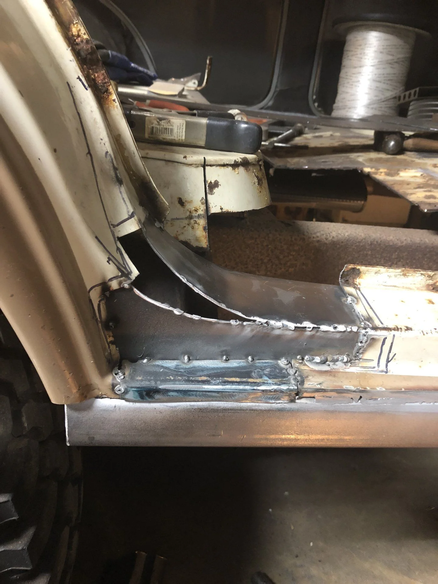

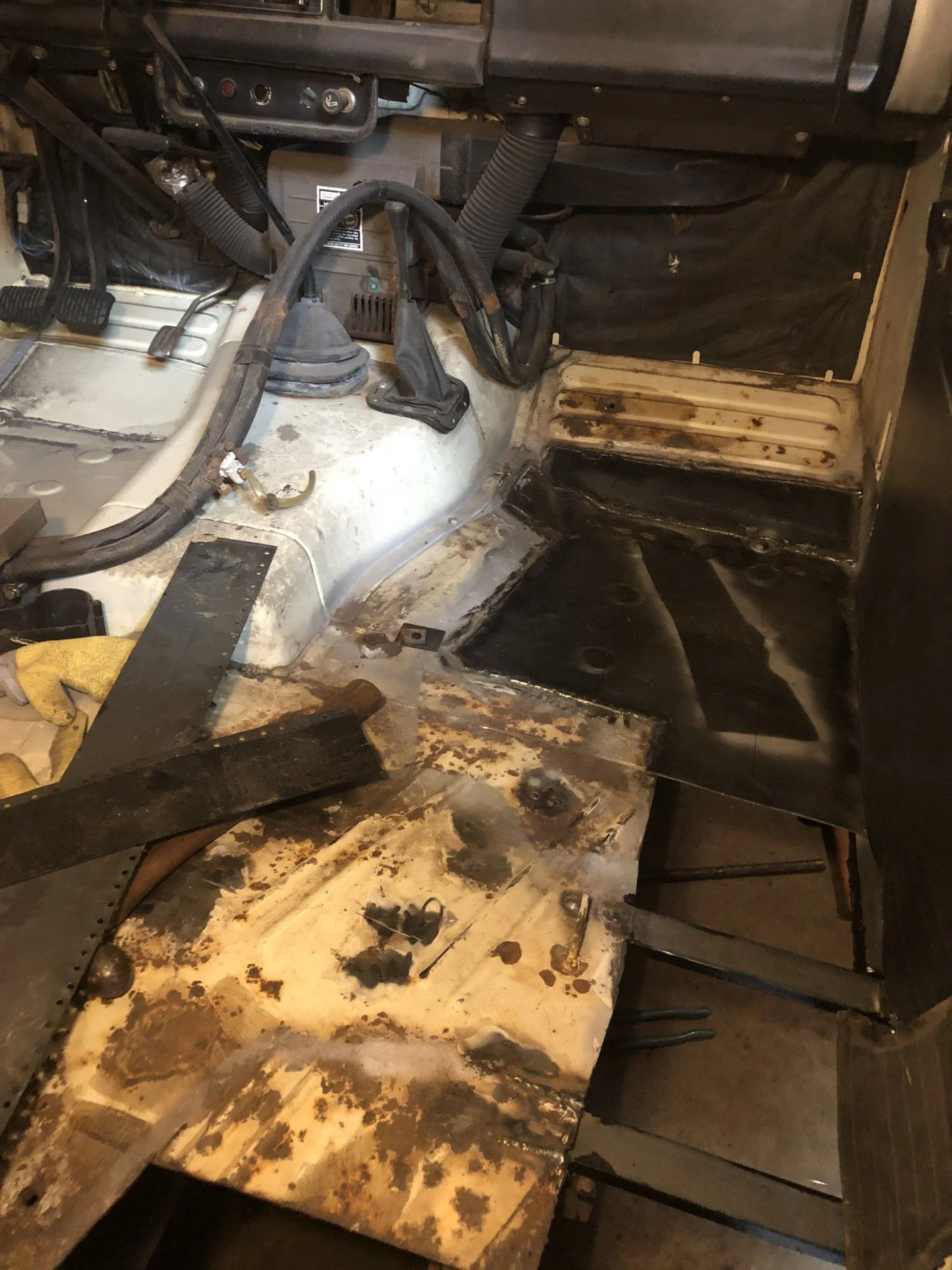

PS Inner fender wire brushed and treated with POR-15. Rusty floor and front body mount removed. Inner rocker stitched in. Next I will weld in the new body mount and start welding in the PS front floor pan.

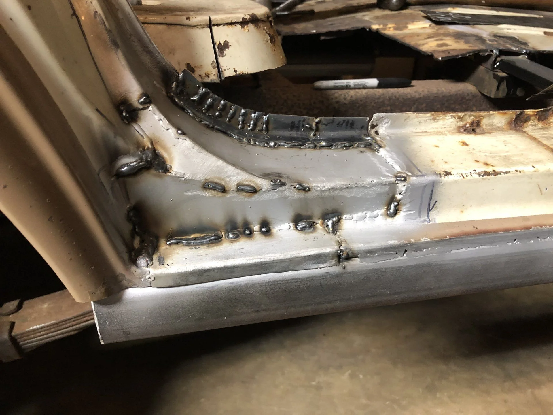

With CRR behind me, I returned my focus to good ol' Bucky. I got the PS front floor pan stitched in and started working on the rotted out PS rear door jamb. Slow and steady gets it done.
Start with a lot of little holes. Make one big hole. Fill it with steel. Repeat ad nauseum.
Nice work man!

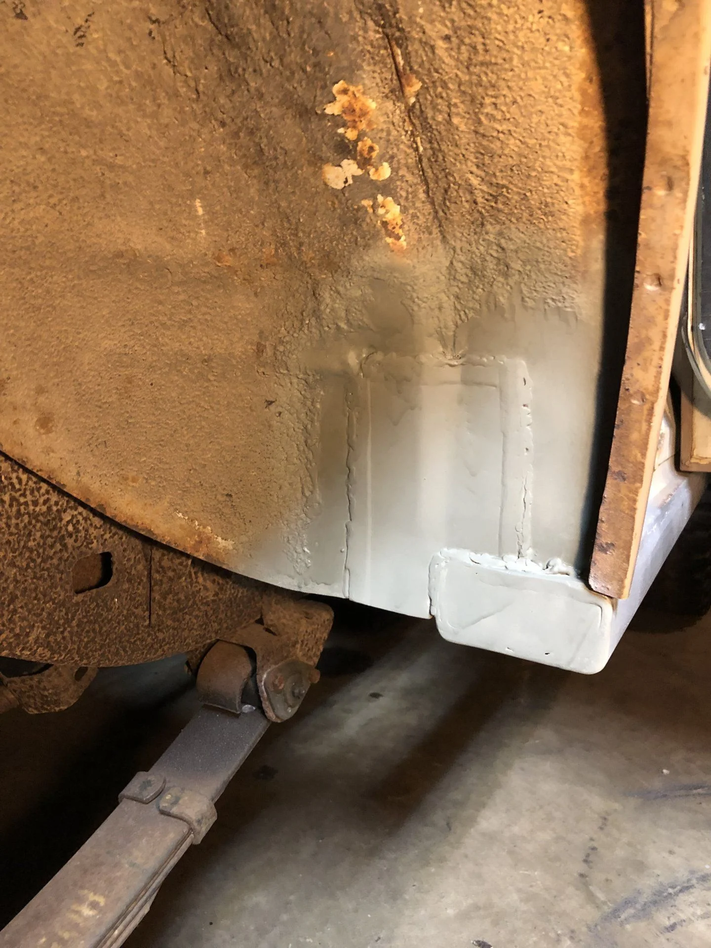

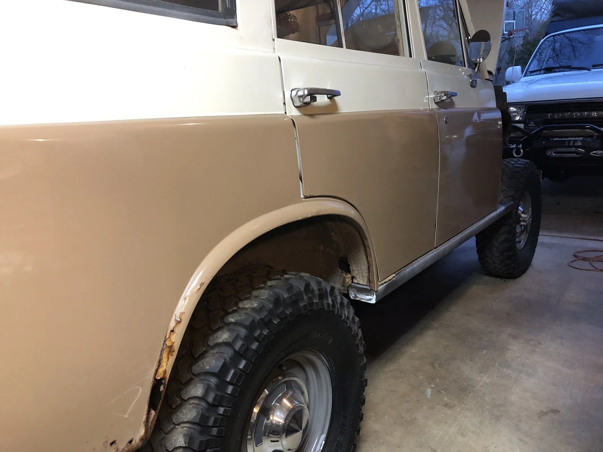

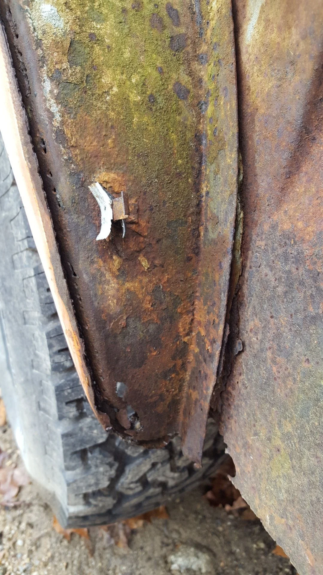

Are you going at that blister in the top of the rear wheel opening?
Will you get some good pics of the cross-section of the wheel opening?
I haven’t decided whether or not to mess with that blister. My goal is not a rust-free truck, but just a solid truck where it really counts structurally. Floors, rockers, jambs, etc. That blister doesn’t bother me much. I know it will get worse, but I’m not sure if I really care. Heck, I am debating whether or not to even fix the rotted out rear sections of the rear fender flares. I have to find a stopping point and I don’t want to do a repaint, so it’s never going to be perfect. Also, I’m getting tired of fixing rust. I kind-of need a break. I want to get this pig on the road and have some fun with it. Pablo, if do decide to cut into that lip, I’ll take pics for sure.
