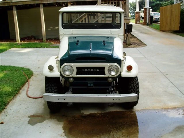

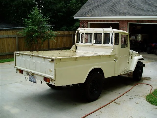

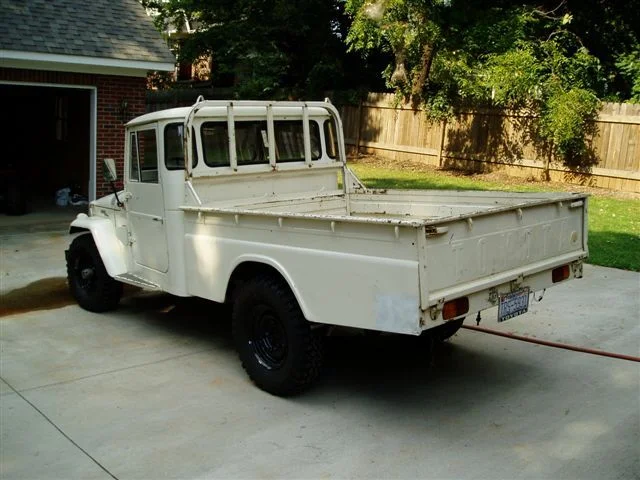

The time has finally come for me to get off my butt and "finish" this truck. I have owned it for about 5 years, and sadly, barely driven it during that time. Other projects, house, three cruisers, wife, etc. have always kept me from really doing anything with it.....until now. I have a limited time, and I mean limited, to get this thing in better shape. I'm about to lose my shop, my free time, and my money for this project, so it's now or never.
First things first, I have to strip it down to get it to the painter. From there, I will finish the front half of the frame and try to get the motor painted. Beyond that, parts will be reconditioned as time permits. My first objective is to get it mobile again as quickly as possible before I have to move.....and before the funds are confiscated by my loving wife. ;)

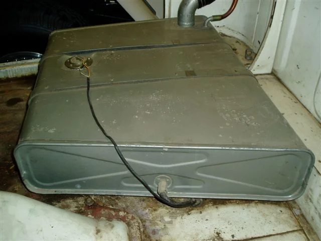

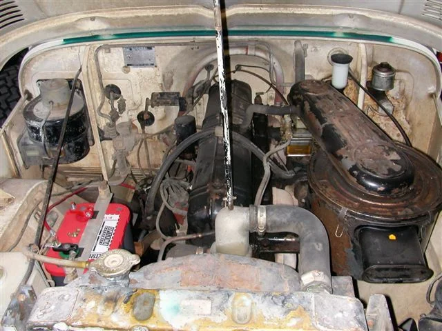

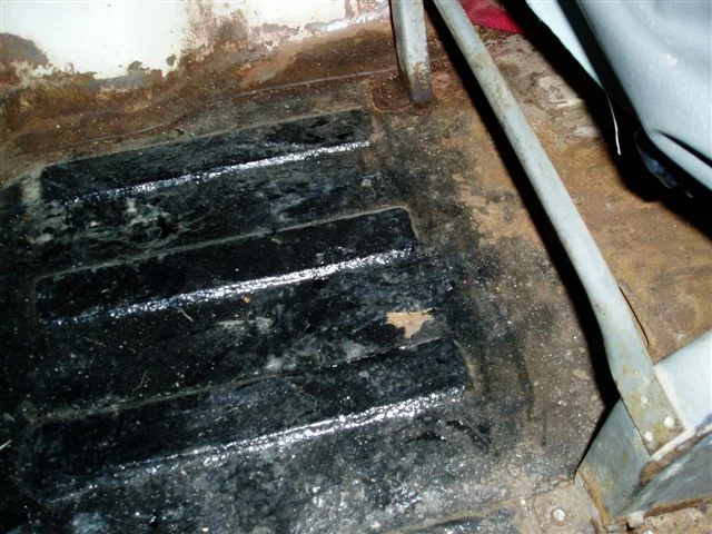

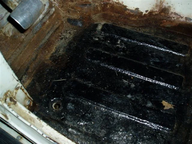

Engine and problem floor

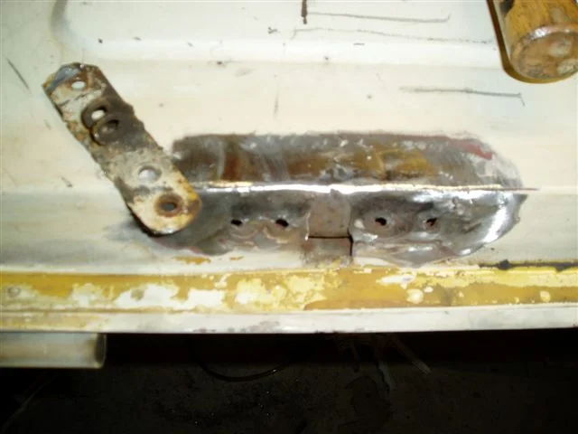

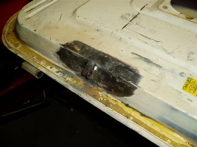

The problem with the last two photos is this is the only place I know of where it has rust...and it's bad enough that it needs to be cut out. Nobody makes a square rib replacement floor though....and that bums me out. I wanted to press my own, but I just won't have the time. I need to spend my time welding a few holes closed and straightening the tailgate as much as possible. The body man will weld in the new panels, but the little stuff is cheaper for me to do....and he doesn't like to weld little holes anyway.

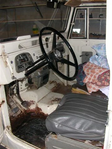

Moving on......hard top and doors off, seats out.

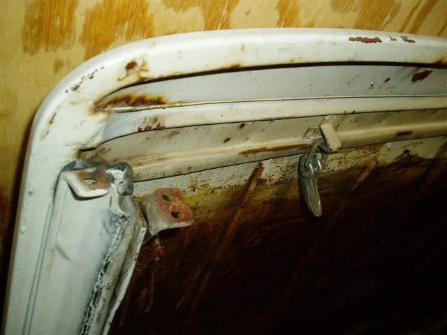

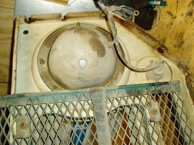

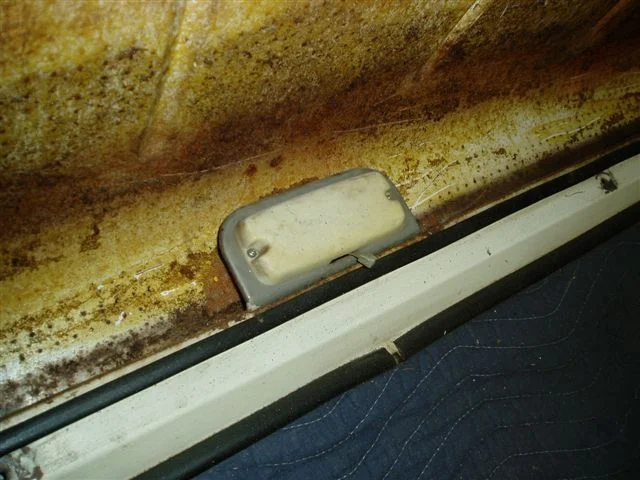

Looks like one rust spot between the hard top shell and the front "valence". I won't know how bad that is until after it's all cleaned up. Bib is off and perfectly rust free....I was wondering about this spot, since they are so bad on many. Funny thing is ALL the rubber I have pulled out (save the windshield gasket) has been in great condition except for having been painted. Thanks previous owners! I appreciate that! :bang:

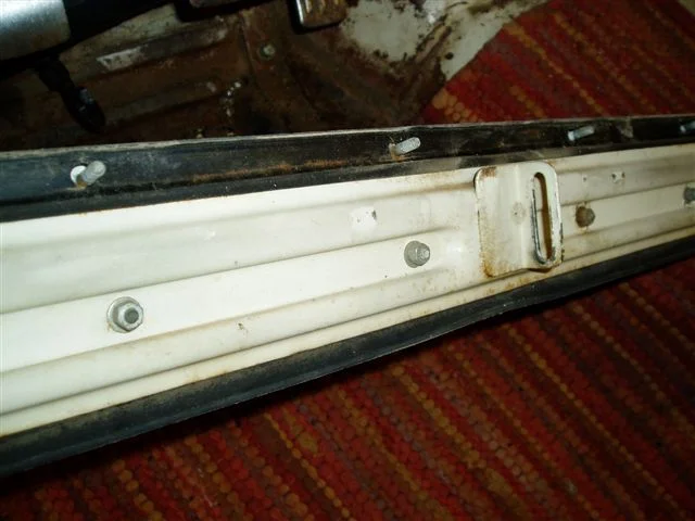

The vent gasket was a pretty good example of that. Backside was in great shape, front not so much from the paint. I gotta say....buying a west coast truck is WAY worth it over an east coaster. This is the second west coast truck I have worked on and all the bolts come out freely. Huge time saver from snappo, cuss, drill, tap, etc.

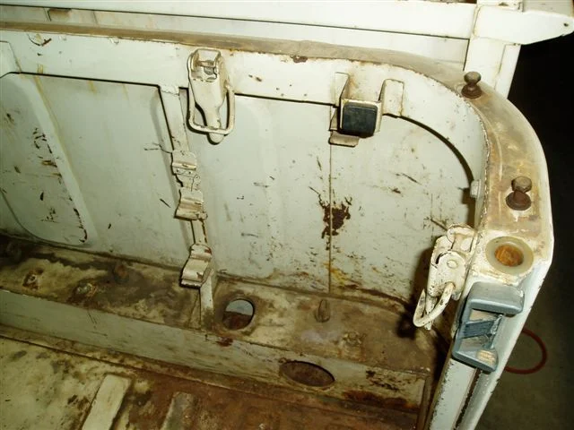

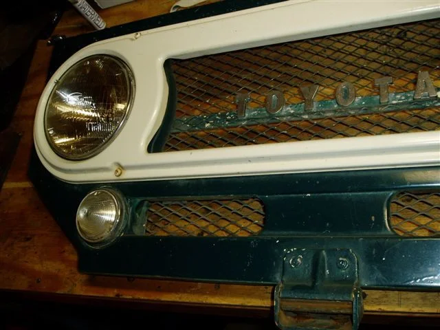

Fenders off, running boards off, etc. I'm down to only needing to lift the cab and bed off and onto a dolly. I only hit two snags in the disassembly. I cracked the near perfect windshield (%$#^&) and I broke one bolt off in the frame where the fender bolts to it. Not too bad...
The biggest PITA is now going to be finding a floor panel. I was going to order Real steel, then noticed that it's nowhere near matching. I thought only the ribs were round instead of square, but now I see that there are the wrong number and width of ribs. CCoT shows the correct floor panel, but it's only offered as a complete pan replacement, and I sure don't need that. $$$$$!!!!!

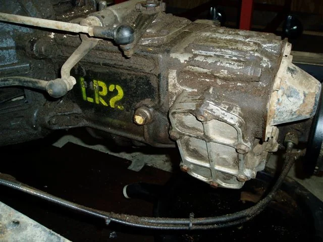

What does "LR2" stand for?

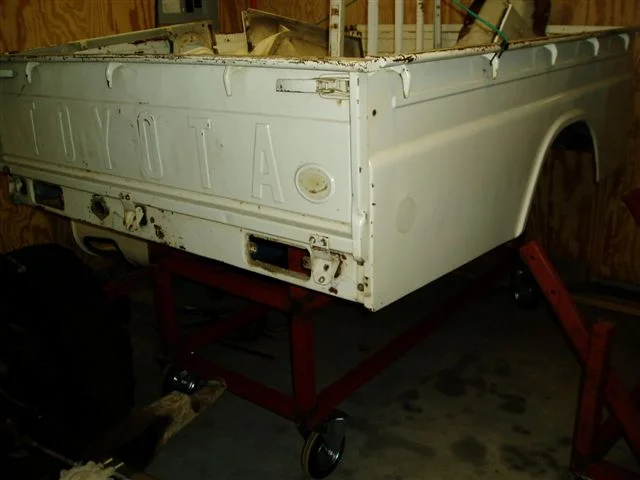

body off
Got the tub and bed off. Dropped the damn bed on the ground.....DOH!!!!!!
Lots of bad words exchanged with myself for the rigging used. I think I can pull the dents out.....we'll see.

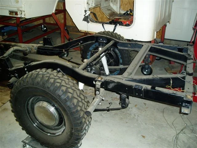

rear frame
You can see the rear half of the frame that I already prepped with POR-15 a few years back. Still looks great. I'm looking forward to the front half looking like this. Anyway, on track to drop the body at the paint shop this week and let him get cracking. I still need the floor patch panel, but no biggie. He has a lot of blasting and stripping to do anyway.

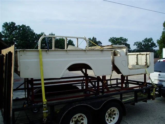

Loaded it all up on the trailer and dropped it at the blaster first thing this morning. He should be done by Friday and I'll take it directly to the paint shop.

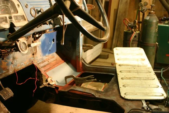

Last winter I replaced the same floor sections in my lpb tub. I used a tailgate access panel from an fj 55. The ribs matched nicely, but had rounded ends. I was pretty new with the wire feed at the time and so the transition isn't all that smooth, but I'm glad I did it. More on that project can be found by searching my thread in the 40 series tech entitled 'the first cut is the deepest'.
