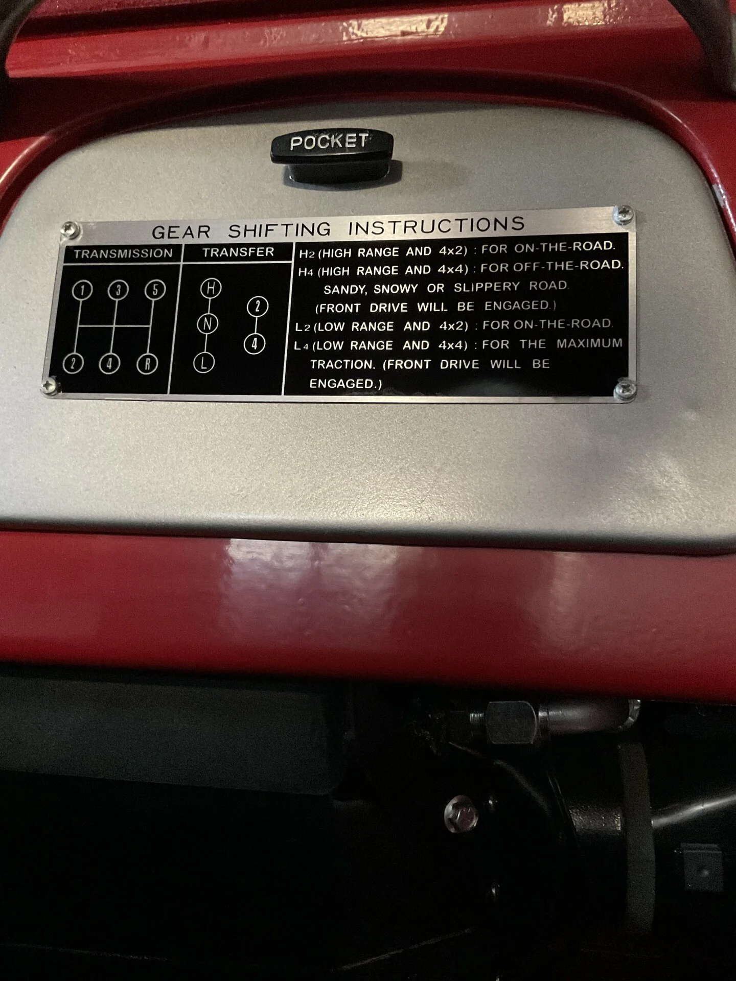

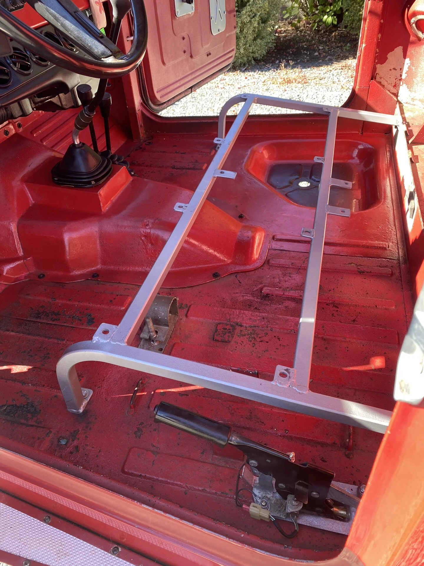

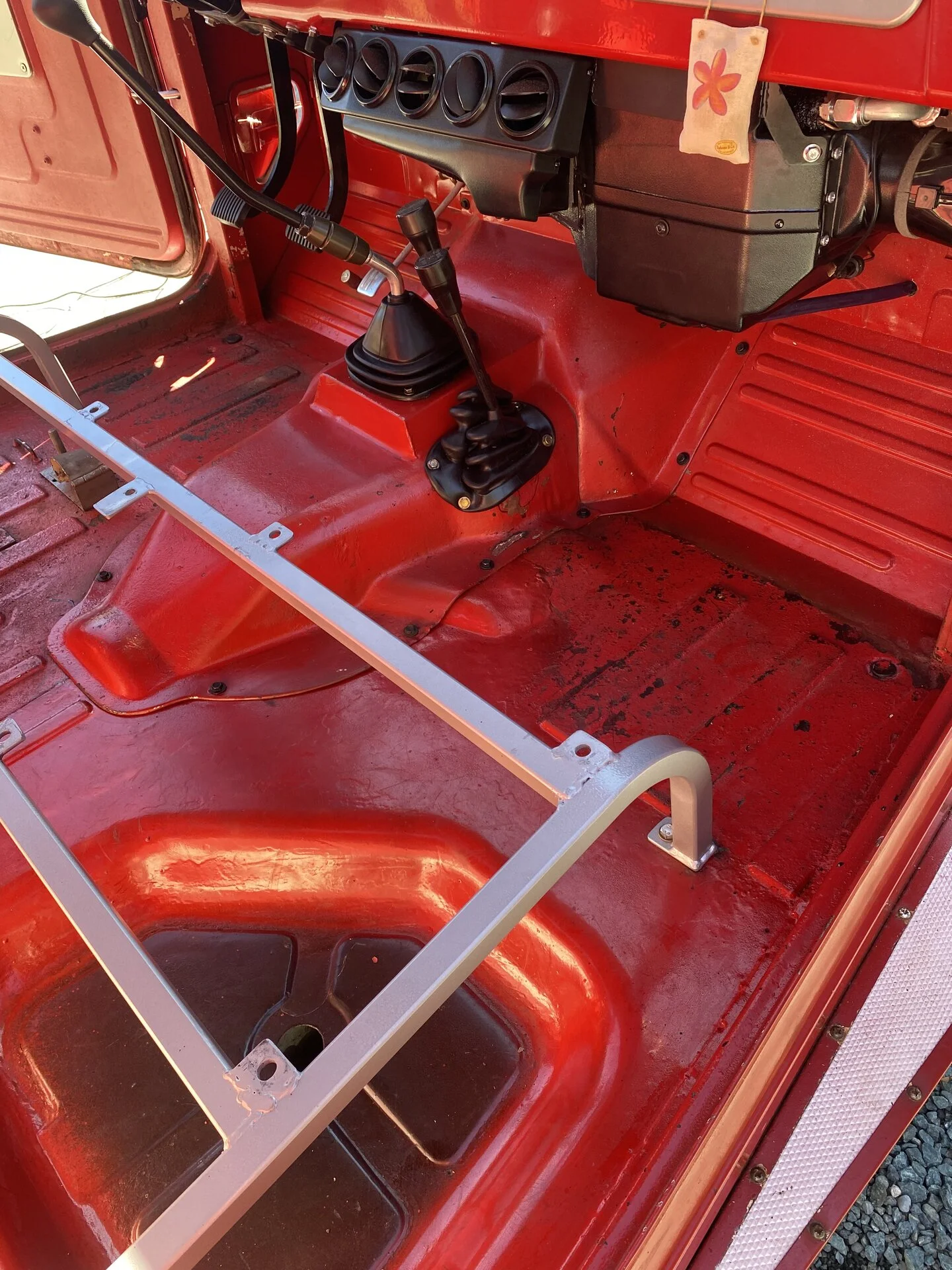

Bought a new shifting diagram plate to reflect the 5 speed and the twin sticks 😀

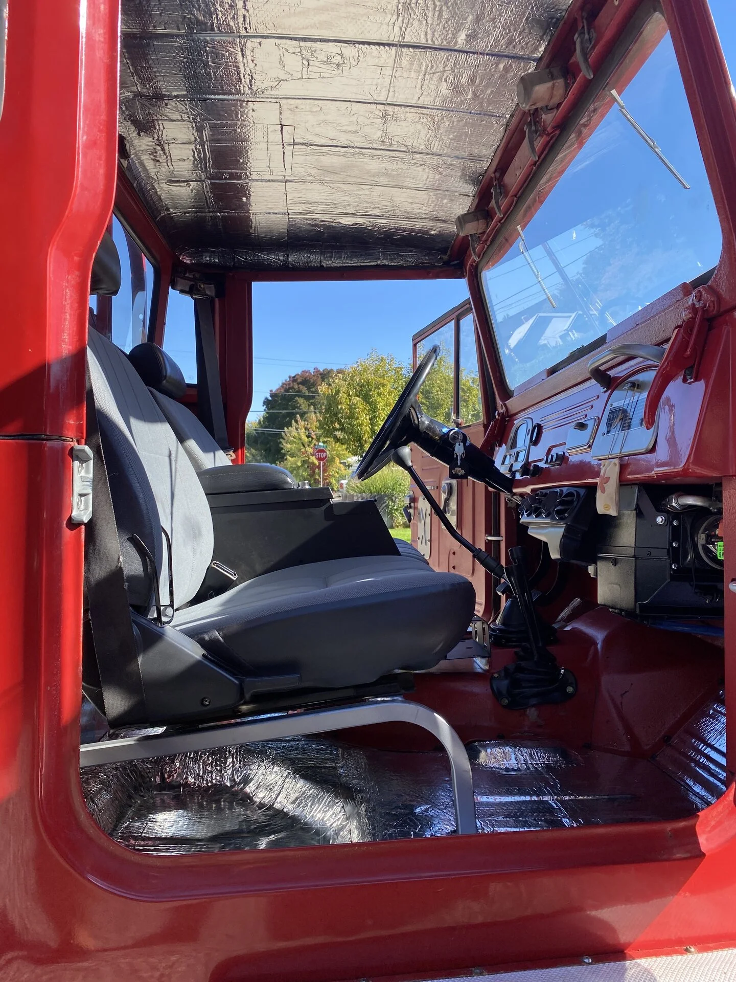

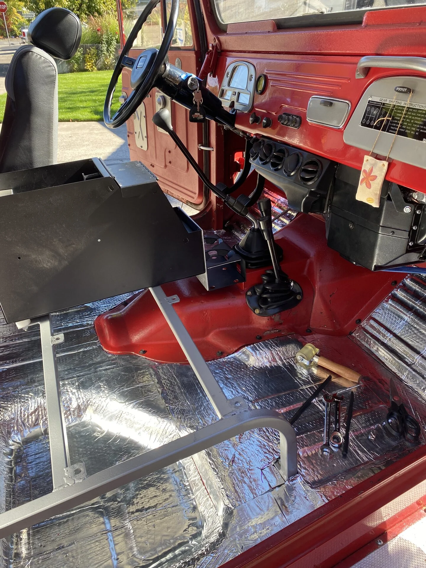

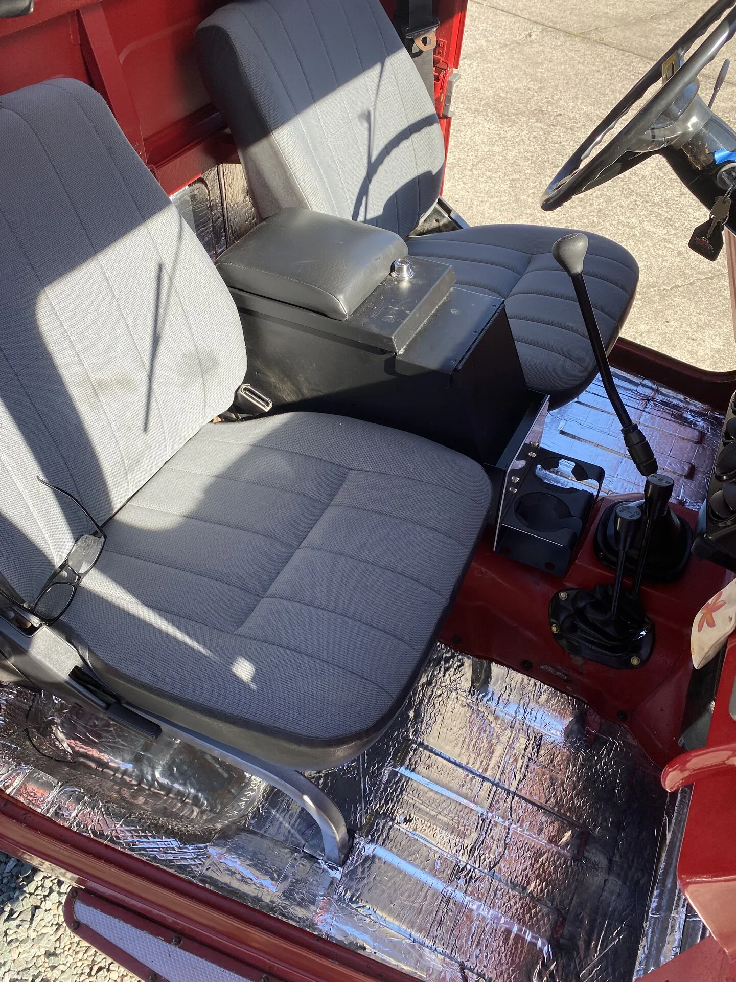

We are having a warm spell here in Oregon, so I thought it would be a good time to start prepping and get some sound deadening in. Going to put it on the roof and back wall as well.
Got some sound deadening in and boy has it made a difference. Still have more to do but definitely worth doing especially with the diesel. I will say that my arms and back know that I’ve had them working overtime…..
The tranny hump was coated on the underside but I still may put some on top as well.
I used Noico mainly because it was a little less expensive and available. It went in really nice and I like the product.

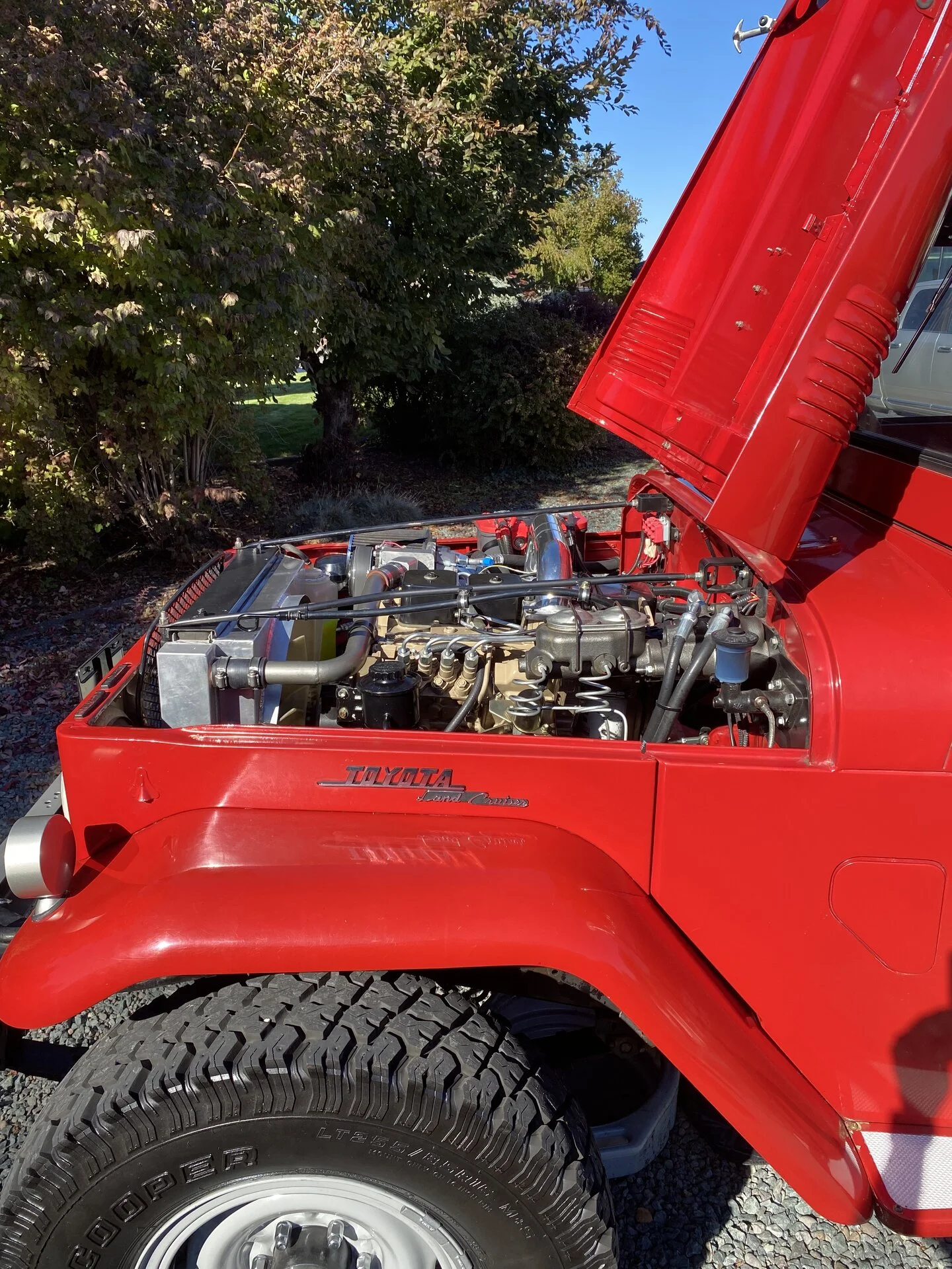

I will be using the Dynamat Hood liner Under the hood. I’ve read It has great thermo and acoustic properties. I think it comes in black and will look better when the hood is open as well. It also comes in different thicknesses. I was not concerned with the silver on the floor as it will be covered up eventually.

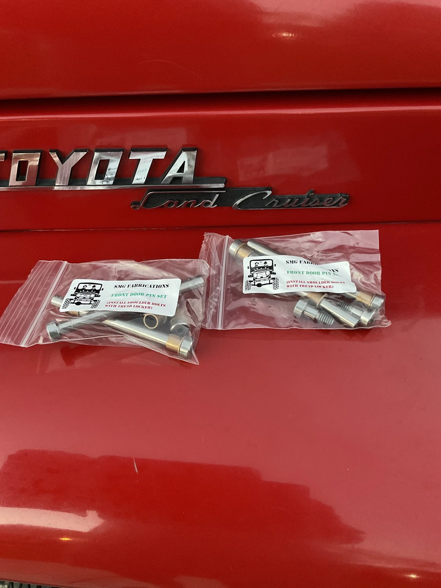

I just received these little gems for my door pins from @SMG. I should receive my hood and windshield pins soon. What a great product, Thank you Steve for making these available to us.
Work of art Mark!
Thanks Michael, it took a while to finish this one up but it’s been totally worth it. We still have a few things to get done but I’m super happy with the outcome at this point..
Mark

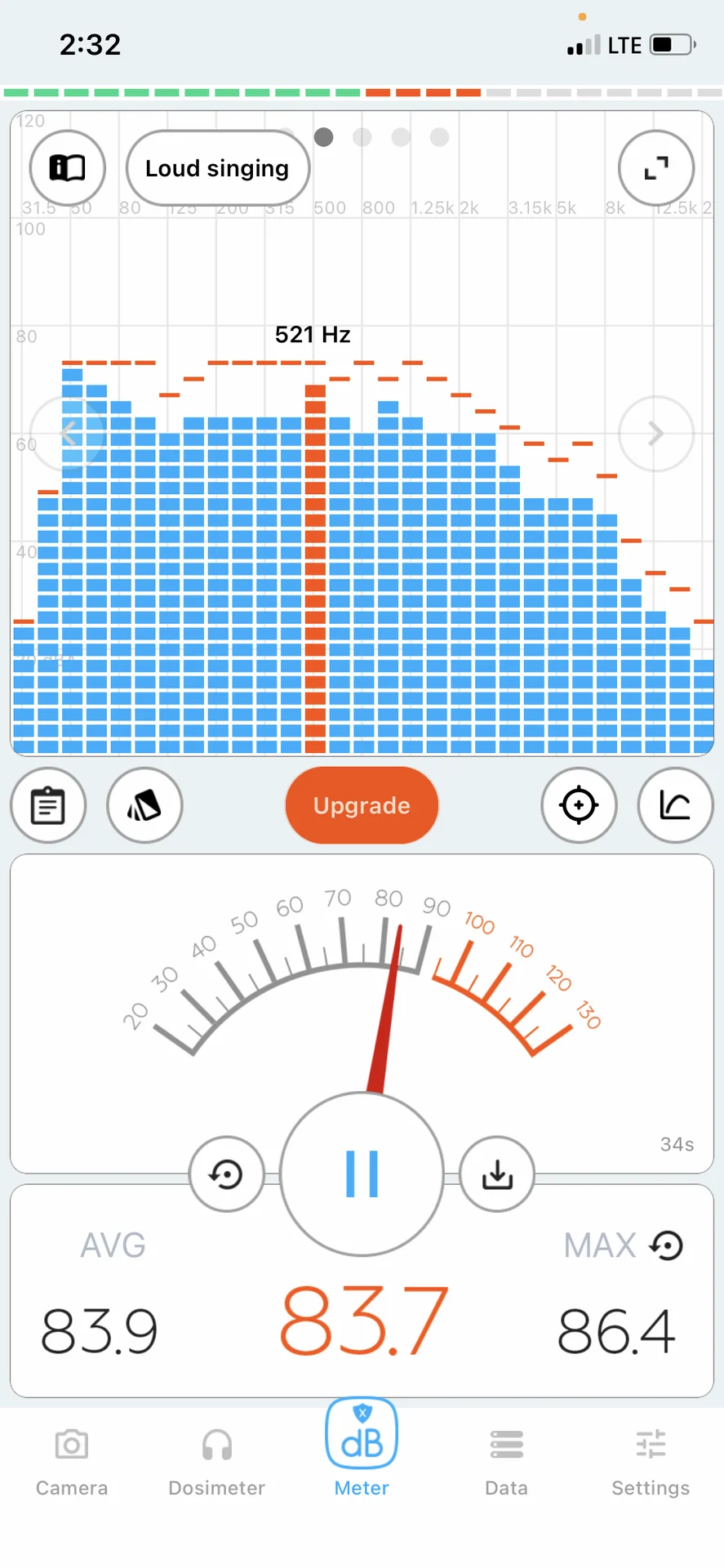

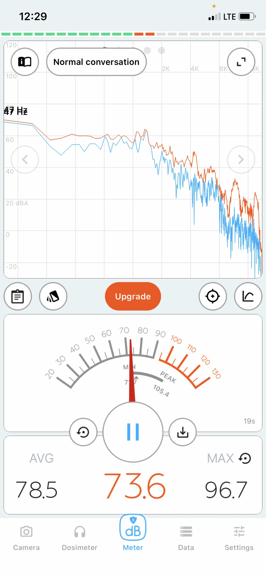

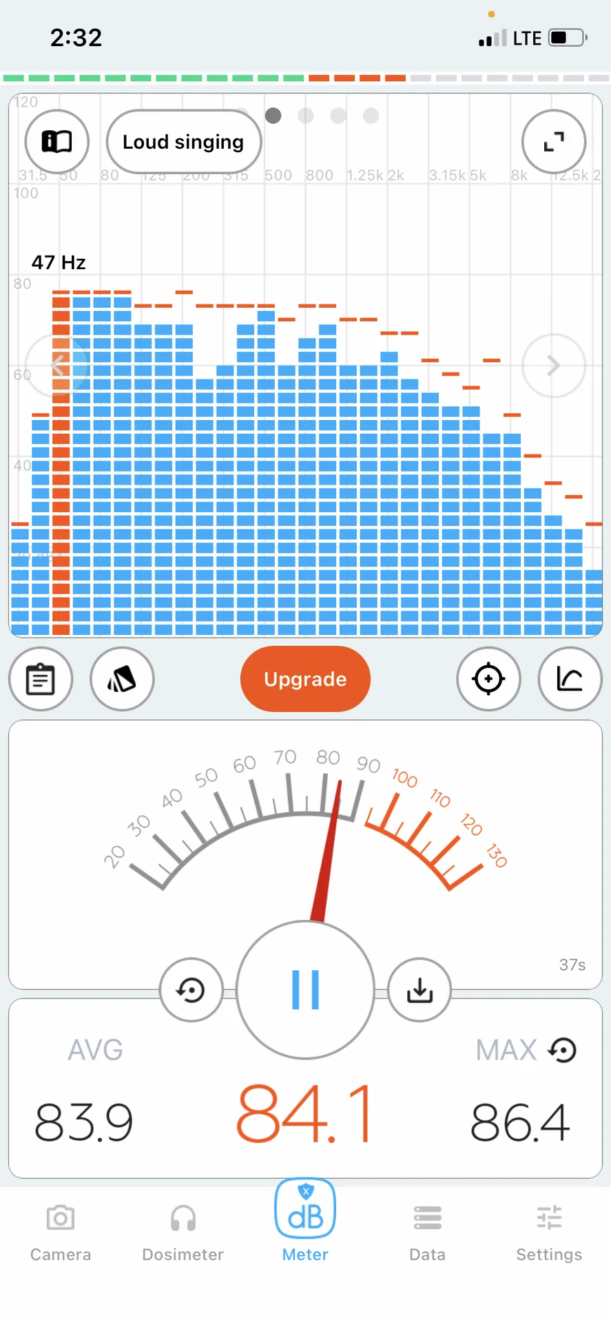

For those who have been asking about the noise level before and after the sound deadening, here’s what I have so far…
I have completed putting the first layer of Noico sound deadening on the floor, cab roof and back of the tub. I still need to put it on the back of the removable top and up a little further on the foot wells. Unfortunately I did not get readings before the deading.
I can say that it made a Huge difference. the decibel readings are not that far off from some of the others with an F or 2F at 65MPH.
At idle ————73.6 dB
At 65MPH——-83.7 dB
At. 70MPH ——84.1 dB
I still need to get the headliner in, more matting as well as some Dynaliner under the hood. I am surprised and extremely happy with the results. Not sure it’s much worse than my old F engine screaming along at 60 MPH.

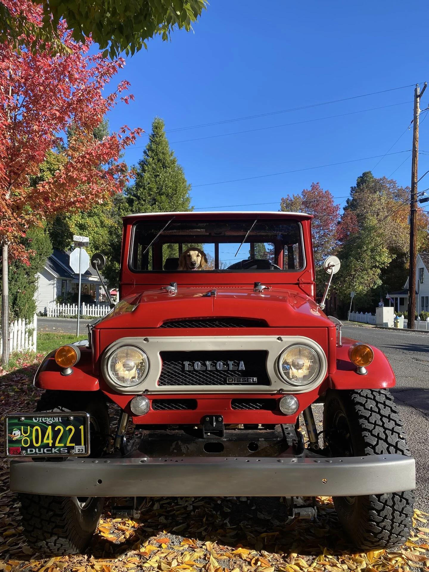

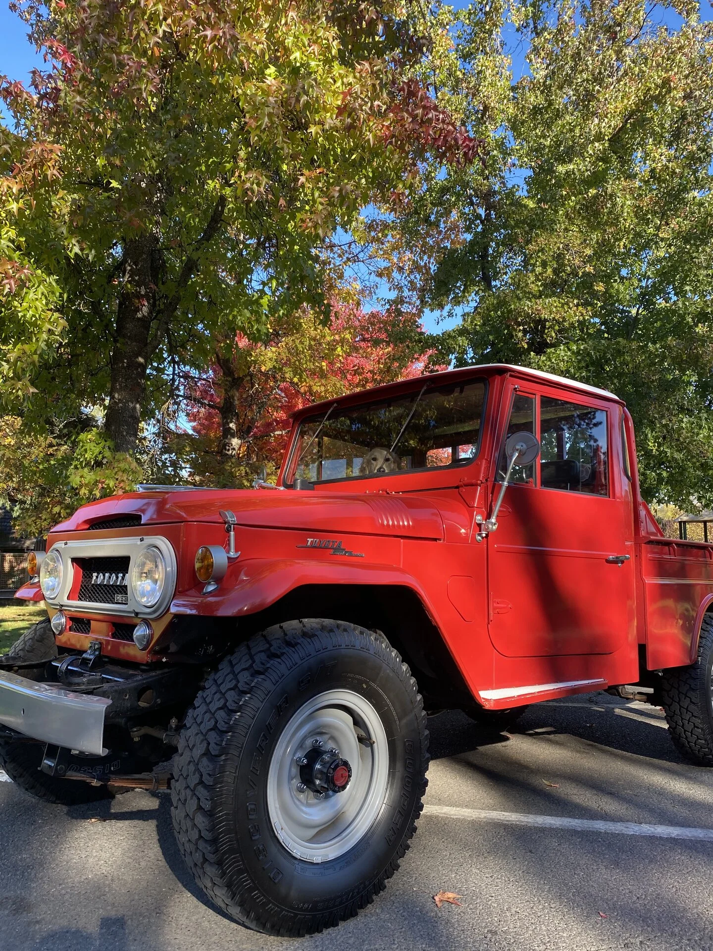

My wife had a specific tree and color in mind. So….I was on a mission to find a Scarlet Red Maple tree. Just what I needed, an excuse to drive Scarlet 😀
