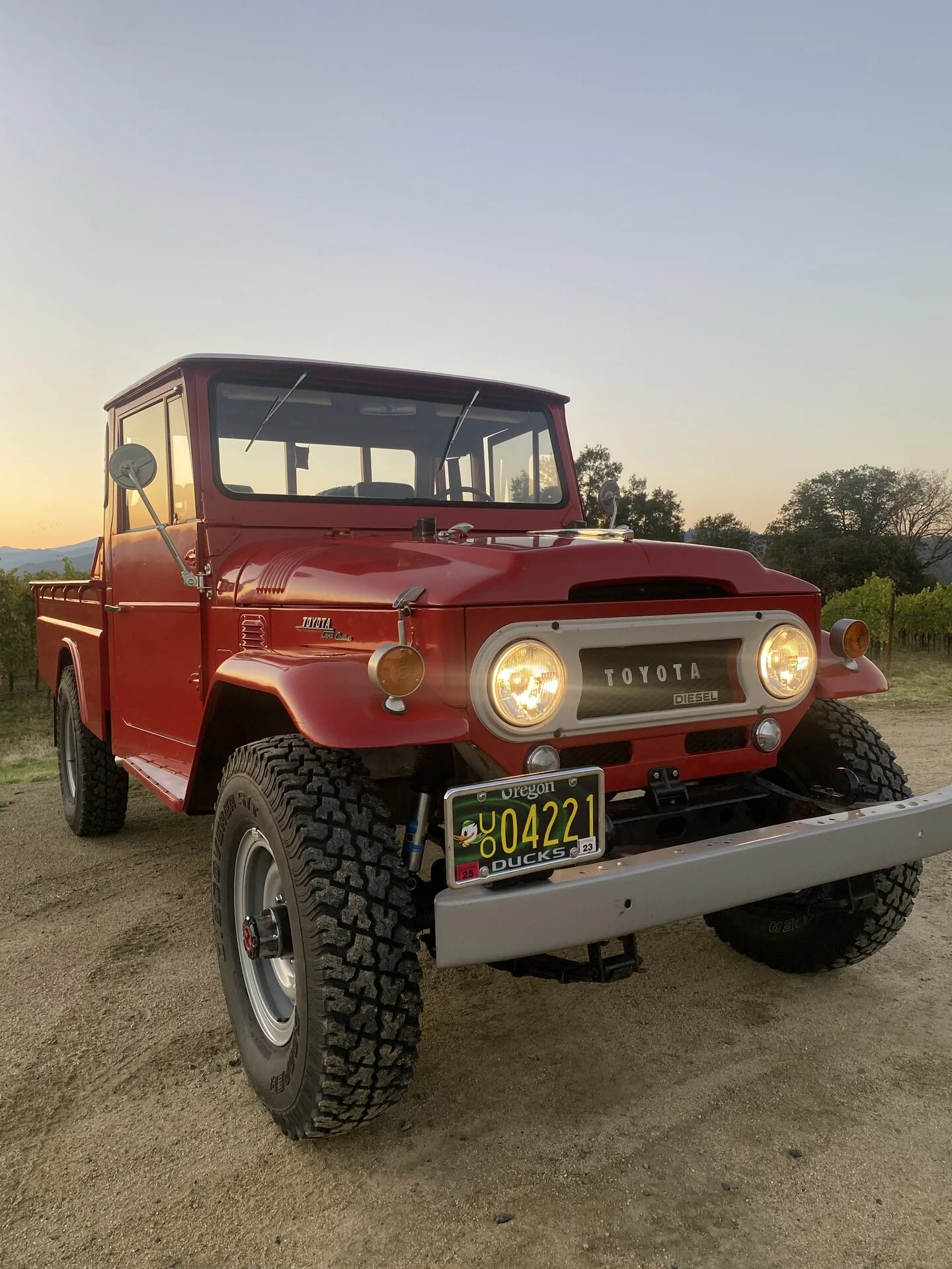

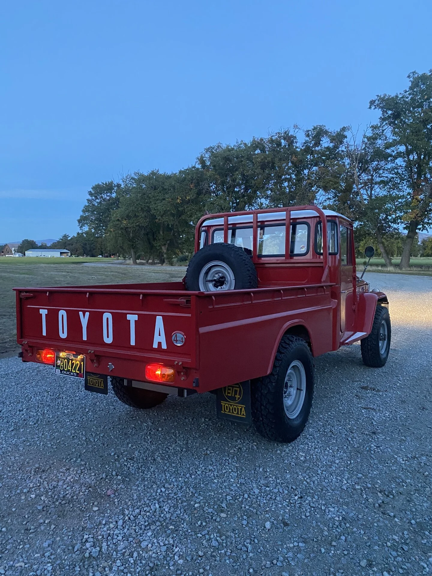

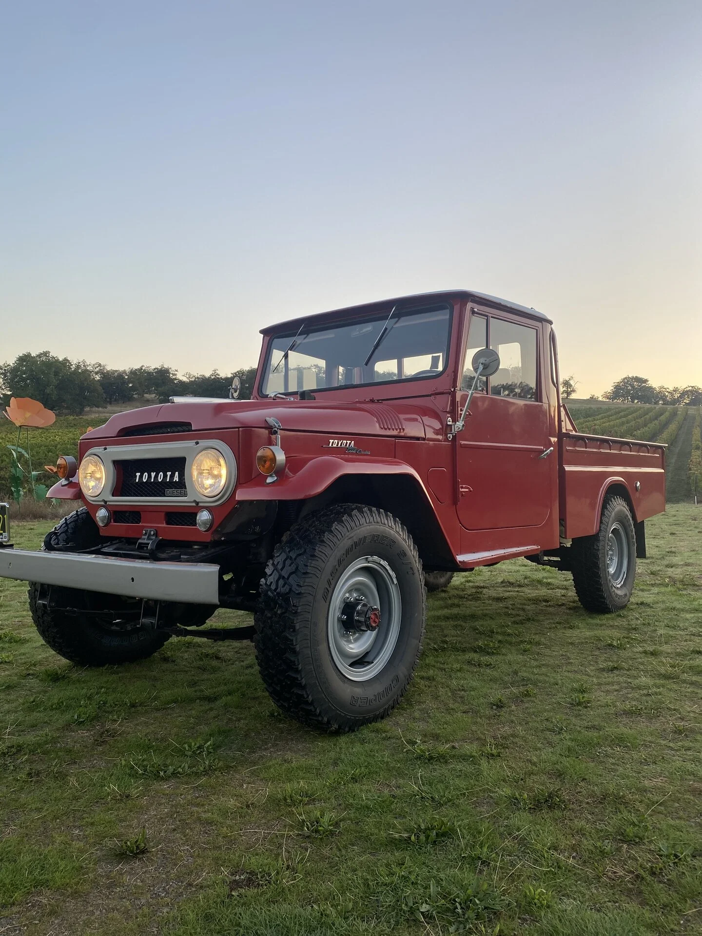

After contemplating and sole searching I decided several months back to take one of our 45’s, a 1966 LPB to be exact to another level.
We found the engine and some other components here on mud from another member.
This truck was not stock and had been repainted before. Never thought a true Restomod was an option as I’m more in line with the all stock mind set. However after watching Nolan create some true master pieces out of some old relics, I thought maybe I might test the waters, “ by no way to the same level”.
Well I did more than test the waters. I jumped in with no life preserver. Full disclosure, I did not perform most of this work. I decided to sell or trade away most of the true 45 parts that I wouldn’t be using so one, I couldn’t change my mind and two I could make the pocket book feel like it was less empty. 😳 A few members here on mud were the recipients of those parts….Thank you.
My thought was to go with the cummins power plant, upgraded FJ60 axels and brakes, late model FJ60 seats with a custom frame to get the most out of the cab leg room wise, NV4500 transmission, late model Toyota split transfer case, new Bilstein shocks and added some creature comforts since this will be driven daily. We added a Dakota Digital gauge cluster and a Vintage air and heating system just to name a few. We are still working out some kinks but we are very happy with the results. we still have lots of sound deadening to do and a few other things. We wanted to keep the original look for the most part and I think we accomplished that. It’s a work truck that will be used.
Here are a few photos of Scarlet…..she drives wonderful.
Regards
Mark

Beautiful Mark. Curious how you handled the spring perches on the front FJ60 axle, I thought that springs needed to be out boarded wider than the factory FJ40/45 perch width to clear the pumpkin/use the factory FJ60 spring perch locations. Look forward to seeing more details on the build.
Thanks EWheeler, the old FJ60 perches were taken off and new perches were added. I can get you a picture of that if you need one.

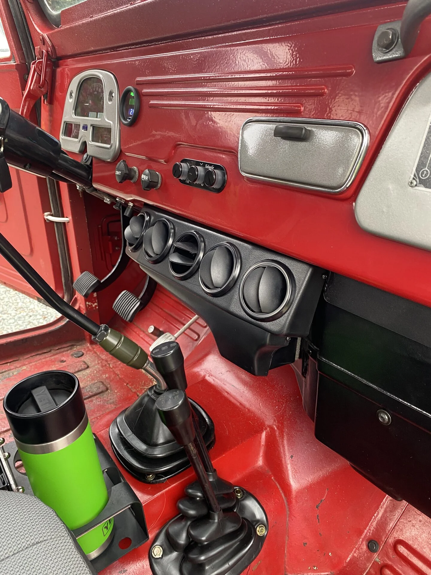

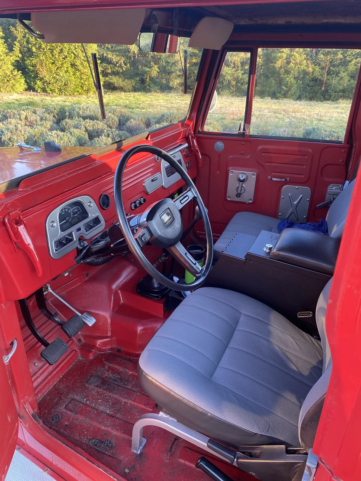

Used the FJ60 parking brake a relocated it to the left of the drivers seat …
awesome set up. An actual parking brake that works….
I didn’t say that….😀
wow, many more pictures please. I don't think you will be able to post too many :)
Here ya go Matt. I have lots of little things left to do but wanted to get some miles on her. Headliner, Dynamat, touch up paint etc.
Thanks Michael…that is the plan.

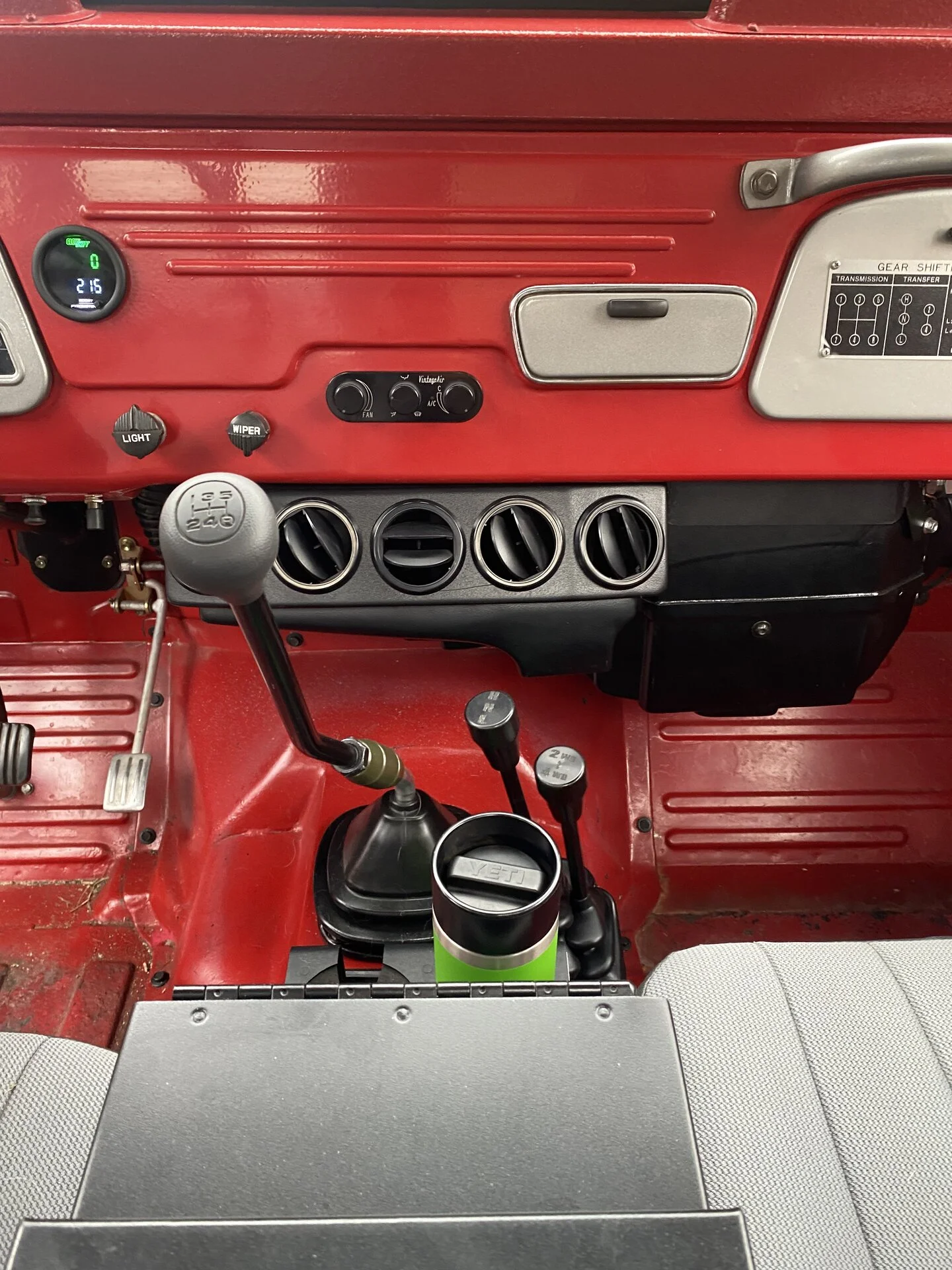

Couple shots of the twin sticks we put in and the Vintage air/system. Both are working fantastic. The A/C will run you right out of the small cab🥶

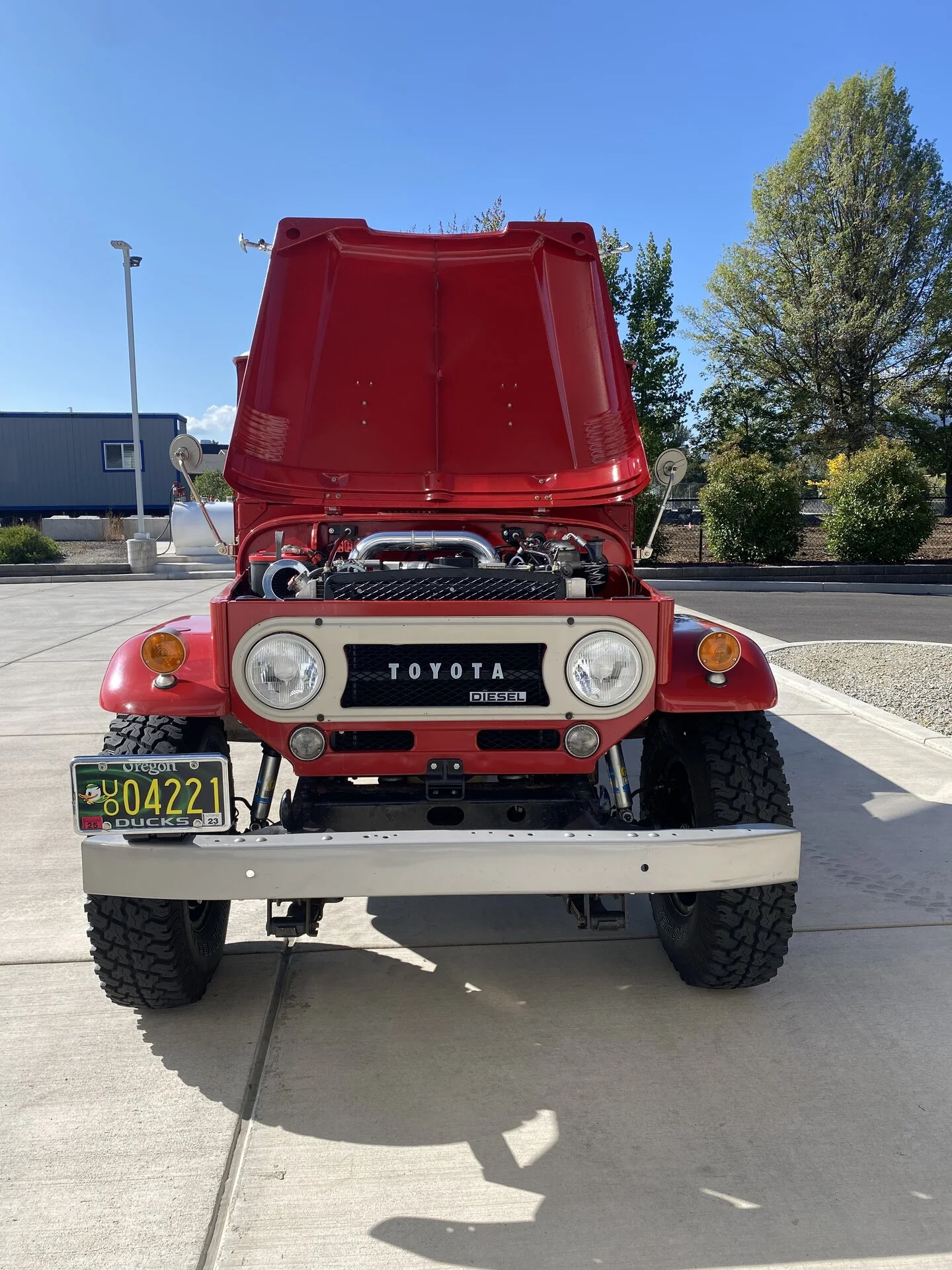

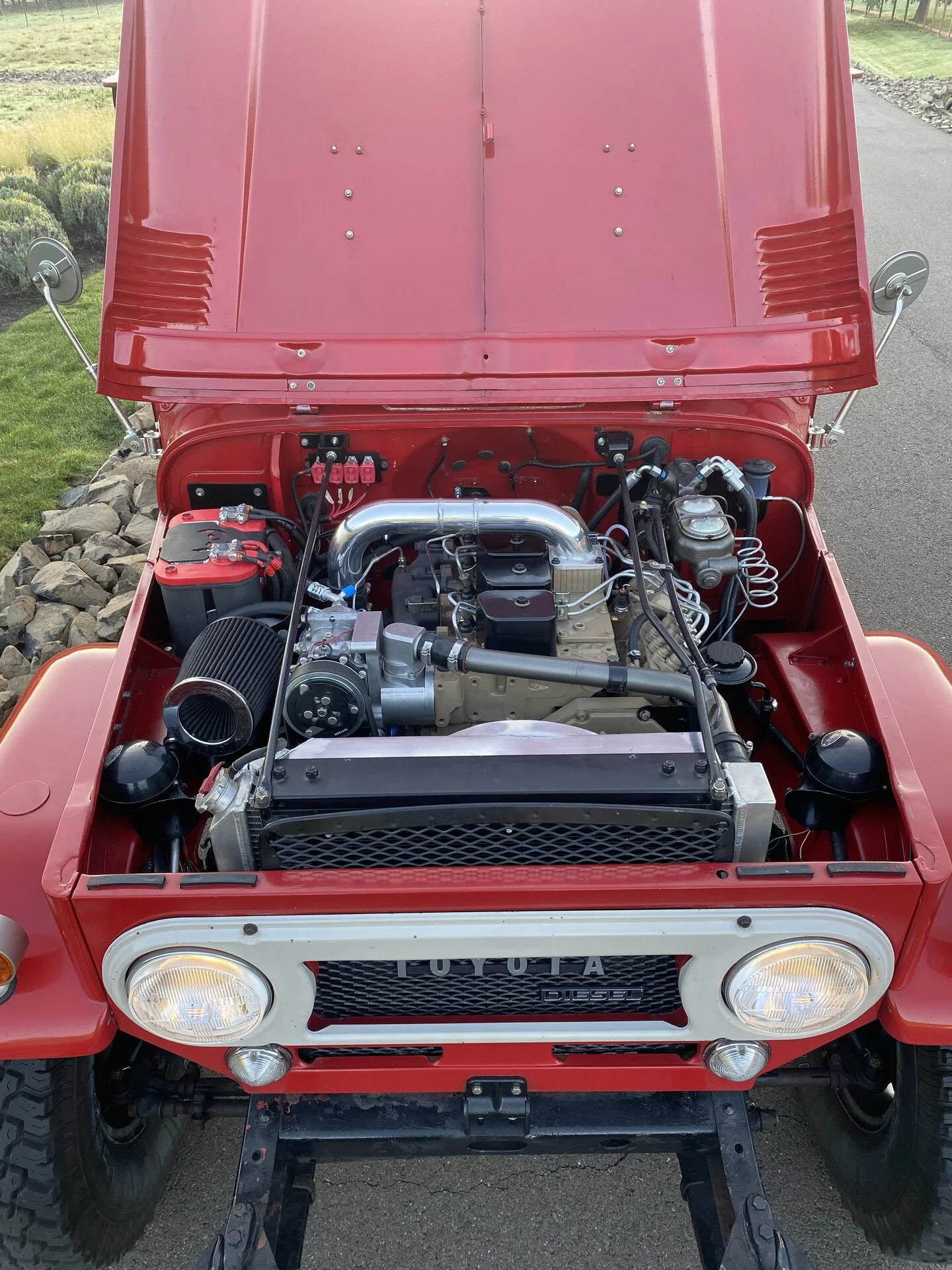

Nice work! Please post some before and after videos of driving with and without the sound deadening. I’d love to hear the Cummins. Looks like a 4BT? Did you have any performance work done to the engine?
What engine and transmission mounts did you use?
Hi Chris, Thank you. I will definitely post up some before and after with Dynamat installed. Trying to get a bunch of miles on before that process. A lot of work was done before I got the engine. Dowel pin, 3000+ RPM governor spring, fluid dampener, valve upgrade, upgraded ARP head bolts and much more.
We have have a custom made “not by me” transmission mount that came with the package.
My buddy’s shop made our own motor mounts.
